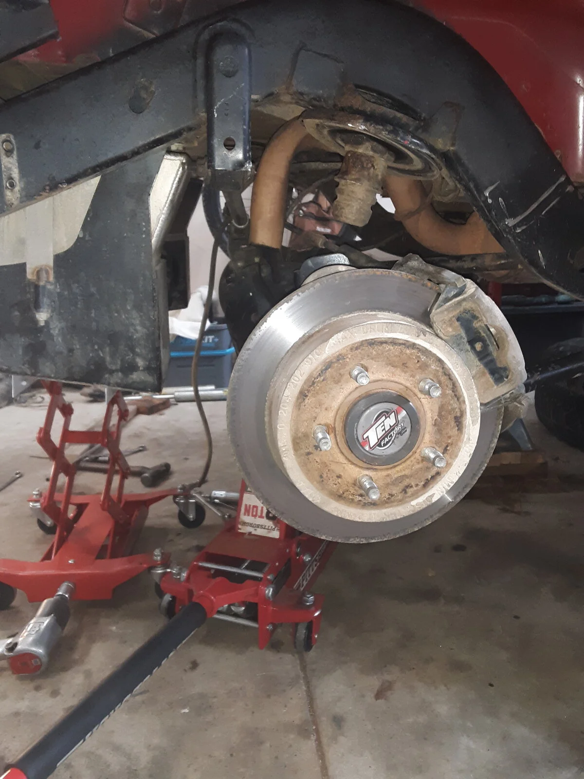

Nice work. That warranty claim seems to have gone smooth for you? Which brand shaft was it that broke?
Ten Factory. I emailed them in the morning and they shipped it that day.Nice work. That warranty claim seems to have gone smooth for you? Which brand shaft was it that broke?

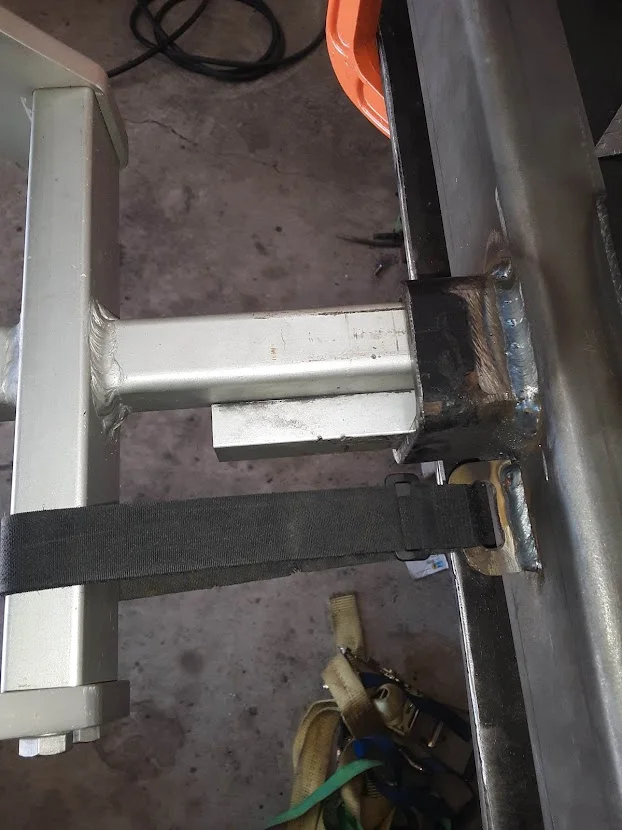

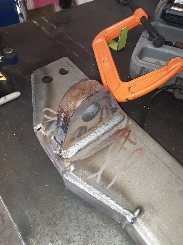

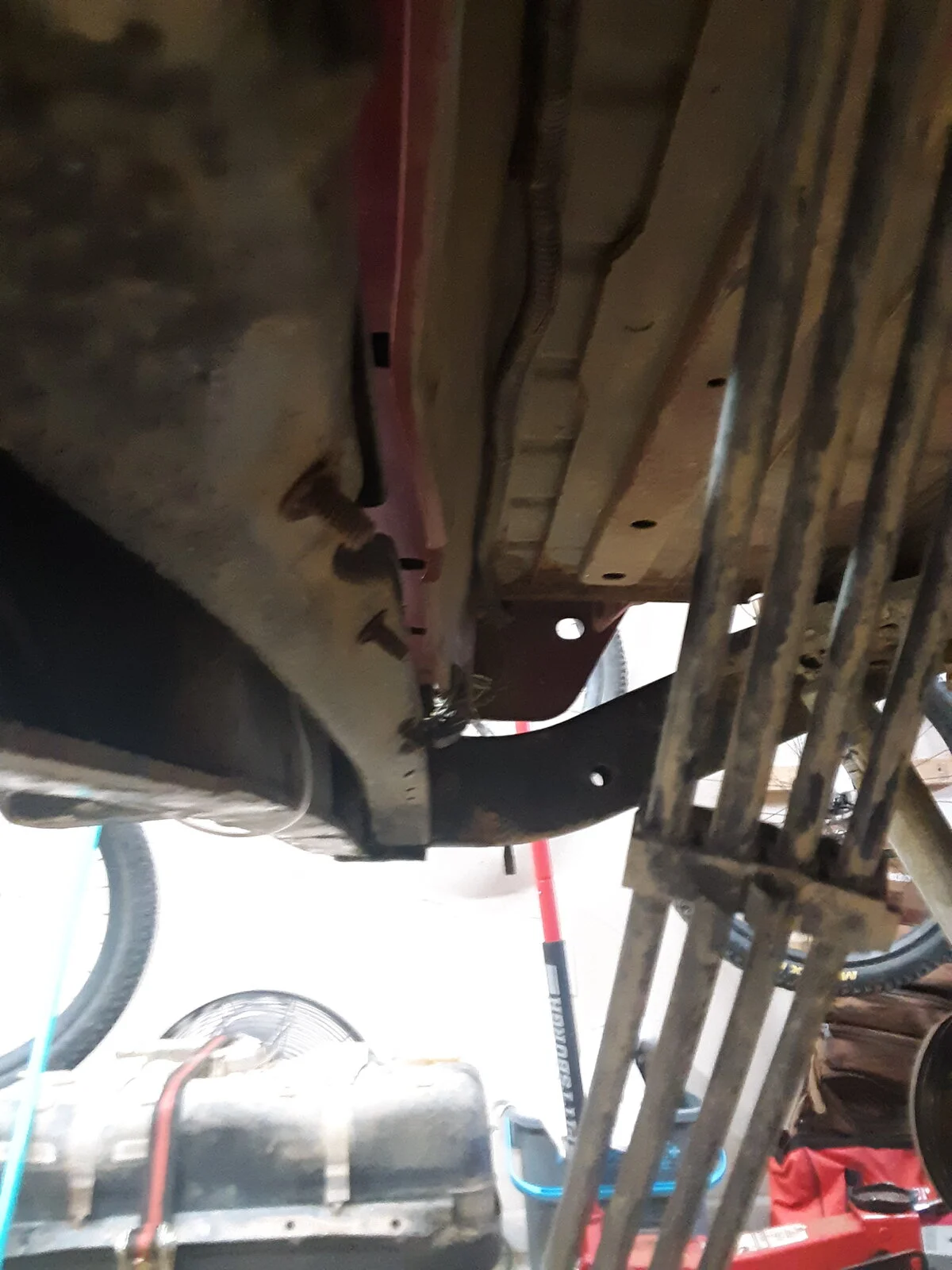

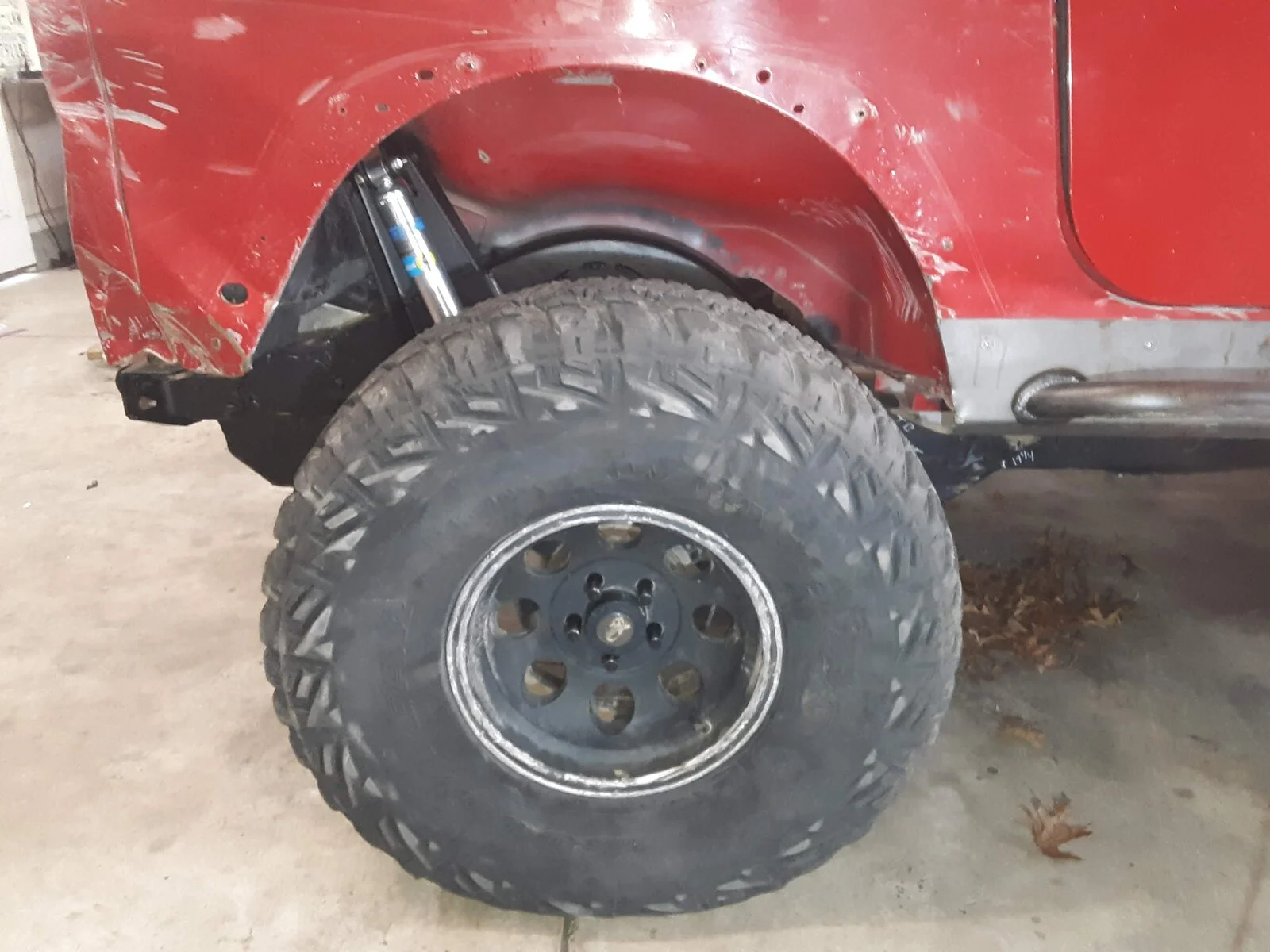

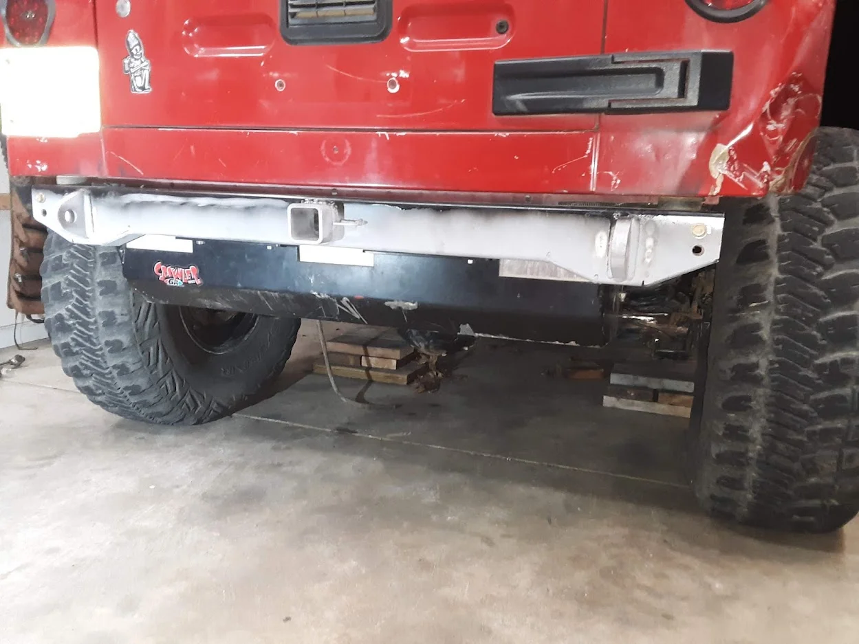

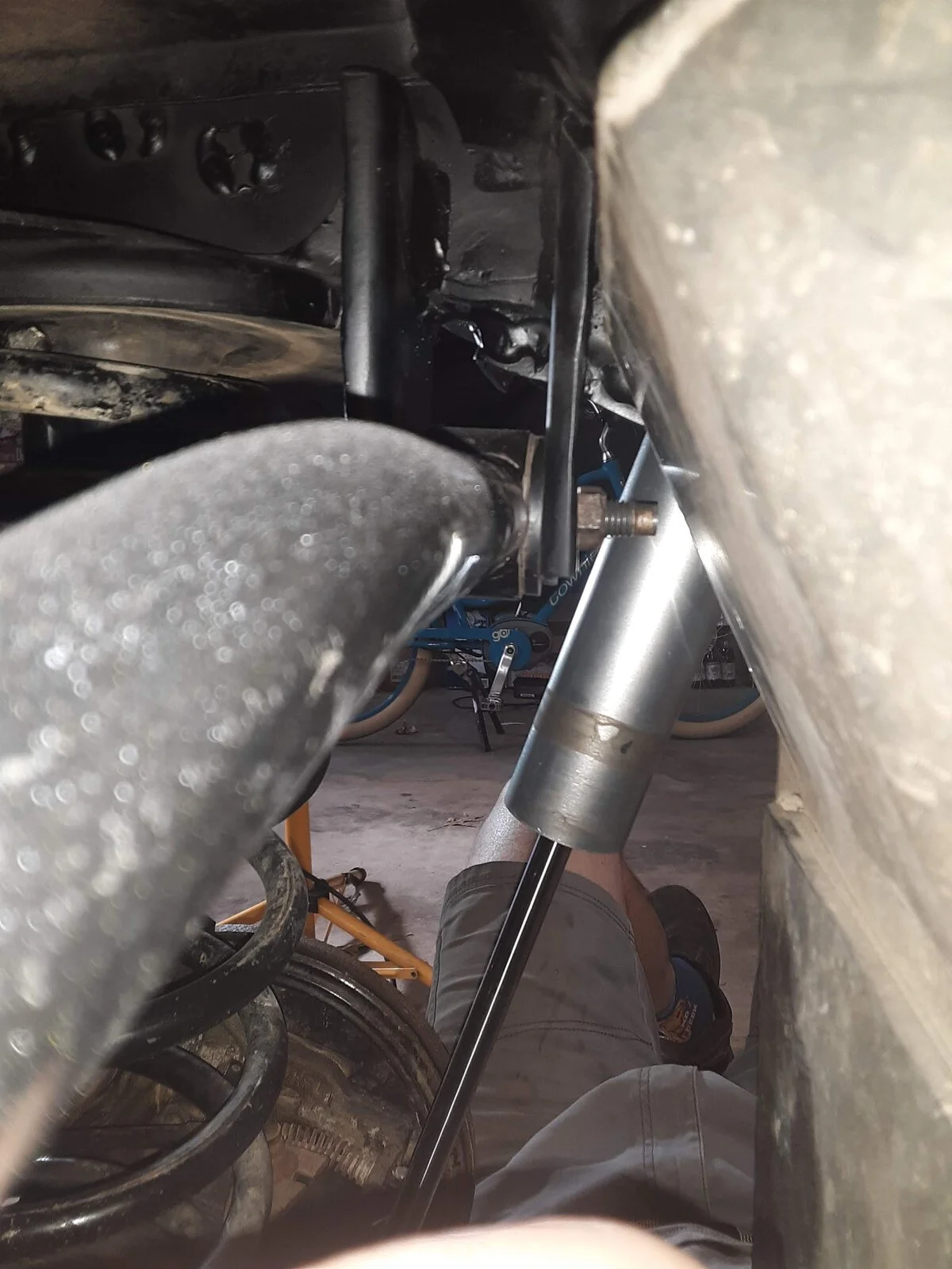

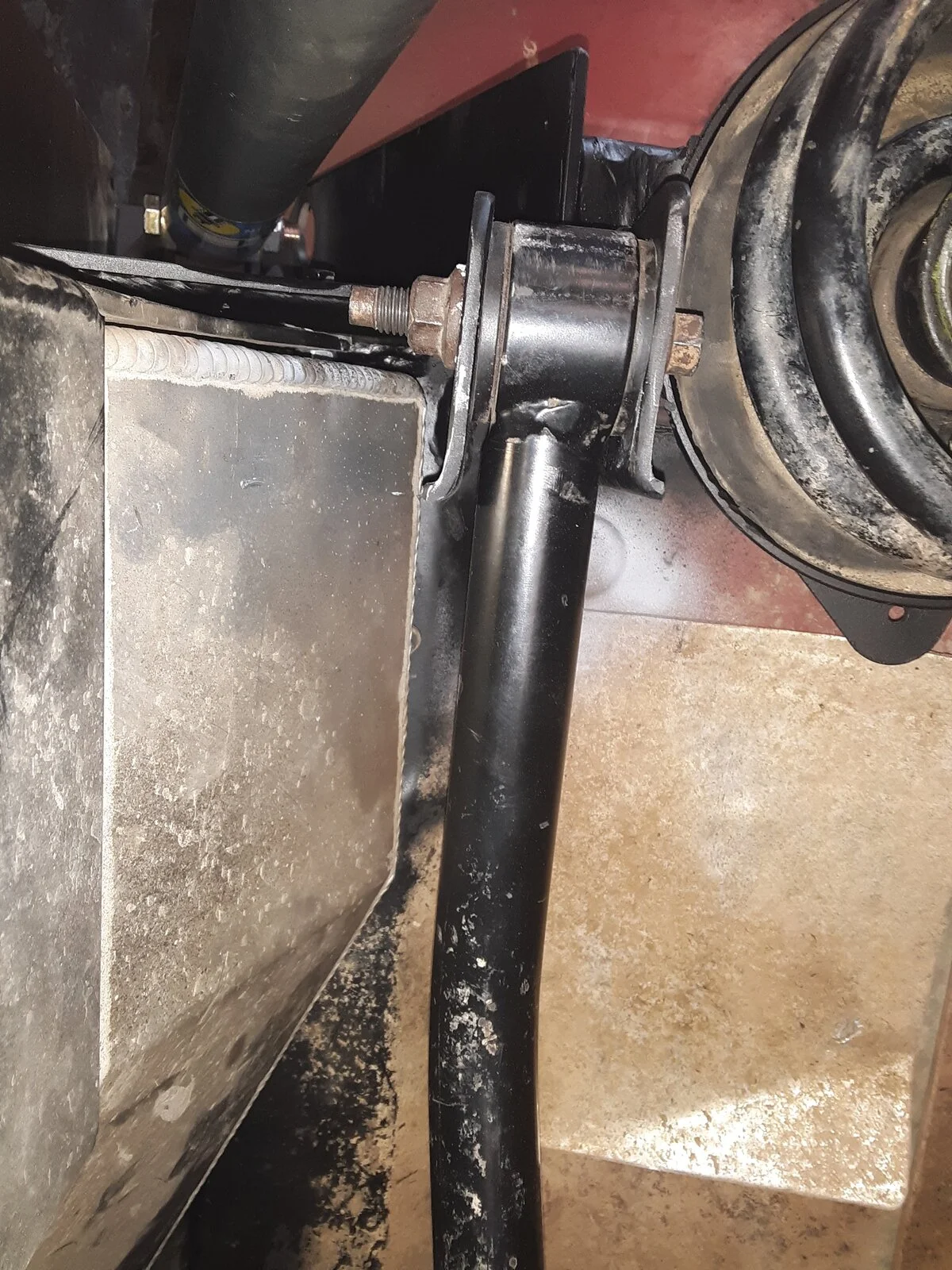

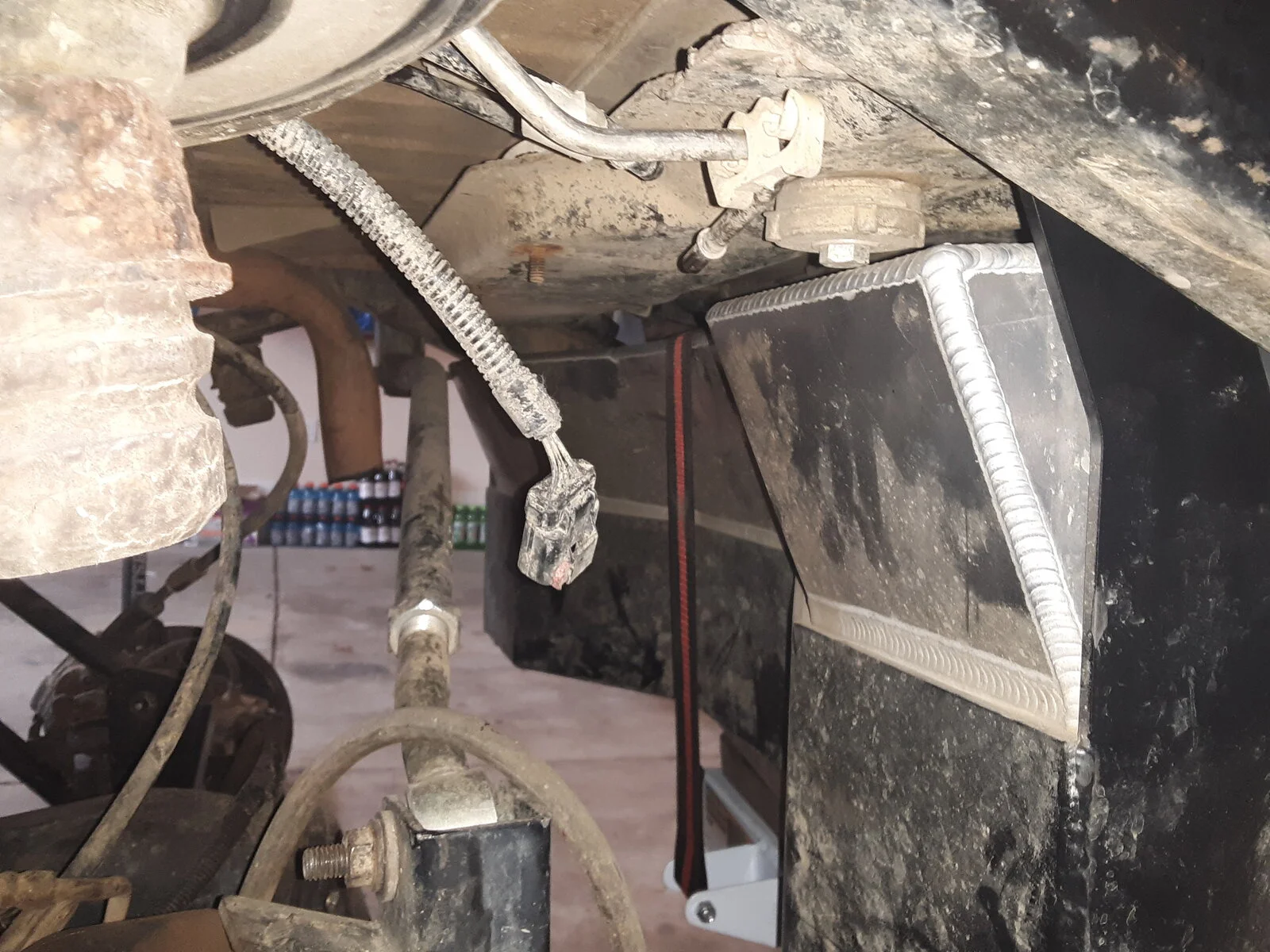

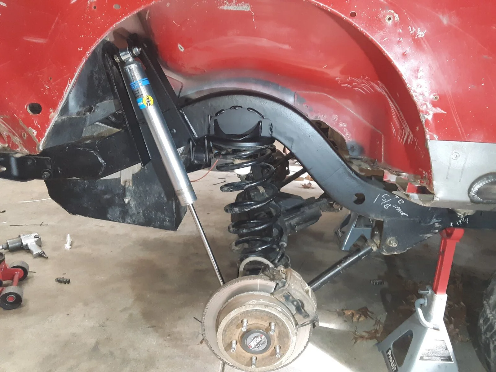

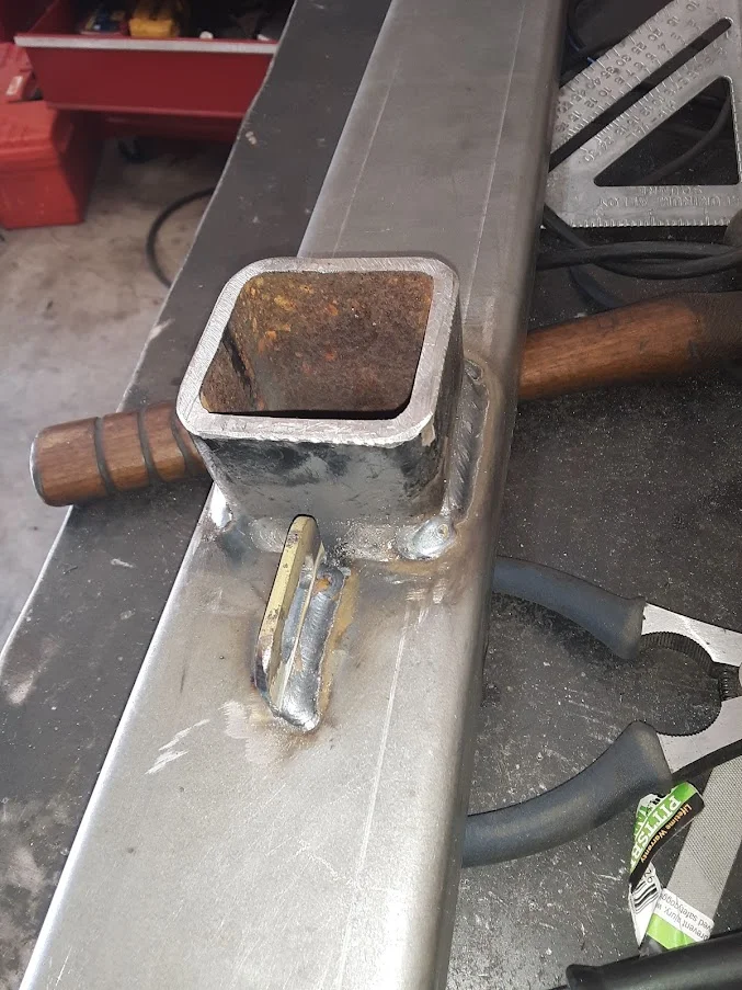

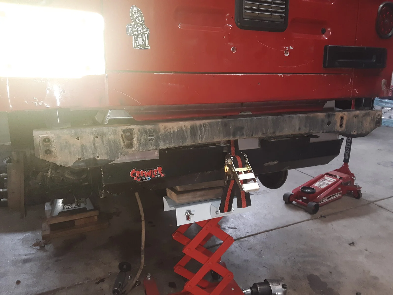

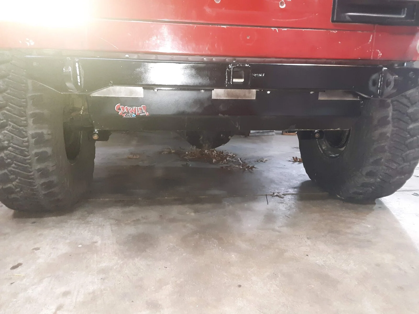

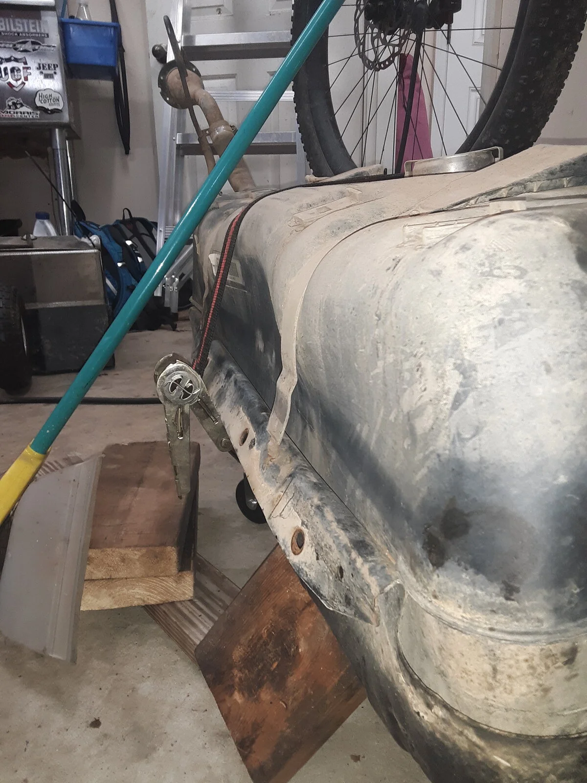

I just purchased a GR Crawl23 tank which will require the rear shocks to be outboarded. I also have already purchased the towers and shocks to outbd the rear shocks.
A lot of typing just to help me get some of my thoughts out and "down on paper".
- So Step 1 is going to be to outbd the rear shocks and install the fuel tank. This is going to be a multi process step because I need to get my ride height with all the weight (including fuel and normal crawling gear, camping gear will be the outlier and not accounted for) in order to properly outbd the shocks and I will also want to push the rear axle back slightly and to rotate the pinion to correct angle so I will need to remove and install parts numerous times while measuring, etc... to get everything set correct.

- Step 3 is going to be to do something about the short arms and the antisquat issue. TBD. I have preliminarily designed my own single triangulated 4 link which will cost about $1200 or just bite the bullet and buy the savvy mid arm for $2800 and do both the rear and front. Right now I have been focused on the rear and haven't even thought about the front yet.

Not yet, I still haven't hooked up the fuel/vapor lines yet but looks like there is plenty of room. Also, as you are aware, it would be impossible to route the exhaust back past this tank. I learned a few lessons on why it is dangerous to give an Engineer a grinder and welder, but other than that it has not been an issue.Nice Vic - any other fitment challenges getting it in there?
