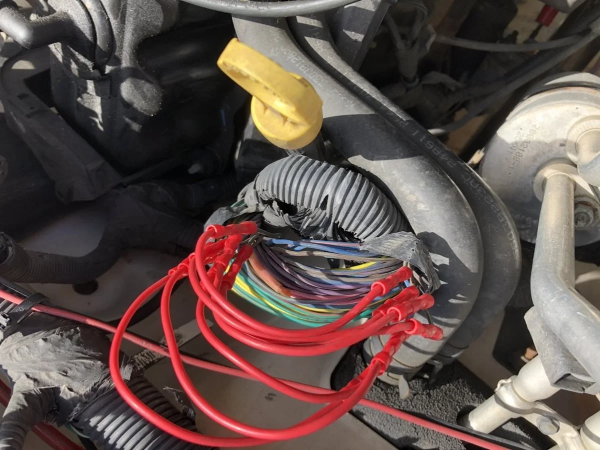

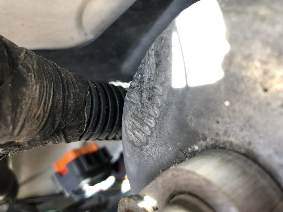

So the other day a problem returned that I hoped never would. The PCM problem in 05 and 06 automatics. I was wondering if anyone has taken they're Jeep to a dealer and they flashed it.
I may be 2 years too late but I thought I’d chime in with my PCM experience. I have a 05 RUBI a/c and a/t. I got the CEL after my Jeep started running rough. I got several codes. Cat was bad, both upstream o2s were showing up bad and a fuel injector. Replaced cat, bank 1 on old one was collapsed and plugged. Replaced all o2s but both upstream remained inactive. Thought maybe it was PCM. Long story short. Before I dropped huge money on a new PCM I decided to physically check my wiring from pcm to each and every plug. Not far from the PCM, where the accumulator is the wire loom rested over it. I put my fingers under the loom there and found a hole that the vibration of the motor wore a hole into and severed many wires throughout 15years Well hidden disaster. I unplugged the battery and all 4 plugs going to PCM and started repairing wires. When I finished I plugged everything back in, started it back up. The Jeep ran smooth. No CEL light, no codes. I fixed the problem. It wasn’t easy to find. My Jeep was down since August 2019. My original PCM has 168,000 miles and still going. It’s not always bad components, it could be broken wires or both. Hope this helps.Good luck fellow Jeepsters.

I may be 2 years too late but I thought I’d chime in with my PCM experience. I have a 05 RUBI a/c and a/t. I got the CEL after my Jeep started running rough. I got several codes. Cat was bad, both upstream o2s were showing up bad and a fuel injector. Replaced cat, bank 1 on old one was collapsed and plugged. Replaced all o2s but both upstream remained inactive. Thought maybe it was PCM. Long story short. Before I dropped huge money on a new PCM I decided to physically check my wiring from pcm to each and every plug. Not far from the PCM, where the accumulator is the wire loom rested over it. I put my fingers under the loom there and found a hole that the vibration of the motor wore a hole into and severed many wires throughout 15years Well hidden disaster. I unplugged the battery and all 4 plugs going to PCM and started repairing wires. When I finished I plugged everything back in, started it back up. The Jeep ran smooth. No CEL light, no codes. I fixed the problem. It wasn’t easy to find. My Jeep was down since August 2019. My original PCM has 168,000 miles and still going. It’s not always bad components, it could be broken wires or both. Hope this helps.Good luck fellow Jeepsters.View attachment 157852View attachment 157851
were you having PCM related issues? Or mainly just the CEL?
