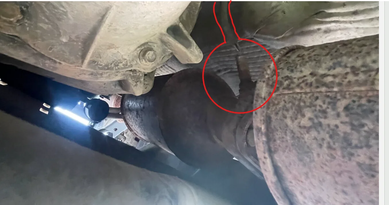

Looking at the diagram for the 4.0L engine, I should have 4 sensors, and two cats right up against the manifold right? Wrong. No cats up near the manifold, looks like I’ve only got one under the skid plate, and only 2 sensors, one before the cat, and one after the cat. Refer to pictures. 1st pic is before cat, 2nd pic is the exhaust going into the manifold and actually looks like there are bolts in where the sensors should be and the 3rd pic is the cat/sensor after cat.
So I’m assuming the owners before me potentially modded this?! After looking at the VIN, double checking I’ve got 6 spark plugs (lol), and checking everything telling me this is a 4.0 6 cylinder engine, I’m not crazy am I?! Any idea on what sensors the two I have would be? TIA!

Where would I find the second o2 sensor? I only see the one upstream of the cat next to my trans, inside the skid plate.
The first ne is right before the cat and the second one is right after it between the cat and the muffler pointed up at a slight angle towards the body tub.

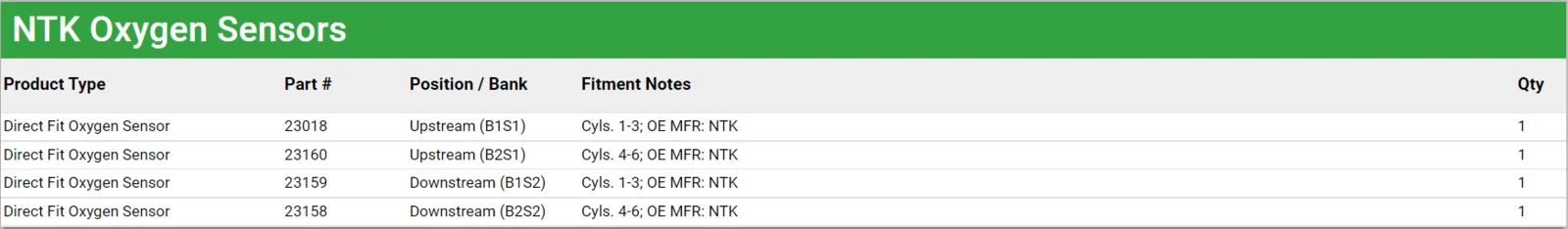

Hey @Chris could you maybe edit the first post to add the Federal Emissions model to the 2000 Model year and maybe put a note that Export is not the same even though it looks the same.
2000 Federal Emissions (Non-export)
NTK #23122 - Bank 1 Sensor 1 (Upstream)
NTK #23099 - Bank 1 Sensor 2 (Downstream)
Found the 2nd o2 sensor, and thank you for clarifying the part numbers. Mine are exact configuration as you stated, 1 before the cat, 1 right after. No mini cats, and no additional o2 sensors further upstream nor on the manifold. Thanks!
