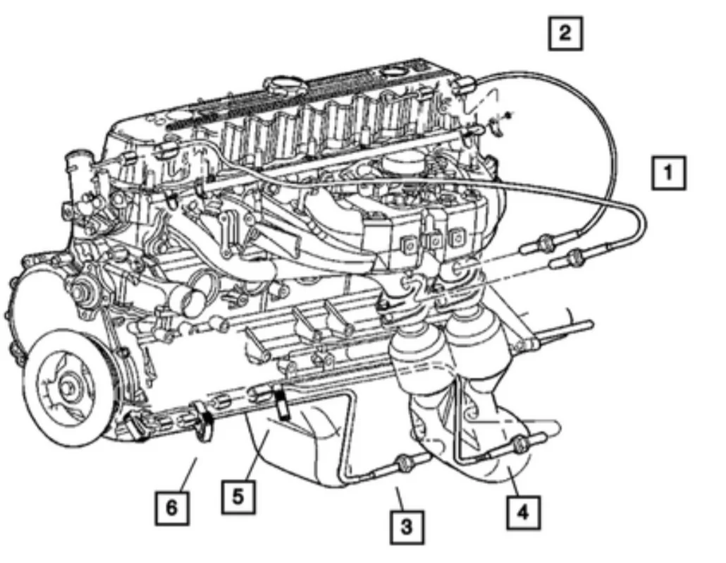

What are Bank 1, Bank 2, etc.?
Since this question pops up from time-to-time, here's an easy to follow diagram that illustrates what they mean when your OBDII code scanner (or manual) tells you something like "O2 sensor, Bank 1, Sensor 2":

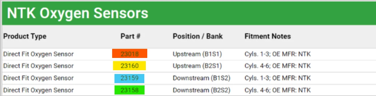

2005-2006
NGK #23018 - Bank 1, Sensor 1 (Upstream)​
NGK #23160 - Bank 2, Sensor 1 (Upstream)​
NGK #23159 - Bank 1, Sensor 2 (Downstream)​
NGK #23158 - Bank 2, Sensor 2 (Downstream)​

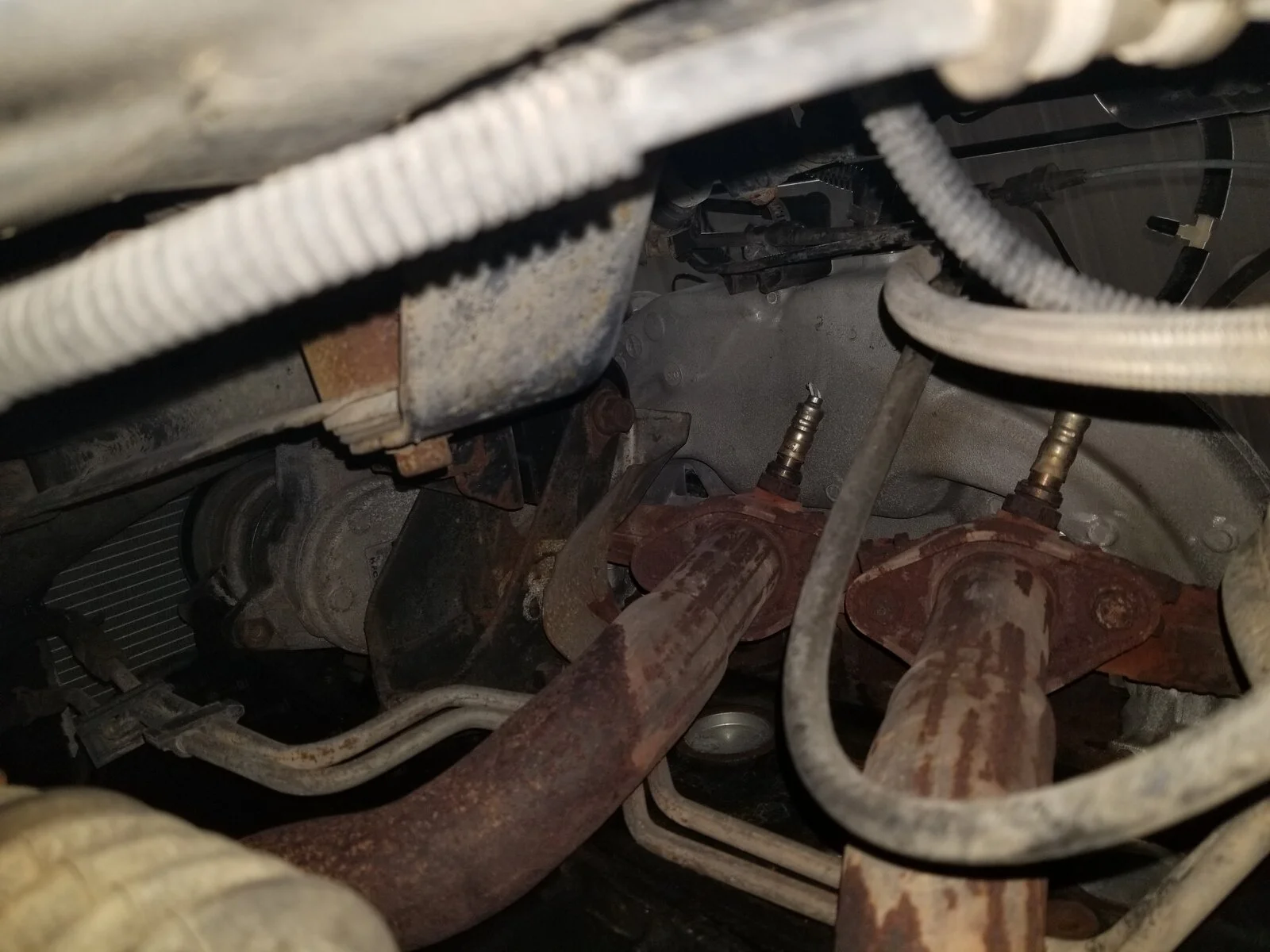

I'm buying a 2000 4.0/auto and it doesn't have cats coming off of the exhaust manifolds. It has two oxygen sensors in the pipes, but the wires are cut off, and i can't find any plugs for them to plug into. There is a sensor just before and after the cat down below, would it be possible that they just put a couple old sensors in to plug the holes in the manifolds? There are no codes and the check engine light isn't on.
2000 Fed Emissions TJs do not have the pre cats.
It could be that someone bought and installed a CA emissions manifold not knowing there was a difference.
Boojadean
Oct 1, 2022
12
Albert Lea, MN
I'm thinking what happened is they may have replaced the manifold, but didn't have plugs for the oxygen sensor holes so just used old sensors. I wasn't aware that there weren't pre-cats on a 2000, but it makes sense.
