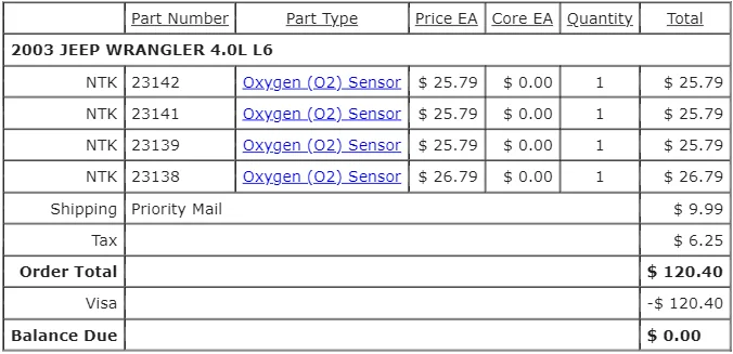

Hope you have good luck with them. I needed a couple new bank 2 sensors for my 03 and RockAuto had all 4 NTK, so I snagged them up. I thought seriously about getting a second set and still might. All 4 cost me $120.40
