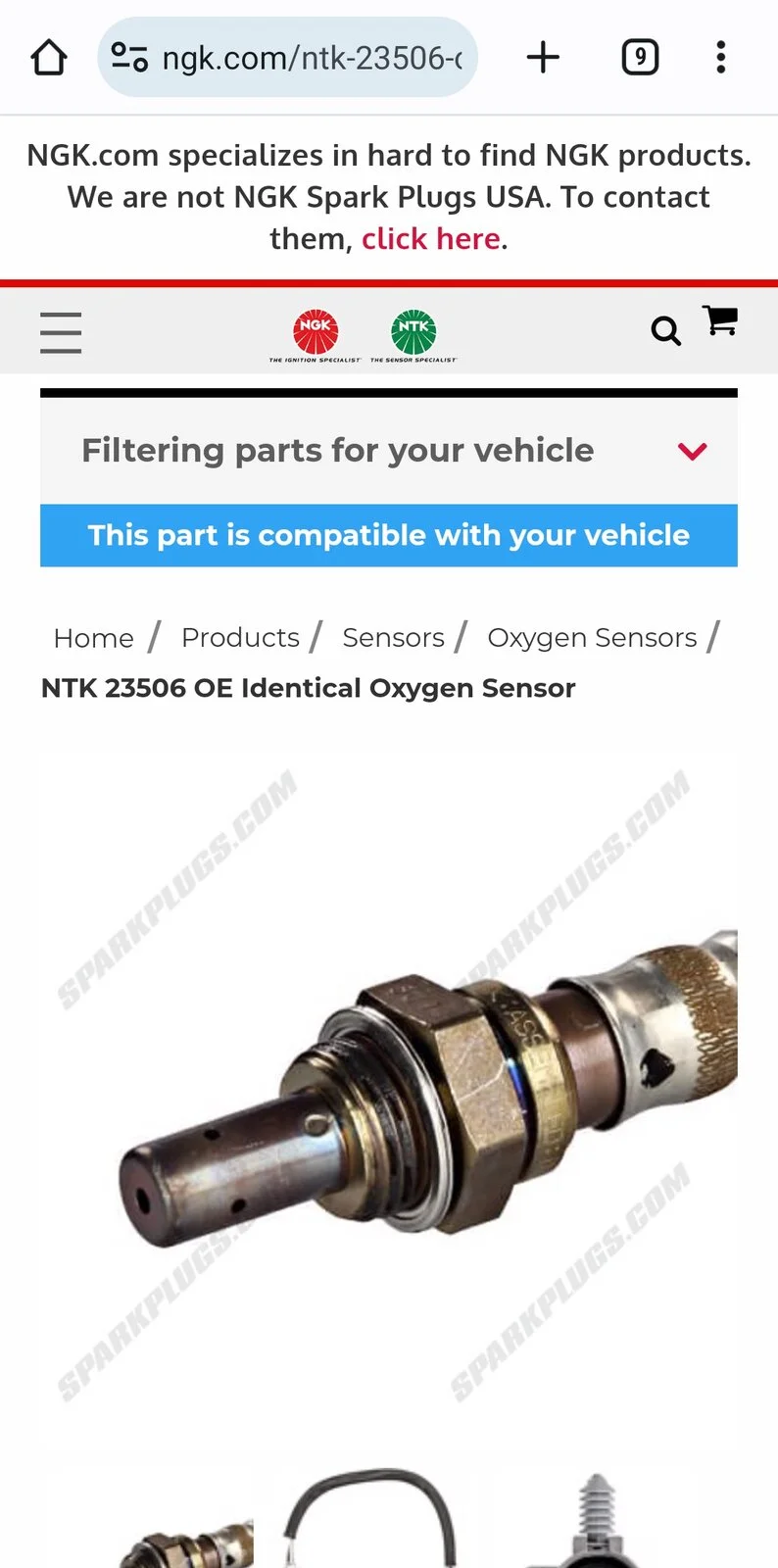

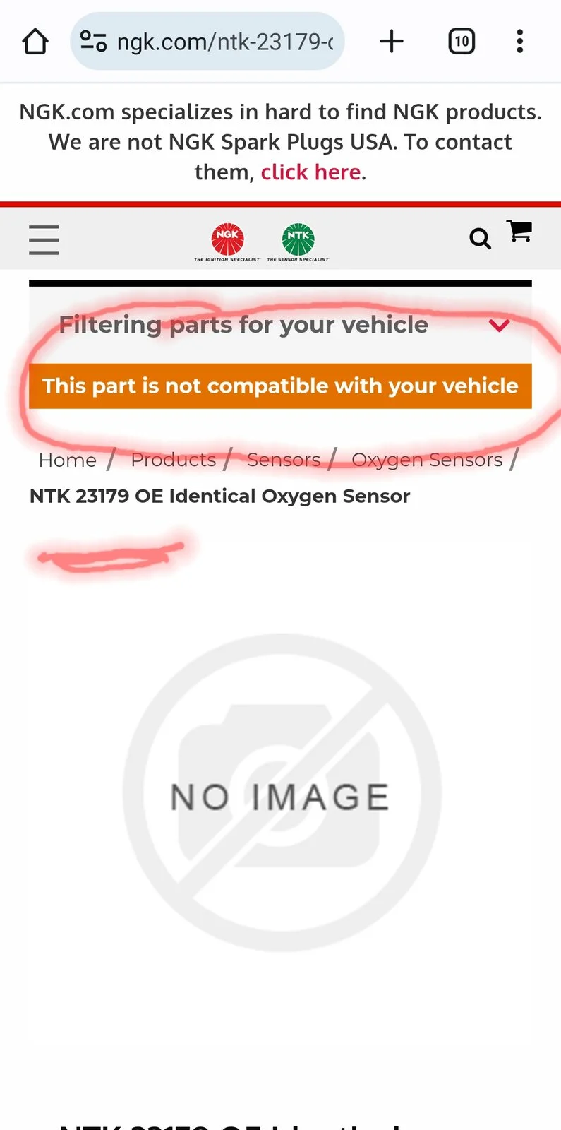

Just a small observation that i thought of sharing with you guys. Even though NTK confirmed that 23179 is the replacement upstream o2 for the discontinued 23506 i have noticed though is that by using their compatibility tool it says that is not compatible with my 2.5l 1997 tj 🤣.
See below:
While NTK23506 it says is compatible with my car then how is it possible the 23179 showing not compatible if its a replacement model??
Nevertheless i have send them an email to confirm and i will let you know if its just a bug of the website.
If i dont get a clear answer i might be going for the Denso sensors as some other tj owners confirmed they worked fine for them.

I would trust their techs over what the website has to say.

Techs verified fitment and also told me that the site is wrong. I already installed one and it is fine. Upstream 97 2.5.

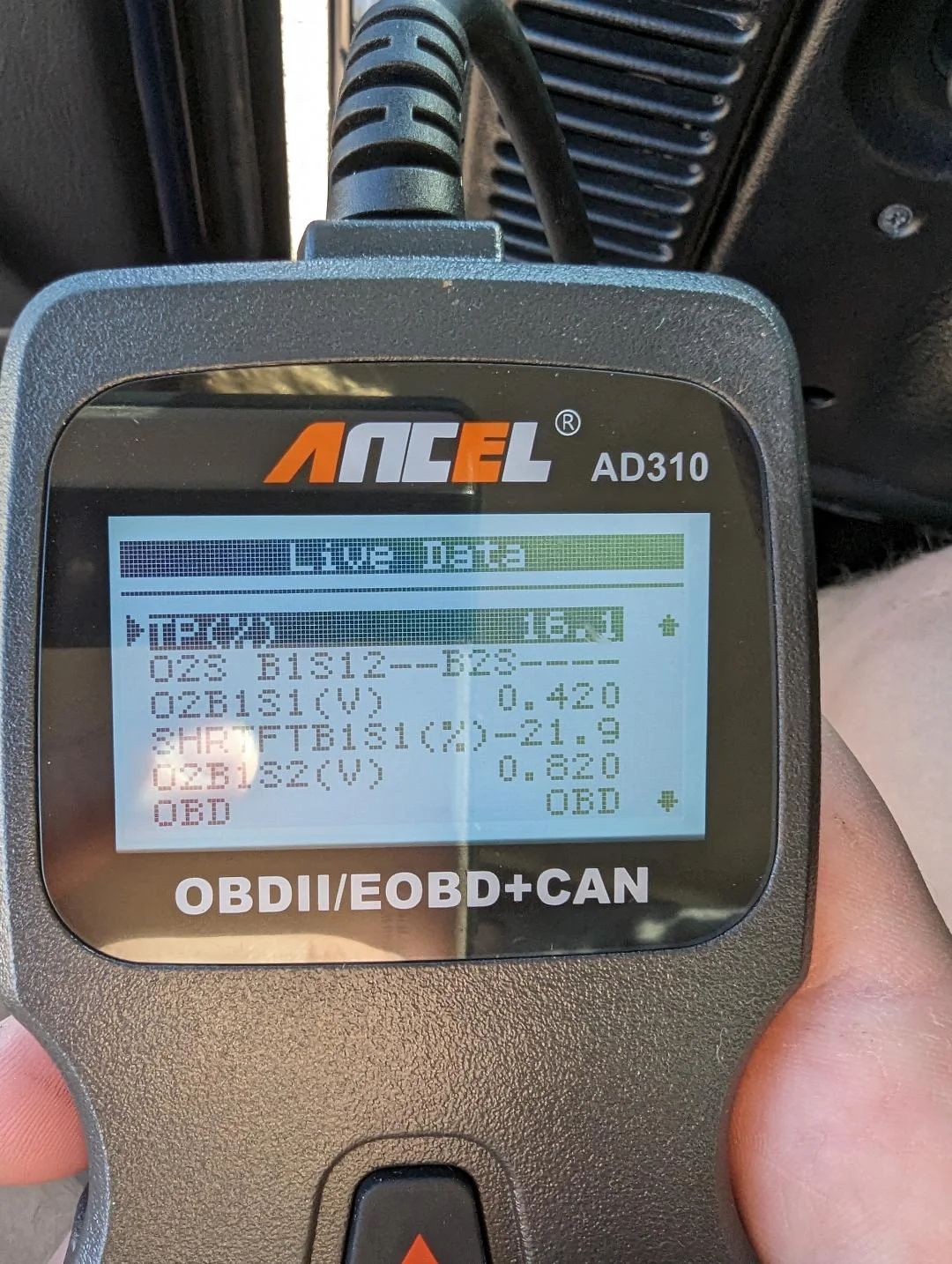

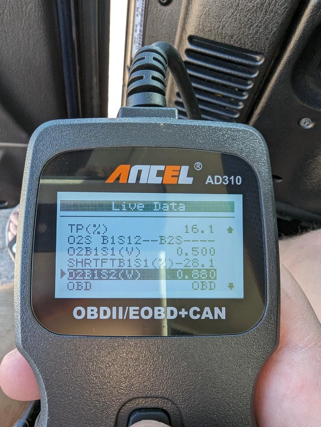

I just went out with the code reader and got values under .9v
I've only owned this vehicle for about a month. Gas milage is around 9-10MPG but that seems lower than what others are stating 16-18mpg. my tires are 255/75/r17 and my speedometer is accurate maybe +2MPH
No leaks from the downpipe back. I haven't checked the headers yet as the manifold is blocking it.
Sorry new to jeeps my previous vehicles were Subaru and somehow it seems TJs are more picky than a WRX.
