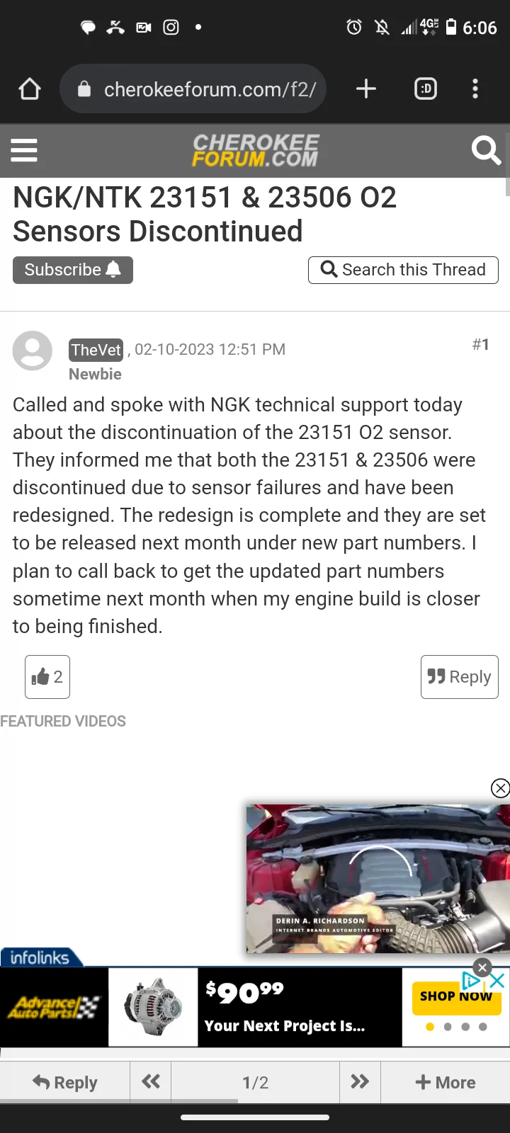

Found something recent on a Cherokee forum about 23506 getting replaced with a 23179. When I look at 23179 the plug doesn't look familiar on the stock photos associated. Could be photo doesn't represent the product, I also could.juat be unfamiliar with this year's upstream, haven't had to mess with them yet.

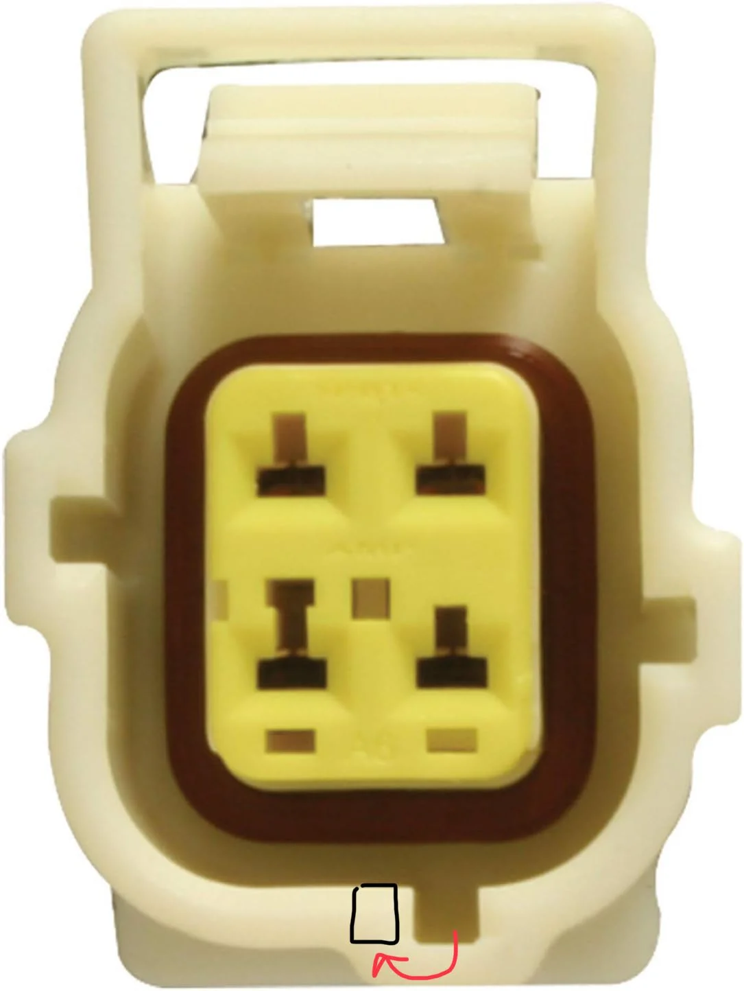

Did anyone else have issues with the 23141 for bank 1 sensor 2? I have a 2004 TJ and the harness didn’t quite fit right. The new sensor plug had a slot that was off centered. I had to shave off the male edge of the existing harness to get plugs to connect. Made me think I had the wrong sensor… but don’t think I do. Seems to be fine.
looks like I have the wrong sensor. Should have been 23132. Will this be a problem? Should I correct?

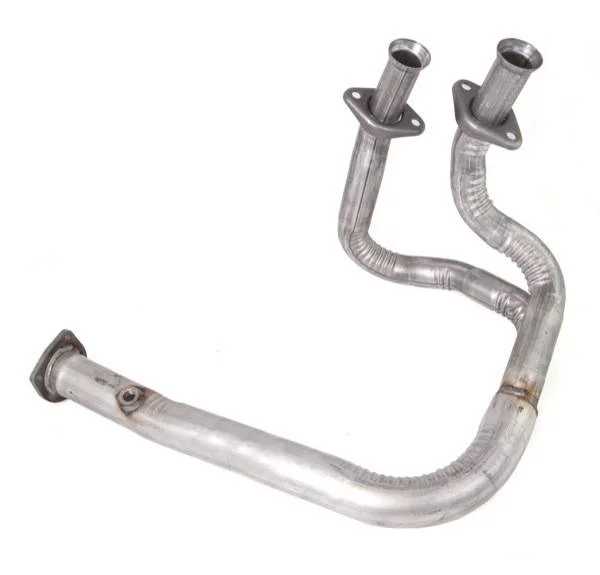

I can't remember if the VIN decoder will show if it's Fed or CA... But if yours was a CA emissions all 4 of the sensors would be visible from the driver's side looking down 2 above the pre cats 2 just below. The Fed emissions upstream is just before the cat.
This is what the 2000 Federal emissions (and export models) Exhaust Head pipe is supposed to look like. The pre-cats were only on the CA emissions until 2001.

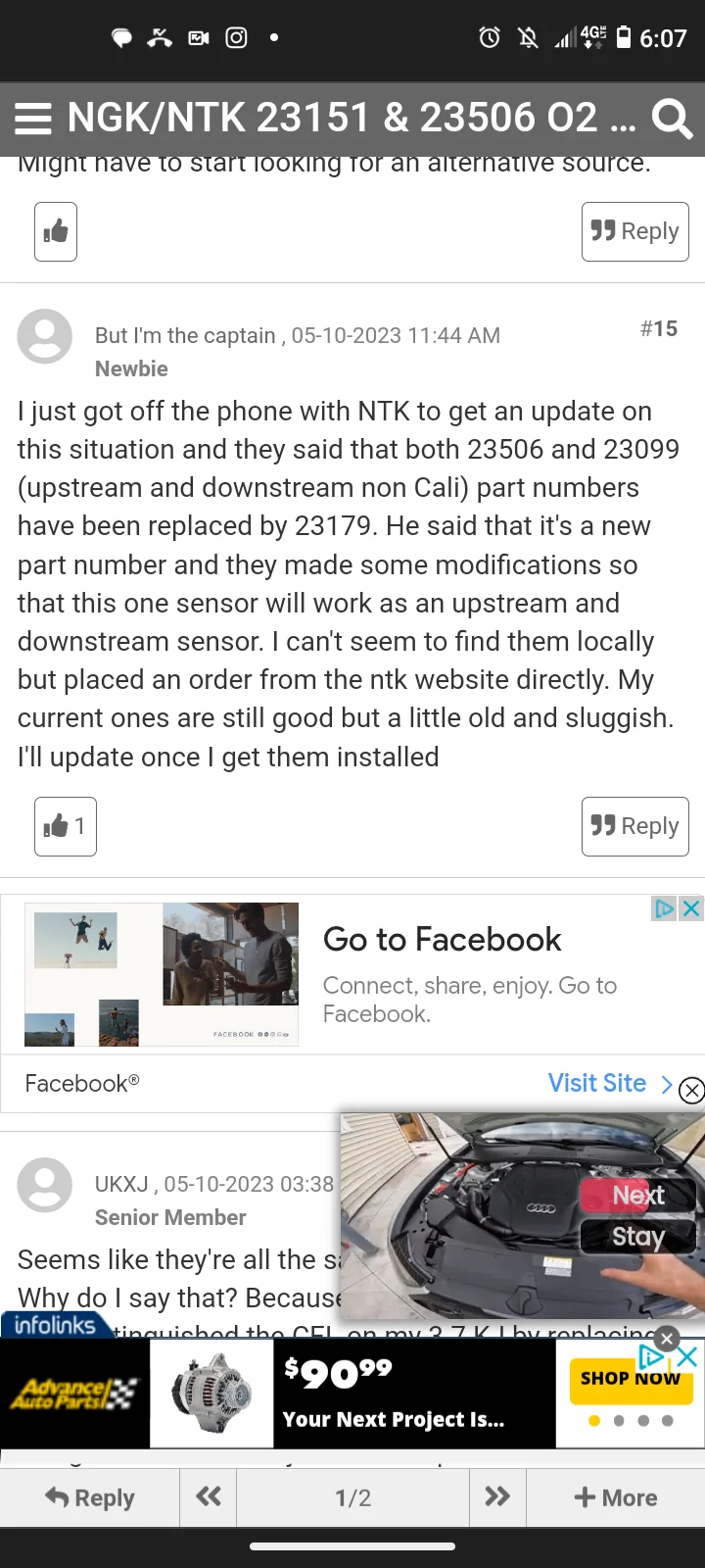

I thought I remembered someone posting about an update to a couple sensors, and it's just a few posts back on this page.
your down stream should be the 23099 and according whom ever made the post that was screen captured NTK replaced that sensor and another with an updated part number, the 23179... You might contact NTK tech support to see if that's true or not..
https://wranglertjforum.com/threads...-tj-oxygen-o2-sensor-thread.4068/post-1384035
Ok, the upstream sensor is right before the cat like in that head pipe image you shared, so mine's gotta be Federal. My head pipe is shaped the same but there's not a bolt-on flange before the cat. It's all welded as one piece until you get to the muffler. I wonder if mine is aftermarket?
In any case, it sounds like potentially the 23099 or the 23179 would work?
