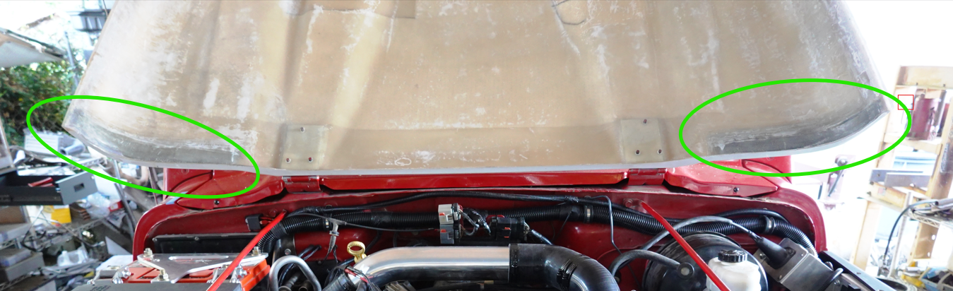

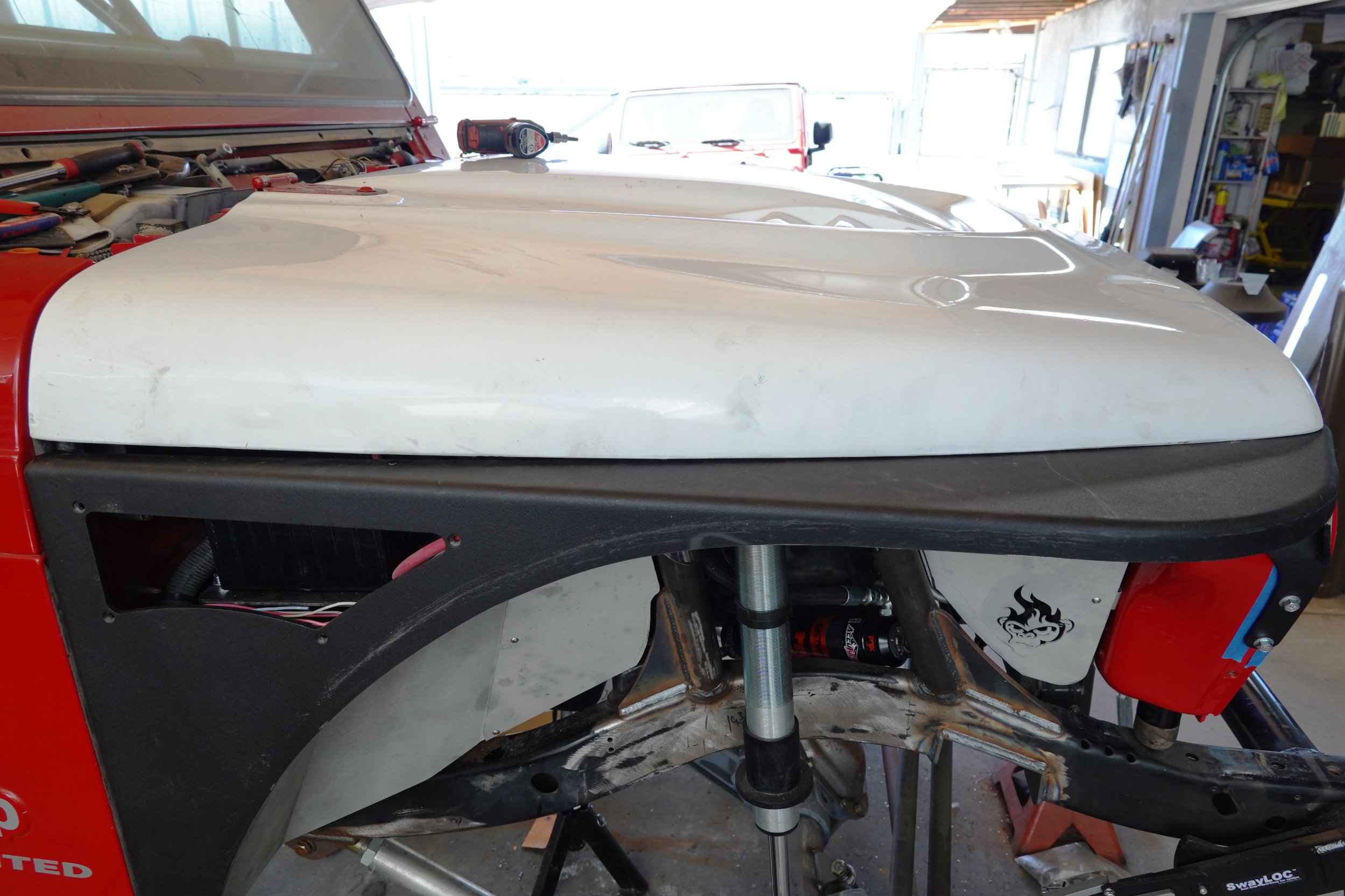

Out of the box-
Note rear corner curvature doesn't match shape of cowl. We glassed in bent pieces of SS flat bar we used to correct the shape to push the sides of the hood out. We corrected the lower flange as well.
All of which is the only way you can arrive at this.
Given a choice, I'd find someone who could do the work on a steel hood for under 1500 bucks and never touch another glass hood ever again and the ones that GR used to sell make this one look almost perfect. For reference, a buddy bought one, it fit very poorly, he called GR, they said bring it back. When he got there, they had him offload it into the dumpster before they would give him a new one.

Out of the box-View attachment 654106

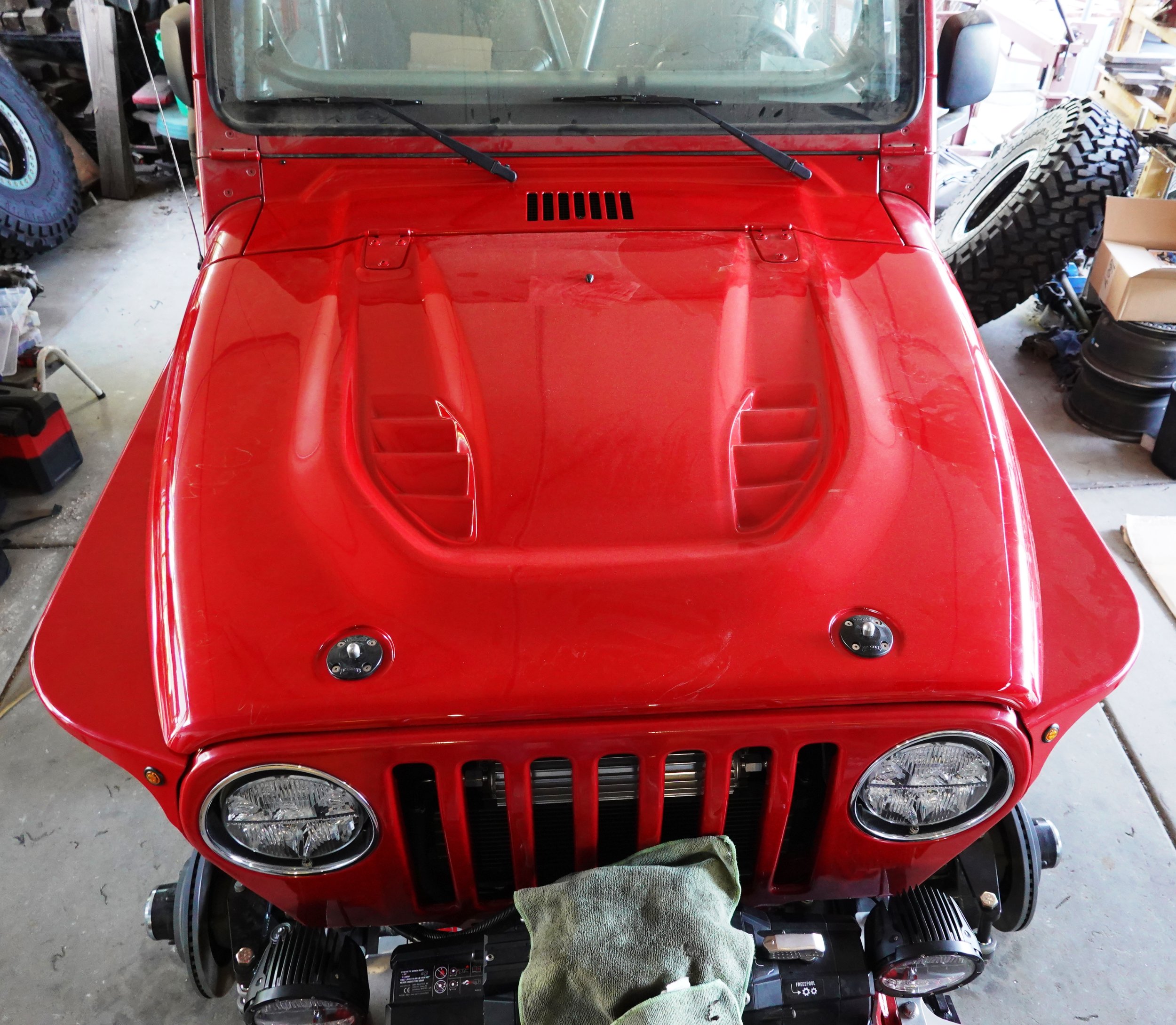

I wasn't clear that is not a GR hood. It is done by a local trailer supply as a sideline. 50% of them fit out of the box, the rest are lots of work to get acceptable. The last 3 we bought were 450 each so they are okay for the price, not okay if you are picky.
Reactions: Mike_H
Get close to the final cut line with a fine grit disc. Then hand file to the line. Then paint.
This is what I’m going to do. File it nice and even and then paint and clear.

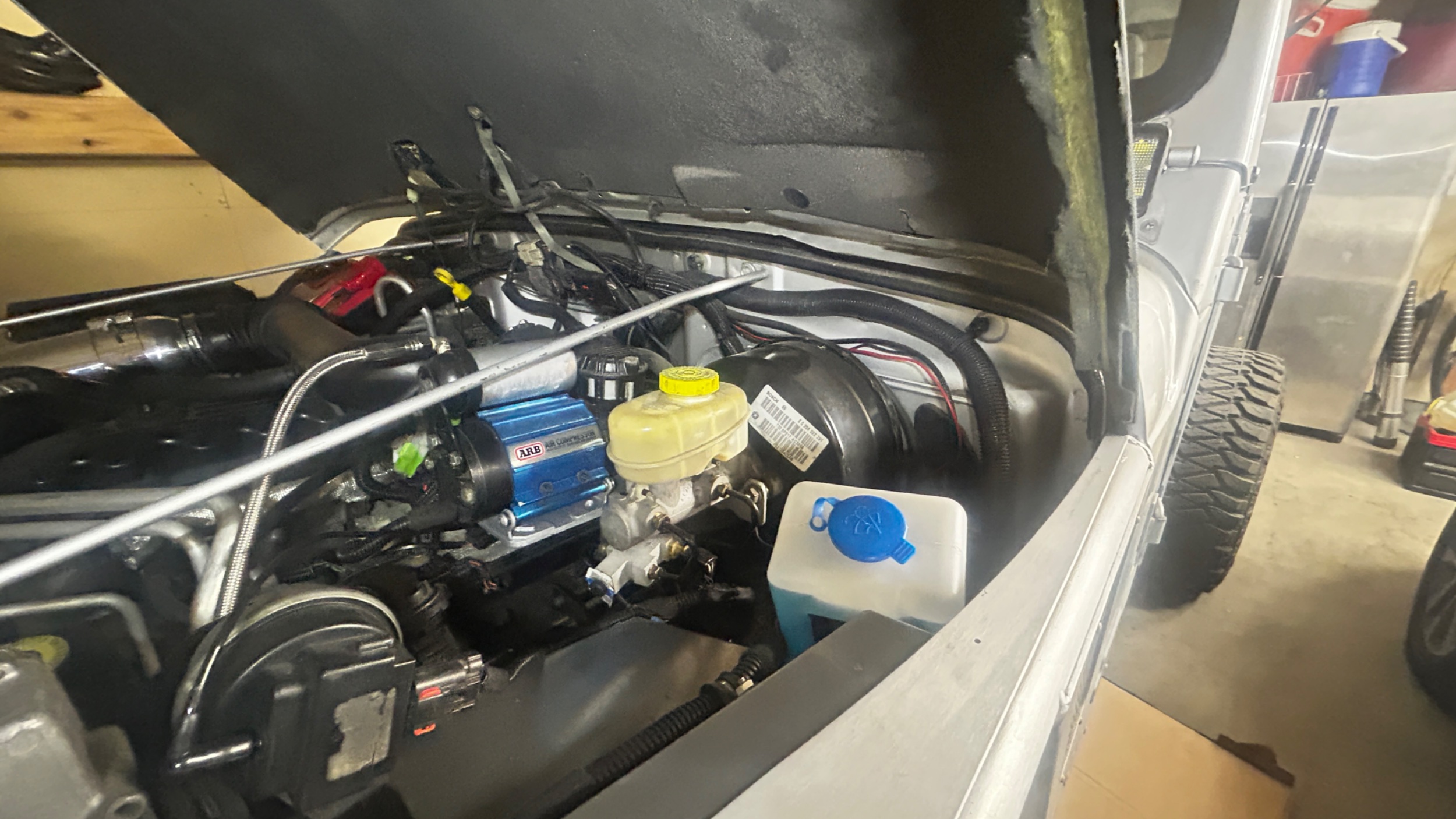

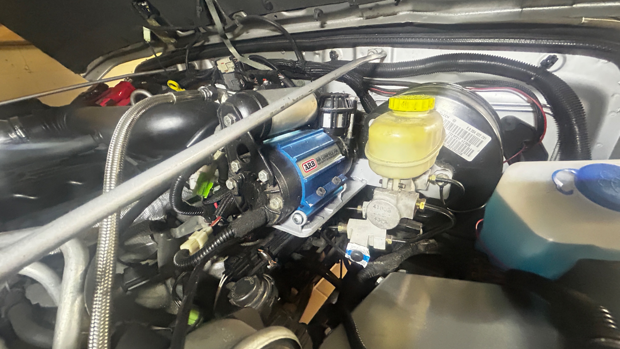

Left space for PSC Hydro Assist. New windshield washer reservoir. Splice one wire into factory harness and ground the other. Works great. New vacuum tubing on the cruise control module. It was brittle and breaking. You can see the ARB compressor, which has been relocated here onto a bracket that I fabbed. I have some O-rings on order because it’s leaking at one end of the air reservoir. Adel clamps securing the harness which is all cleaned up and re-loomed.

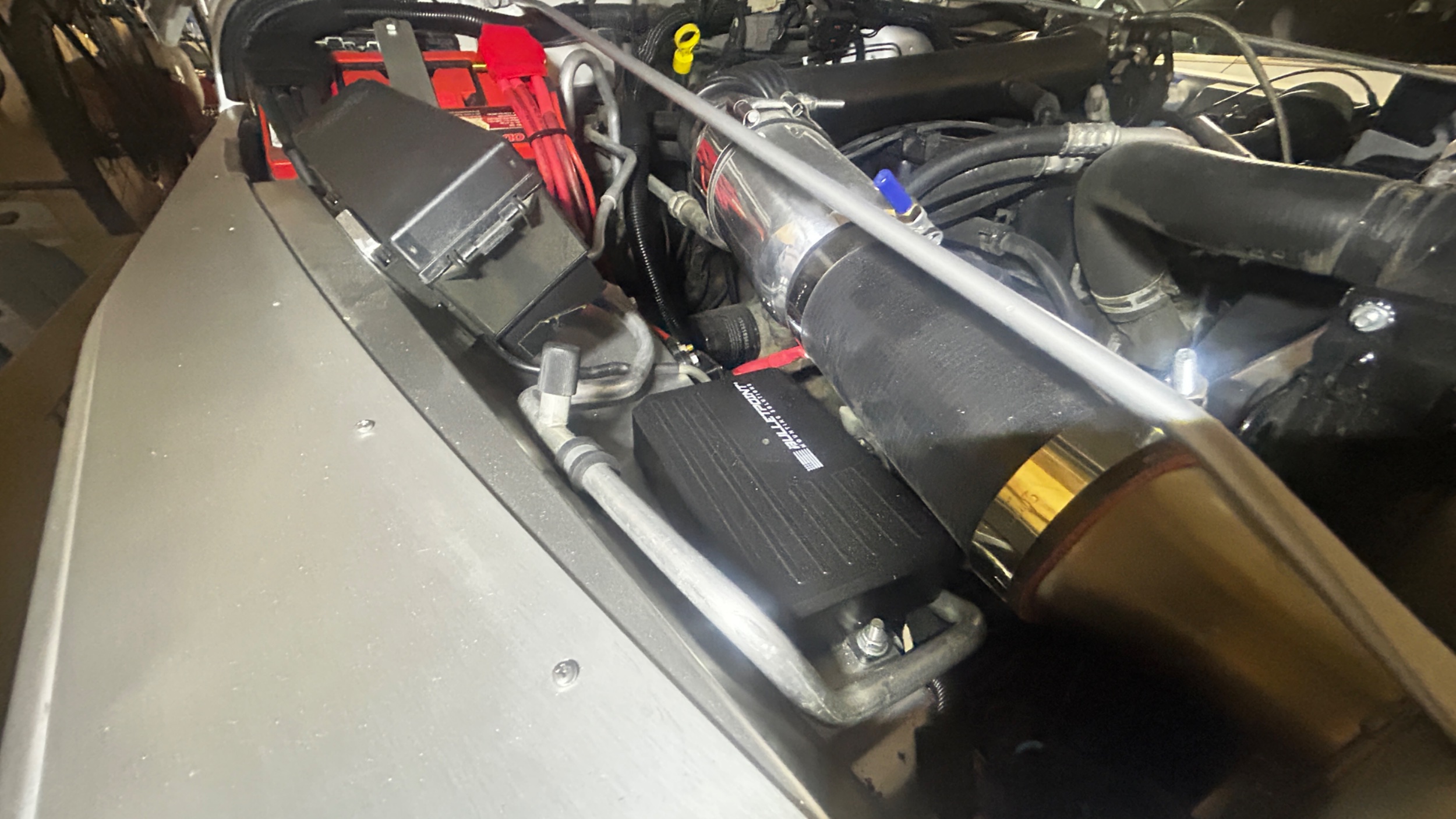

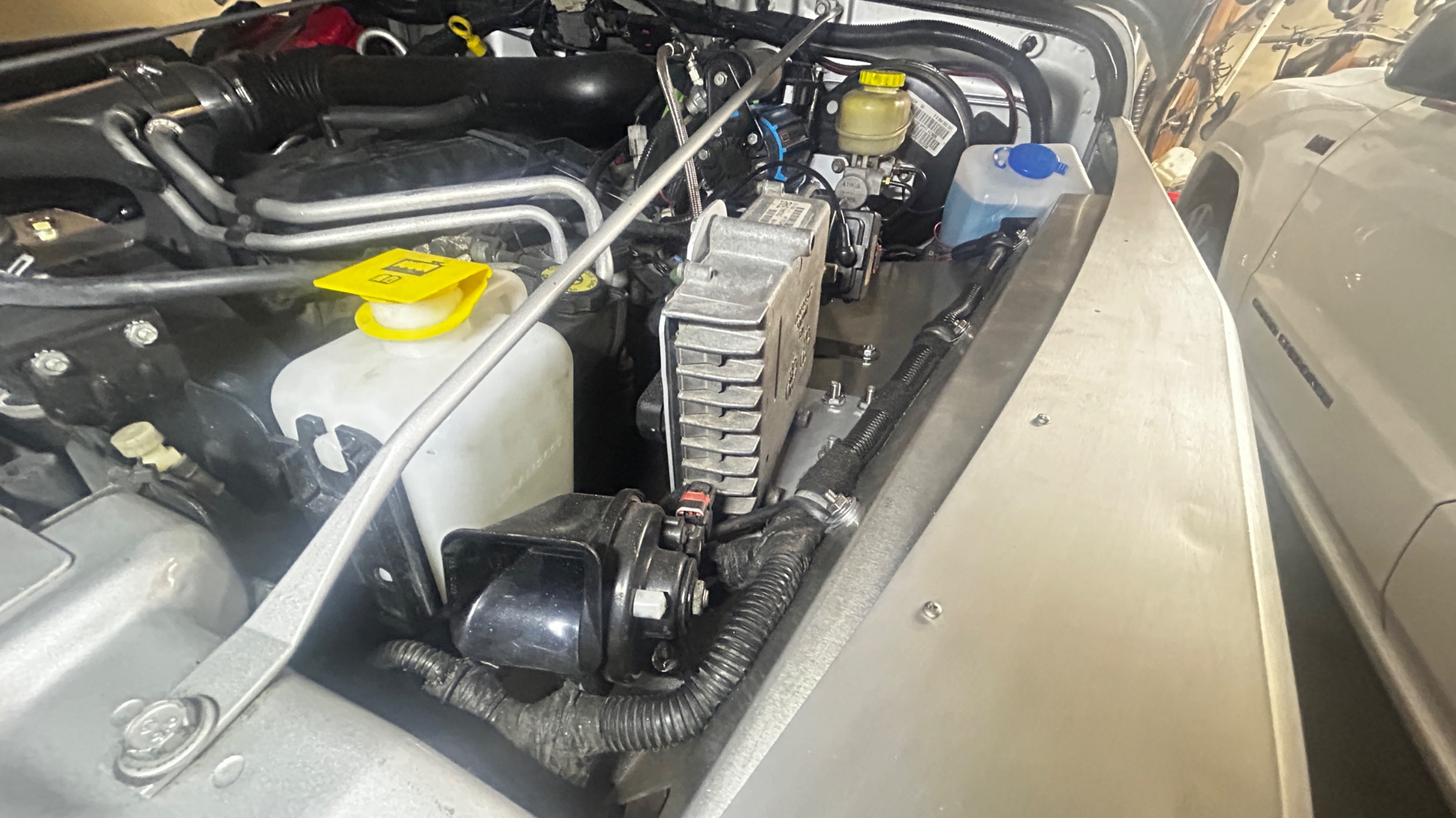

Fabbed up a bracket for the TCM. Horn just barely fits, but it’s there and pointing forward. I rotated the bracket so that it’s underneath the horn rather than sticking out to the side.
Here’s a better view of the ARB compressor and the space for the PSC Hydro assist.
I routed the air Chuck out here and intend to make a little bracket to attach under one of the bolts on the Fluxor bumper.

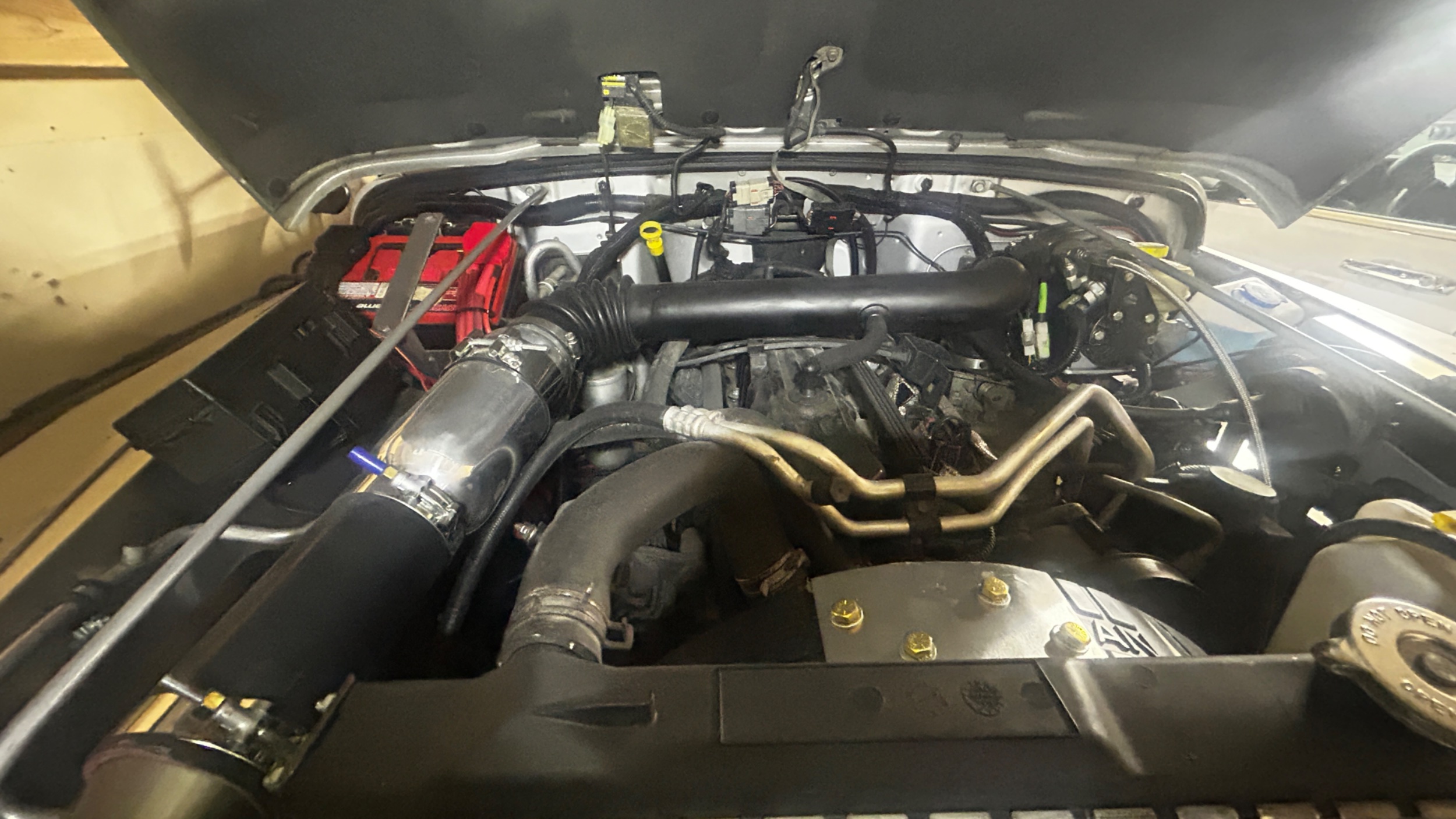

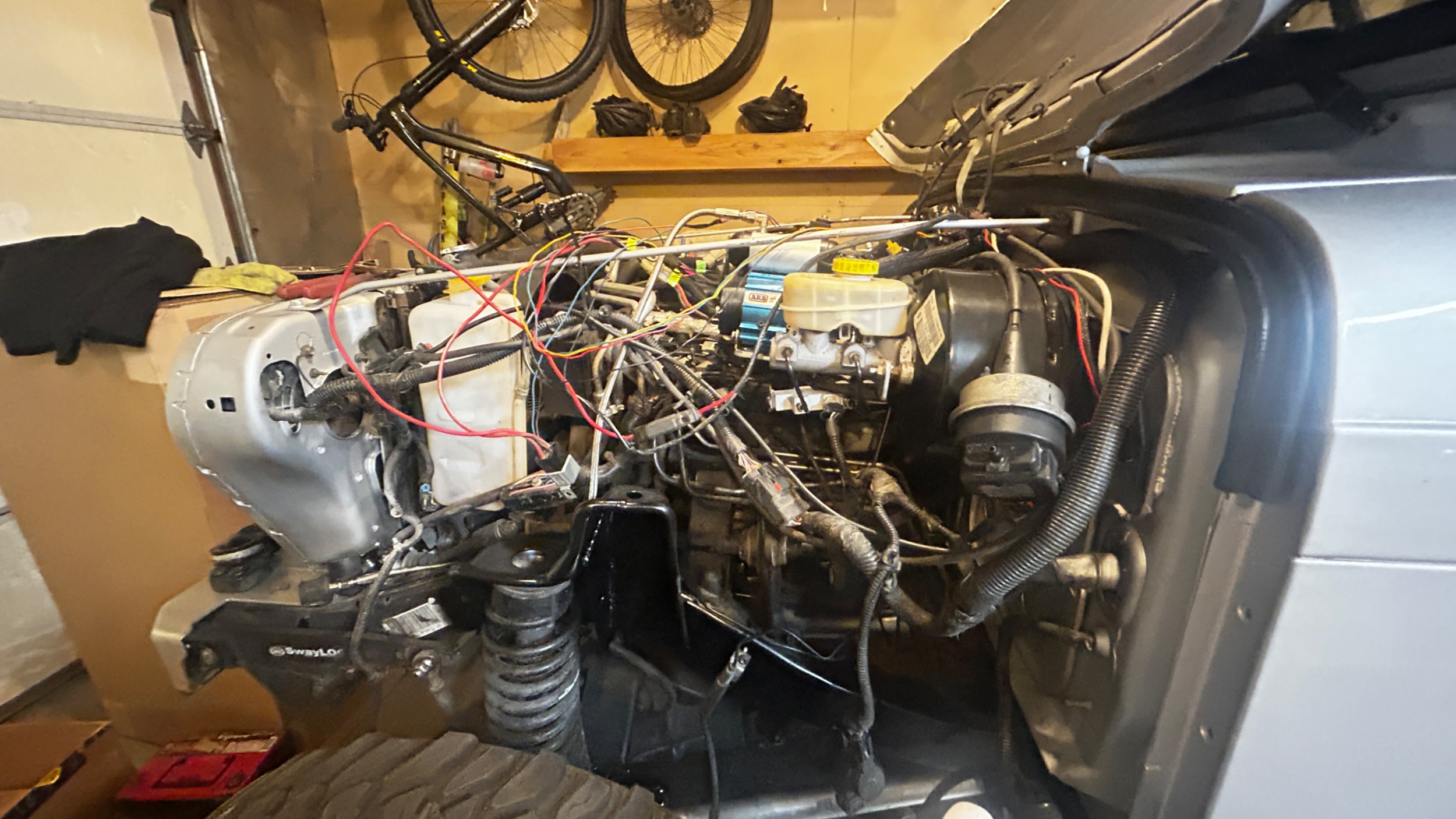

Full picture of the engine bay. The fan shroud was completely cracked and I was not even able to remove the coolant overflow tank. So, I fixed it with an aluminum piece and bolted it through the shroud and the fan clears by miles.

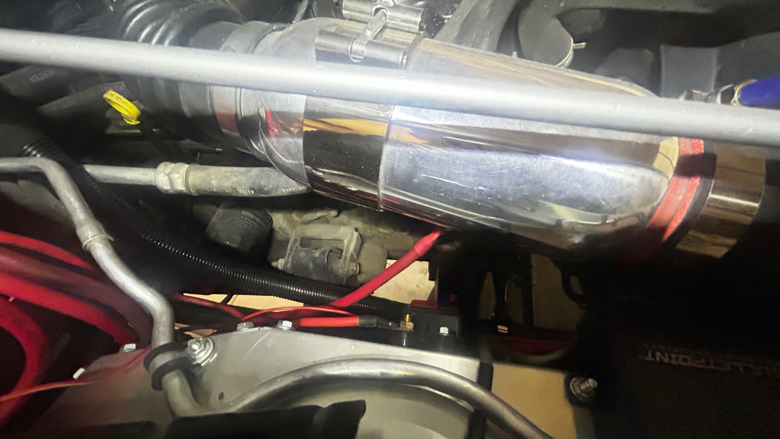

Spectra air intake with an oiled filter. 2” cold air intake above the headlight that quickly opens up to 3”. I shortened the silicone tube to make everything look nicer since the last time I posted about this. Thanks to @mrblaine for this idea though mine is not as nice as his. Did the best I could! Bulletpoint auxiliary fuse box needed rewiring and new location. Everything works.

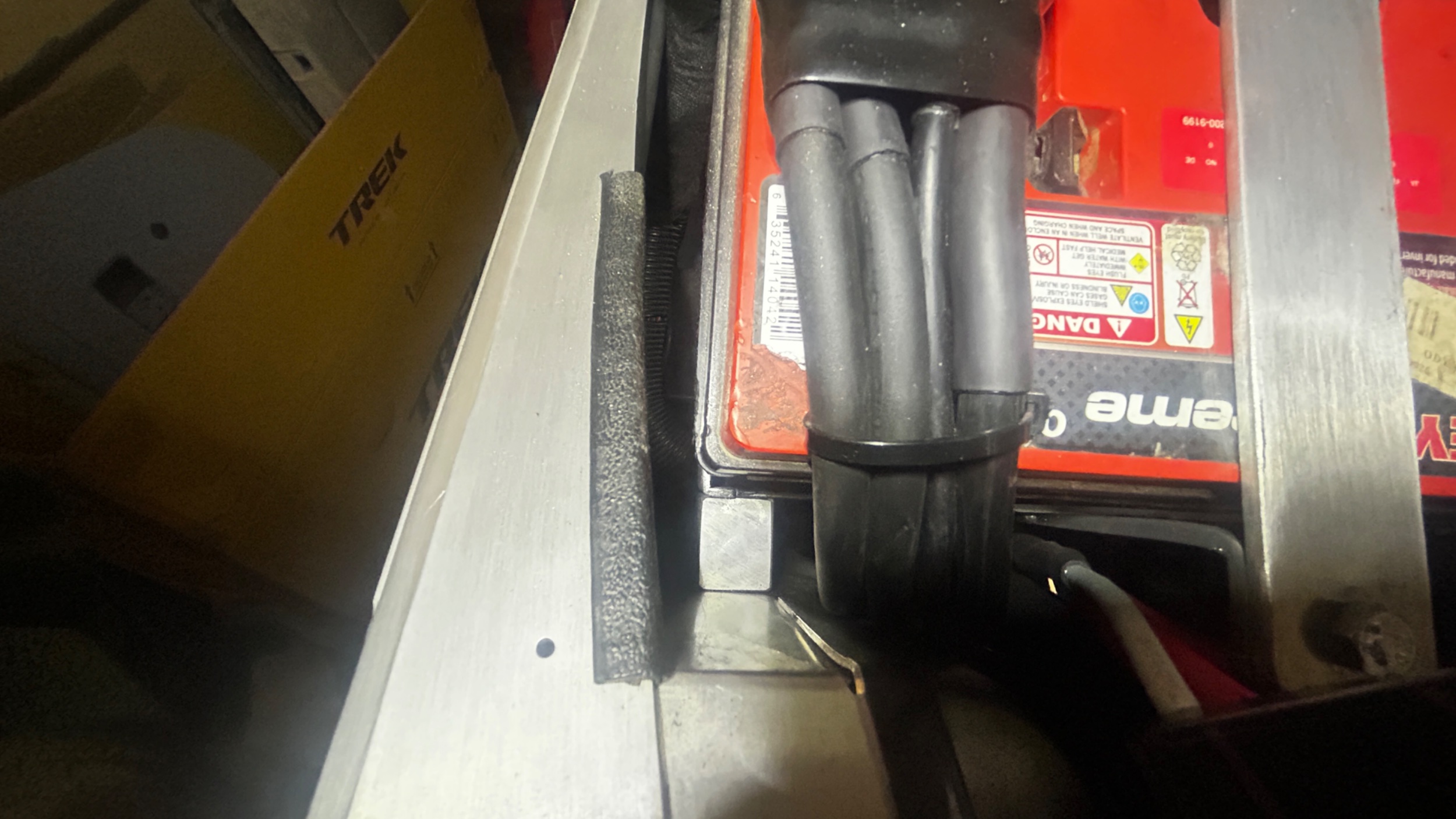

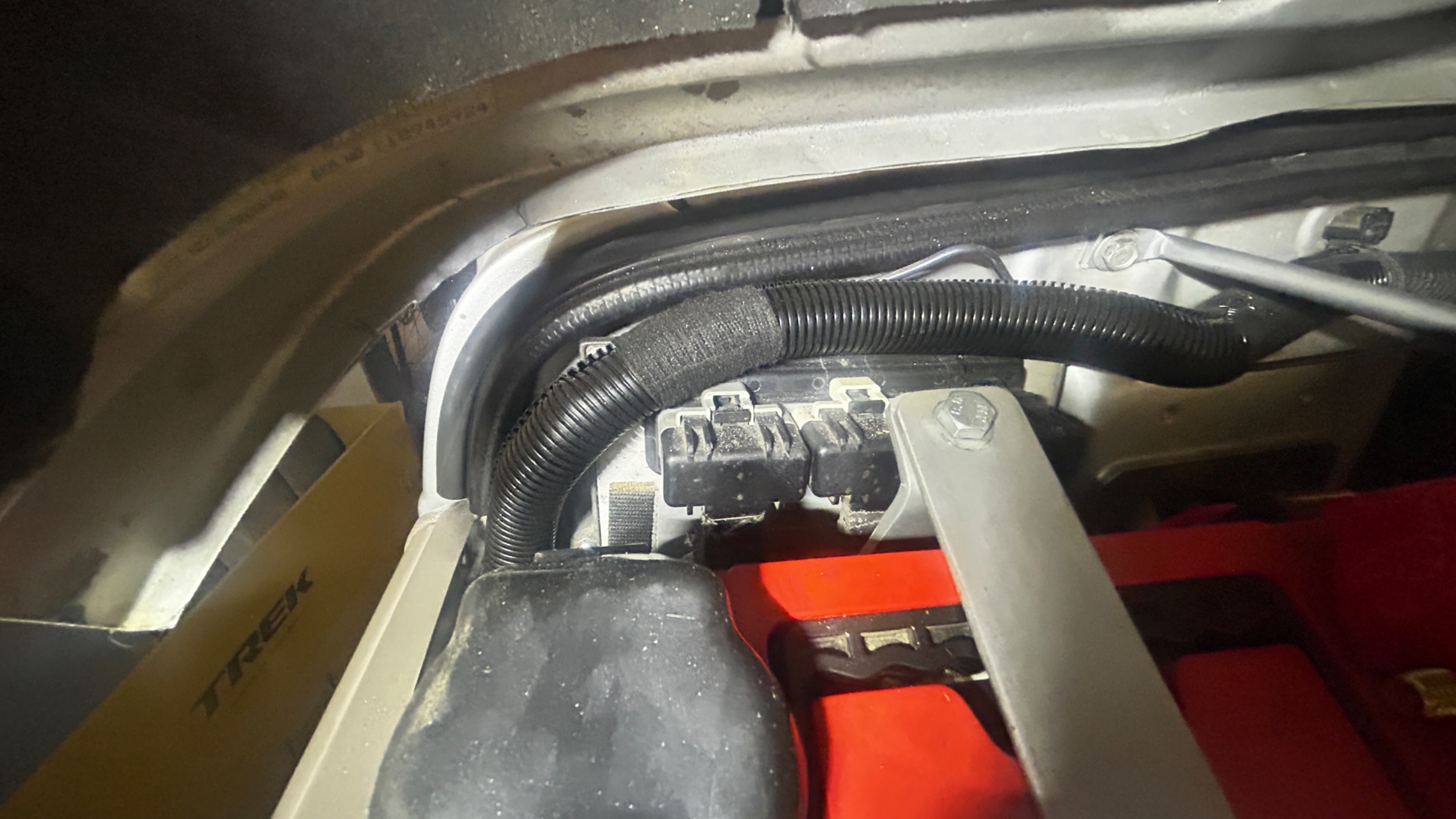

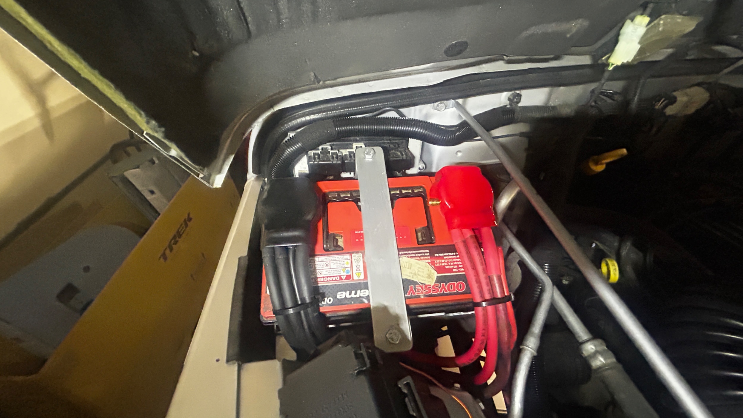

All new battery cables and military terminals. @Wildman was right about turning the battery around so the terminals were farther away from the fenders. Super clean and I’m really happy how it turned out. Thanks to @Lou. I left one bolt on the + terminal a bit long so I can add an amp later. Then I’ll cut it and tuck it in.

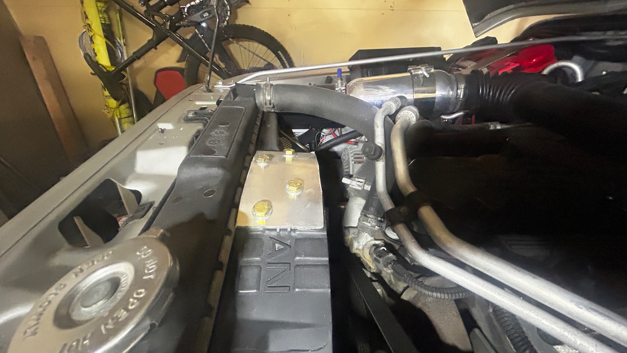

Battery tray is braced and bolted to the inner fender with a 1 1/4” block of aluminum. Thanks to @mrblaine for the heads up and insistence I brace it somehow. This turned out to be my best solution. Thanks to @jjvw for insisting on this too. I had no idea going in I would need to do this.
Custom battery tie down bracket welded to the tray with an aluminum strap. PCM is raised and flush on the firewall thanks to @Lou and @jjvw.

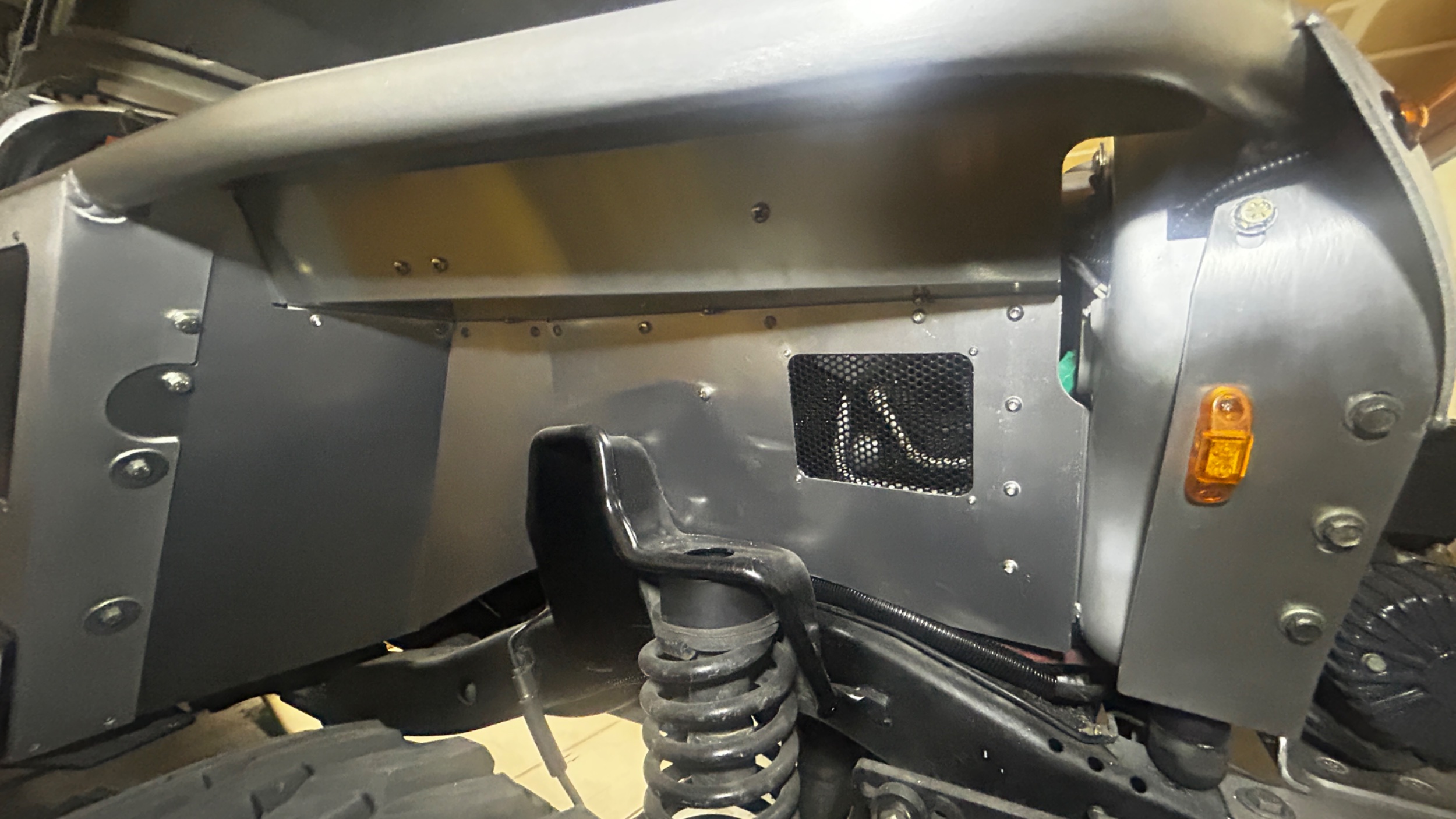

Just a glimpse inside the inner passenger fender.

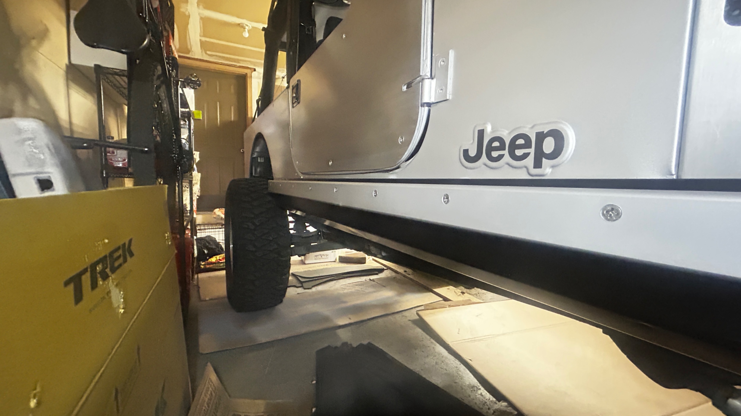

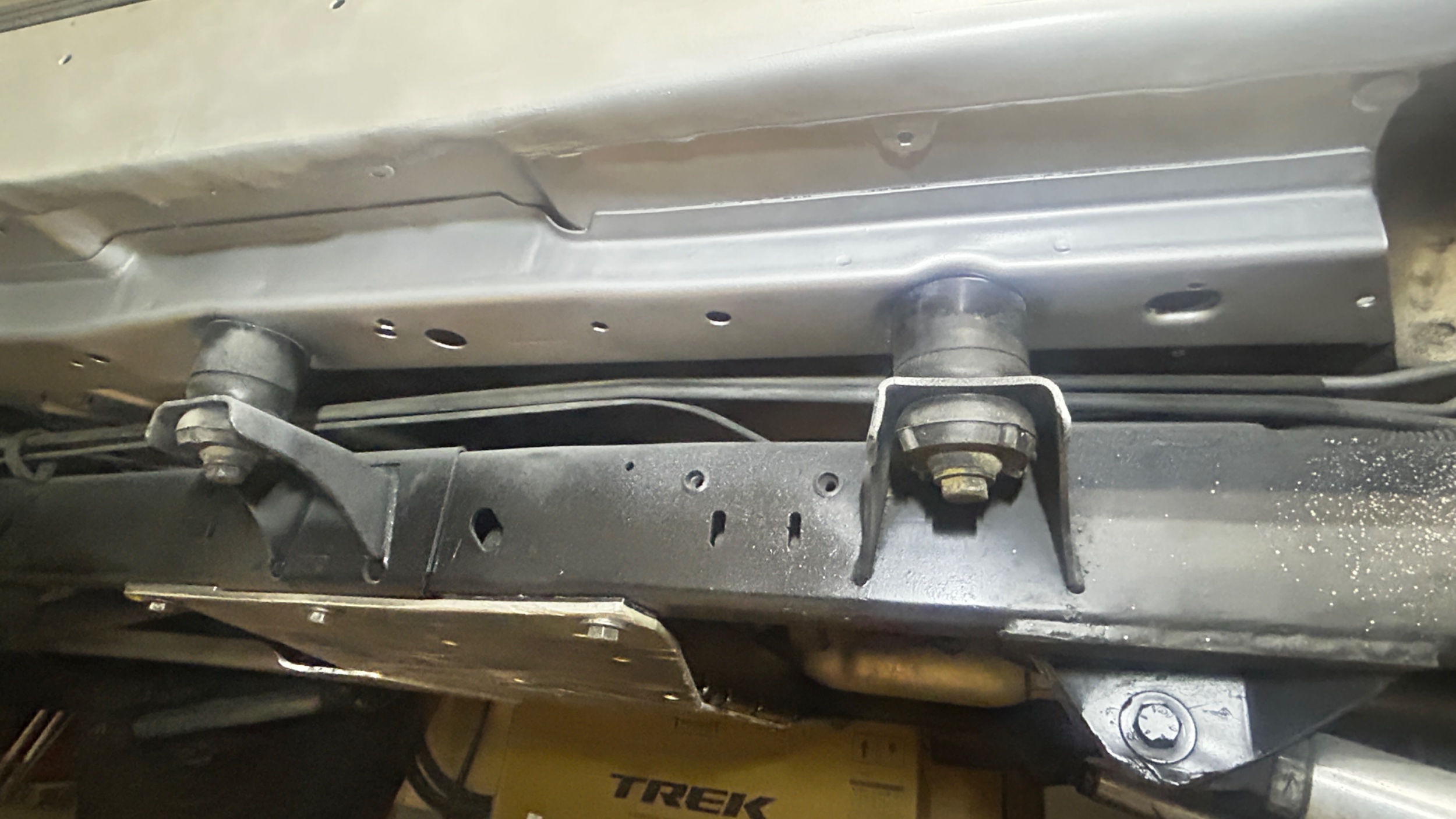

The sliders have to minimally be cut, but for these GR mini boat sides I cut off the DOM steps and followed @mrblaine design which @jjvw, @hosejockey61, and @rasband have done. Mike has a good how to video on BFH Garage YouTube channel. This modification is a lot of work but very rewarding. Got lots of time behind the mig gun and that’s lots of fun!
All the bolt heads are out so the inner fender well is clean. Painted the mesh panels black for some contrast with the silver. All the aluminum panels and fenders have Shark Hyde applied to them to protect from corrosion.

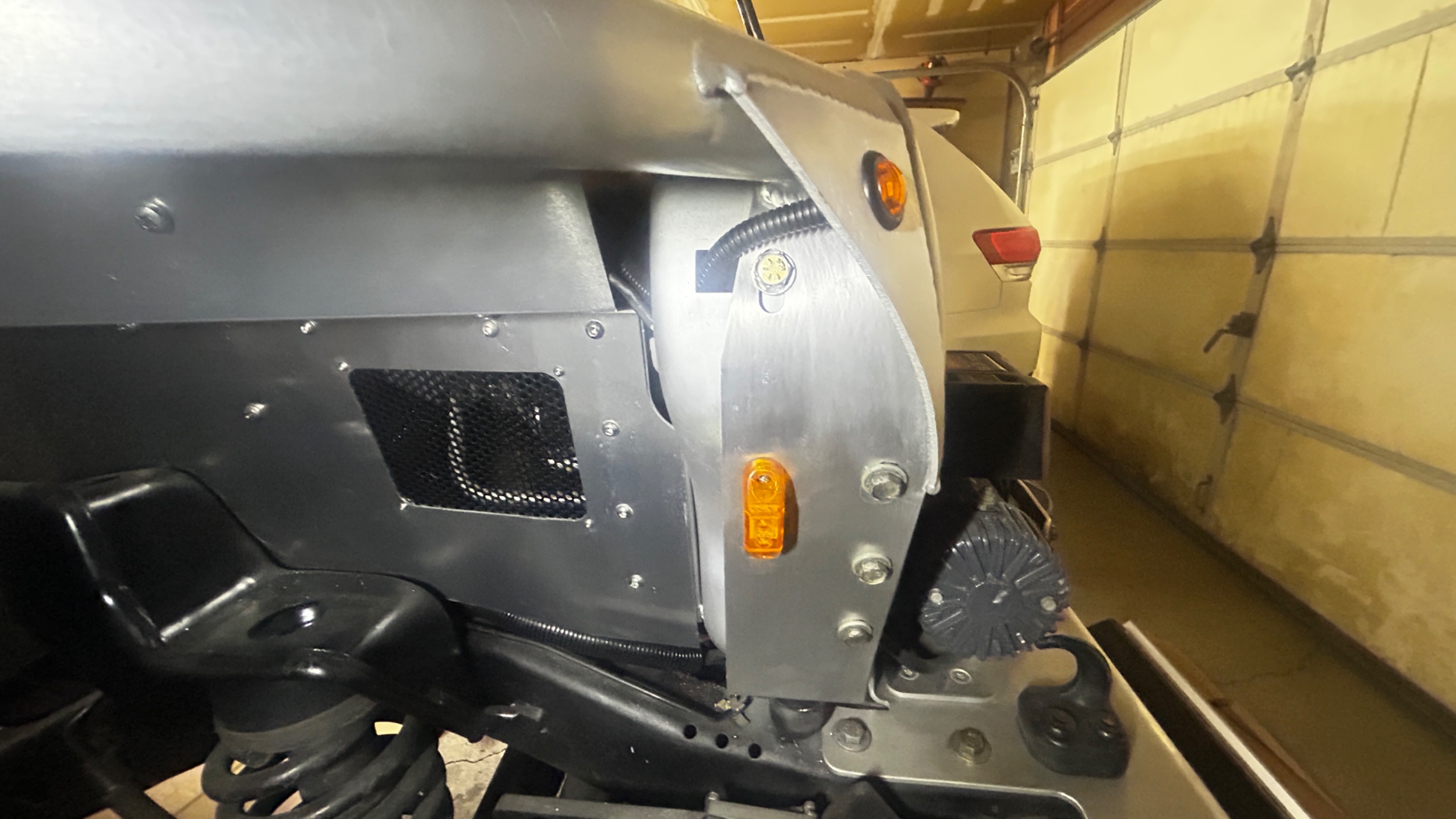

I used a 3/4” amber for the turn signal and the GR stealth side marker. I had all of them in the attic in a box from several years ago so just used them and did them my way. Not trying to spend lots of money. Not overly excited about the side marker but it’s easy enough to move.

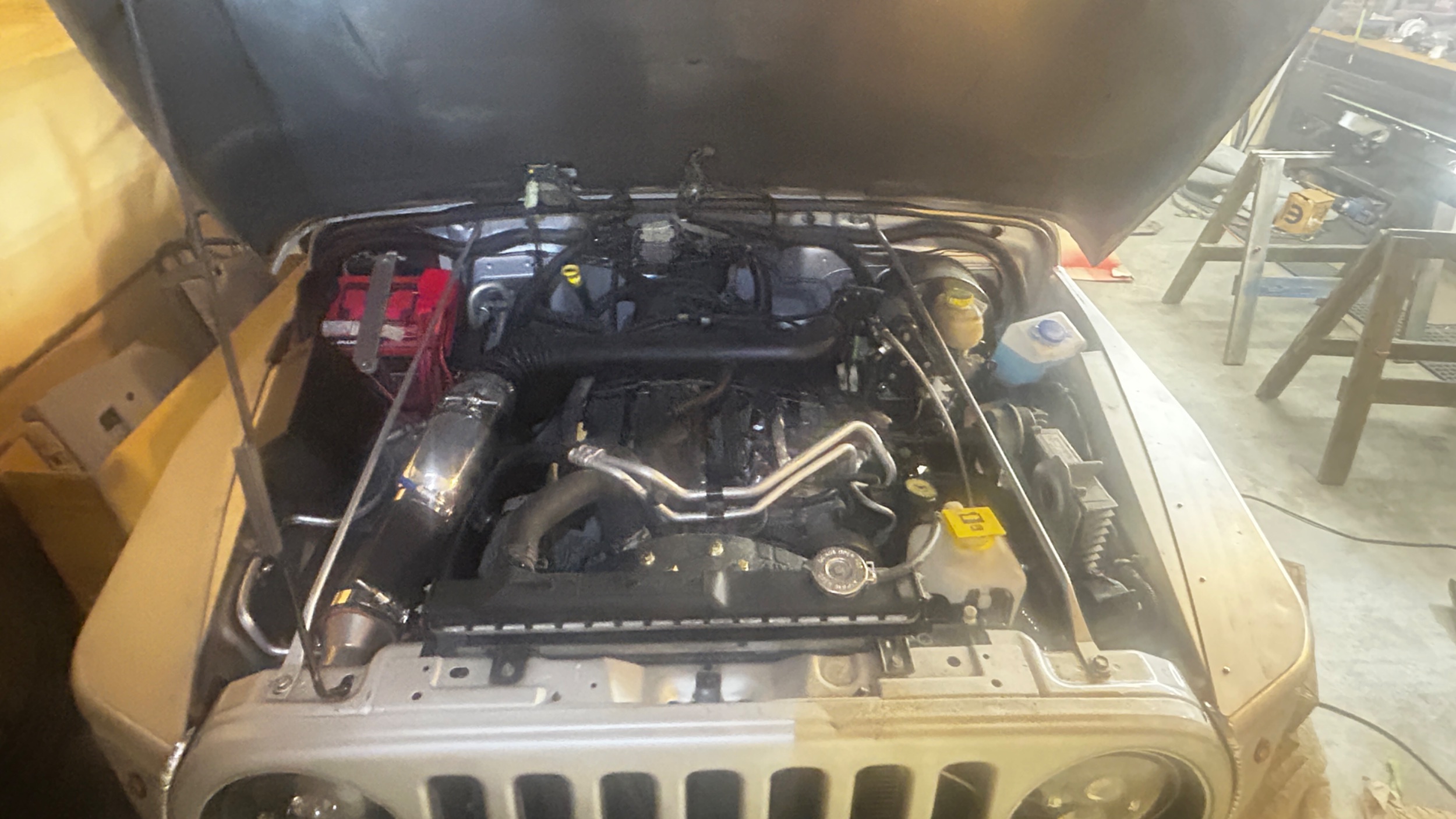

Pic of the engine bay. Hood is cut but needs more trimming and hood pins.

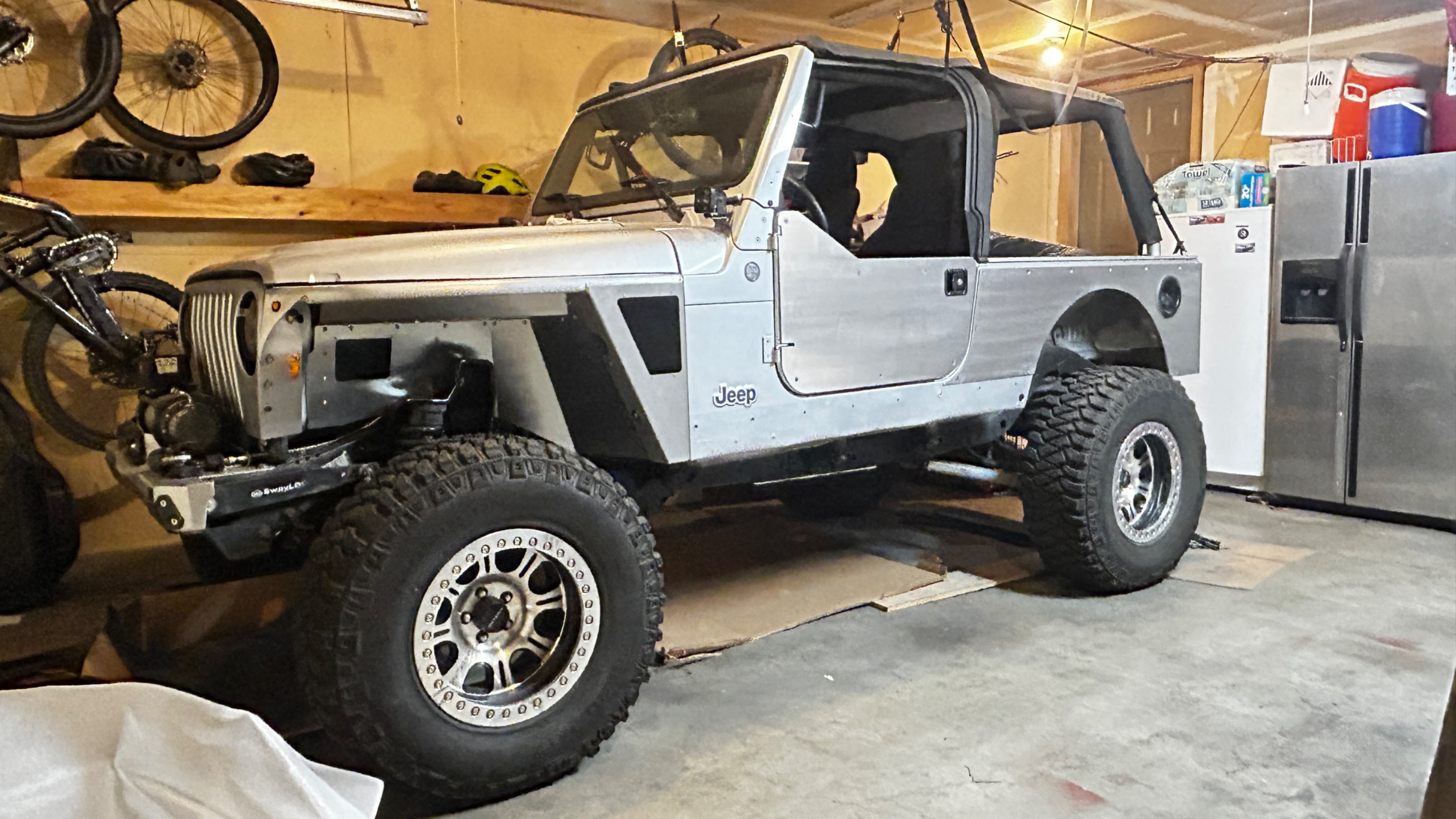

A pic of the Jeep but without the slider.
Halfway done!!!
I routed the air Chuck out here and intend to make a little bracket to attach under one of the factory bolts, holding on the Fluxor bumper.
Full picture of the engine bay. The fan shroud was completely cracked and I was not even able to remove the coolant overflow tank. So, I fix that up with an aluminum piece and bolted it into the shroud and the fan clears by miles.
The sliders have to minimally be cut, but for these GR mini boat sides I cut off the DOM steps and followed @mrblaine design which @jjvw, @hosejockey61, and @rasband have done. Mike has a good how to video on BFH Garage YouTube channel. This modification is a lot of work but very rewarding. Got lots of time behind the mig gun too and that’s lots of fun!
All the bolt heads out so the inner fender well is clean. Painted the mesh panels black for some contrast with the silver. All the aluminum panels and fenders have Shark Hyde applied to them to protect from corrosion.
