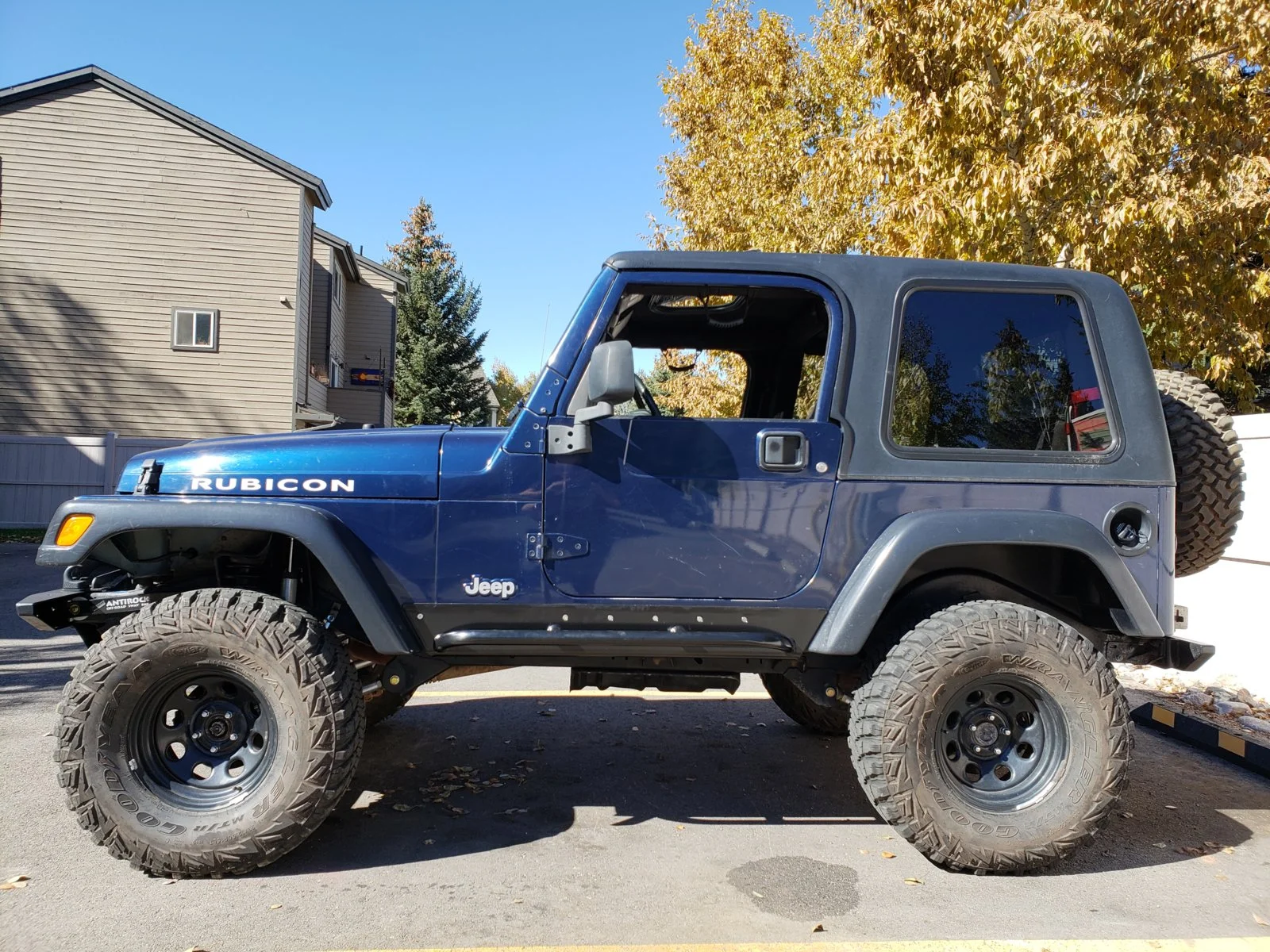

Finally done. That was a huge pain in the ass, I'm tired.
TC drop removed, drive shaft removed, adjusted front pinion angle, rock rails installed, surface rust treated on frame from transfer skid area, savvy shifter cable installed.

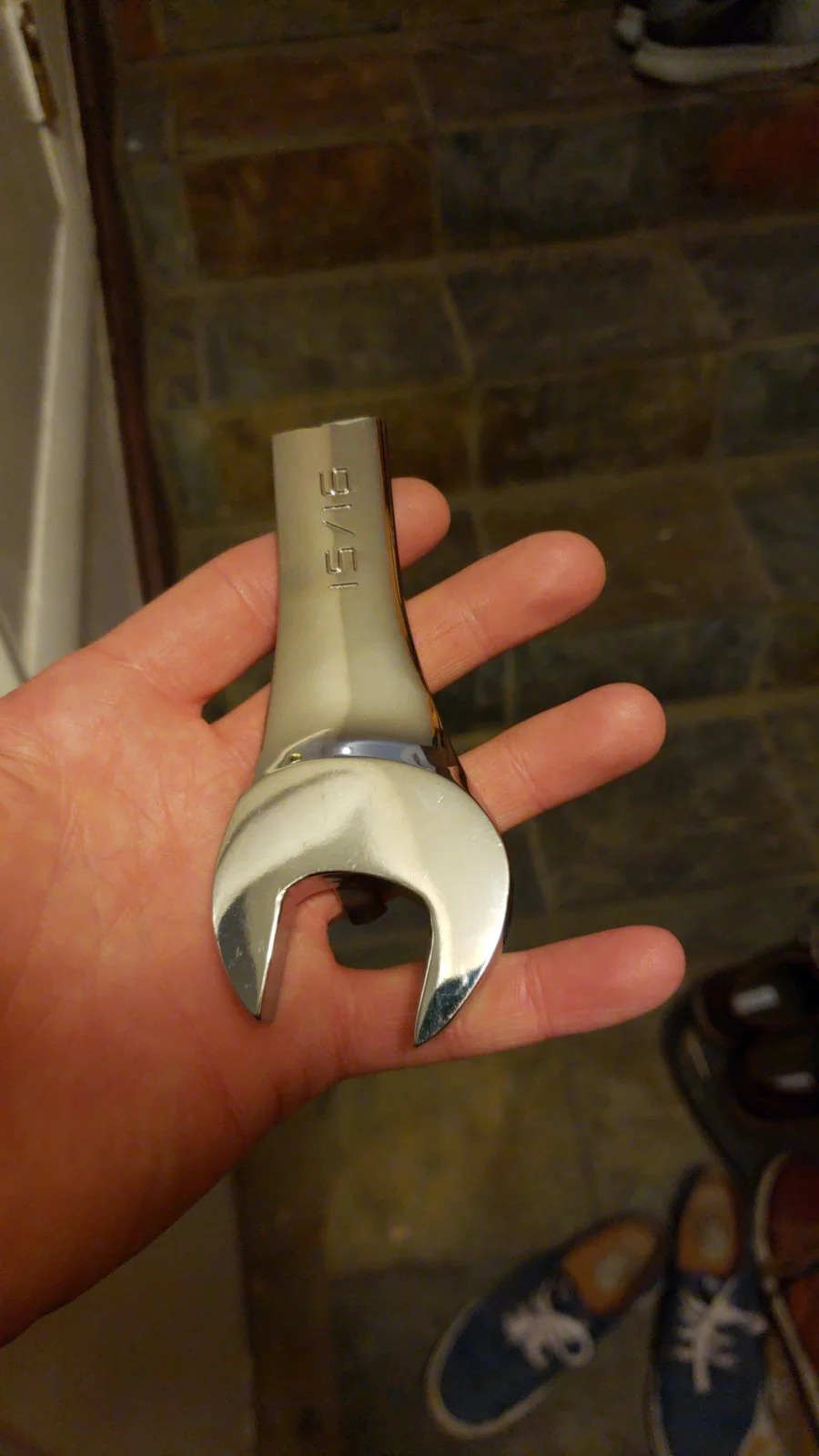

I had to cut a wrench to adjust it, it's pretty tight up there.

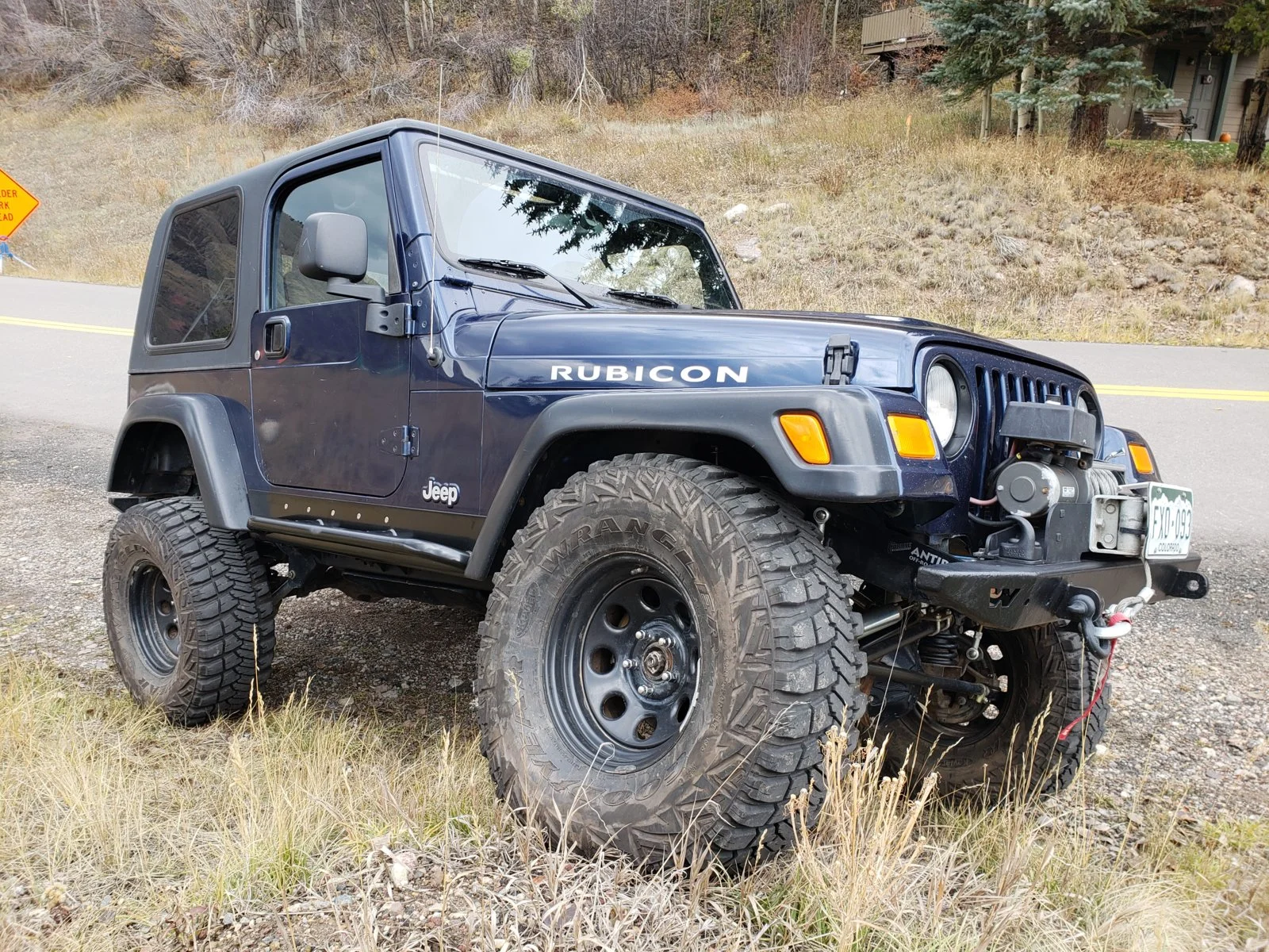

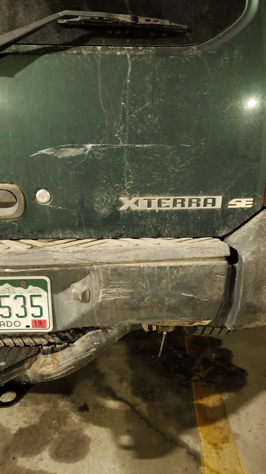

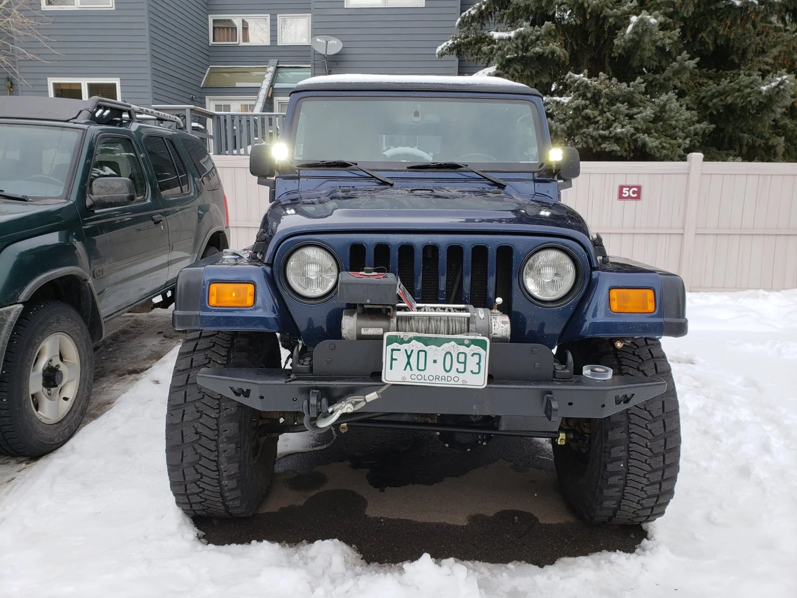

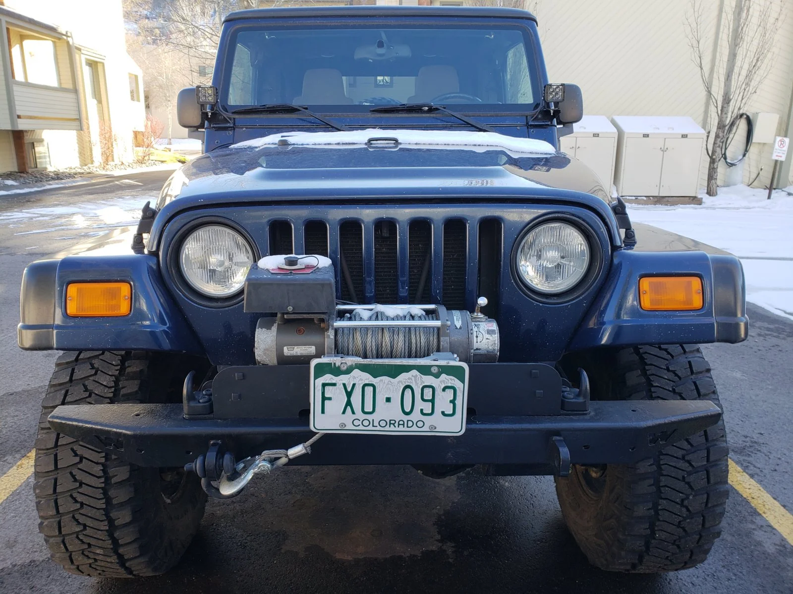

It has been a long time since I've last updated a lot has been going on. After 500 miles of replacing my axle shaft I drained the differential fluid and found a giant piece of a metal shim. The Jeep has been part since then and will be towed to Denver on Monday by flatbed to have a shop look at it. My wife and I found a killer deal on a Nissan, and was promptly rear ended. My 350z was also hit 3 times, guess it's a Nissan curse. Added some aux lights wired to my oem fog switch.
It has been a long time since I've last updated a lot has been going on. After 500 miles of replacing my axle shaft I drained the differential fluid and found a giant piece of a metal shim. The Jeep has been part since then and will be towed to Denver on Monday by flatbed to have a shop look at it. My wife and I found a killer deal on a Nissan, and was promptly rear ended. My 350z was also hit 3 times, guess it's a Nissan curse. Added some aux lights wired to my oem fog switch. View attachment 65853View attachment 65854View attachment 65855View attachment 65856View attachment 65857View attachment 65858View attachment 65859

Thank you! It should be pretty straightforward hopefully. Hard part was finding time to tow it 100 miles to a shop that can work on Rubicon lockers. Sucks because that's at least a new savvy gas tank skid in cost I'm having to spend.
