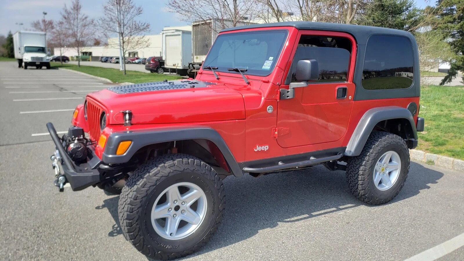

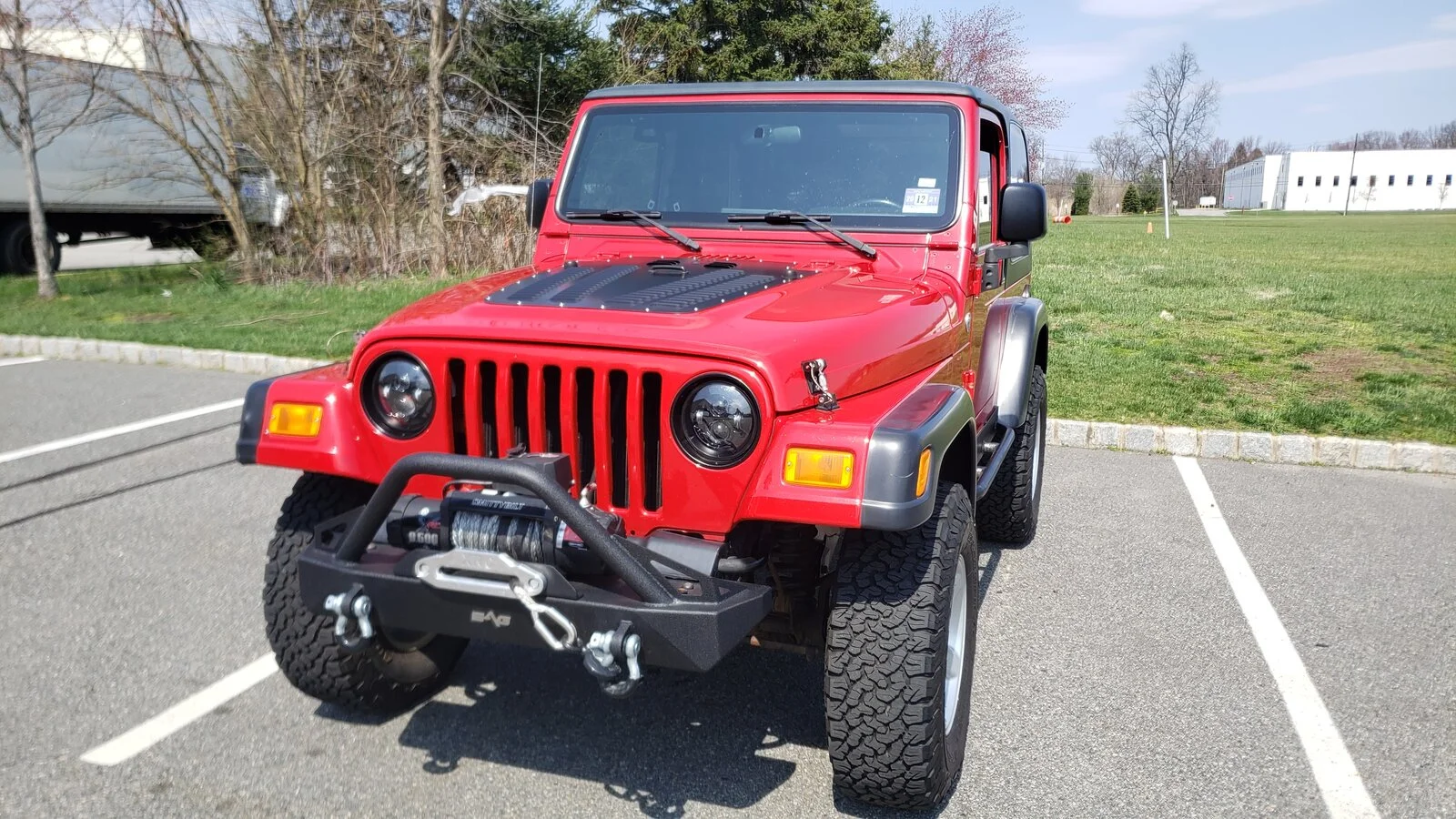

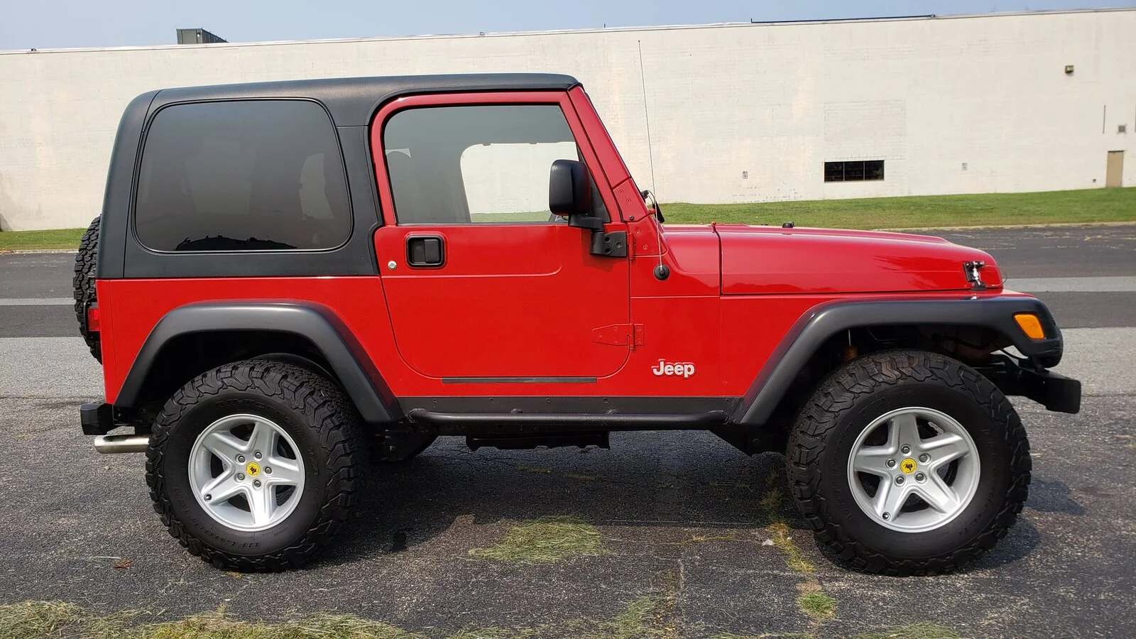

So I purchased my first TJ as it sits. These things are so much fun to drive. It has a 2in. spacer lift with 265/75/16 KO2s which is equivalent to little over 31.5in. I have taken it on 2 mild offroad trips and she was great. I want to stay with the 31s until I need tires and then go to 33s and that is the biggest I believe I will go. I am looking to do a tummy tuck with under amour and a suspension lift. Right now I am looking at OME 2.5 lift. I was thinking of doing a savvy body lift with more MML (Motor Mount Lift) (Motor Mount Lift) and full amour first. What are your thoughts on that? and next year add the OME lift. It will not be my daily driver but I want to build it for comfort and capable when I take her offroad. I'm new to building a jeep and my brain is fried from all the reading. Am I gonna need any additional items as in trackbar, adjustable control arms, etc. I want to build her right the first time. Let me know your thoughts and advice? I am looking forward to this build.
Freaking beautiful. This is how they should look for a mild lift. Clean, simple, and not a brazillion & 1 bolted on gizmos.
It's almost too clean....need to do something about that.
