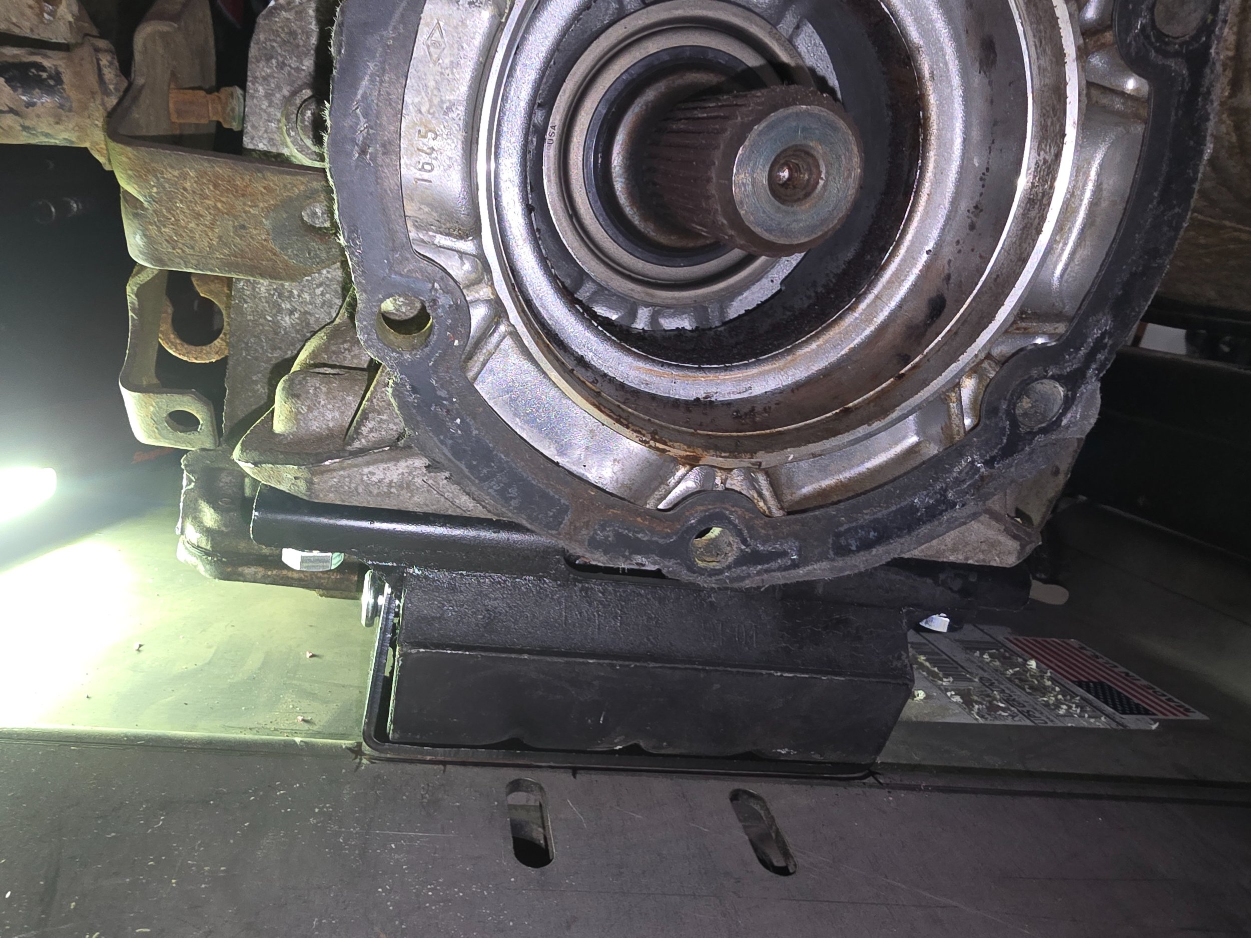

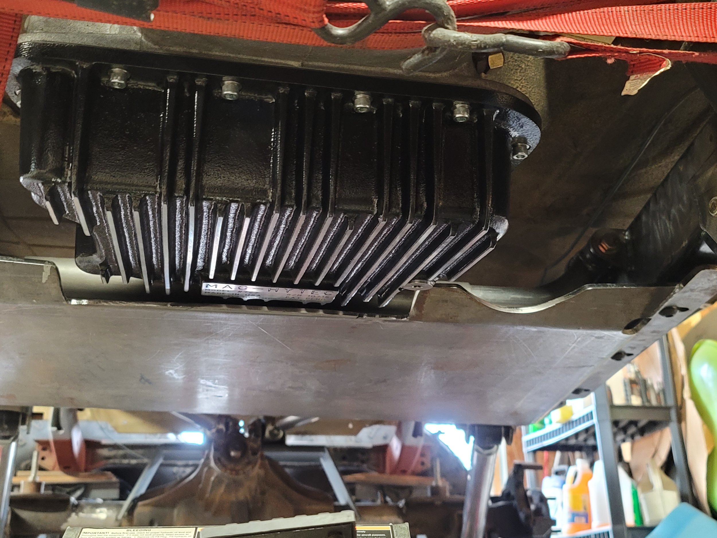

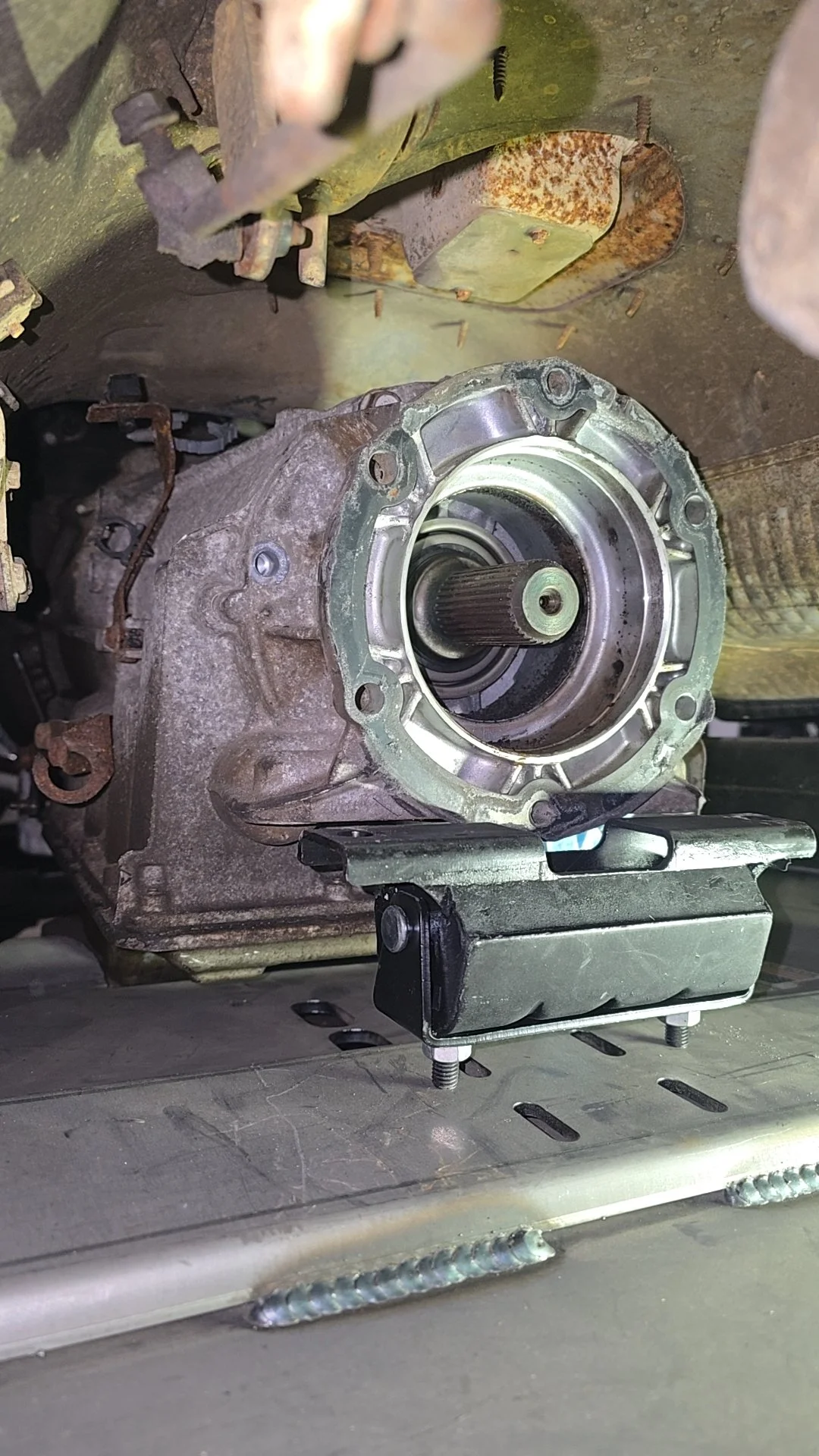

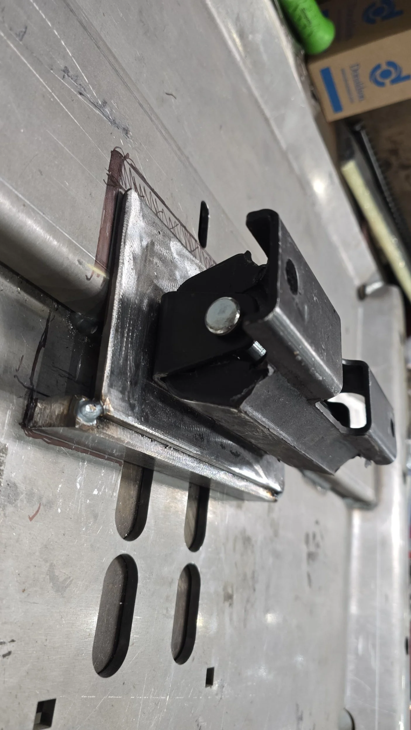

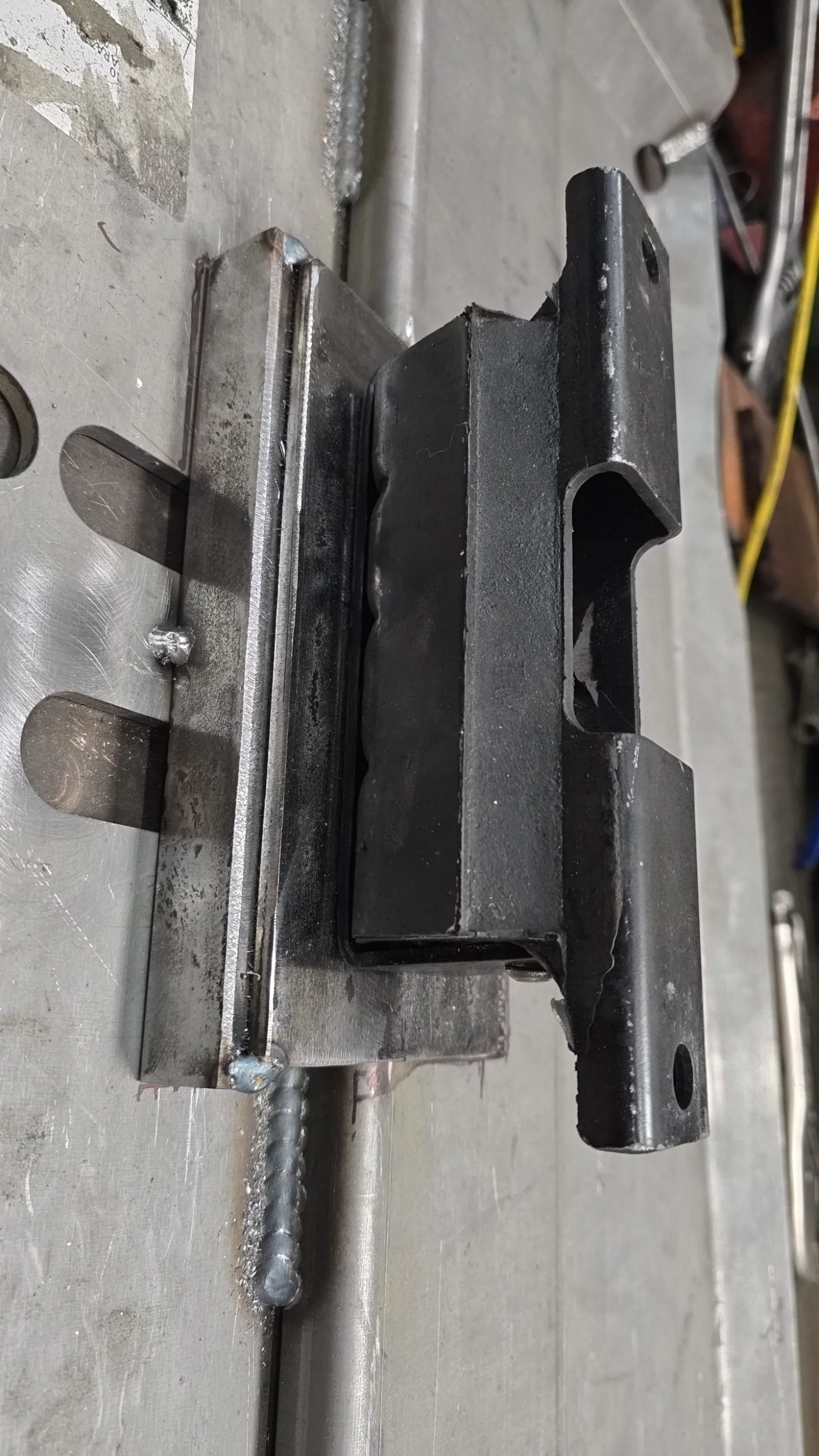

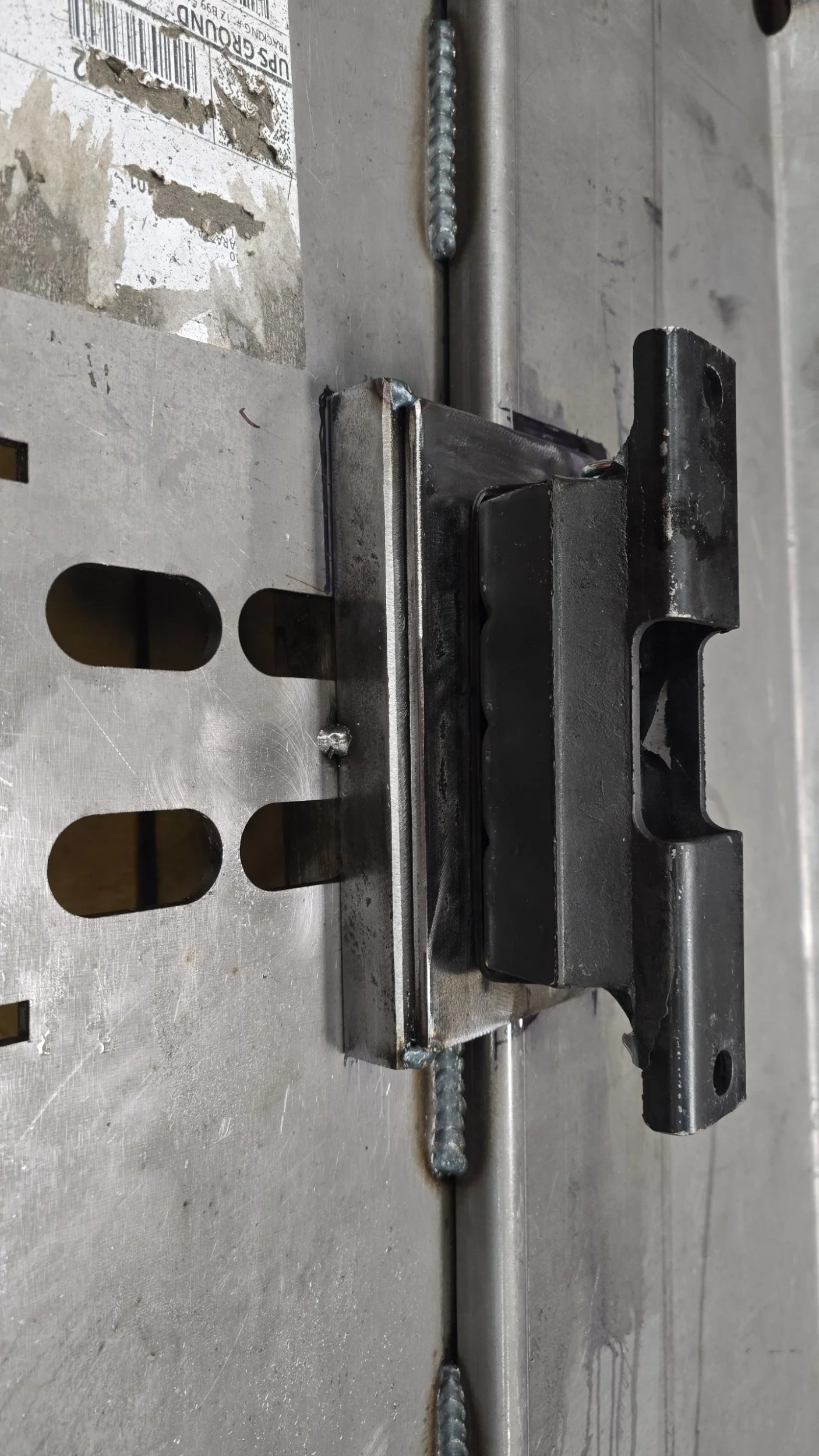

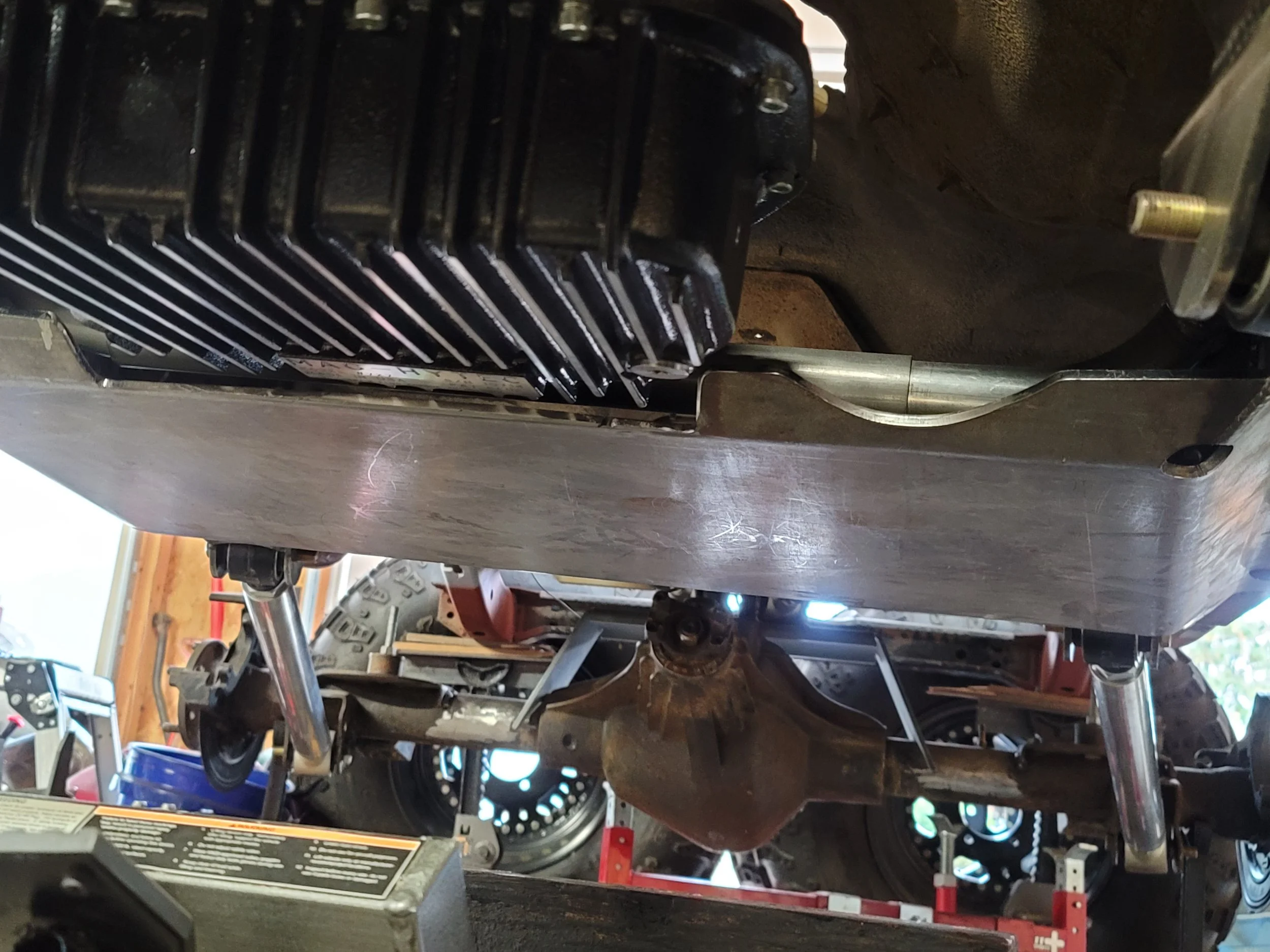

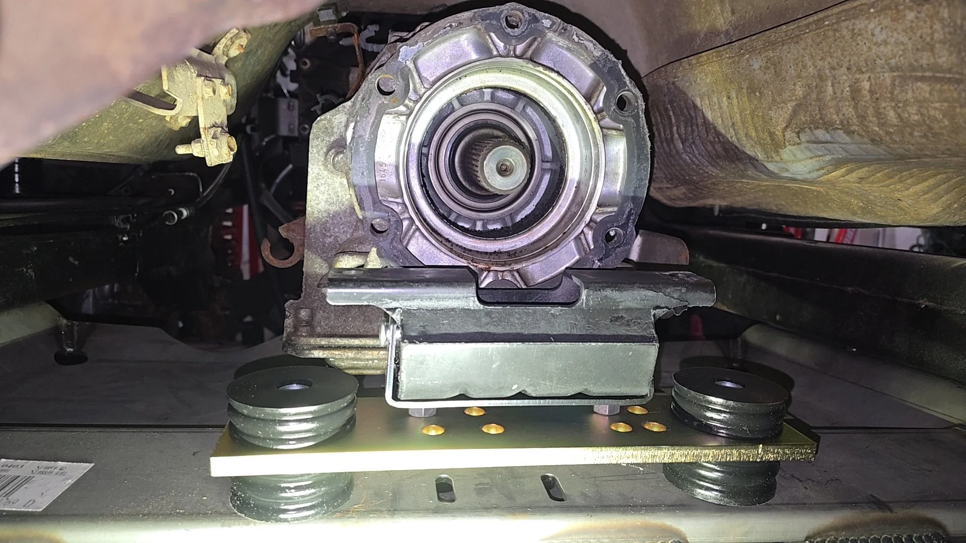

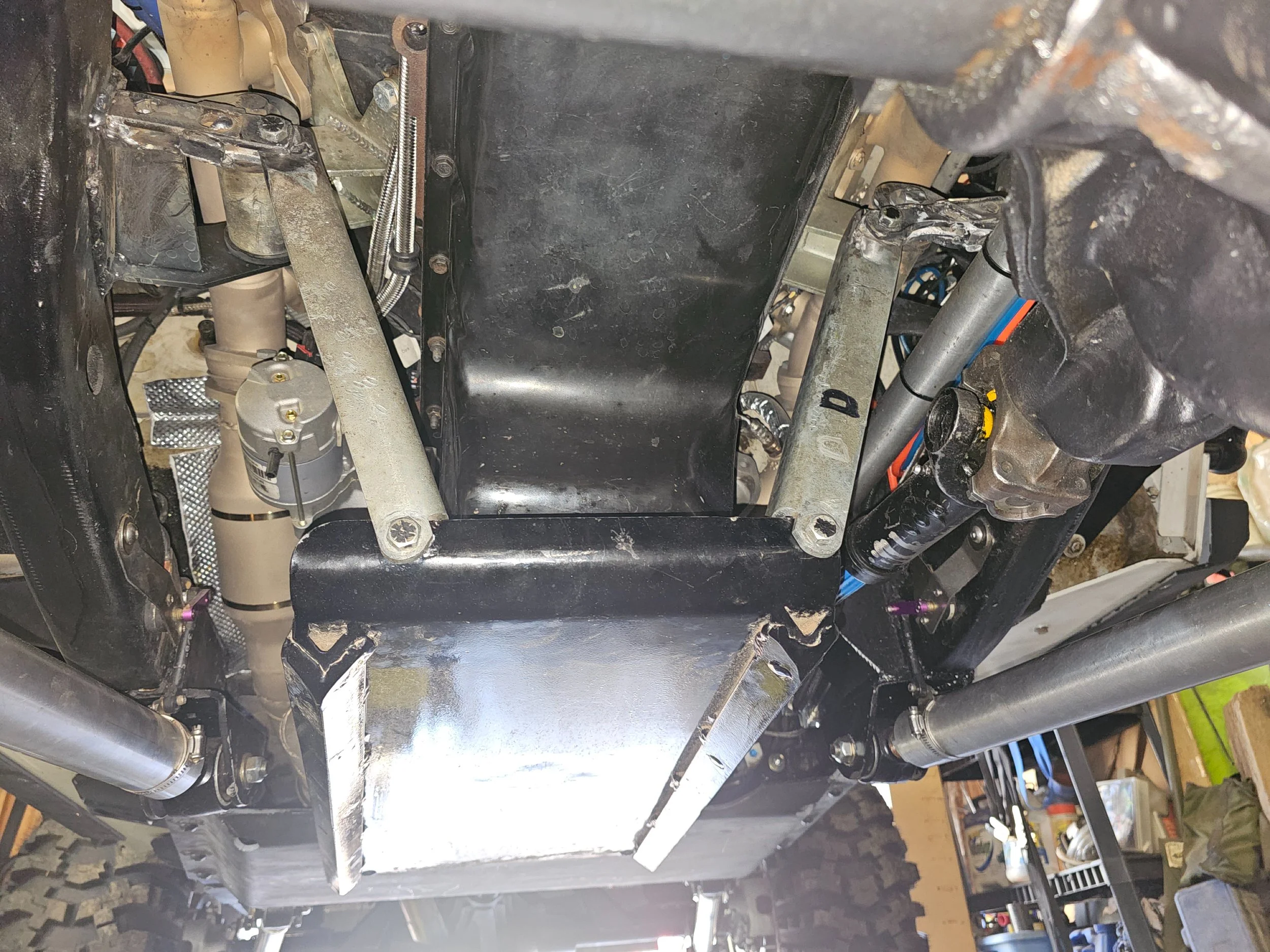

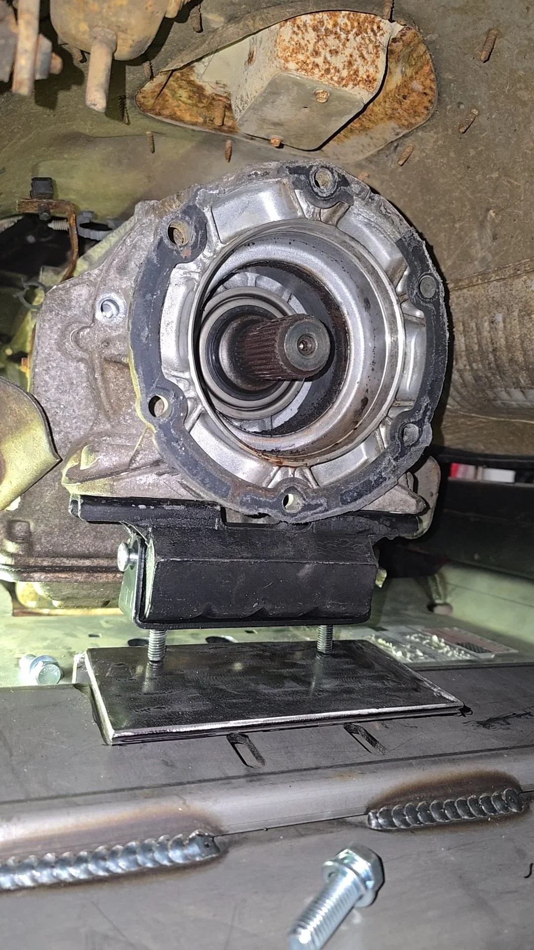

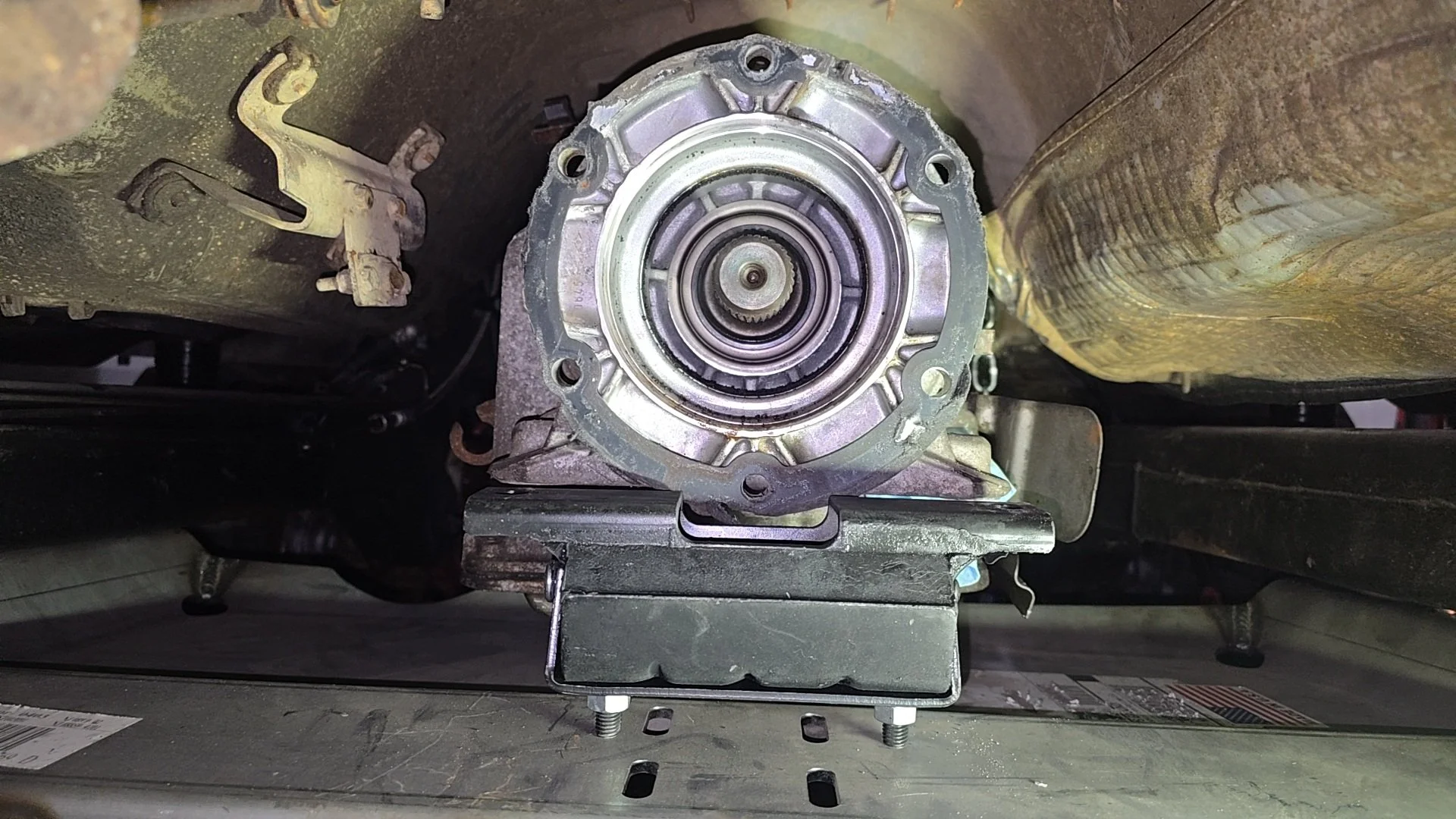

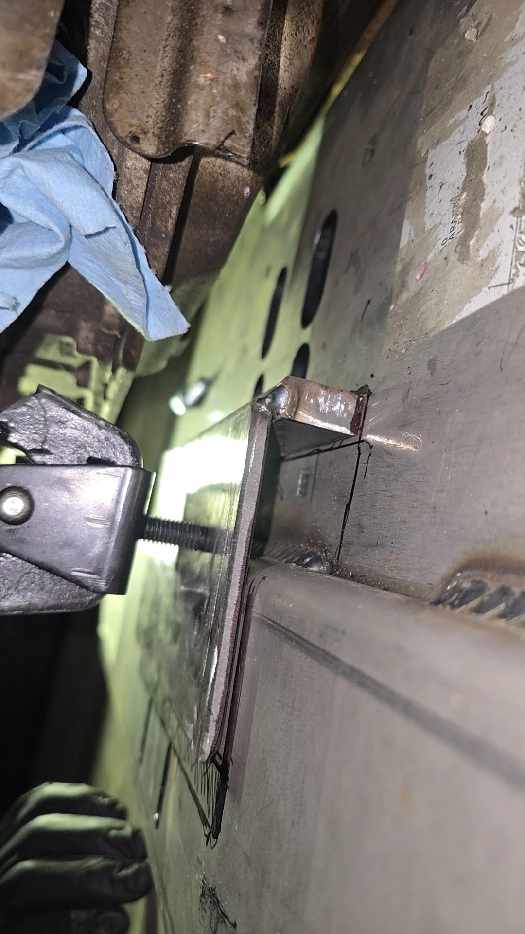

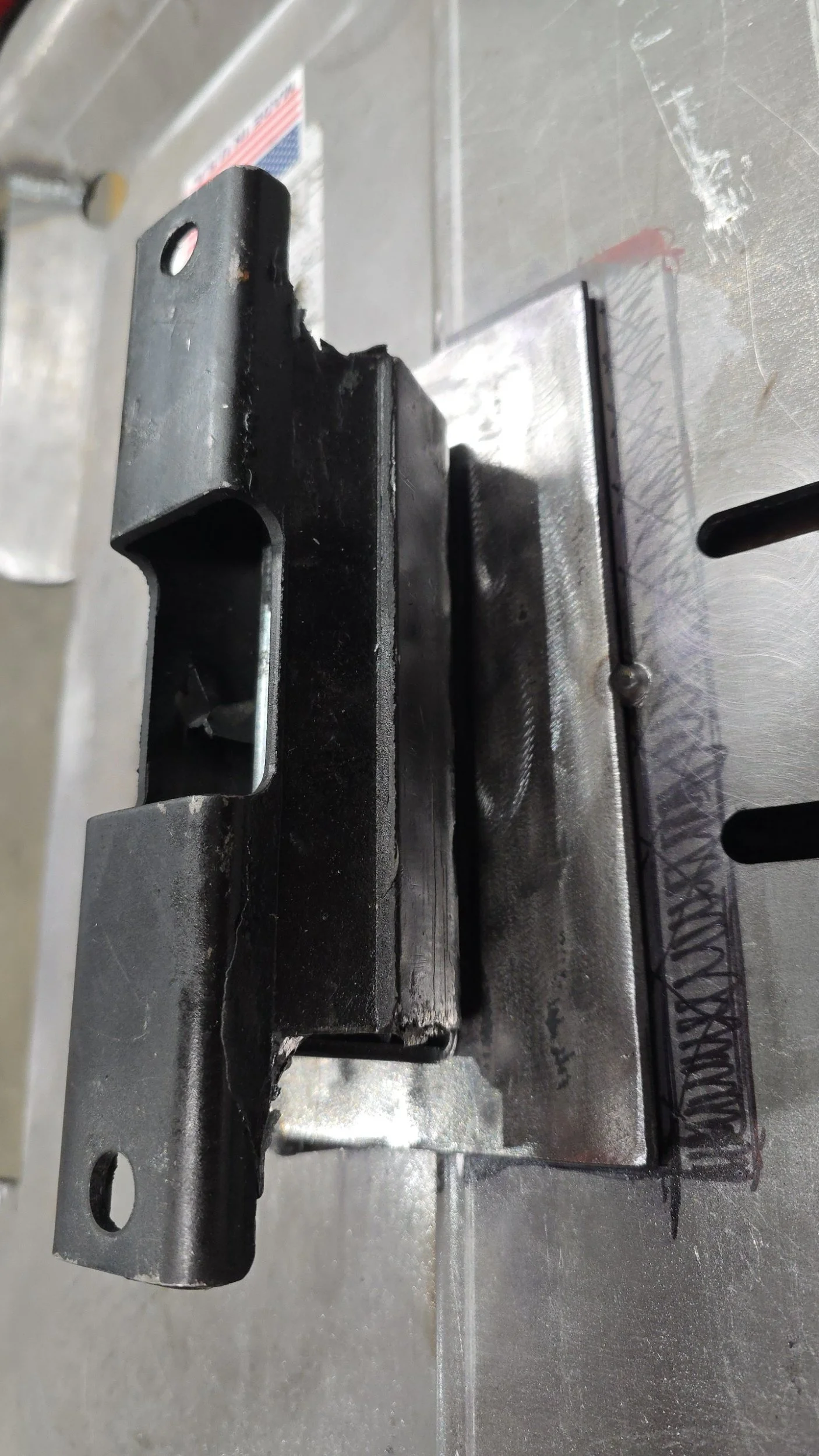

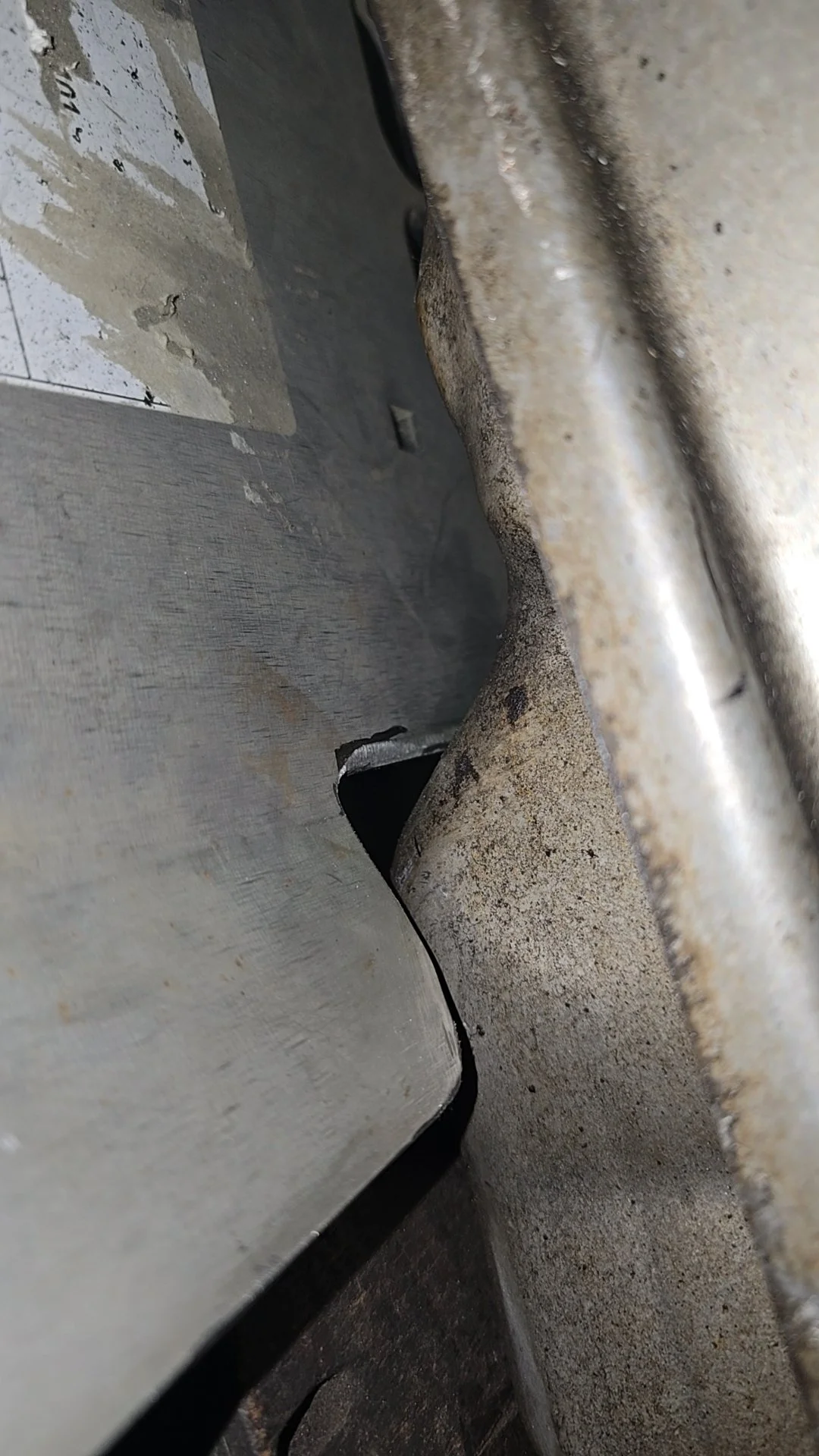

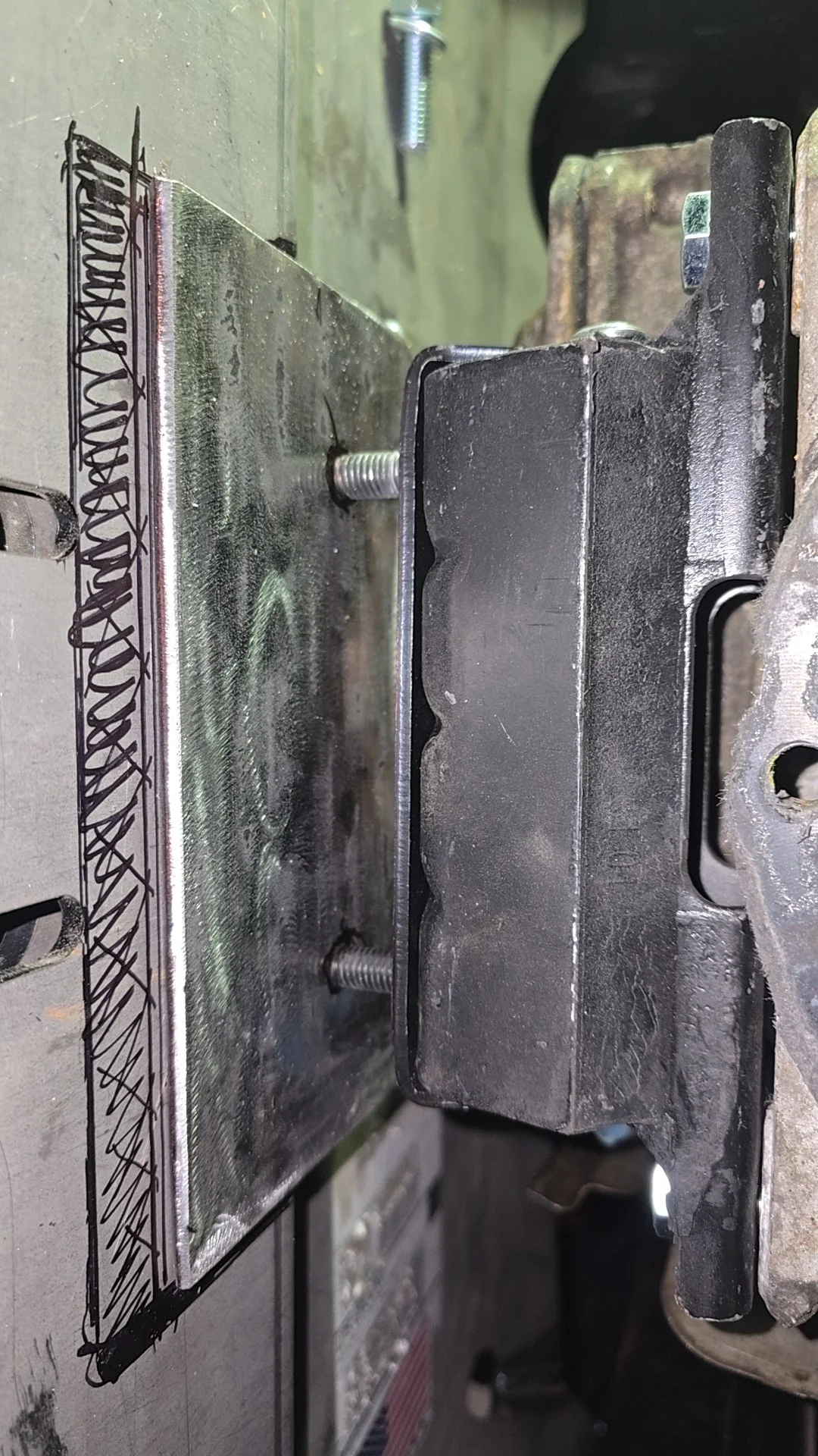

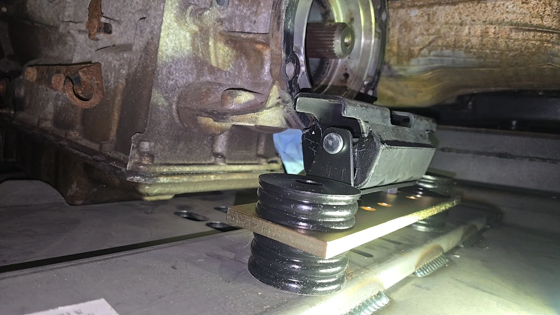

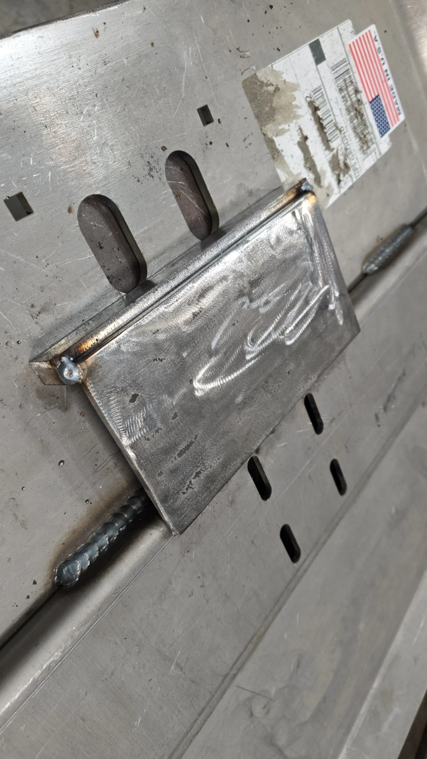

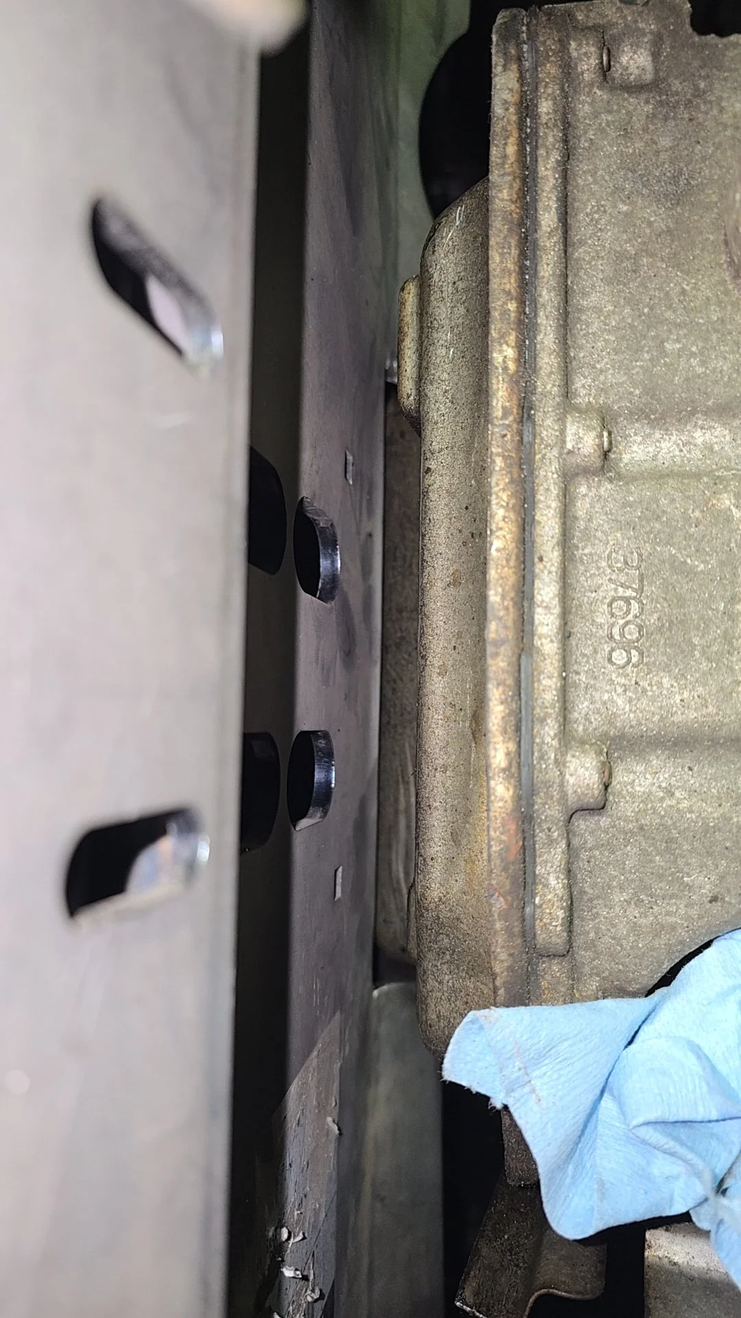

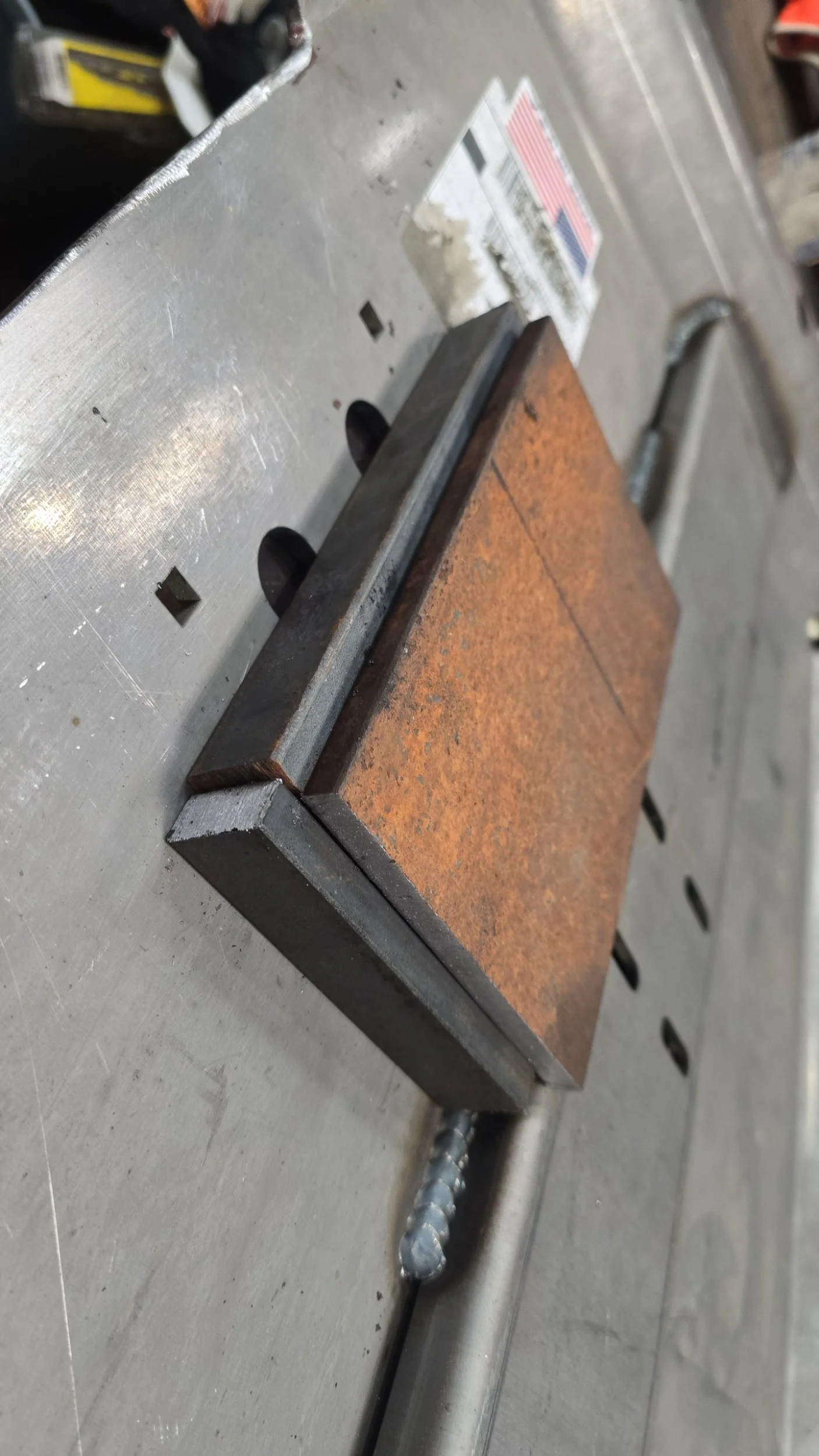

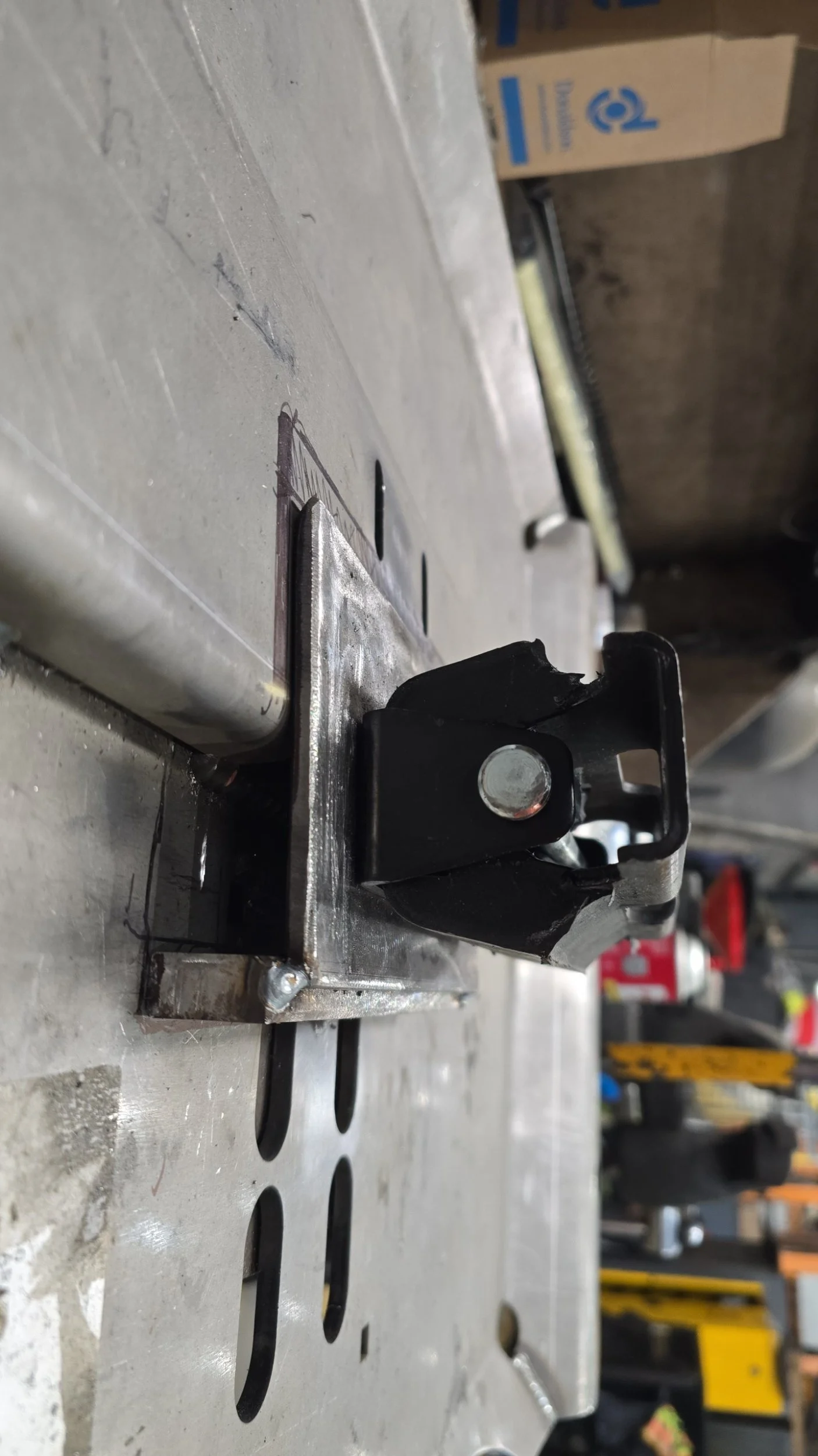

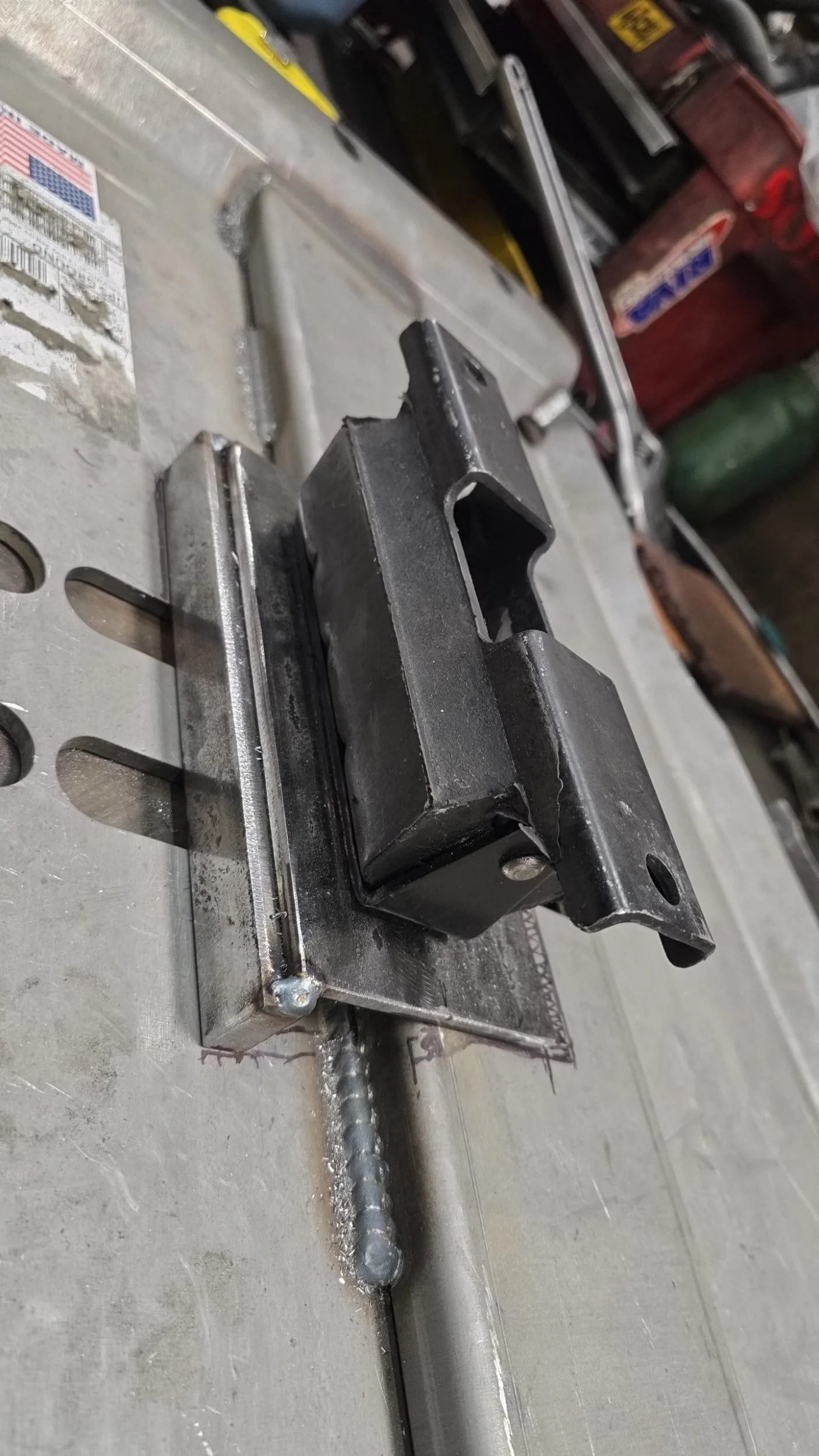

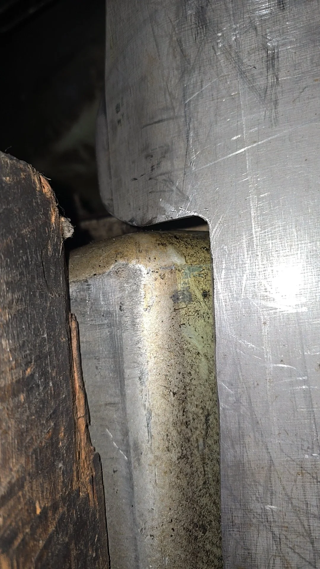

I’d at least look into that shallower pan, looks like it nets 1.05” of clearance, that’s quite a bit. That break in the front of the skid that you’re taking about cutting off adds a lot of strength to it.

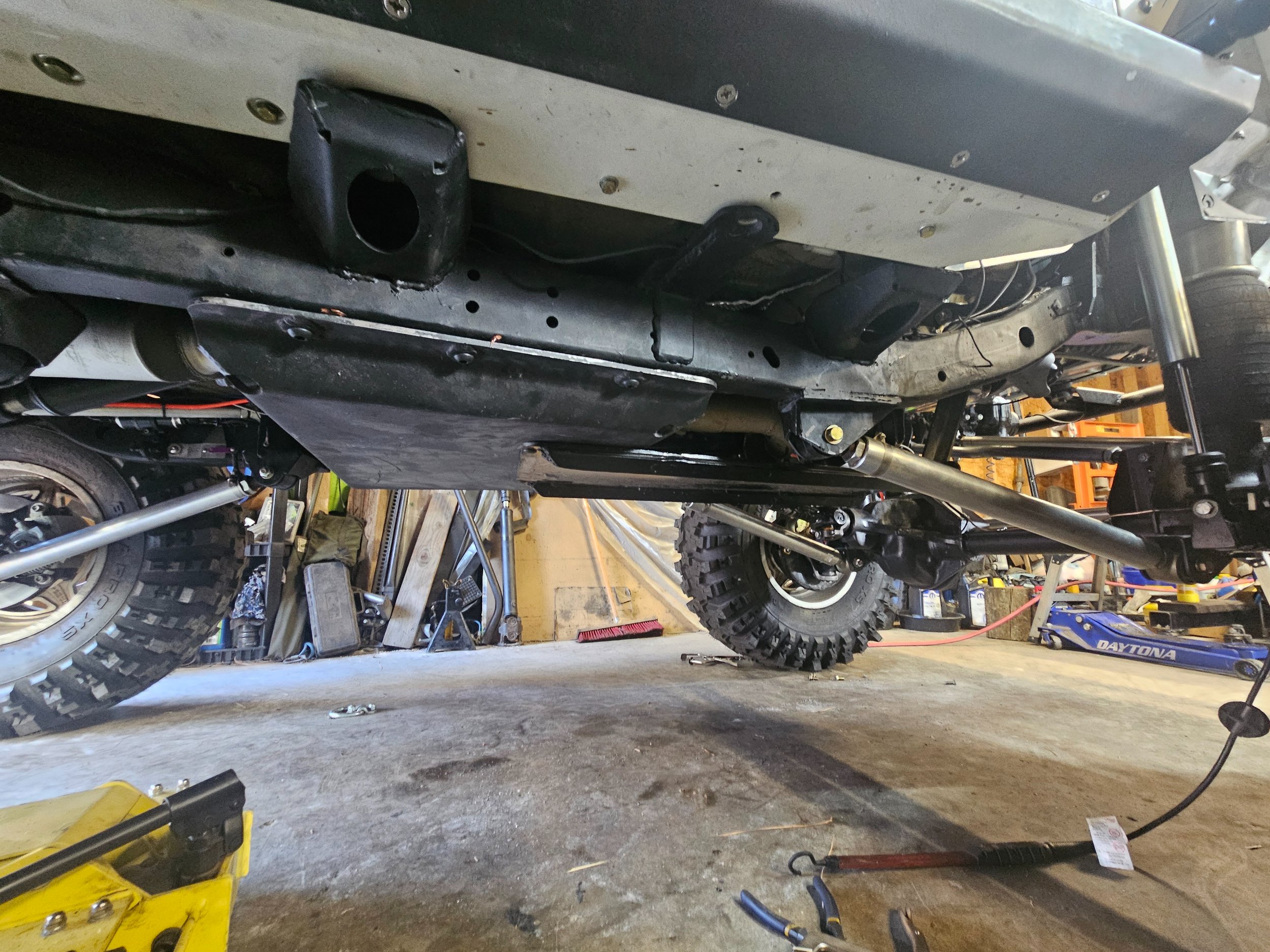

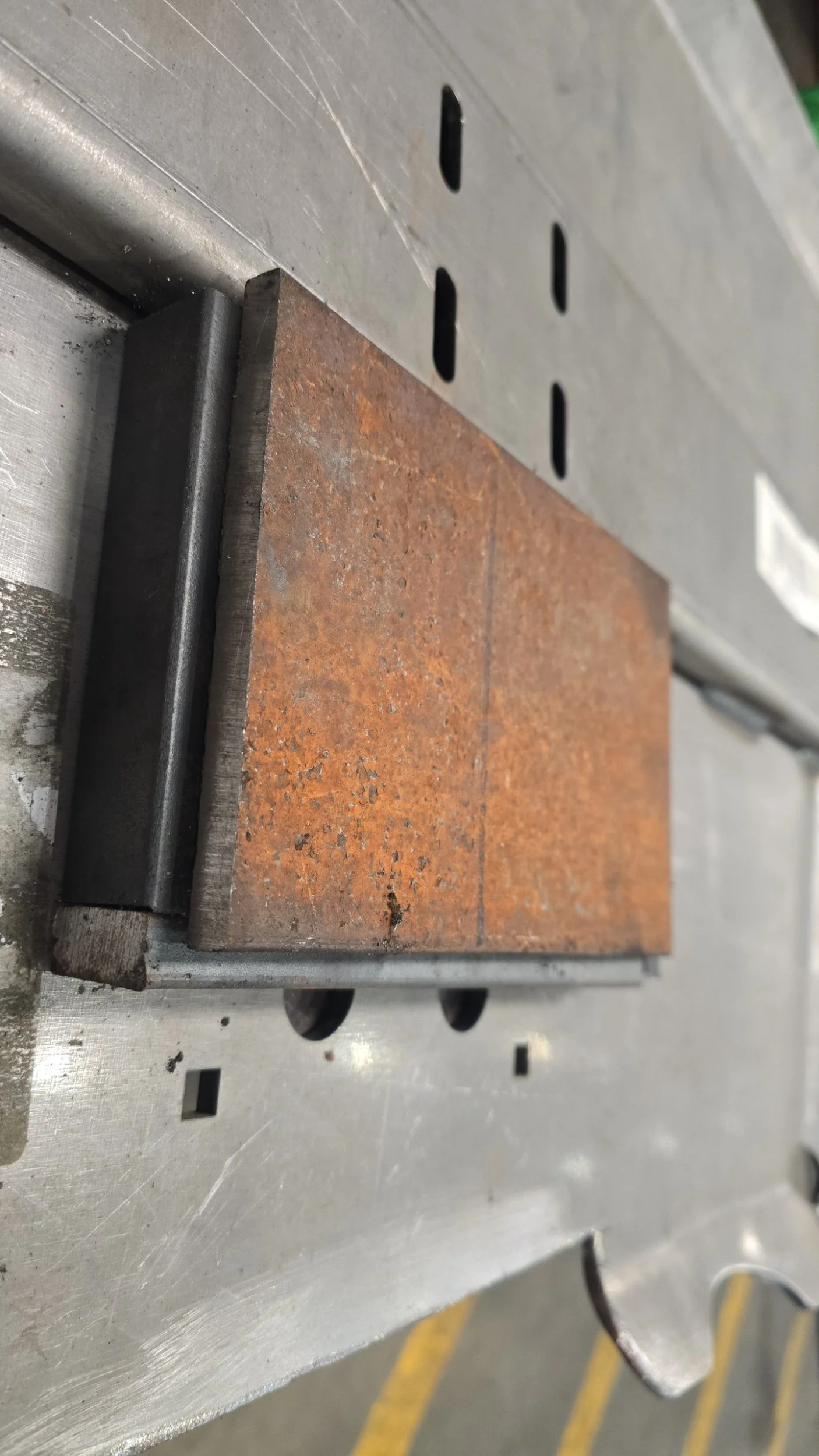

I agree that cutting the edge off the skid isn't a great idea..... But in my case I didn't have any other choice. I don't know if there is anything to be done to mitigate the cut either. Short of running a closer to stock skid plate it's what it is.
