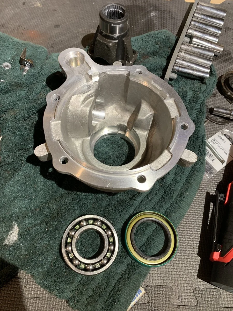

I played it safe and used assembly lube. But now I’m at the point where I’m reassembling the rear tail housing. But it looks like the housing and bearings and oil seal all came separate instead of already preinstalled as one piece. How do I press those bearings and seal in? Is a special press needed? It’s a tight fit and I don’t want to force it in if there’s a special way of doing it.

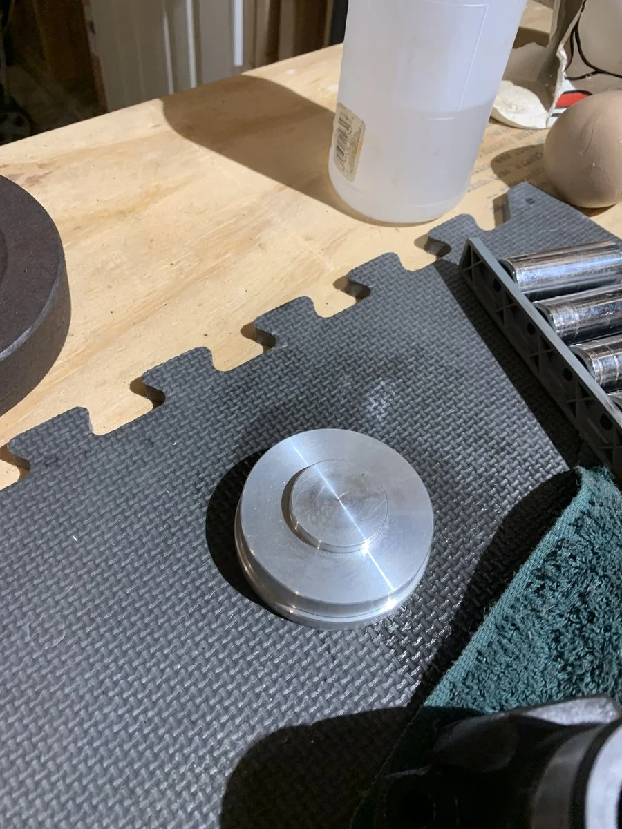

Also my advance adapters kit came with this part and I’m not sure what it is or what it’s for. Instructions weren’t great and the instructional video was just ok.
Nevermind. I’m dumb. They put the instructions on the very last page. Which I’m not sure makes much sense.
That part is a pusher for the bearing. It should allow you to install the bearing without applying pressure to the inner race of the bearing. If you're careful, you could use a large C clamp with a bridge against the outside of the housing (yoke side). Another way - you could brace the outer part of the T-case housing against a jaw of a vise and use a drift/pusher in conjunction with that piece that they supplied you to seat the bearing. Take care as to make sure everything is square (90*) so when force is applied, so it's a straight push. And that your pusher bar extends beyond the face of the tail housing so as to fully seat the bearing before the other vise jaw contacts your cast piece. And forgive me if I state the obvious at any point.
All of this is assuming that bearing is to be installed from the inside. Looking more at you pictures I can't quite tell which side its intended to be installed into. The relief/cavity just beyond the bore for the speedo gear makes me think it should be installed from the inside as that's probably a port for oil to flow through the bearing. Is that bearing retained using a snap ring or does it seat against a shoulder on the new shaft? Haha, now I can't remember how mine went. Mine was a super short kit so that's the only experience I have. The oil seal should more than likely install from the outer (yoke) side. Press that by hand firmly and as squarely as you can, then tight lightly in circles around the outer race of the seal until its seated.
If they supplied a thrust bearing (and the bearing is indeed installed from the inside of the housing), the races should be thicker on opposing sides outer/inner respectively. If that's the case, I believe the thicker outer race should be installed into the housing face in, leaving the thicker inner race facing into or towards the inside of the transfer case.
Hope this is helpful.
So I got it all put back together now. Bearing was pressed in using that pusher block and a BFH. Then I pressed the seal on the other side using the same pusher block. Yes I put a snap ring to hold the bearing in place. I’m letting the gasket cure til tomorrow night then I’ll throw it back in the Jeep. Thanks for all your help.
Also I don’t believe I noticed any thickness differences with the bearing. And the instructions didn’t say anything about installing it a certain direction facing up or down. Hopefully I put it all back together fine lol
It's much more likely it's a normal open face bearing. I just threw that in there on the off chance it wasn't. My kit was missing that bearing and the only bearing I could source locally was a thrust bearing. Just wanted to cover my bases lol.
Edit: I'm mis-remembering. I'm thinking the front output yoke bearing. You should be just fine (y)
