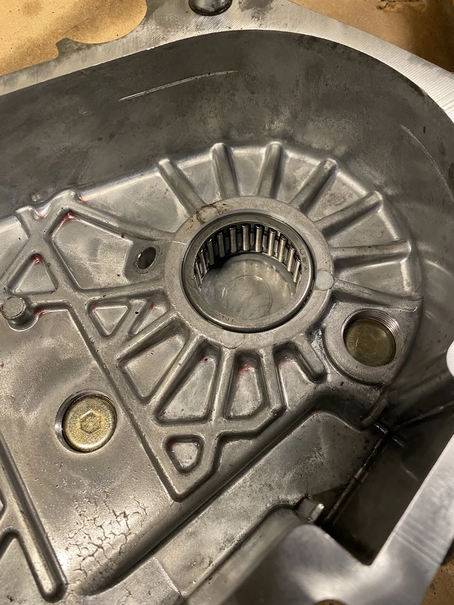

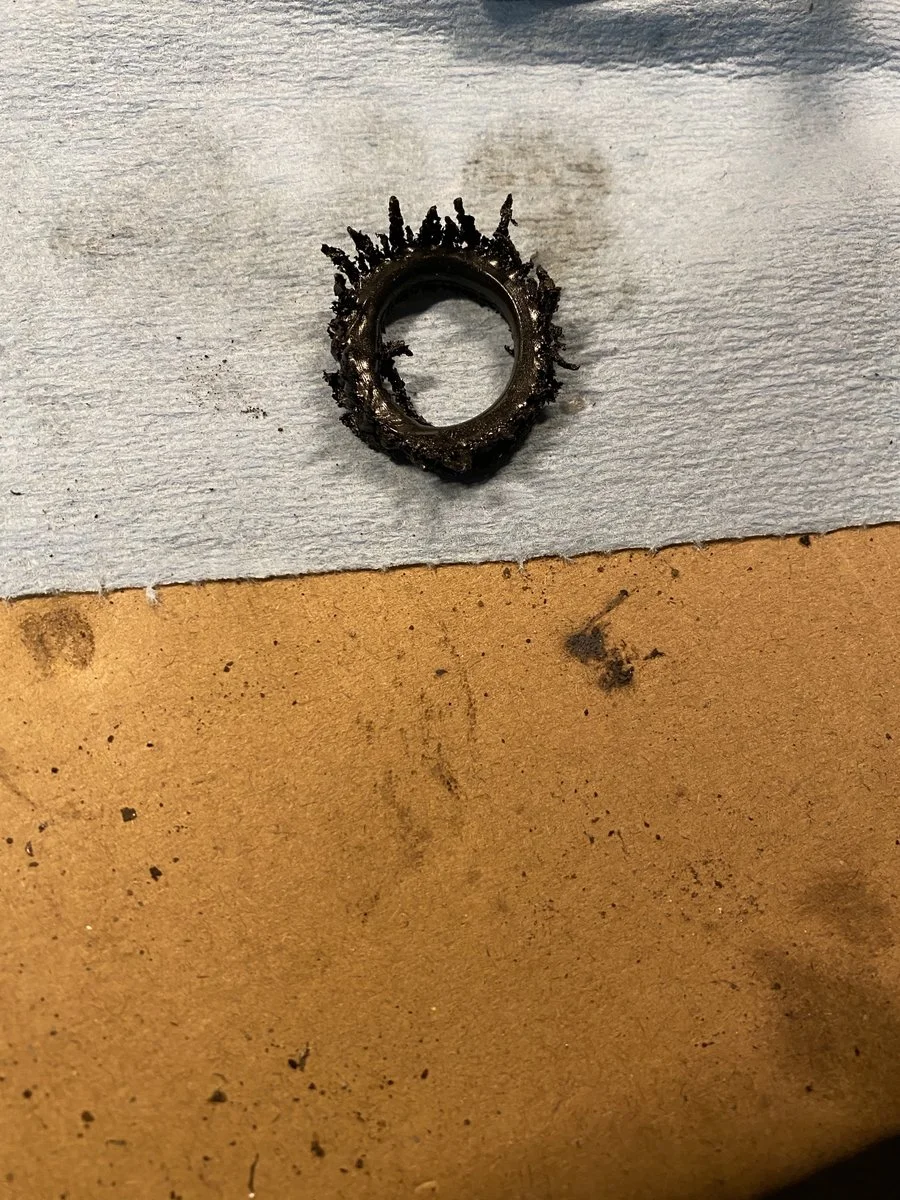

I just took my case apart tonight to install mine. I found a bad front output shaft pilot bearing which is going to be fun trying to remove. Going to try and get a slide hammer in to grab it. What did you all use for the pinion washer on the front yoke (the black sprocket shaped one). Mine was pretty chewed up and my sye didn’t include a replacement. I guess I need to order one?

Got any pics?
Got any pics?
Here is the bearing that feels a little "gritty" and the shaft has some lateral play. I have a replacement on order but not too sure how to get this one out without a special tool.
Here is the star yoke washer. I'm a little surprised it isn't mentioned in any of the instructions or youtube vidoes. So curious what others have done in their install.
I have a new one on order.
To tell you the truth I don’t think I even noticed those bearings. And as far as that star rubber washer, doesn’t the SYE kit come with a brand new one? If I had one in my TC it definitely did not look chewed up like yours.
