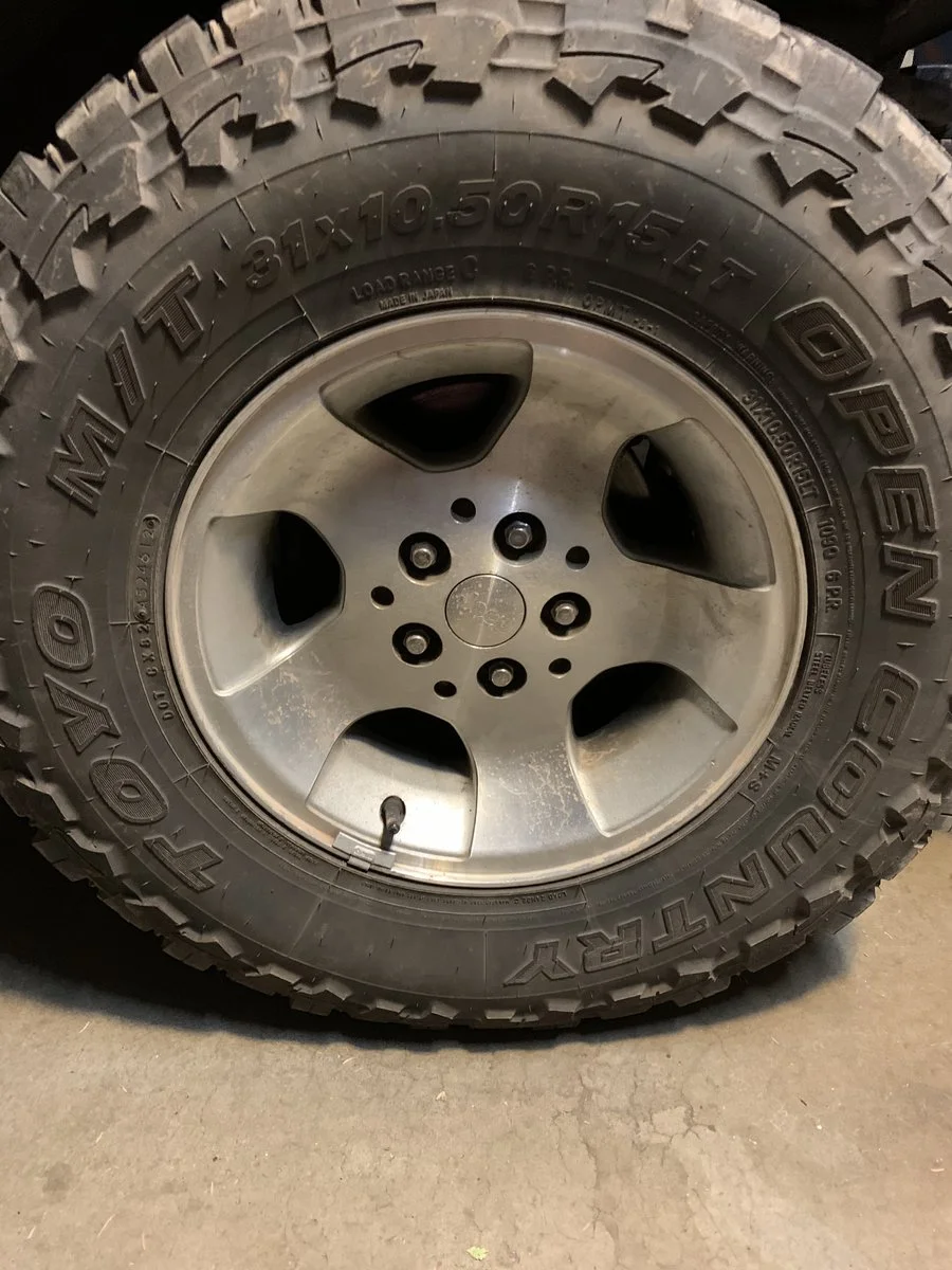

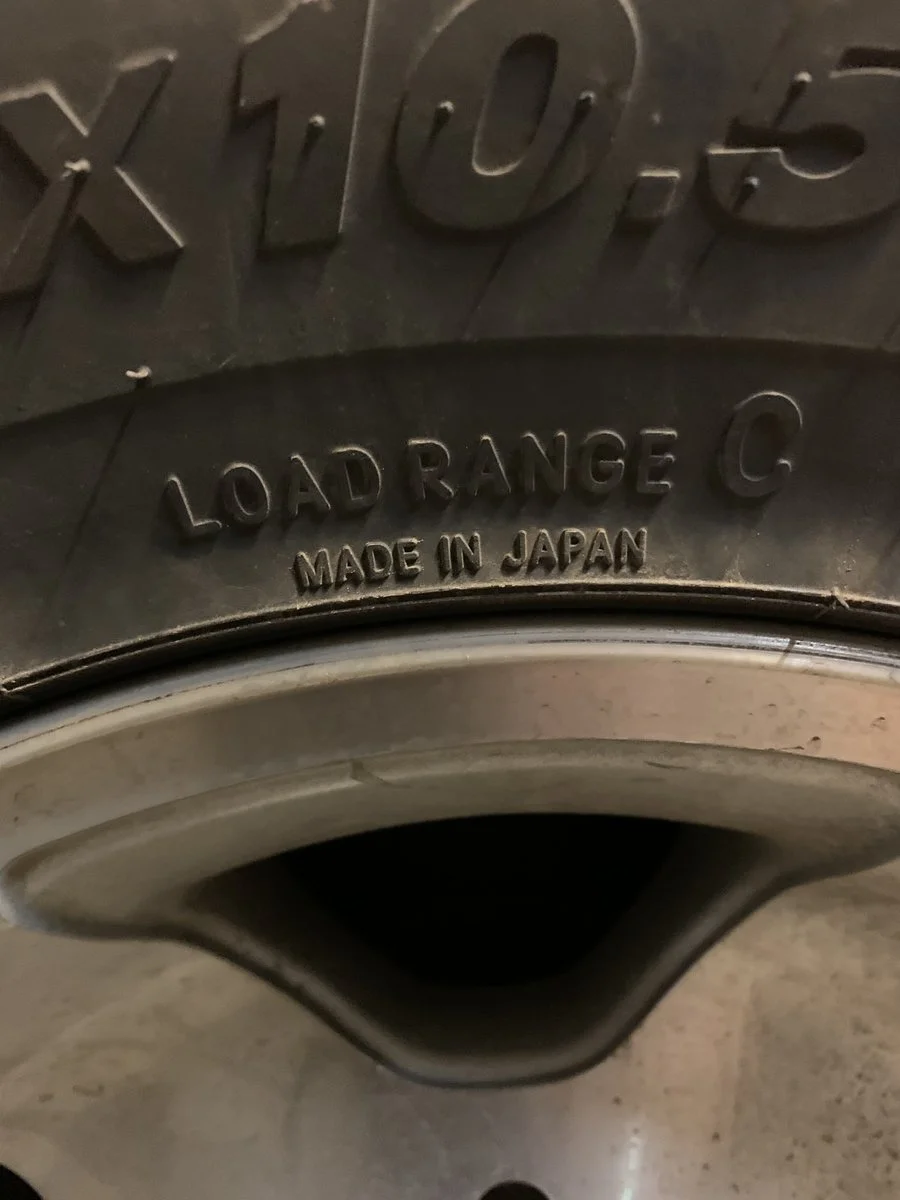

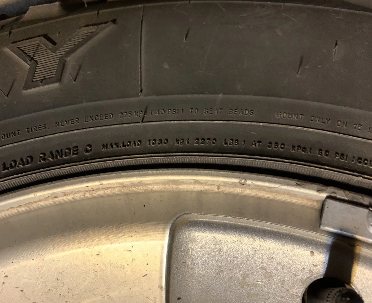

Resent suspension upgrade complete, but TJ ride has room for improvement. Replaced suspension with Rancho RS5000X stocks and OME Medium/Heavy springs. No hard top. No upgraded bumpers....yet. 4.0L. How do you manage your air pressure?
1) I see many posts mentioning 22-26 psi....is that for off road and on road use?
2) What do you use for deflating? Is it important to have a quality tool to get close to exact tire pressure in each tire
3) What do you use to inflate? I have seen onboard tanks, plug and play compressors and air tanks.

26-28 psi is more for 33" size tires and that high of a pressure only for street use. Offroading, the tire pressure is much lower, usually 13 psi or under. Generally speaking, the bigger the tire the less air pressure required and visa-versa. If you're not under 15 psi for offroading you're not airing down enough.
