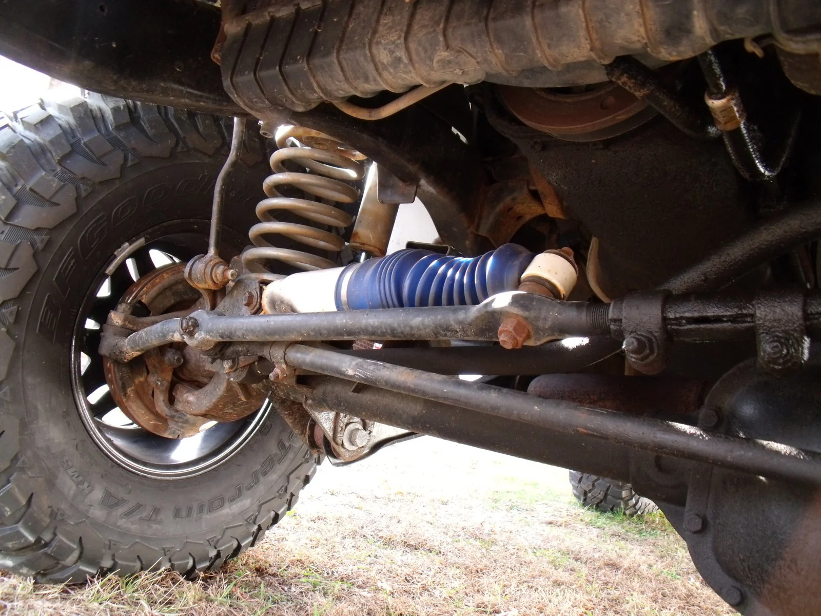

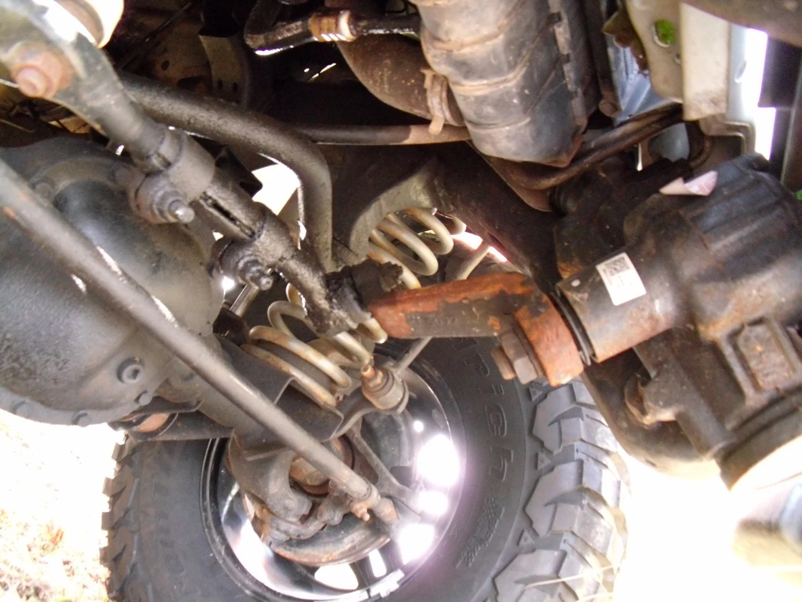

I am having the same issue. When I drive I feel like it’s going to left, especially when I drive on uneven pavement (construction on highway). I will post a photo of my under carriage can someone take a look at it and let me know. I am new to the Jeep family. It is lifted and is running 35’s on it.
Okay, there is two issues going on there I see.
First off, someone has added a second steering stabilizer that is attached to the tie rod. That needs to be removed completely as it shouldn't be there to begin with and is doing no good.
The second thing is that you have a drop pitman arm which is more than likely the culprit as to why your steering is wandering (this is a known issue with dropped pitman arms).
You'll need to put a stock pitman arm back in place of it.
Most of the time when I see a second stabilizer, it tells me it really needs more front end work, they ran out of ideas, and slapped that on there.
