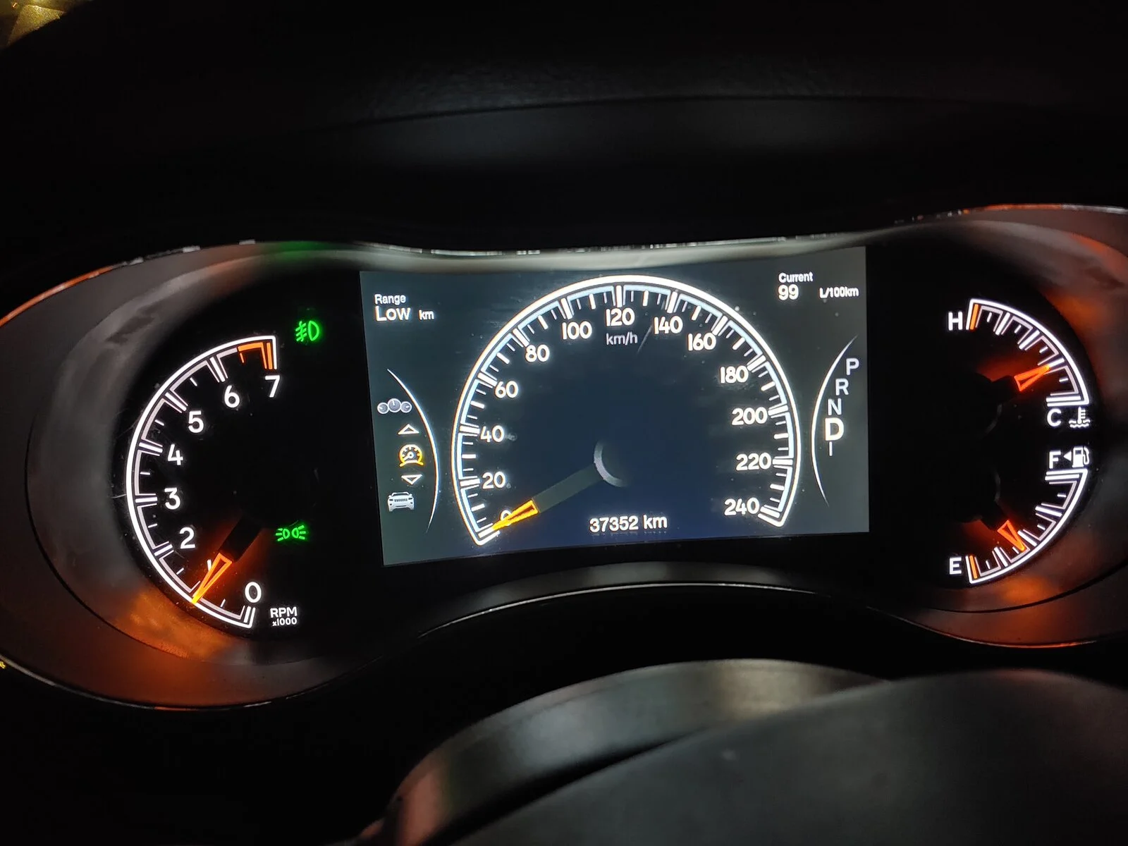

I found this picture of one of the rentals I was using for work. Idling for the better part of 12 hours in -30°C does a number on the estimated range.
