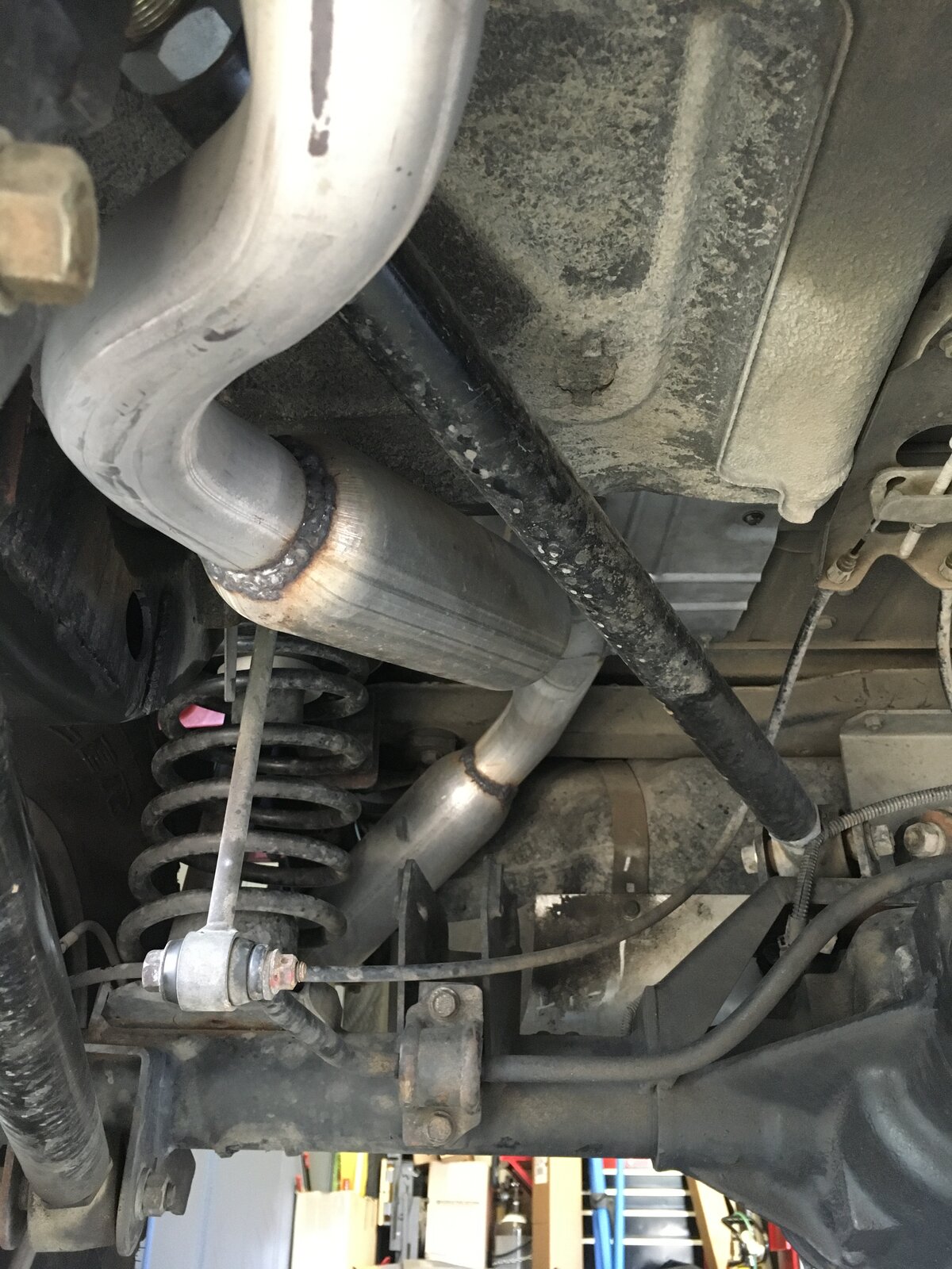

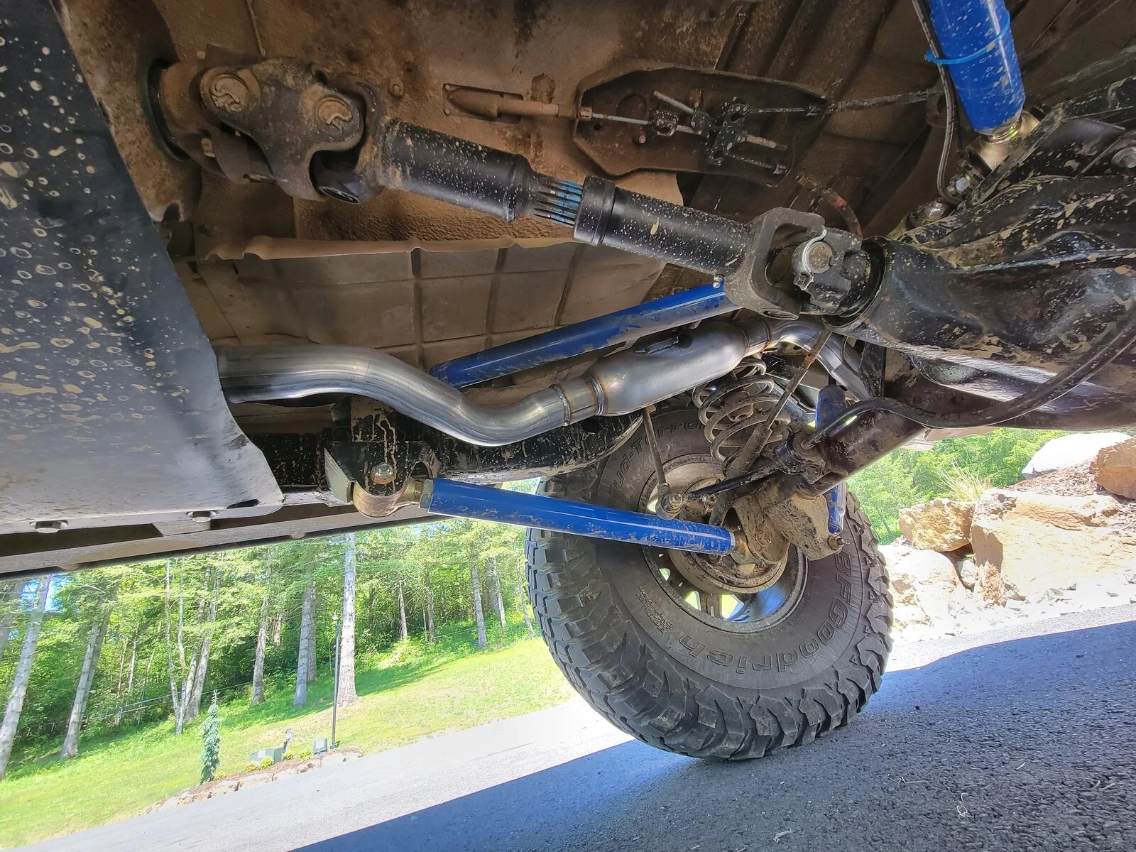

Here I my final exhaust setup, I ended up getting the muffler I posted in post #3. I am very happy with the result. Under about 2.7k rpms the sound is maybe slightly louder, if not the same as stock. Anything over that has some noice, but a very tolerable amount.
Does your sway bar allow your rear axle to droop fully when positioned below the rear differential like that? Does it get hung up on rocks?
