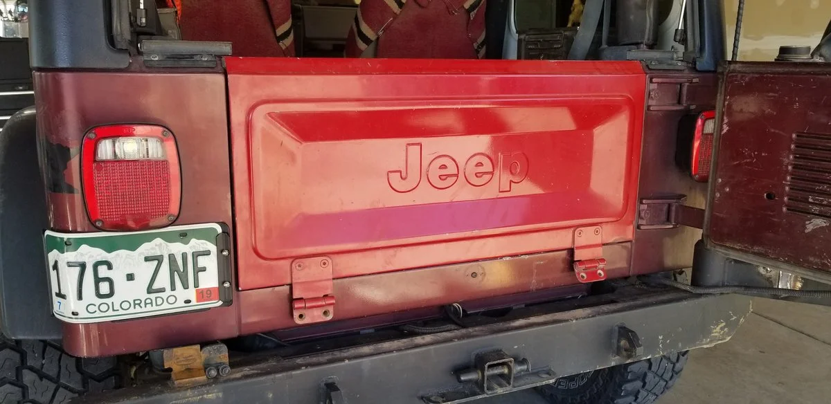

Money is usually the answer, however I will still ask. Why not skin the CJ tailgate you do have and graft the embossed Jeep skin, "into," your OEM tailgate?
Or better yet, just convert it...
Jeep CJ:TJ Tailgate.jpg
Best of both worlds.
jjvw
0-60 in 18 seconds
Feb 17, 2018
8,667
Colorado, USA
Or better yet, just convert it...View attachment 119262
Very nice! The stamped Jeep logo is all we really want. It would be a shame to cover that up with an Exogate. :)
Reactions: Fouledplugs and JMT

I hope their is a write up on how this was done. That’s exactly what I’m wanting.
Jeff Scherb also did something similar with a stamped logo swing out door. The center section of a CJ7 gate was reduced in size a bit and grafted into a TJ door. I recall it being about as easy as body work. :)
