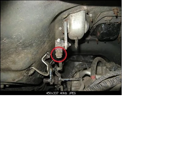

So I ran into a issue where my jeep (1998 Tj) would not engage 4wd in a slightly problematic situation. I was trying to tow jetskis offroad on a uphill. To make a long story short, the jeep didn't engage 4wd. The shifter seems to be able to go through all the positions fine, (2H,4H,N,4L) but beside the notches, there's not indication that I was in 4H. It feels like I'm either in N or 2H when shifting in 4h Sometimes the gears engage, other times it just revs. I feel the ratios change when going into 4L, however still the front axle doesn't seem to engage. Once I was out of my predicament, I tested the different transfer case positions on flat road. Front wheels never gripped the pavement. When examining, I noticed a 2 pin connector melted near the exhaust going from the transfer case harness to the transmission. Not sure if that has any effect on my situation. I tried spinning the front differential by hand in 2wd and 4h, 4l. 2wd spins freely, both 4h and 4l "resist."
Any help and/or questions are greatly appreciated.
Shifting between 2Hi, 4Hi, Neutral, and 4Lo is a purely mechanical thing, a melted electrical plug wouldn't cause that.
It's just likely your t-case shift linkage bracket that holds onto the shift rod from the t-case has simply slipped out of adjustment. It's held in position by the 1/2" head bolt circled below. When it slips it gives the problem you are describing. It just needs to be readjusted back into position. You can normally find the position the bolt used to sit at on the shift rod by the mark it leaves in the shift rod.
Perfect post. The rod will just slide if the bolt is loose - if you have to snug it up, have the handle and transfer case actuator in the proper positions, then snug it up.

Don't mean to interrupt this convo, but that adjustment seemed to have worked like a charm. Even the 4wd light came on! I appreciate both of your guy's help.
