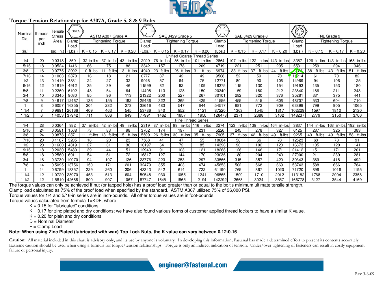

All I know for sure is their assertion that the torque must be reduced by 1/2 doesn't match anything we deal with and at no point in time does the torque value get anywhere close to clamp load for higher graded fasteners.
Any of the common bolt charts show that fairly readily. We're looking at about 5000 lbs of clamp load for a bead lock bolt.
