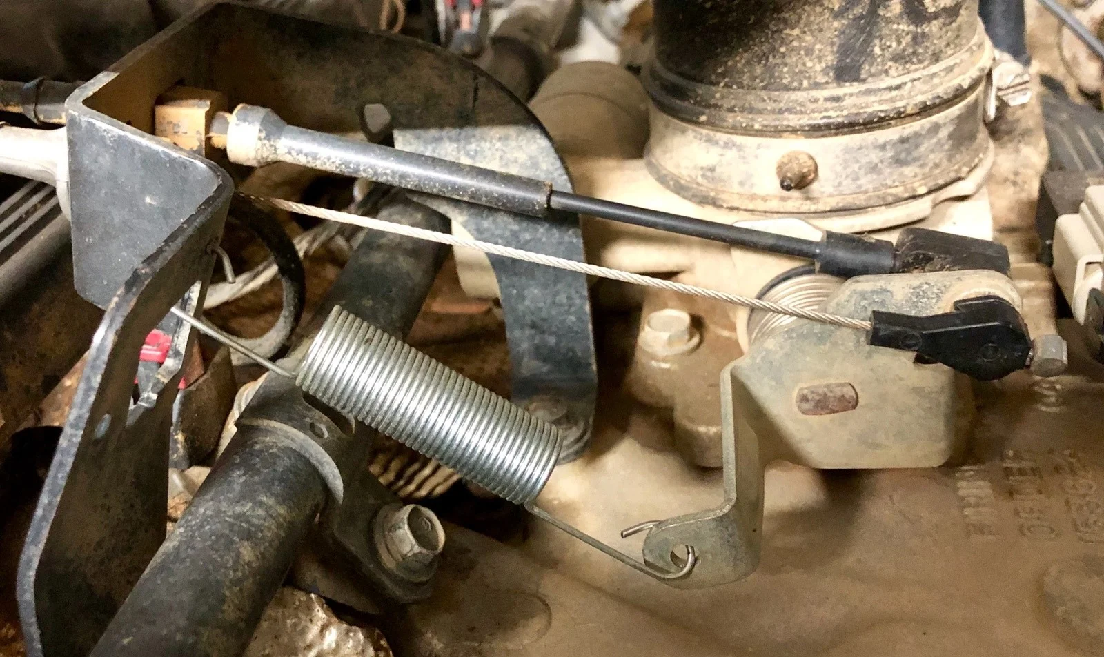

Can someone share the part number for that spring? I have felt the same "lurching" and if adding the spring makes that better, I will go ahead and add that for my '05.
https://wranglertjforum.com/threads/missing-throttle-return-spring.12513/
I think I’m 03/04 they removed the extra throttle spring. We talked about it in that forum post. Mine was just as you described, added the spring and much easier to control now.
I dont have a spring or anywhere to attach one. My setup is like the pictures posted by KCsTJ on the thread mentioned above.

Thats how mine was, a pain over rough terrain, here is what I did to fix it. Spring kit from Autozone.

I put a heavier spring on mine too. There was a pack available at Oriellys with a bunch of different sizes. Ive been running that same spring now for 4 years.

Back when jeep engines still had carburetors an additional throttle spring was a common "fix" for a jerky or oversensitive throttle in low range on rough terrain. The idea was to make the throttle stiffer to reduce pedal movement from minor foot pressure changes.. Another method was to lightly brace the right edge of the throttle foot against the transmission hump to reduce foot movement during bumps..
I used an additional throttle spring for the Hesco fuel injected 258 engine in my CJ-7. I haven't felt the need in my LJ, but I still have a collection of old throttle springs in my bins of miscellaneous fasteners and hardware "just in case."
Reactions: JeepZilla380
When I put a mc2100 carb on my 258 I fabbed up a bracket with two big ole springs to help with the touchy throttle response. Getting rid of the emissions crippled Carter carb was one of the best thing I ever did for that engine.
