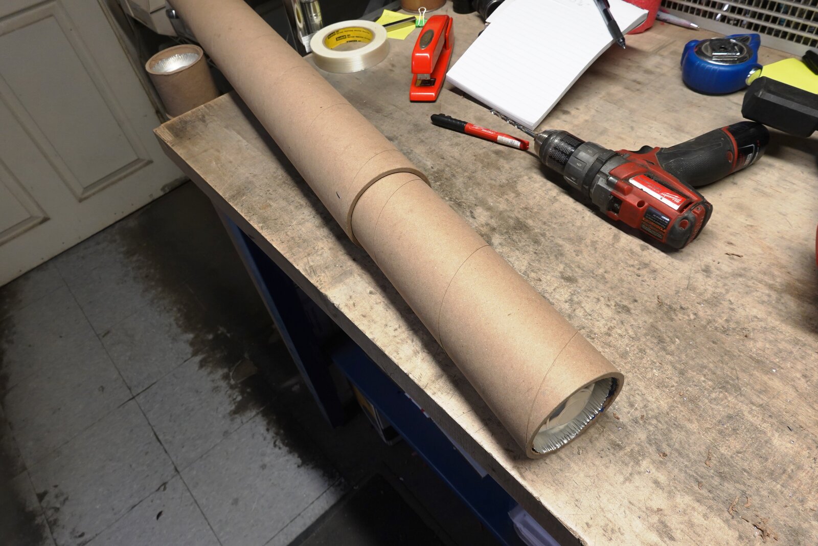

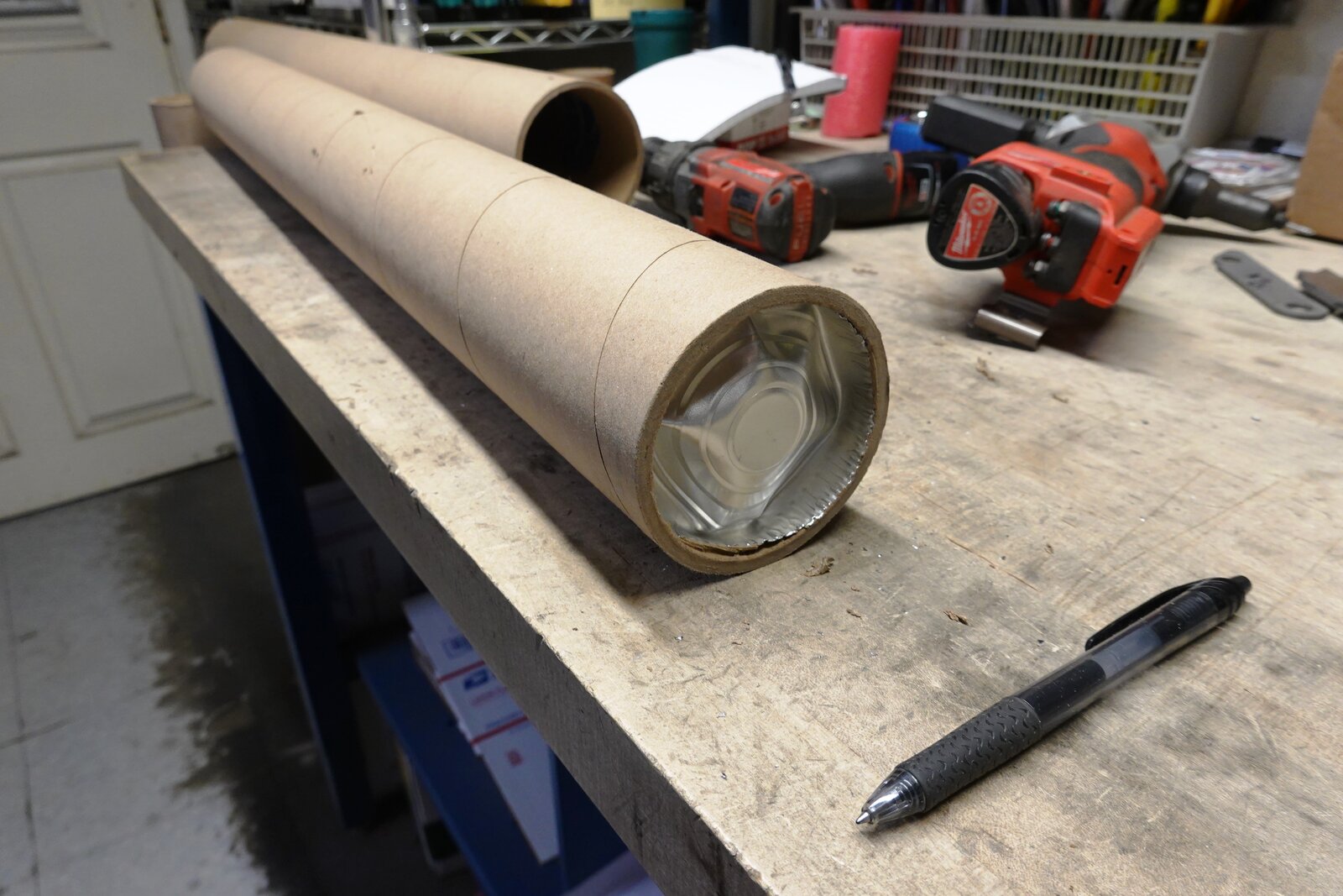

Here are the results of my testing.
First of the metal end cap as they come to us.

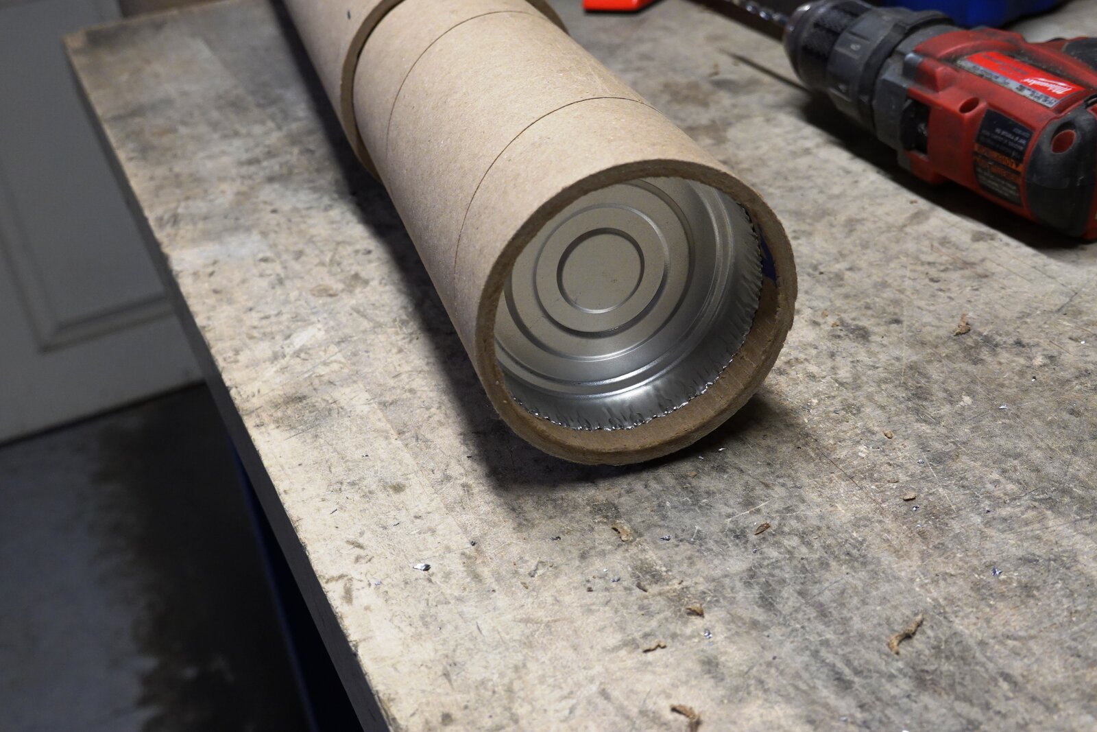

I have a 12" high mark on the packing bench leg. This is one drop from 12" with the tie rod centered on the cap. You can see significant deformation and the cap has moved toward the end of the tube a fair bit.

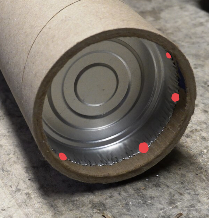

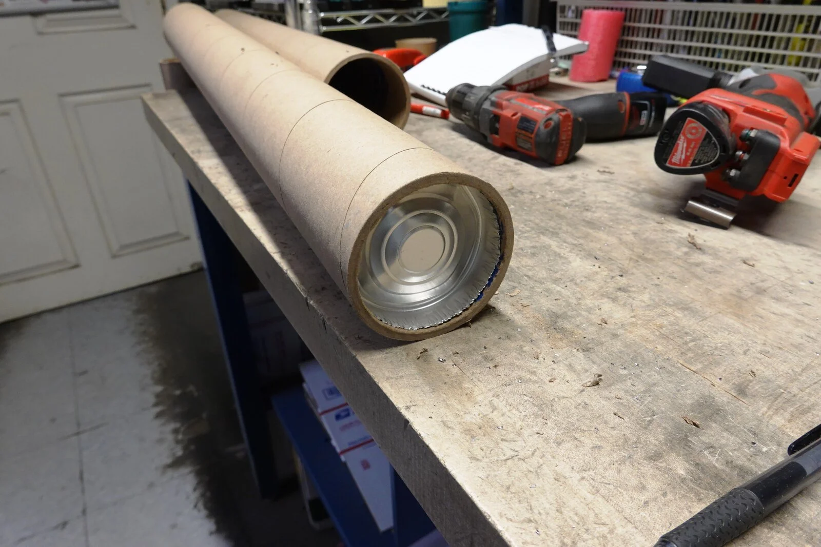

Second drop from 12". Far more deformation of the cap and now if it tags something while laying flat, it will likely punch the end cap out completely. Worse, the end of the cap is very sharp and will easily slice through any tape or plastic that I attempt to restrain the cap with.
The tubes are heavy enough and then some, I just need to find a way to mechanically restrain the end caps.

If you look at the test I did, you will notice that as the center deforms, it pulls the rim inward away from the tube which loosens the press fit and allows it to move easier.Can you punch the inside of the cap into the tube so it bites into the tube if forced out?
