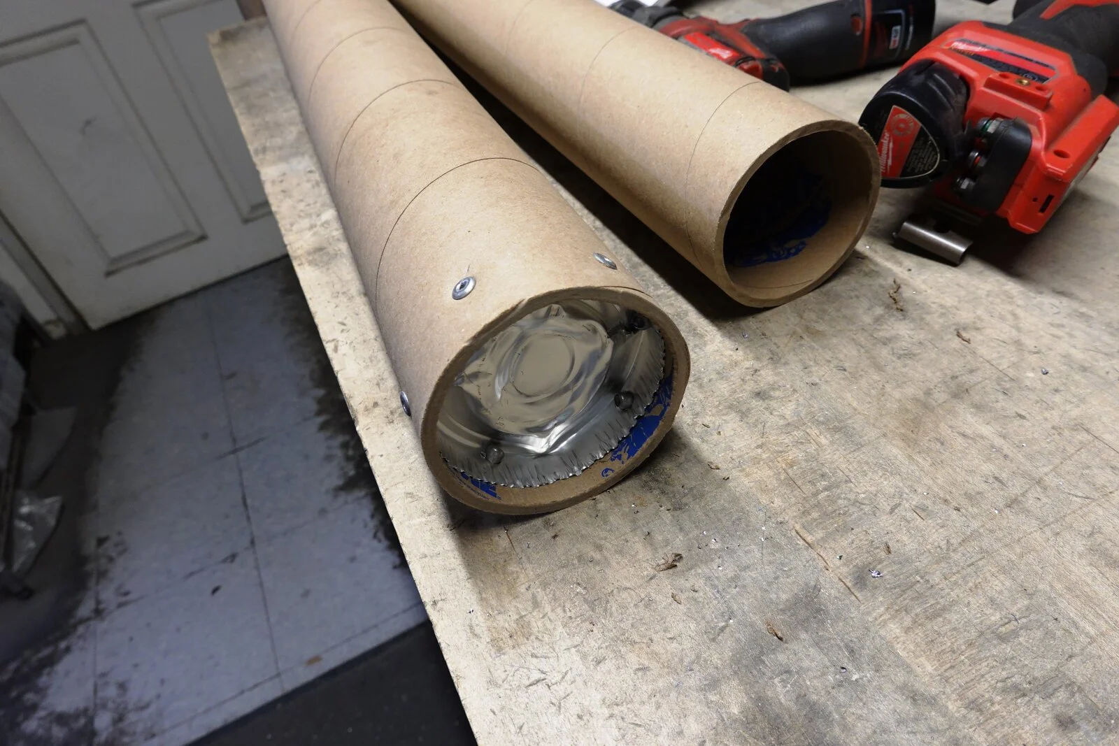

Drill a couple holes and pop rivet the caps in.
I've been testing that. I used some of my expensive rivets on a few and ordered in some cheaper ones to see how they will do. If I can get the load spread out over a larger area, it seems like it will work other than the additional time it takes.
I do have to wonder if you didn't recognize the Milwaukee rivet gun in the other pics though. ;)

All arguments aside, when I used to have my restoration shop we would get stuff in tubes all the time. The ones that seemed to arrive in the best shape had end caps like your new tubes, but they had 2 or 3 heavy gauge staples through the tube into the flange on the cap. I think that would provide enough additional resistance to movement of the cap.
I'm on the hunt and have been for that stapler. There are several versions of anvil staplers out there but they don't tell me what they will punch a staple through.

As far as the sharp ends of the tie rod tearing the metal caps...perhaps cutting the tops off of the PBR cans, filling the cans with that expandable foam insulation and then jamming a can on the end of each tie rod before putting it in the tube would spread the force enough to prevent tearing.
Oddly or perhaps not if you know me, we do not have any beer cans in aluminum here, nor do we have any other aluminum beverage cans to cut up. I may be able to find one or two cans of root beer long expired to use but that doesn't solve my problem long term.

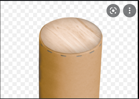

If I can get the wood end closure, this all gets very simple and fast. I have or can get the 1/4" crown stapler to shoot the end caps in. That would take seconds. Drop a wad of butcher paper in each end, slide the tubes together, staple them to prevent them from sliding apart and I'm done. I go from 20 minutes per package down to 3-4.
That's the ticket.

we get tubes of all kinds of materials shipped in . some have staples, most just use cheap ass sheet metal screws to hold the metal caps in.
If I can determine whether the stapler would work, that is on the top of the list simply due to speed. My hesitation is we have an air power carton closing stapler to shoot down the flaps on the brake kit boxes. I shot the tubes with it on the overlap section to see if it would work for that and the staple didn't even penetrate the cardboard, just bounced off the surface and shot the gun up off of the tube. I then leaned into it hard and all it did was wad the staple up in the plunger chute and jam the gun.
we used a roofing staple gun and often cut wood plugs if we couldn't salvage a metal 1.
woods expensive and time consuming but holds great, but 4-5 sheet metal screws zip in to those metal plugs pretty quick. i'd see deformed caps all the time but rarely did they break out.

It would take at least 3 dowels since the tie rod is 1 1/4" in diameter, x 2 tubes, = you need to show me how to do that fast.

Solid would be best and I'll switch to that when I find out the end closure that works best. For now the reason they telescope is so I can put high density foam in the ends and then compress that by sliding the two tubes together by putting one against a wall and leaning on it while I staple or tape them together. With a fixed length, that gets harder but if I can get the wood end caps made it gets very easy. I'll figure out the tube length that works and cut longer ones down to work.

That is a crown stapler. ;) I'm familiar and we have all manner of them ranging from 1/4" all the way up to 1". That part is easy if I can get the plugs made.

Temporarily, I may have to make some 1/2" thick plywood ends to drop in on top of the metal caps. That will spread the load out to the rim and slow down the deformation some.
