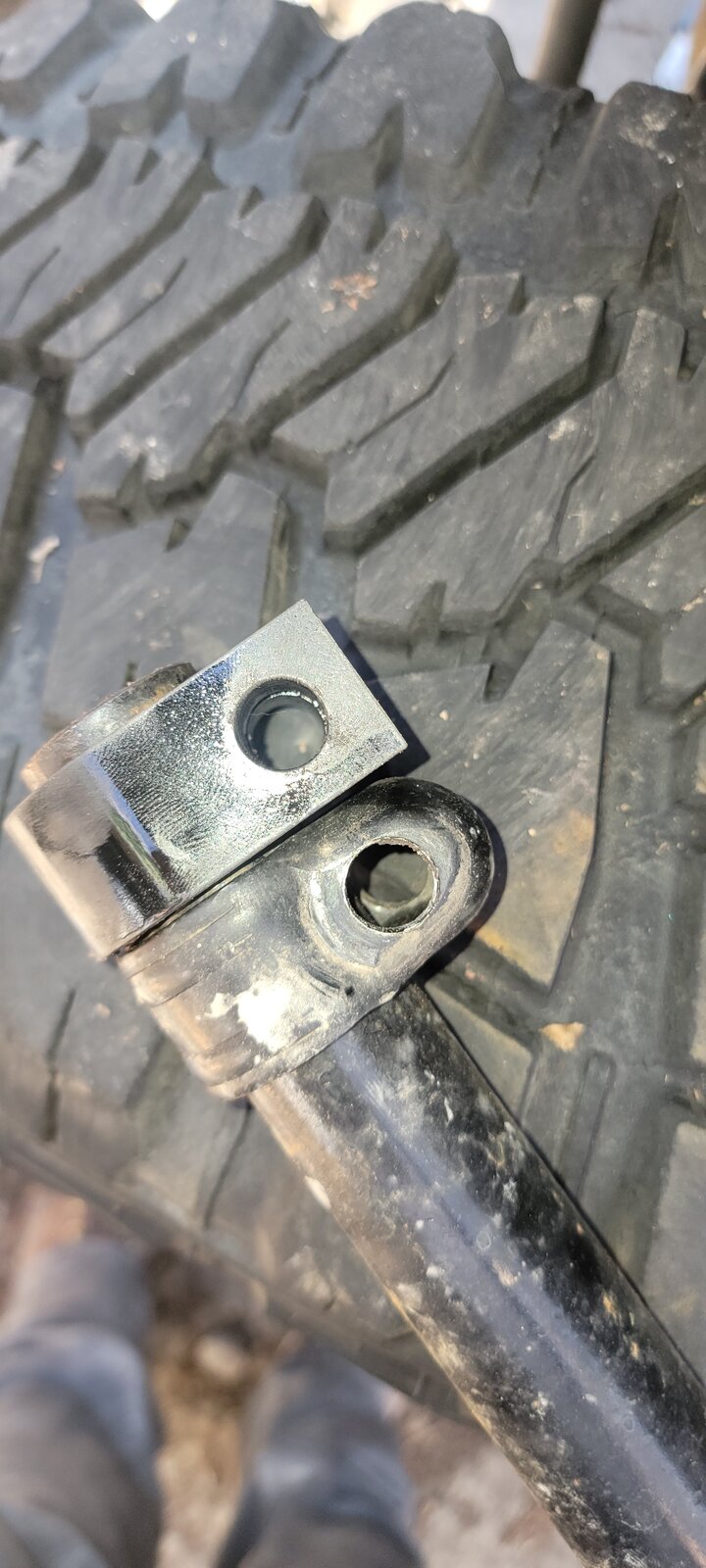

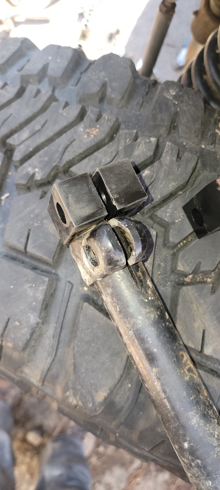

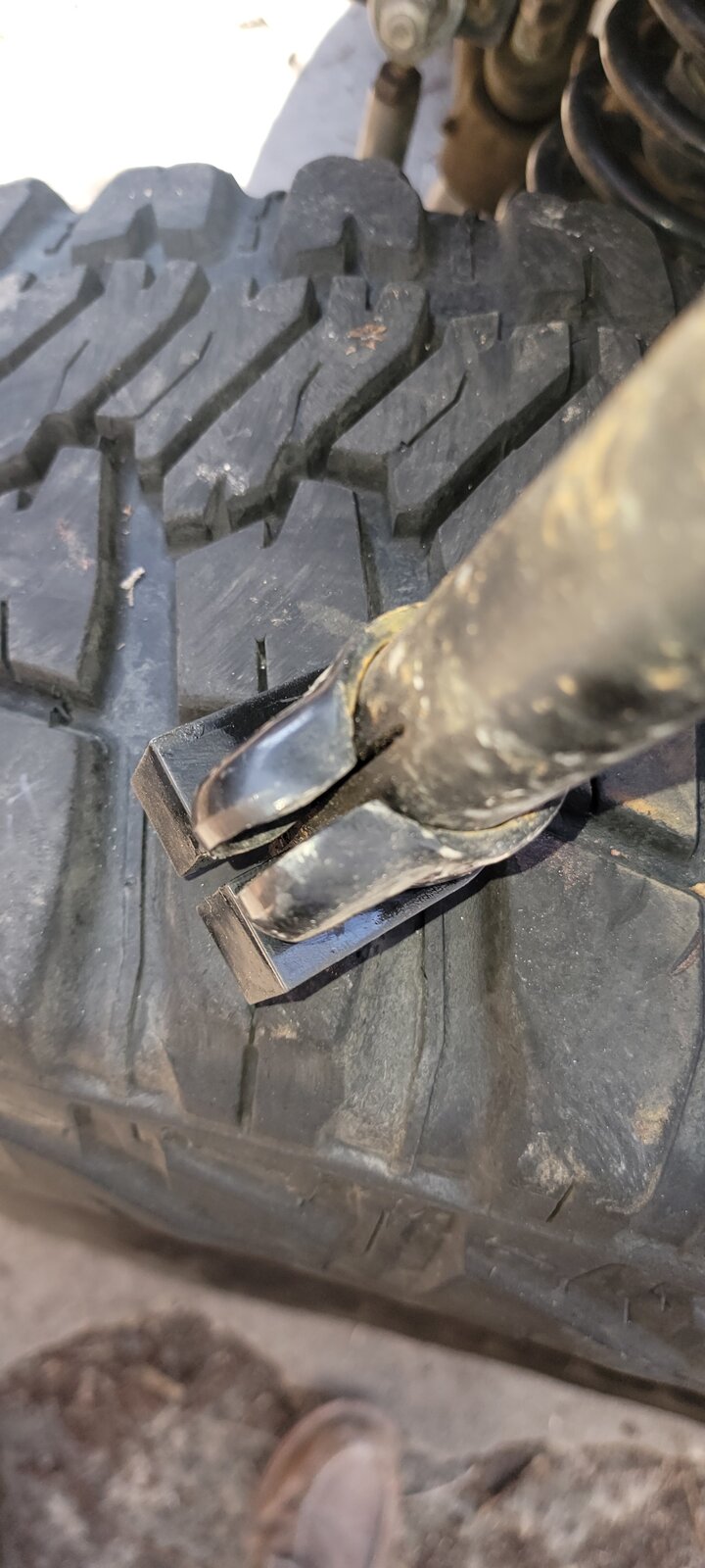

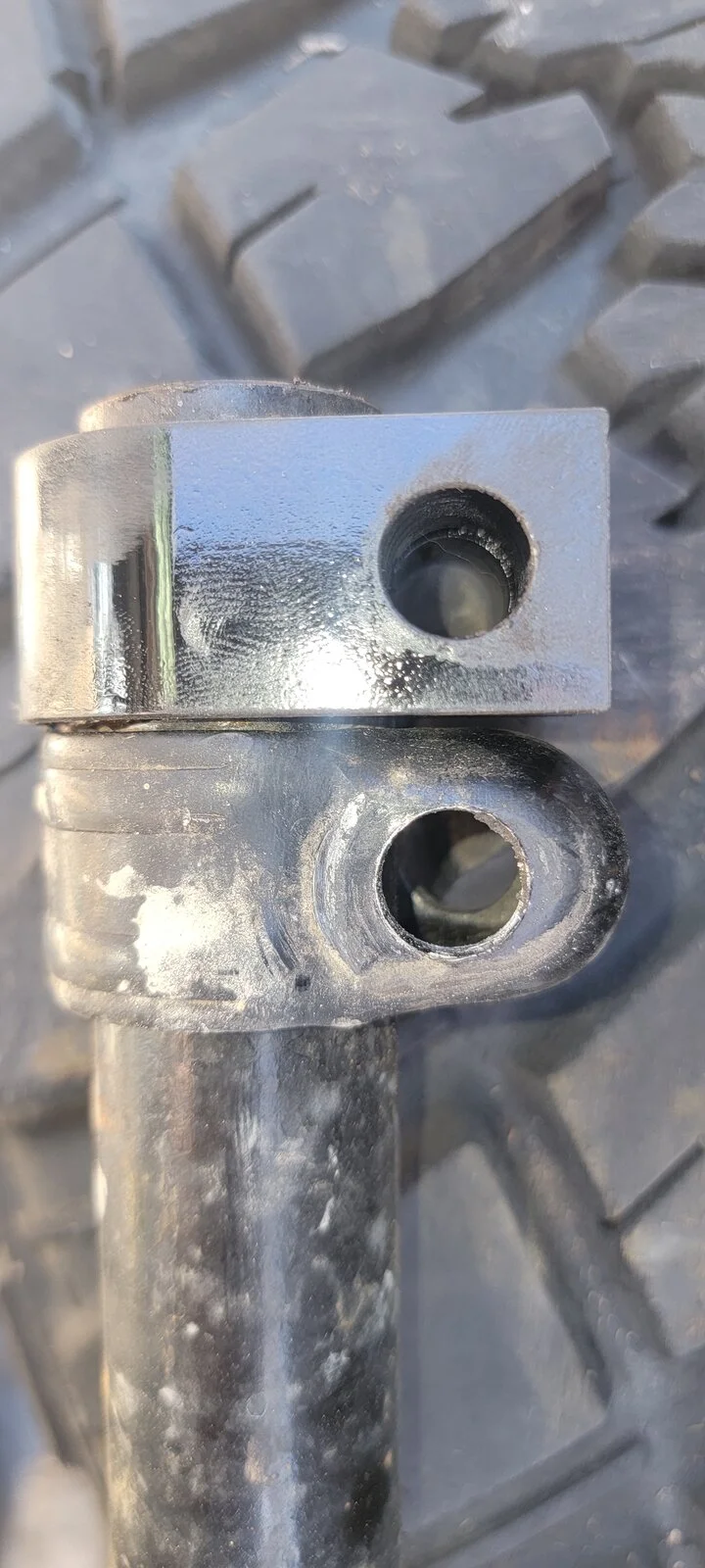

Some of us and you know who you are, tend to need things that are a bit tougher than the standard fare. As such, I had my machinist make up some extra heavy duty clamps that will take a lot more punishment should the need arise.
Not cheap, but most tough things typically aren't. These first versions cost me 30 bucks each plus a bolt, washers, and nut.
Future versions will come down in price some and hopefully they can get out for 60 bucks a pair including shipping, hardware, and Loctite for the nuts. That will be for a stand-alone upgrade. They will be offered as an option on the tie rod over the regular clamps and the cost of the regular clamps will be deducted from that so likely a 40 dollar upgrade at that point. I'm going to try and get that down to 35 but I have my doubts. I'm also not sure if I should add to the cost by getting them plated or let ya'll just rattle can them to keep the cost lower.
These have a through hole specifically because the two bores misalign when the clamp is tightened. That messes up the bolt, the threaded hole, and causes bind which reduces clamping force. The holes are oversize slightly to compensate for that problem. View attachment 317046

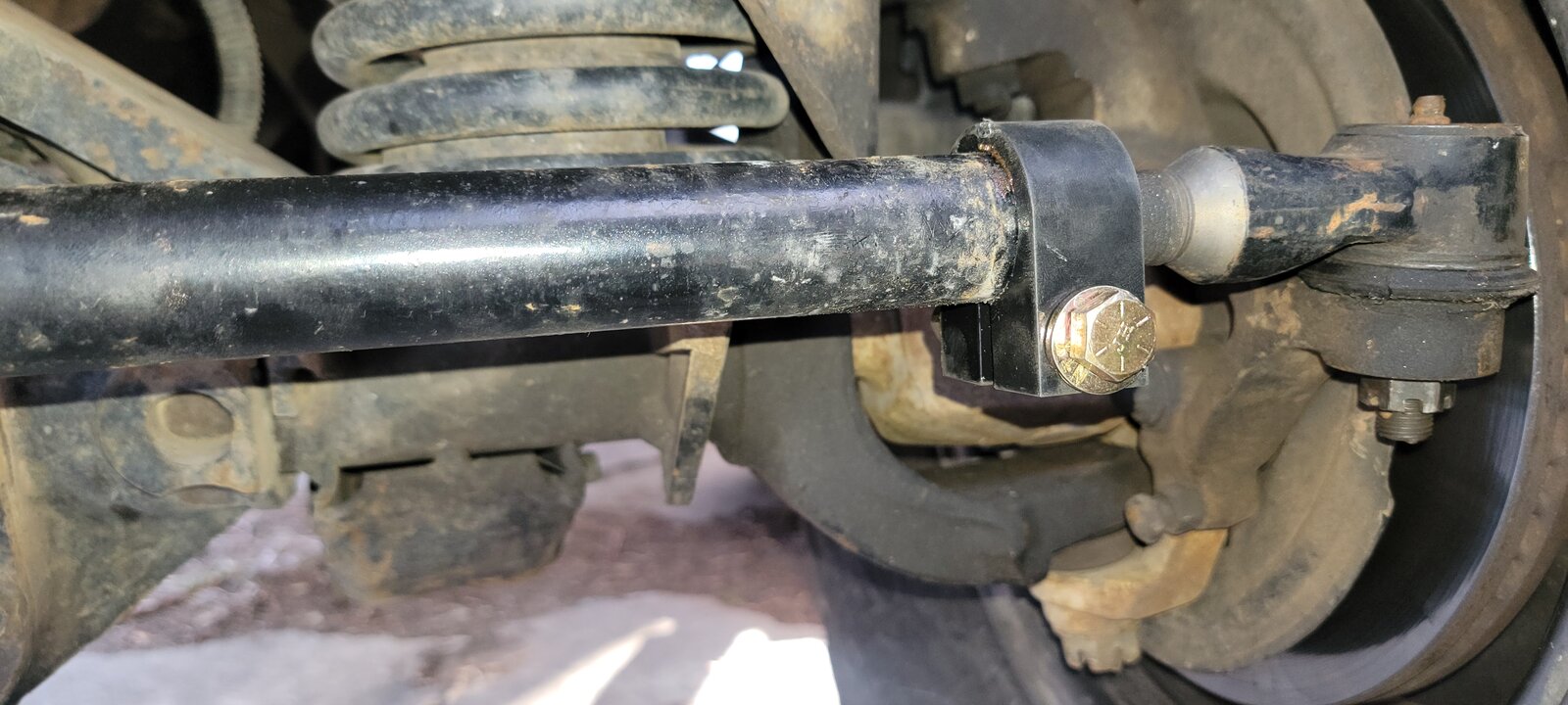

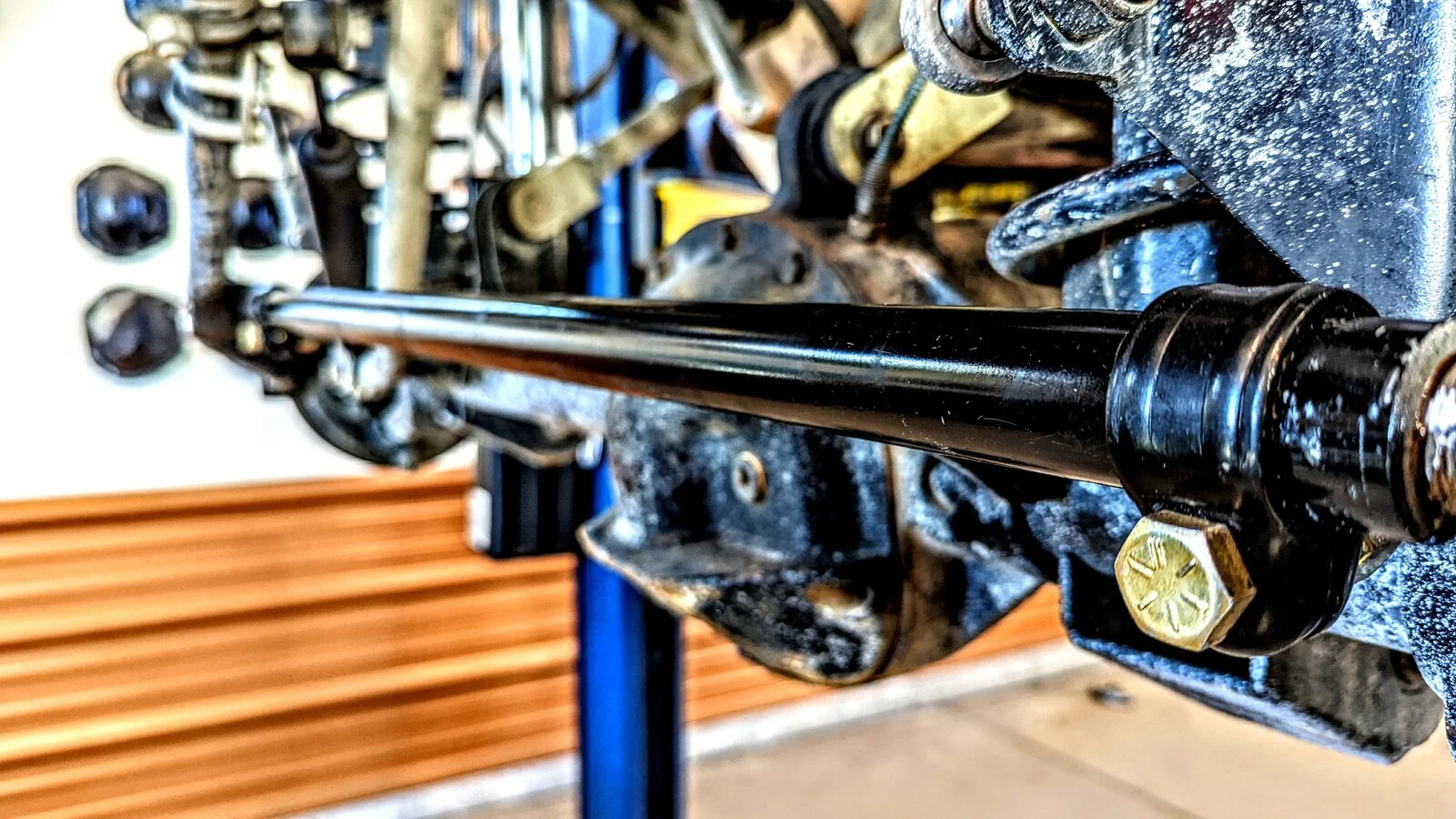

@mrblaine can you elaborate on clamp orientation. My thought is to keep the cut slot oriented down and then align the clamp the same way as shown in the picture. I'm my mind this allows for the clamp to "close" the slot and create the needed clamping force. Plus, in this orientation, it keeps the passenger side clamp out of the way of everything. Is it not necessary to align the clamps in any particular orientation?
Like pictured regardless of slot orientation.

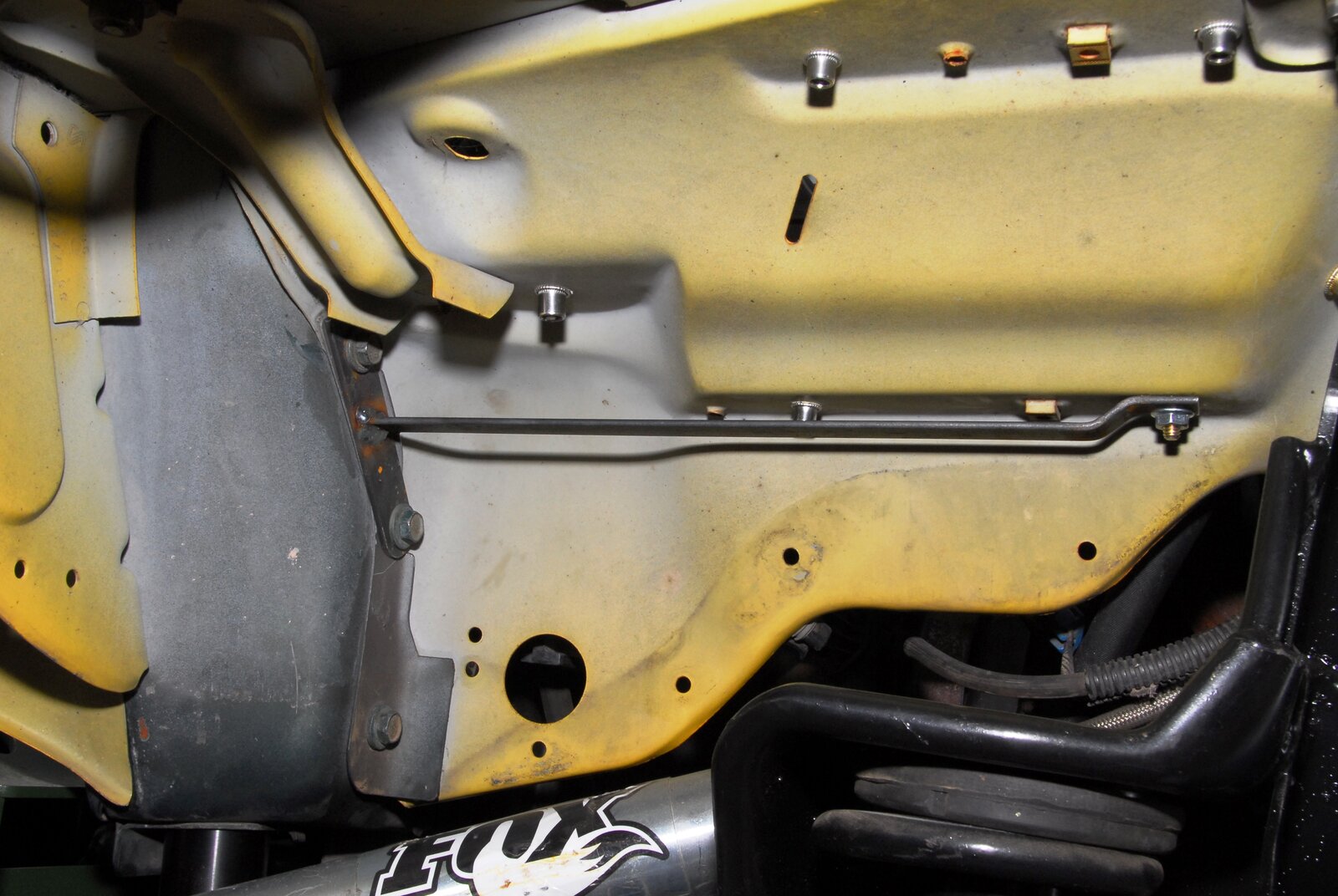

These should be available soon. They were inspired by us making the same reservoir mount over and over. This is a rough hand built prototype. The laser cut and bent versions are much nicer.

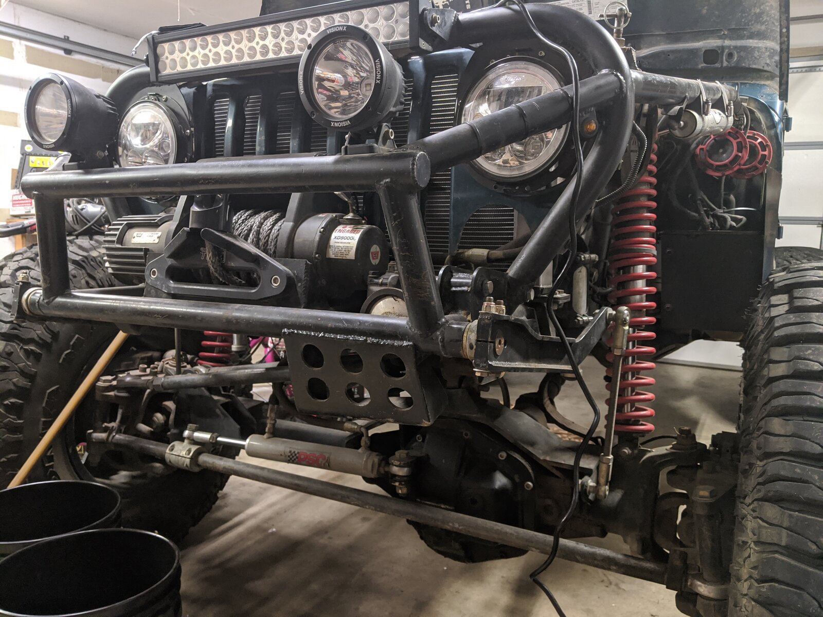

For those that may be hesitant, I ran one of his custom made for my full width for seven years of hard wheeling and prerunning KOH, and I've wedged a rock between the tie rod and diff, hung the front and had to drive back against it on Sledge plaque rock. It was probably flexed 5-6 inches the guys told me. I thought I was going to break a hiem. Only the slightest bend in it after. :D Great product.

Love all those lights, Paul. But, ahhh, just checking...do you, ahhh, have lockers???

Safety first in the desert! :D I like good lights, but have never paid for them. Fortunately I had a good friend working at Vision X that gave me a box of returns. Or else I would likely have some incandescent sealed beams.

They tighten up really nicely! There was no hint at all of the clamp stretching.
