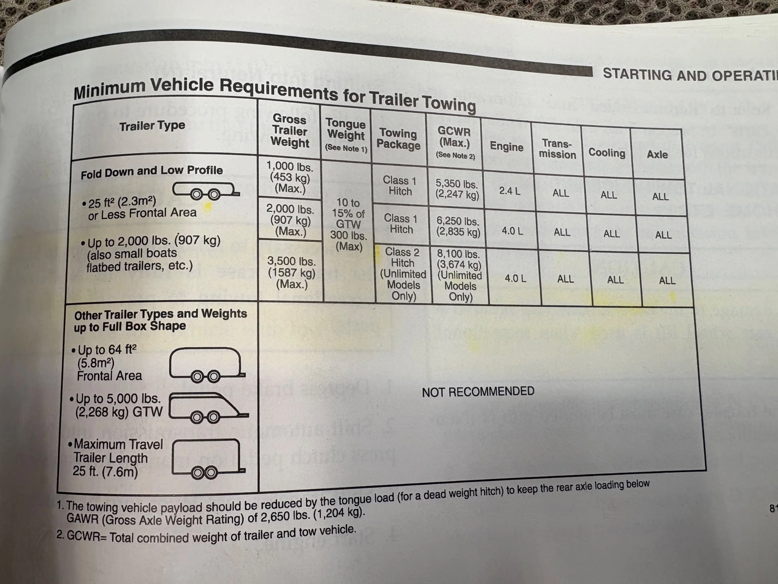

I’m personally not looking to get anywhere close to the TJ’s rating, it was just a thought I had where I questioned why the LJ specifically is rated less than the XJ considering it both weighs more and has a slightly longer wheelbase. Thanks to the replies in this thread I’ve come to understand there’s more at play like suspension, gear ratio, transmission ect. The most I’ll ever tow with my TJ is my little boat which weighs less than 1000 lbs fully loaded

Another oddball, this is at play on newer wranglers as well, is the LJ hitch is rated as a Class II, compared to the Class III on the tow package XJ.
Normally a class II is a 1.25" receiver, but, at least on the newer wranglers, it's upsized to a 2" reciever for accessory/mount compatibility. In either size, Class II has a 350 lb TW limit.
With the lower payload rating of the TJ/LJ, say 800 lbs. A 500 lb tongue weight would only leave you 300 lbs for passengers and cargo. Of course, that may make a great excuse for the wife and kids to stay home.
