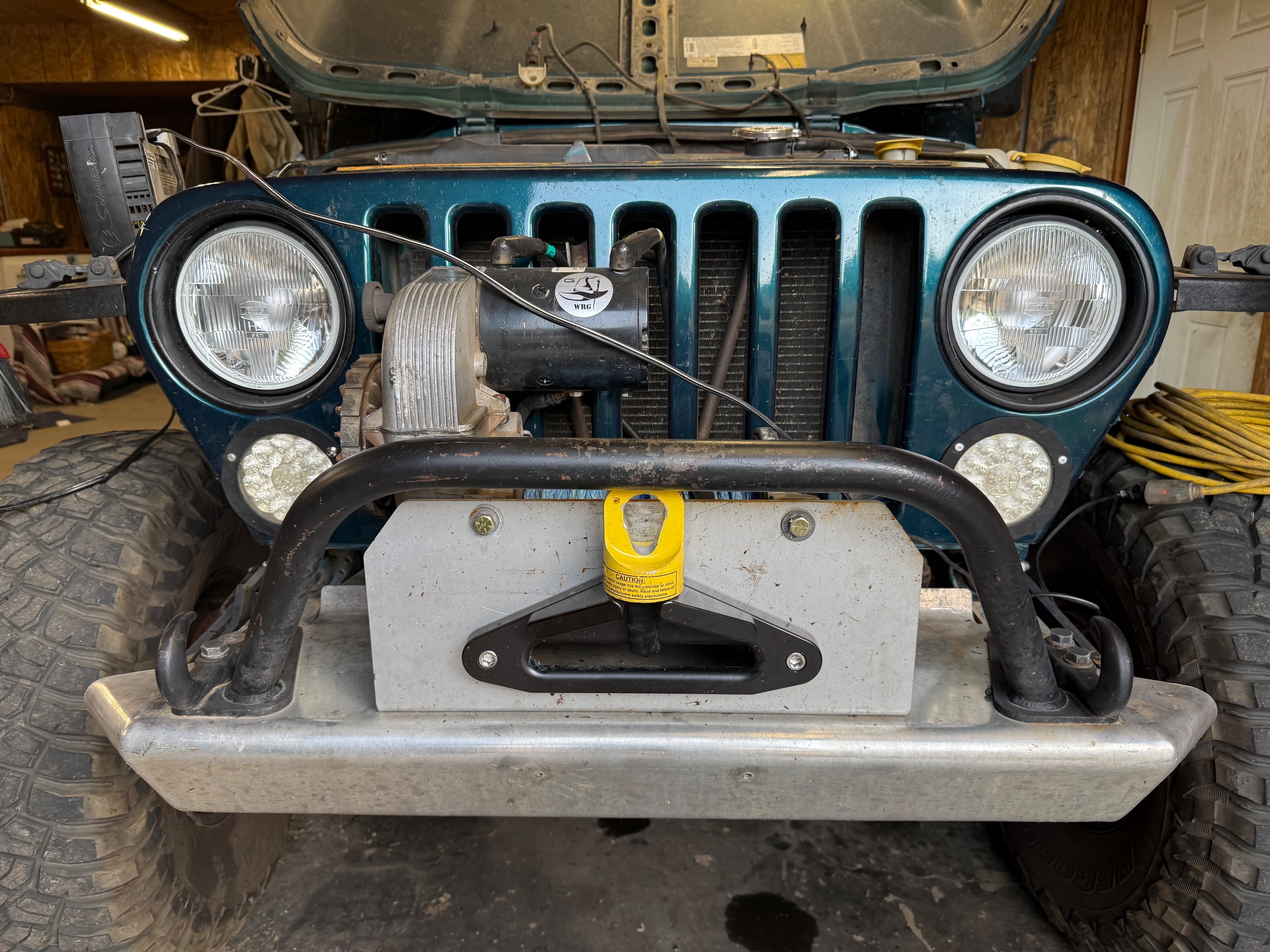

Toyota lights on your TJ! Cheap, quality LED alternative
I've got a set for my 71 chevelle sitting in the garage currently. Been running them on my jeep for a couple years with the hella bulbs.

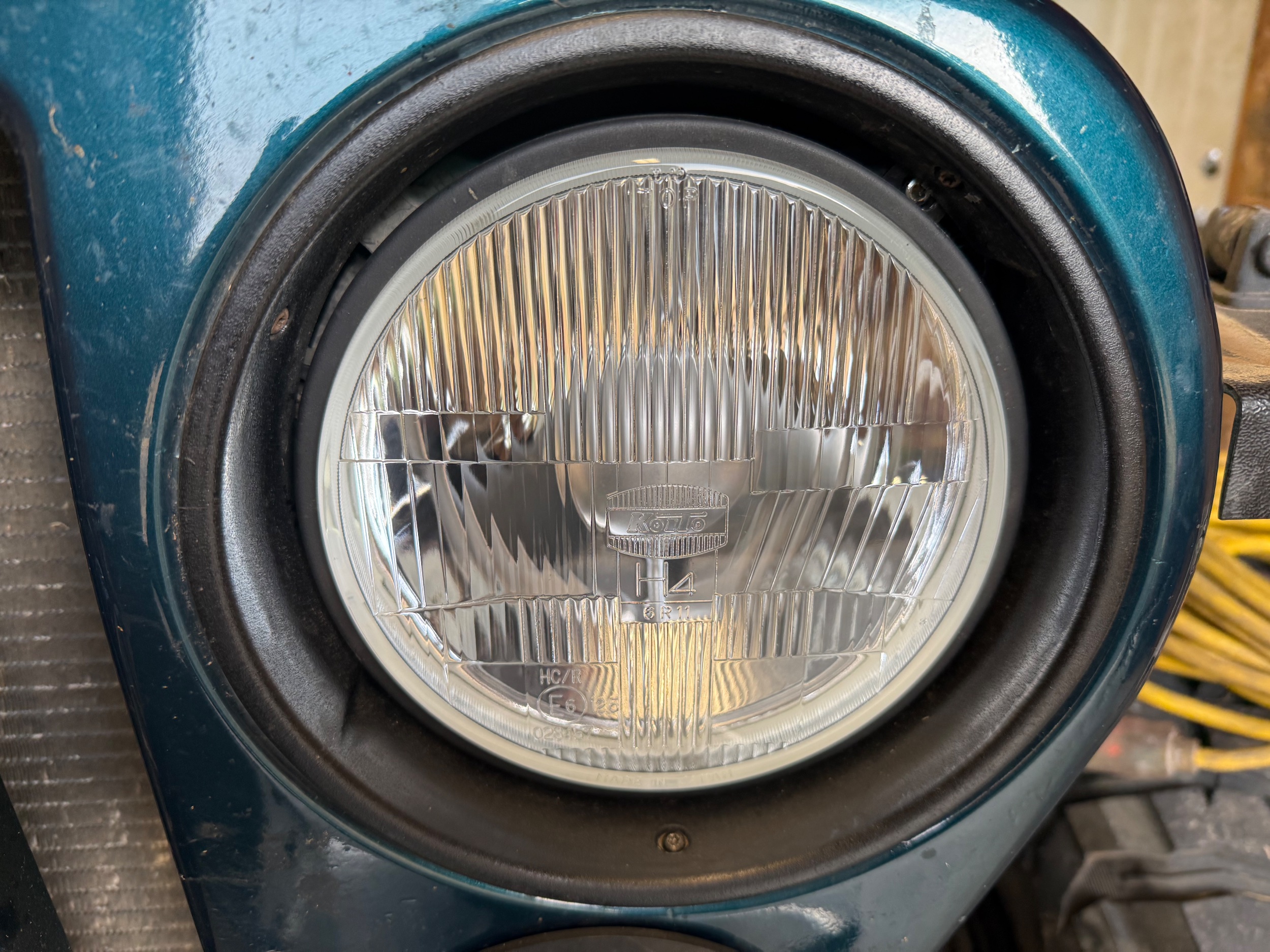

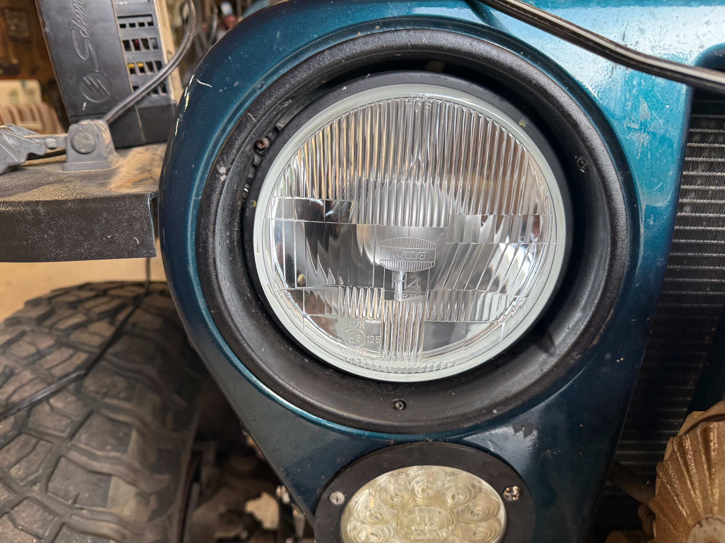

So I got a set of these yesterday and have been trying to get them mounted. The headlight retaining ring will not go down far enough to set the screws in place. I have not heard of anyone with these issues so am I doing something wrong? I see that these stick out more to the front than the ones I had in there but no no other difference. Any thoughts?

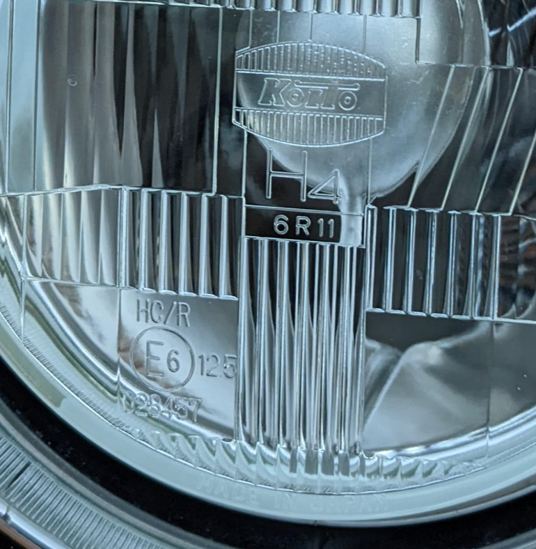

Devil Dog, I do not remember having that issue. Here is a shot of my Jan 2022 glass so you can compare the markings.

On mine its the ring that attaches the light to the housing, it doesn't want to drop all the way down from front to back if you know what I mean. The headlight is fine in the bucket, it's the ring on the headlight itself.
Make sure the tabs on the back of the glass housing are lined up well, and not sitting crooked and holding it out of reach
The only logical explanations I can think of for that is that your headlight glass is molded differently, or your trim ring is different. Did you compare the markings on your glass to mine?

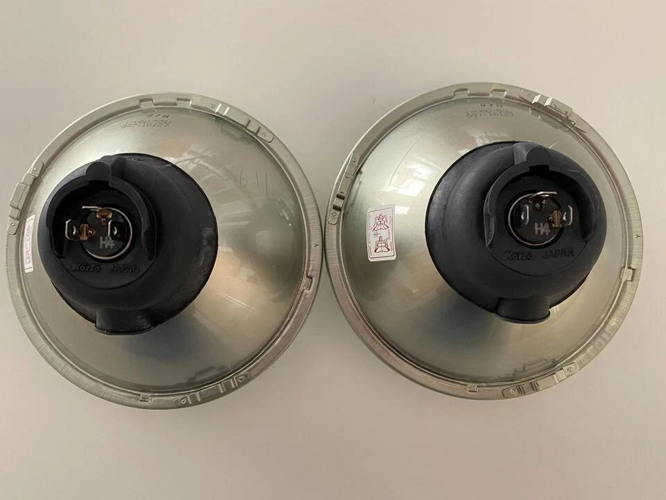

Here are pics of the backs from an Ebay listing. These in the listing have the same markings as mine.
More pics in the link (as long as they haven't sold):

These look the same as mine on the back. I don’t know if mine are ecode though I don’t imagine it changes anything

No they are aimed right. That’s my point, since I couldn’t get that ring all the way around it evenly it looks weird the drivers side especially but they are level at least.

I did get it in. On one side I ground the rim of the headlight down and got it to fit further down. On the other I just left it how it was, it sticks out more but I don’t care that much. Left I ground right I did not.
What are you grinding to make these fit? They should fit the stock bucket like any other sealed beam.
The glass is more squared off on the edges vs rounded, like older style sealed beams. That can make getting that grill bezel/ trim on tricky for the top outer corners.
The metal ring that holds the light to the adjustment housing should fit and should go on like normal.
Reactions: John Cooper
I ground the metal edge around the glass on the back side. I should have taken a picture but on my IPF lights the retaining ring sits all the way down, flush with the edge. On these it would not as it’s a few millimeters bigger. The ring would go down on one side but would stick up on the other side. I must be the only person to have this issue it seems like.
