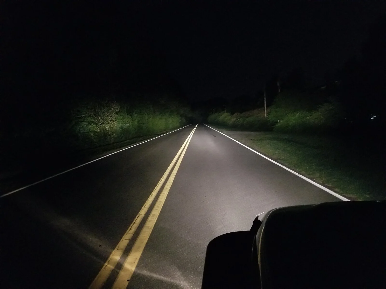

I wouldn't call the high beams ugly or woefully dim or bad. They are much better than the stock lights and Hella e codes I had previously. The beam pattern photos I posted in this thread support that I believe along with the beam pattern photos in the ih8mud link.

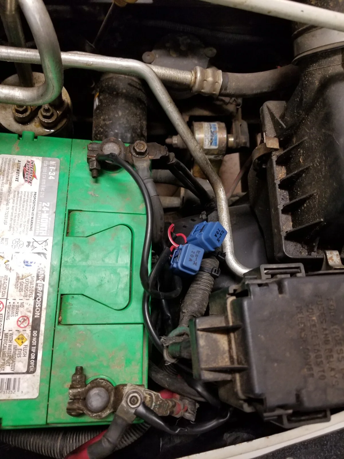

Here is my beam pattern with Hella 100/80 bulbs. Also a photo of my harness connected to my factory terminals on my 05 lj. I posted these photos previously in this thread.

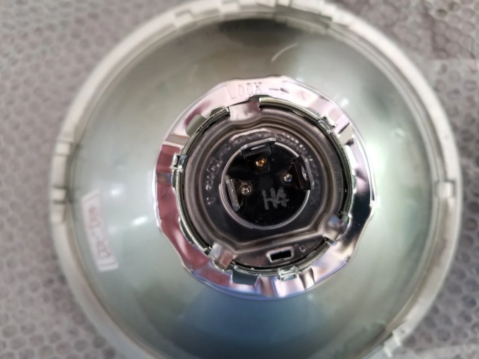

So this may be a dumb question but I have no experience with H4 bulbs. I went to try and install the 100 watt hella bulbs this evening after I aimed the headlights and I can’t figure out how to get the bulbs out the Toyota housing. Any pointers?
Grab the connector of the bulb and rotate counterclockwise. It will turn about a third of a turn, and pull out. Look at the three tabs on the new bulb. Notice that they are different sizes, They have to be lined up with the right size slots to insert it into the housing.
Take the boot off. Then you have to twist that metal collar that says lock the opposite direction of the arrow etched into the metal collar. Pic of the back of the housing you can see the lock wording.
