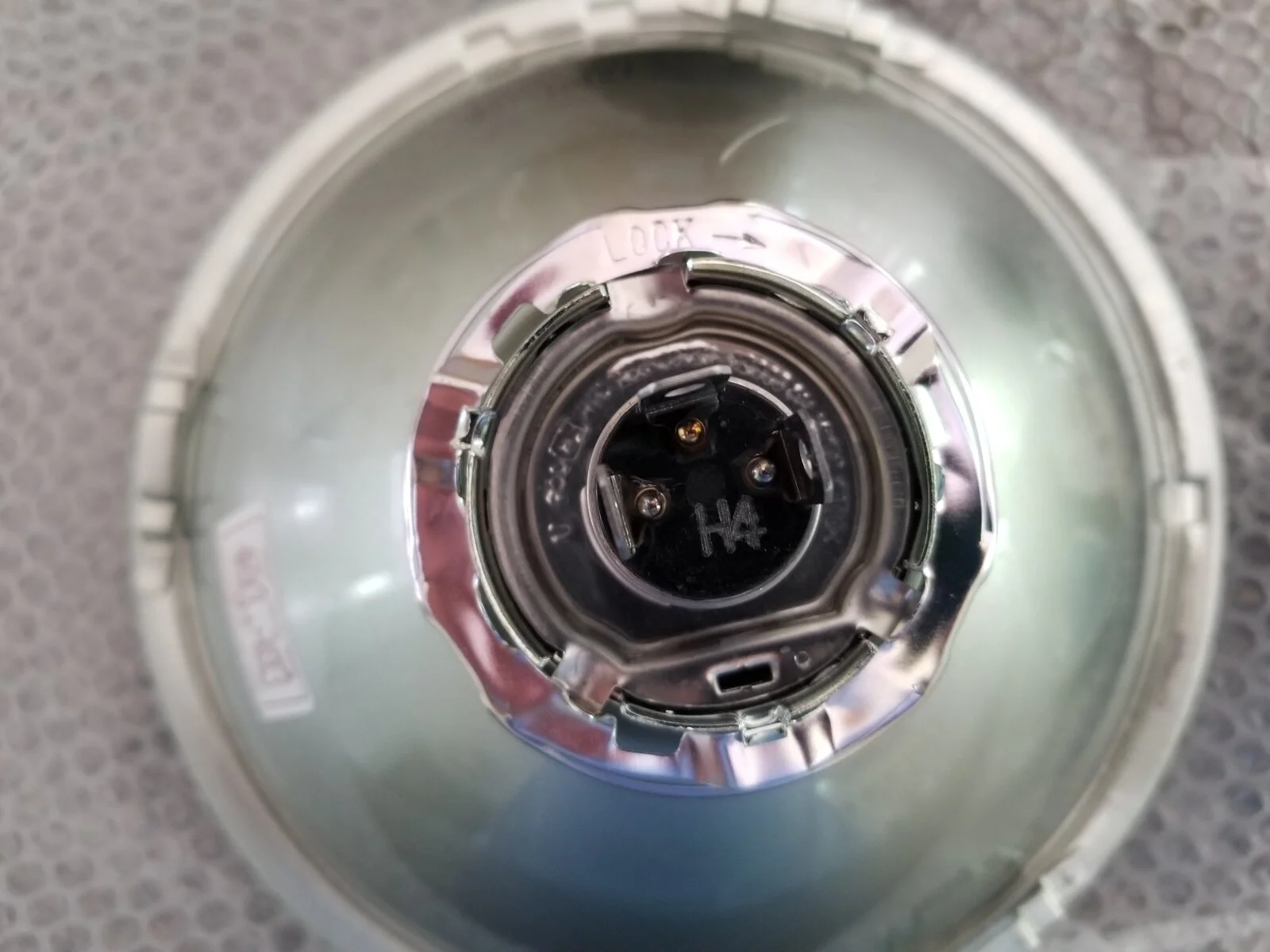

Take the boot off. Then you have to twist that metal collar that says lock the opposite direction of the arrow etched into the metal collar. Pic of the back of the housing you can see the lock wording.
I thought that ring needed to come off but was struggling with it, since they are in the mounted already. I’ll have to try again tomorrow.

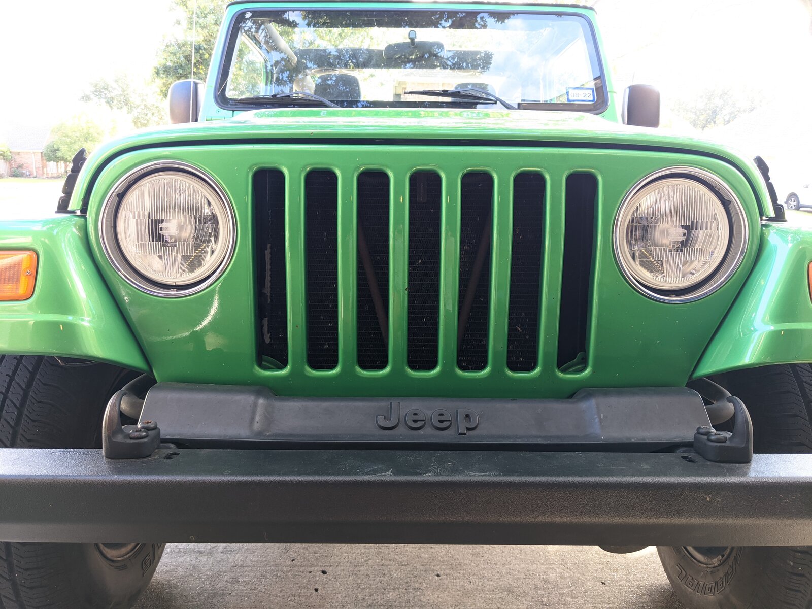

Got these installed with the harness over the weekend. The lenses are beefy. I was a little worried about the look with the hard shoulder on the lens edge but i think it looks great - better than stock. Haven't had a chance to aim them yet, but the brightness and color are improved over the Sylvania sealed beams that were int there. I might throw the Hella 100/80 Quadratec bulbs in the cart on my next order to try them out. Overall, I'm very happy with the way it turned out.
Love the harness with the kit and will absolutely be upgrading the H4 bulbs at some point in the future, but these are so much better than stock. So much.
Nice... at less than three bucks per bulb, it doesn't make sense not to upgrade them if you did the harness install.
Maybe you've got it already but I just removed the housing to change the bulbs. The rings were tight enough that I was worried about breaking the light bucket or something else trying to take the ring off with the housing installed.
I was able to get them off while still installed in the jeep but it is a pain in the ass. I had to put gloves on to get a better grip.
