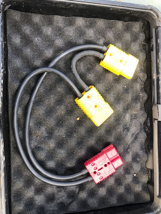

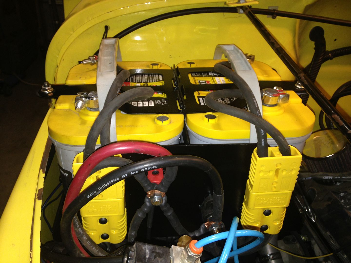

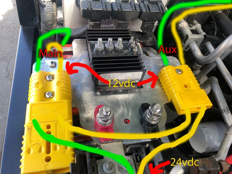

Rick, if the batteries are not connected to the vehicle, then you can use the readywelder on your own vehicle. My system uses anderson connectors to create a 24v yoke for the readywelder. This disconnects the ground(s) and positive completely. It is like the batteries are just sitting ion the vehicle.

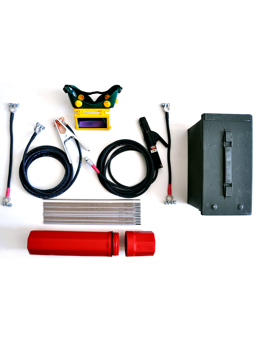

Stick setups are a lot cheaper at a couple hundred bucks for this one. And a lot cheaper than that if you assemble a kit yourself from Harbor Freight and a welding supply shop. Of course they come with the removing and reinstalling batteries hassle.
http://www.trailweld.com/View attachment 306787
All I care to carry is something that will stick metal together well enough to get off the trail and on a trailer. Fancy welding and repairs are best done indoorsAnd they come with limitations to. IMO they are great for trail repairs but that is about it. But yes they are cheaper but some of those other kits have come down in price.

Nice set up, where did you install the second battery in your vehicle?Rick, if the batteries are not connected to the vehicle, then you can use the readywelder on your own vehicle. My system uses anderson connectors to create a 24v yoke for the readywelder. This disconnects the ground(s) and positive completely. It is like the batteries are just sitting ion the vehicle.
The goggles look like the same type I carry. So far they have worked when I need them.Stick setups are a lot cheaper at a couple hundred bucks for this one. And a lot cheaper than that if you assemble a kit yourself from Harbor Freight and a welding supply shop. Of course they come with the removing and reinstalling batteries hassle.

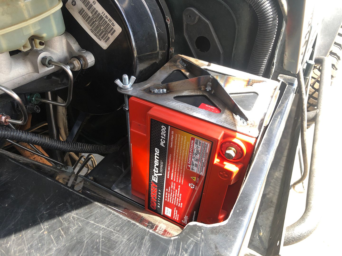

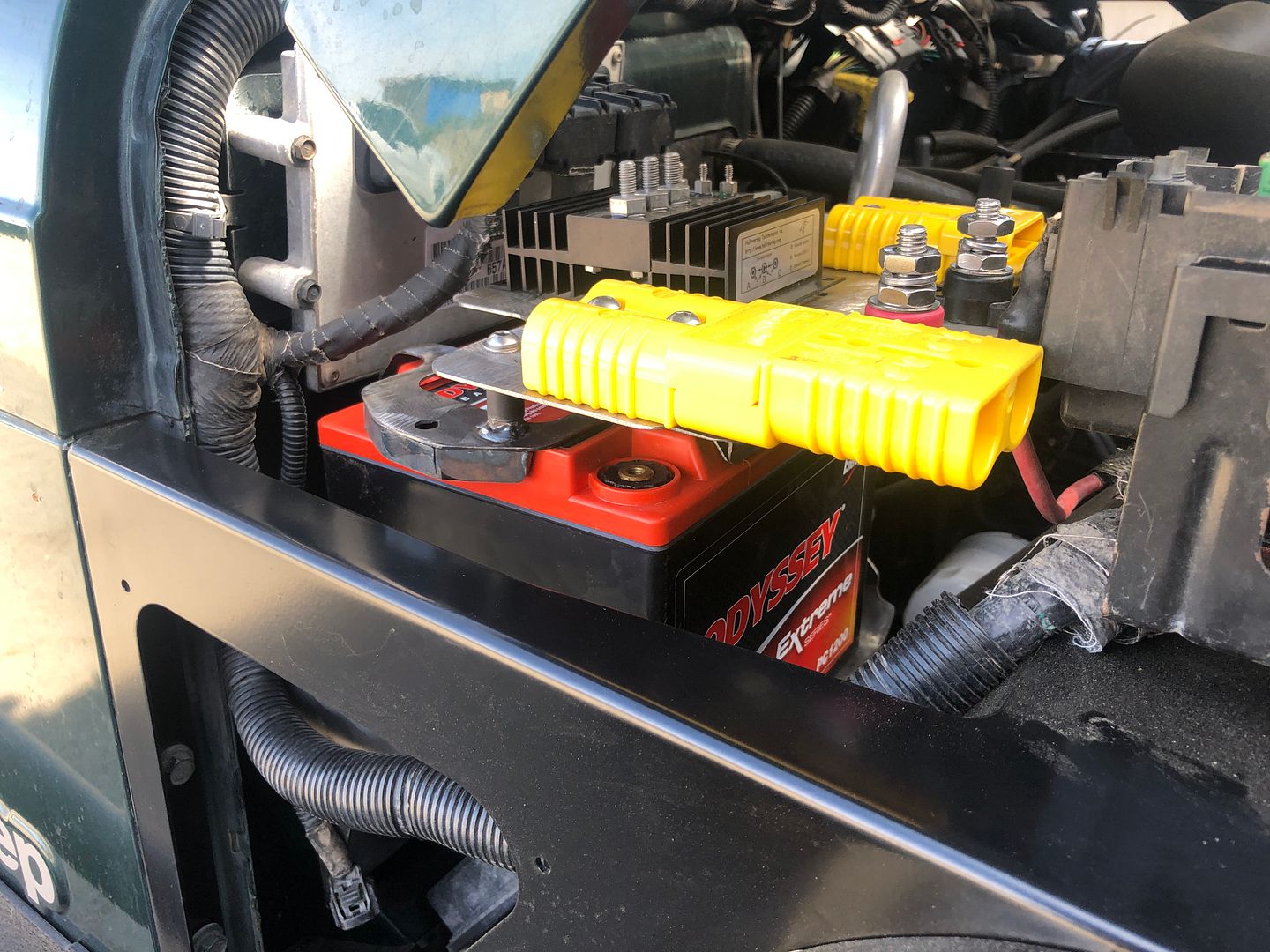

That sir was a chore!! I ended up putting it on the driver side firewall where the ABS pump thingy “used to be”. I had hoped to squeeze them in the same side like I’ve done on my other buildsNice set up, where did you install the second battery in your vehicle?
You won’t be able to weld much with 12v I tried that when I first bought my ready welder. I could not get a consistent bead.This one looks pretty dope actually, especially with the converter it’s talking about so it can run off a single battery if needed.

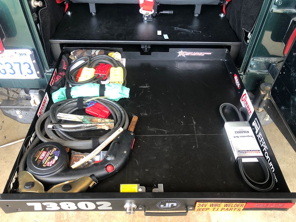

I was also thinking of just carrying a jumper pack then you could use the under hood battery and the jumper pack to weld. I used 2 agm batteries for my power box and I have a small charger. I need to rig up a cigar lighter plug and install one in the back of my Jeep to recharge while driving.That sir was a chore!! I ended up putting it on the driver side firewall where the ABS pump thingy “used to be”. I had hoped to squeeze them in the same side like I’ve done on my other builds
This is what I was hoping for:
This is what I ended up with:
Need more information on the web site maybe a videoMine run on 24volts be it from 2 12volt batteries wired in series at 24volts or 1 12volt battery to a step up converter at 24volts. I have only gotten great feedback from everyone that has one from me (71so far). Try it out sometime I’m sure you’ll be surprised
