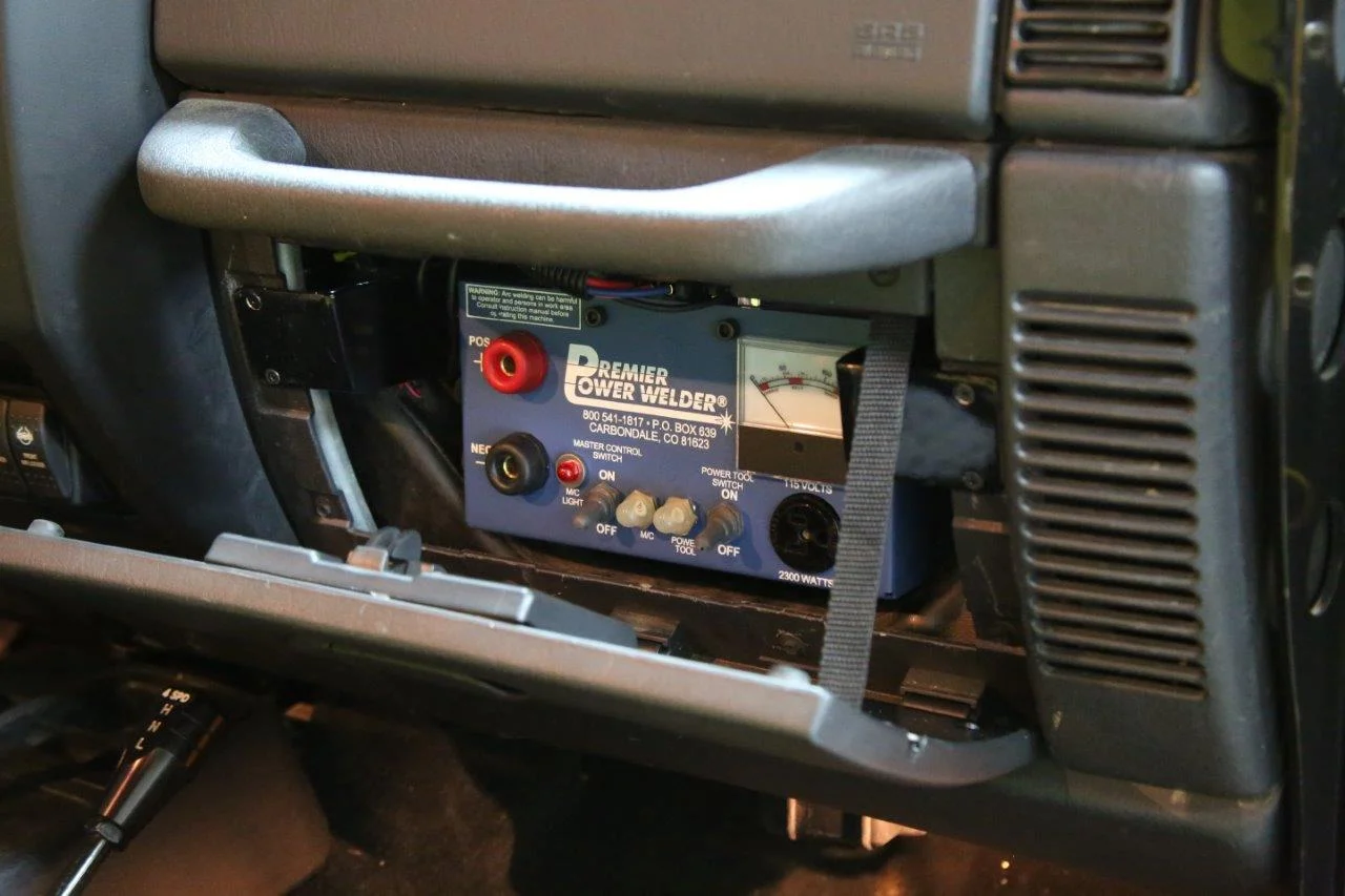

I agree with Nashville, if you know how to use it the Premier is a great welder and I've repaired more than one rig on the trail with mine. Jeff & I both mounted our welders in the glovebox area.
Great minds...
