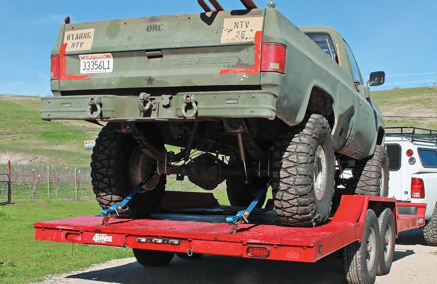

There is only one way to tie to the axles and not loosen all the remaining straps if you lose one. That is straight back. If they are straight back, you can stop it from moving with 2 straps. If angularity is introduced, the rig can move sideways to straighten out that angle and now all of the remaining straps are loose.

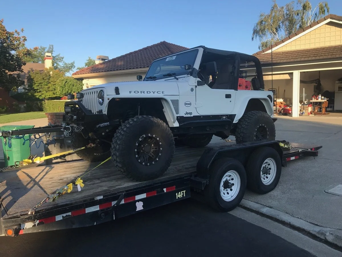

I used commercial grade nylon straps that went through my wheels. The front straps went forward and out from the jeep. The back straps were crossed and went back. I put the cross goes in the back because I read it on the internet (it centers the vehicle under braking). You can see one of the straps on the lower left of this picture.

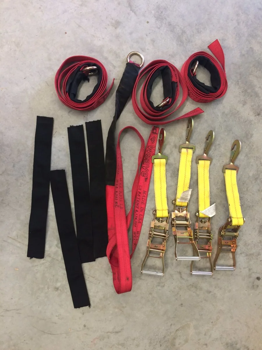

Ratchet straps hooked into the d-rings, red straps went around the tire and through the wheel, black sleevs protected the finish of the wheels.
Not..
Anyone who has experience knows 2 parallel chains will act like a swing..... which is why every professional driver crosses the chains...... and checks them regularly. Yeah sure it looks good in the driveway but wait till you need evasive steering on the Interstate.....
This is the industry standard. The lines need to be angled to be stable. Check the load, no matter how you tie down a leaking tire will loosen the chains.

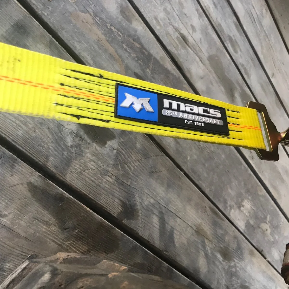

Just a google pic but this is exactly what I do with my jeep. Strap around the axle tube attached to my ratchet strap connected my trailer straight back / forward. 100% closed loop system. I use Mac's straps.
