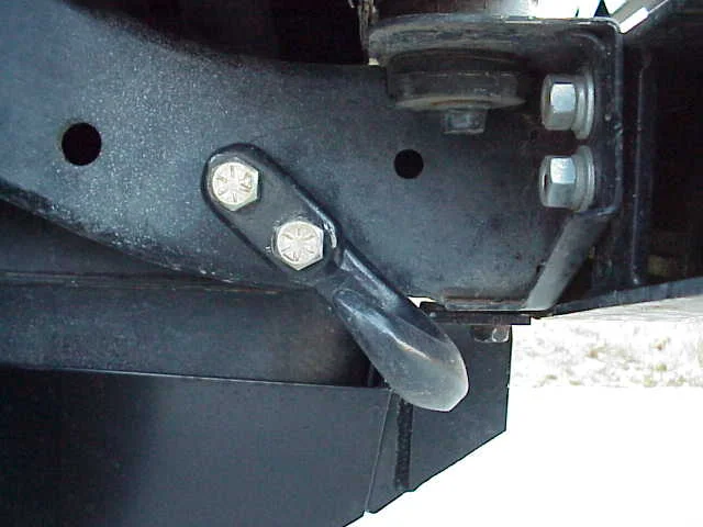

That's not a good type shackle tab to use, you don't want to use surface-mounted shackle tabs for vehicle recovery needs. Through-welded shackle tabs that pass completely through the bumper and are welded on both sides are the way to go.
I completely agree @Jerry. That was just the first picture I came across that showed a small Diameter shackle hole with no chamfer. I didn’t think about it misleading someone
