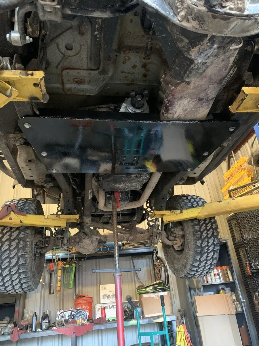

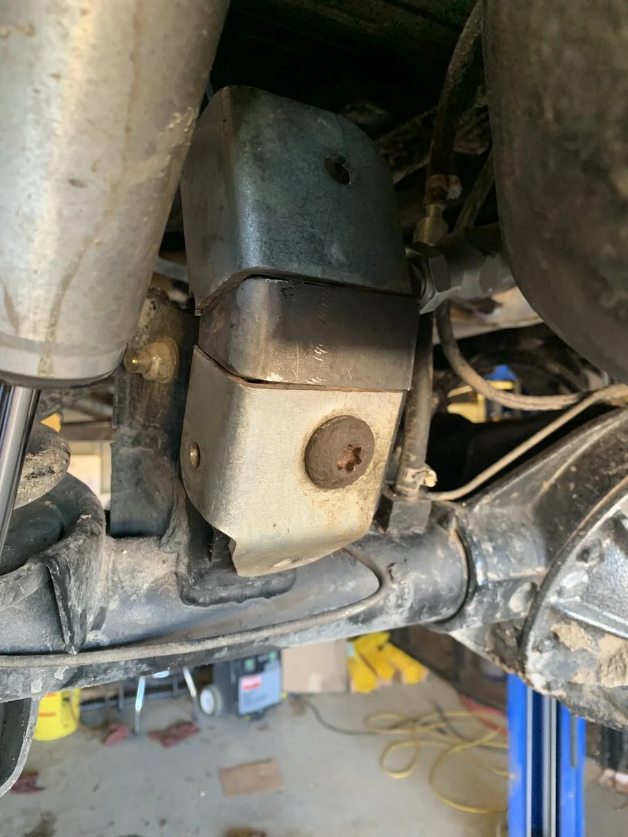

I got my tuck flat. I did some messing around with my track bar mount to get it to a point where I knew it was not going to contact the gas tank. I cycled the suspension. Ended up cutting some notches from the spring perches in the rear to clear the shocks. The exhaust on my Jeep just barely clears the skid plate. And I didn’t modify it at all. I just modified the hanger. I look at Jmt’s build and idk how I got away with only a quarter of the problems he had. It’s gonna be different for everyone depending on what u got. I got a 3 inch lift and As flat of a skid as you can get.
