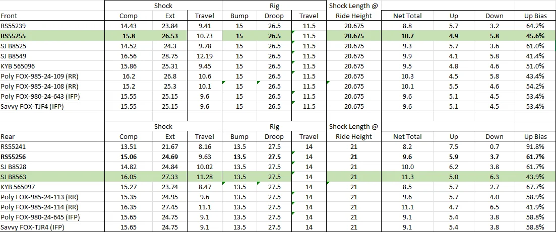

I put this little spreadsheet together so I could easily compare shocks side by side. All I have to do is find the compressed and extended lengths and add a row and it'll immediately tell me everything I need to know. Or if I'm considering a ride height change, I can just plug in the new number and see where I land.
The Rig measurements are just the distance between mounts that is at all usable, not counting any shocks or bump stop extension. Things like hard contact between components (including factory bump stops), springs coming unseated, driveshafts binding, etc. And then the stuff out to the right looks at the greater of compressed lengths (shock vs rig) and the smallest of extended lengths to come up with an actual net travel, up, down and bias.
I threw some Foxes in there a while back just playing around with this idea of a tunable shock in OE mounts, not totally confident that I have them identified correctly. I also don't know if I can compare the lengths apples to apples...for example my rear upper mount is inverted with the bar pin above the crossmember, not sure I can get away with that with a Fox so then I lose about an inch which might move me from the -114 to the -113. Same with the front...I don't know how many inches it'll cost me to put a shock eye under a mount designed for a stud or whether I could do something clever like putting the lower eye below the lower mount, but knowing that would make the difference between using the -109 or the -108.

When sticking with the OEM mounts, everything is a tradeoff. Is the ability to use a quality shock worth a loss of 1/2" in travel? I figured quality is better than quantity. My thought process was that I would rather have 8.5" of well tuned quality travel than 9" of crappy off the shelf travel, as an example. Perhaps that's not a reasonable way to think of it.

It is reasonable if those numbers work, do they?

If it wasn't clear, you can make a shorter shock work. The limit may be how much abuse you can endure since the tune will have to be pretty stiff to slow down bottoming out and how much the shock is tearing up the mount(s) or itself/themselves. If the shock can't dampen the event, the extra force gets transferred into the chassis at much higher levels. At some point you will have to either slow down, accept the abuse, destroy the suspension or some combination thereof.
