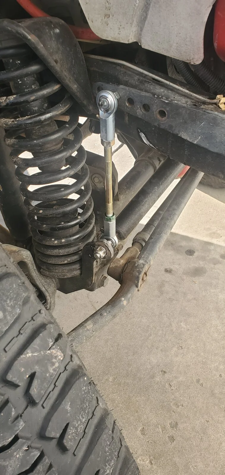

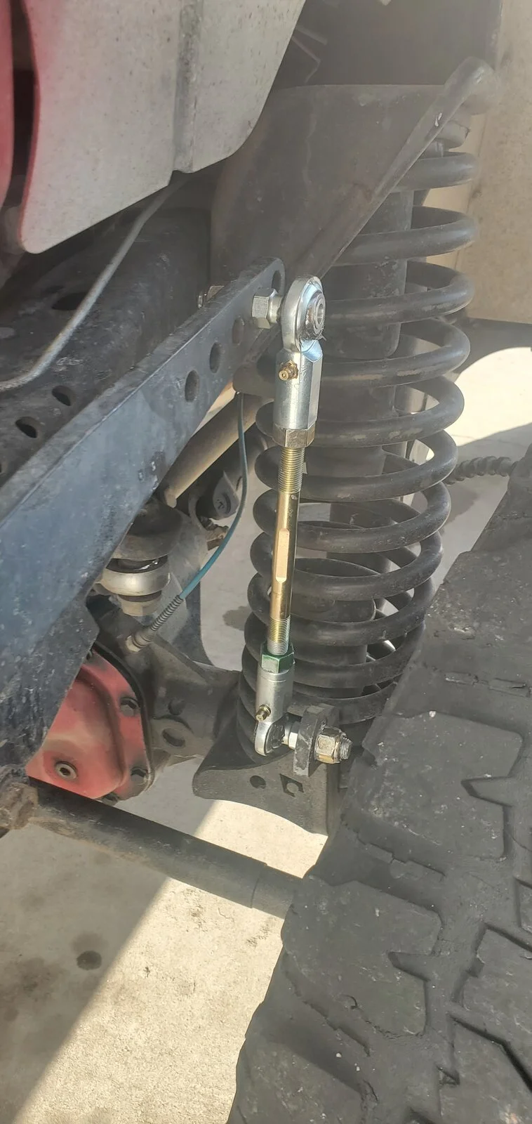

Replaced AR links. Ive had this system for a number of years now and the ends were shot. Greaseable replacement joints from Summit. I was able to remove one old joint and the threads had stripped when removing. The other 3 joints were completely seized onto the rods, which never saw antisieze. I couldnt cut the rod straight either with a dremel because the old joints were in the way. So new threaded rods from RockJock were ordered.
View attachment 217219View attachment 217220
I did notice immediately after install that some of the clunks I would hear when hitting dips in the road are now gone.
I like this idea. I made my own rear links, with joints and all-thread, but they aren't greaseable ends. (y)
Not to mention rockjock wants $45 per link. I think these were less than $10 per. I tried to locate a threaded rod but couldnt find a 1/2x20 locally.
