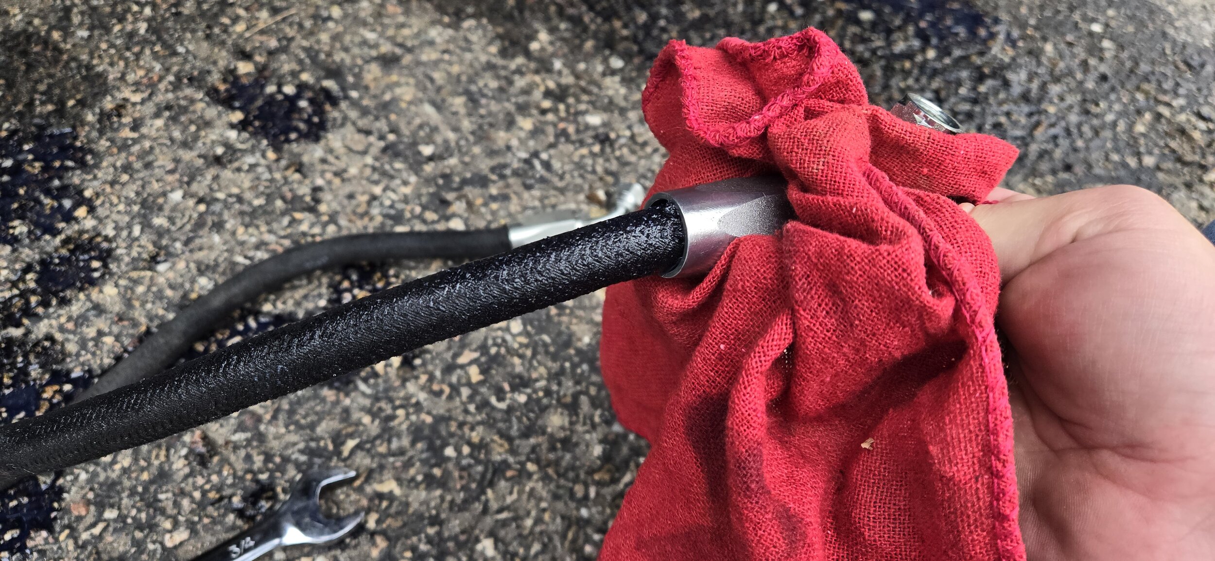

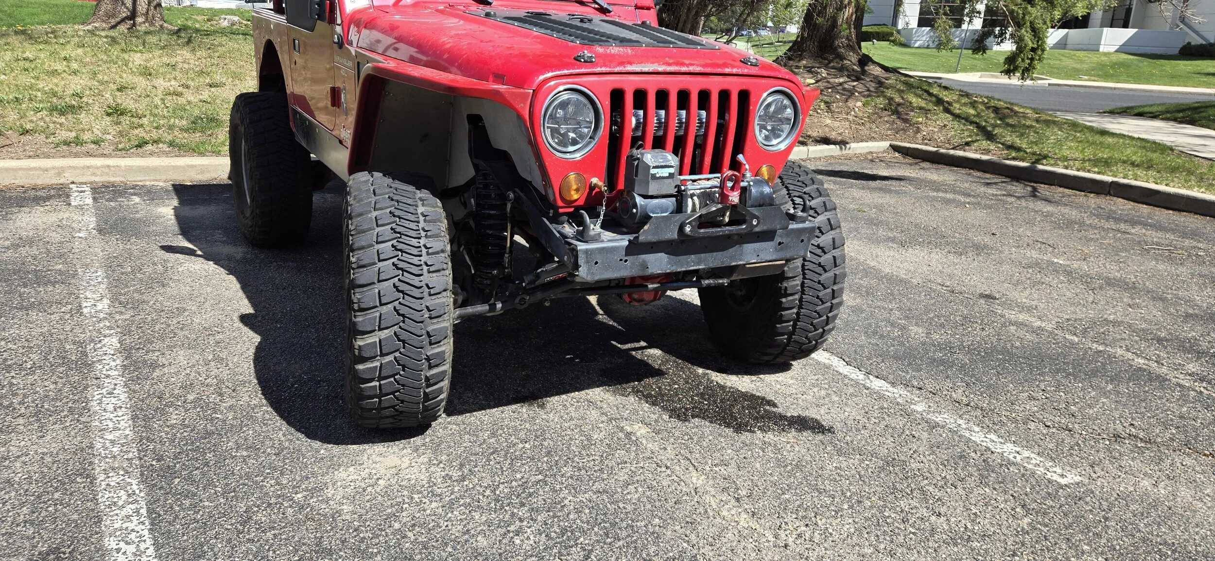

I pulled into my parking spot at work, heard a pop followed by a billow of smoke. Power steering fluid is all over![]()
Hopefully just a hose.
Womp womp
What gave up on you?
Hope it is an easy fix.
I don't see anything obvious, yet. I'll grab more fluid at lunch and see what I can find.
Better there than on the trail. I'm going to guess it's one of the new fittings?
Be cautious about letting the pump run low on fluid.

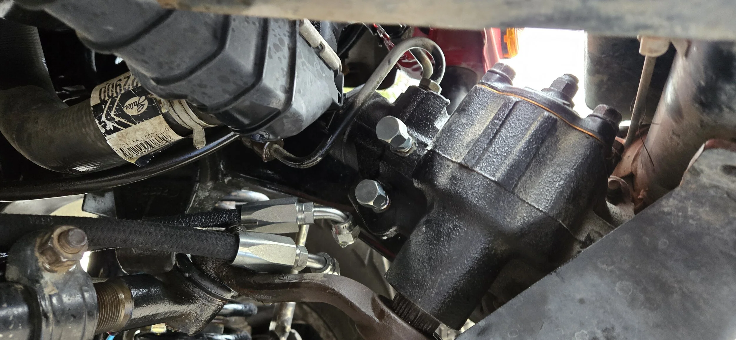

@jjvw happened to be near my office today so he swung by. Didnt take long to find the hose off the steering box was loose. So for those with hydro assist or anticipating hydro assist, keep your caps!

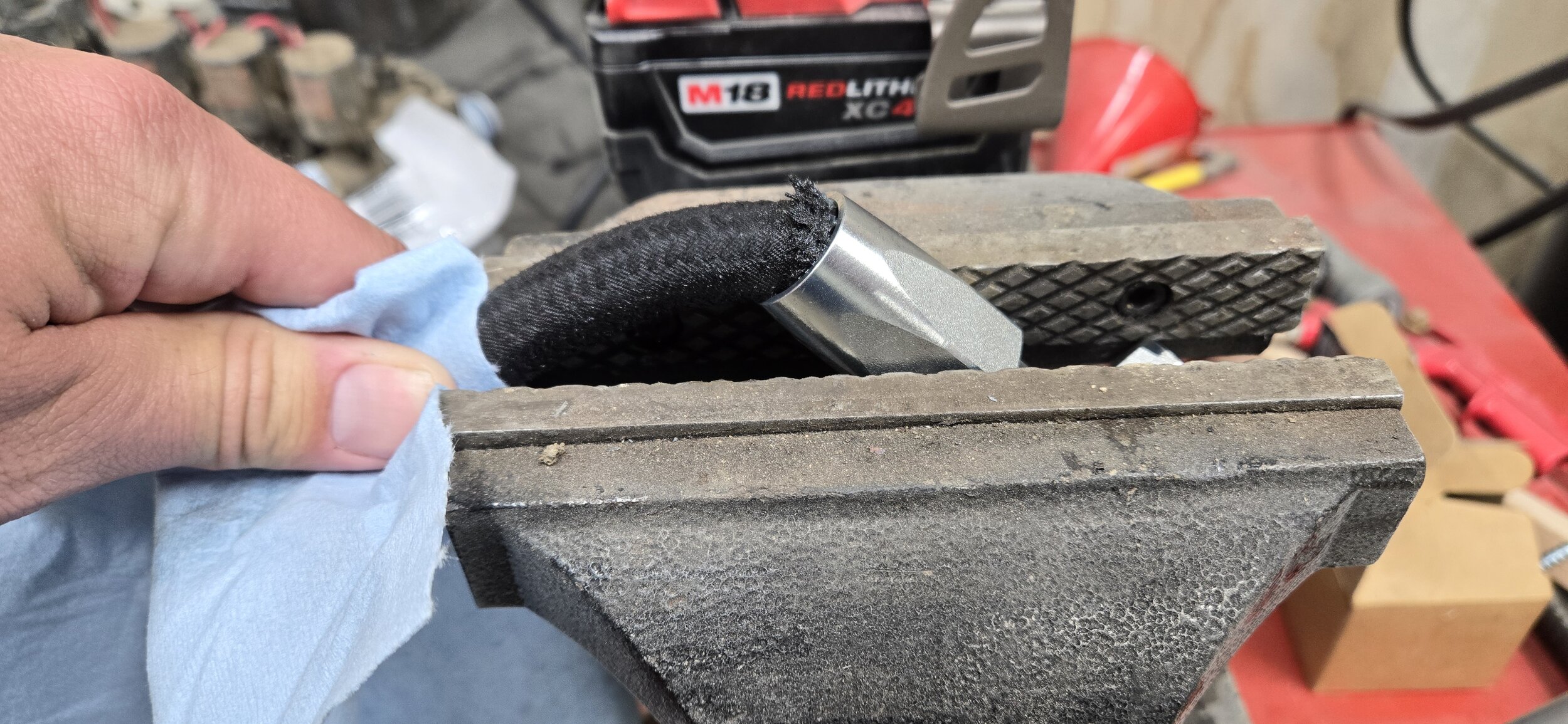

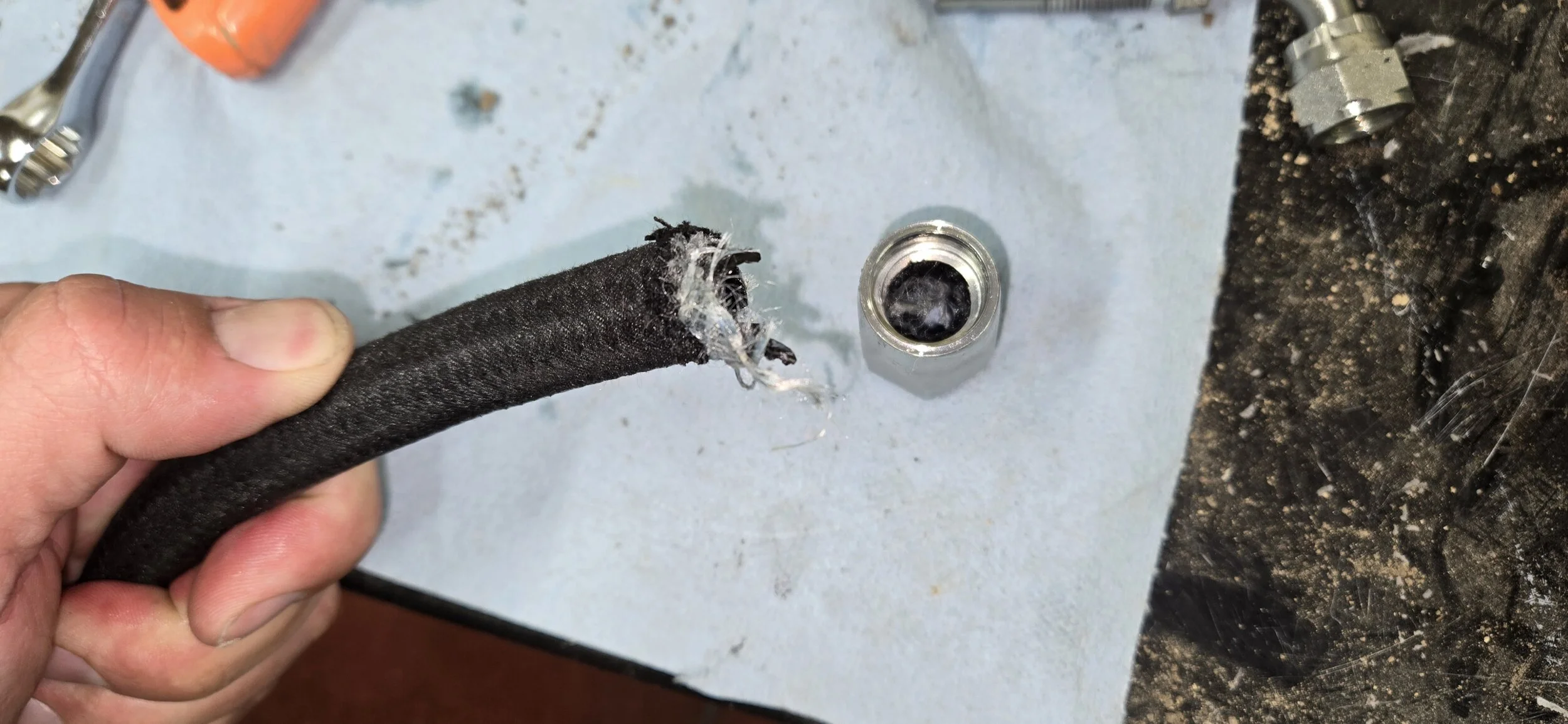

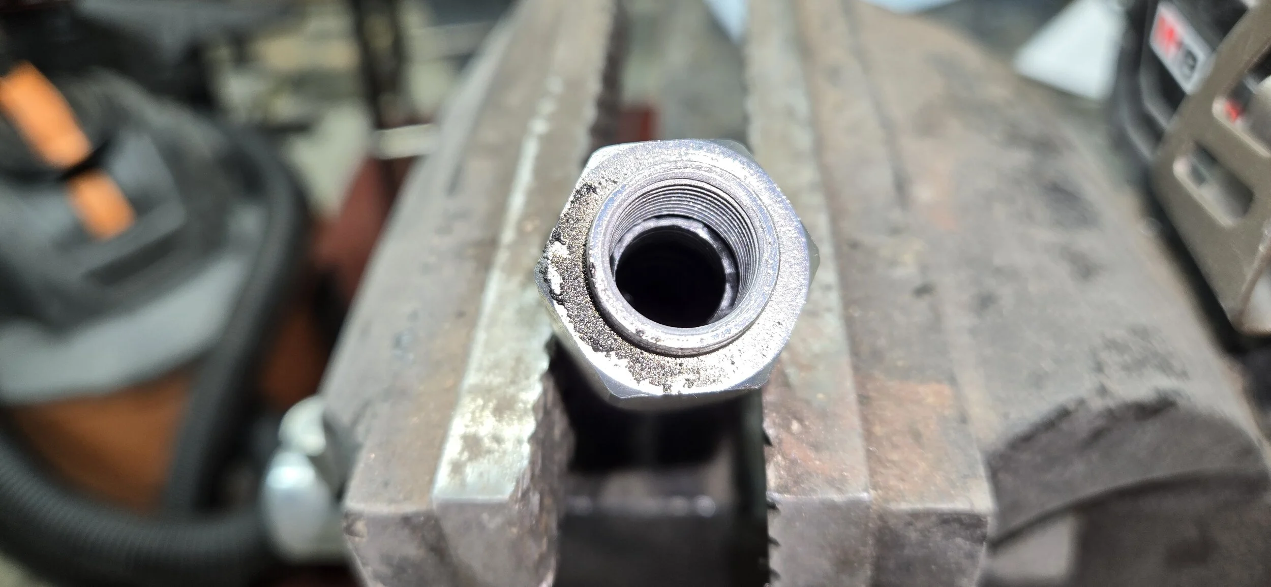

Just got home and took a closer look at things. I thought the hose had backed off, turns out it was the "pop" I heard.
View attachment 521807View attachment 521808
The 1" or so of hose is still in the female portion of the fitting
