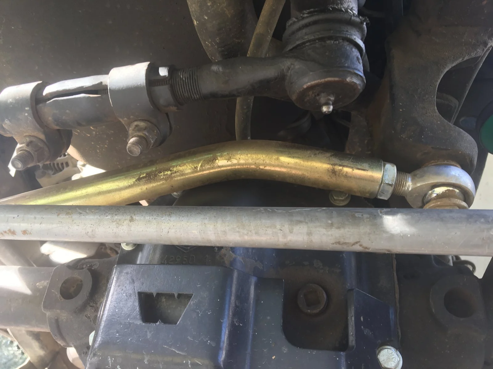

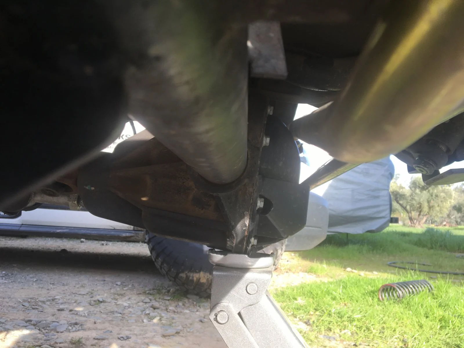

A little bit of tire rub on the body/frame should be fine. Tires are soft enough for a kiss.
Take pics of where the track bar is hitting. What is happening when you fully raise the axle?

Feels like the axle should be pulled backwards. It shouldn't take much. Double check the pinion while you do this since you are shortening the drive shaft a hair. Same with the axle center. There are several moving pieces to keep track of that all effect each other.

That will take a bit. My lowers are all the way in. Need to grind down the threaded shaft a bit. Going to try one turn in on all and recheck.

First check the track bar length and the pinion. Make sure those are where they need to be before grinding.
Blaine has a really nice how-to for centering the axle.

Well one turn on the lowers and resetting pinion within 1* of where it was before. I went from 3-1/4” to 2-5/8 on needed Bs. Surprisingly it didn’t Change my tire to fender clearance by much more tha 1/8”.
Looks like one more turn and it might get me there.

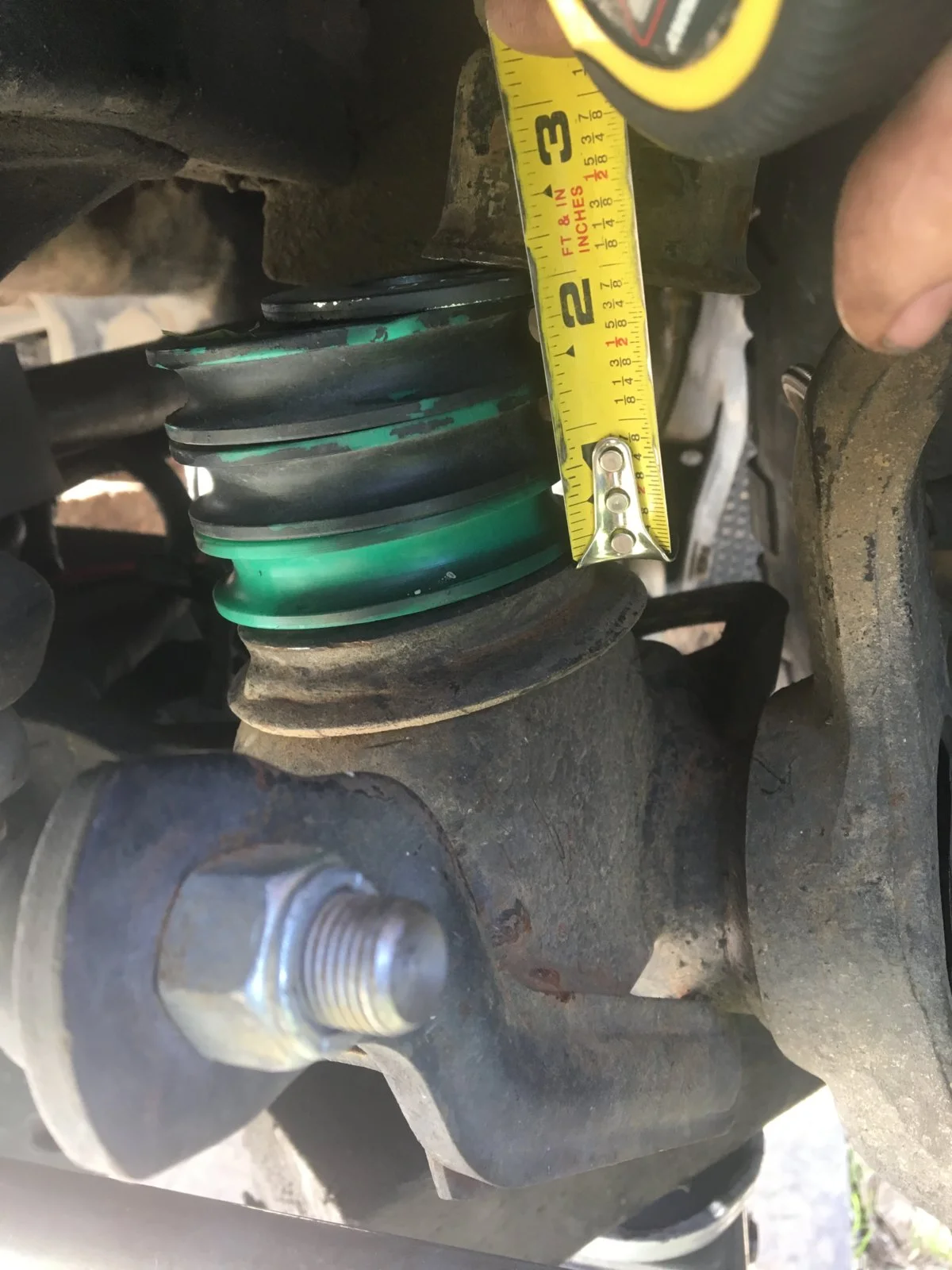

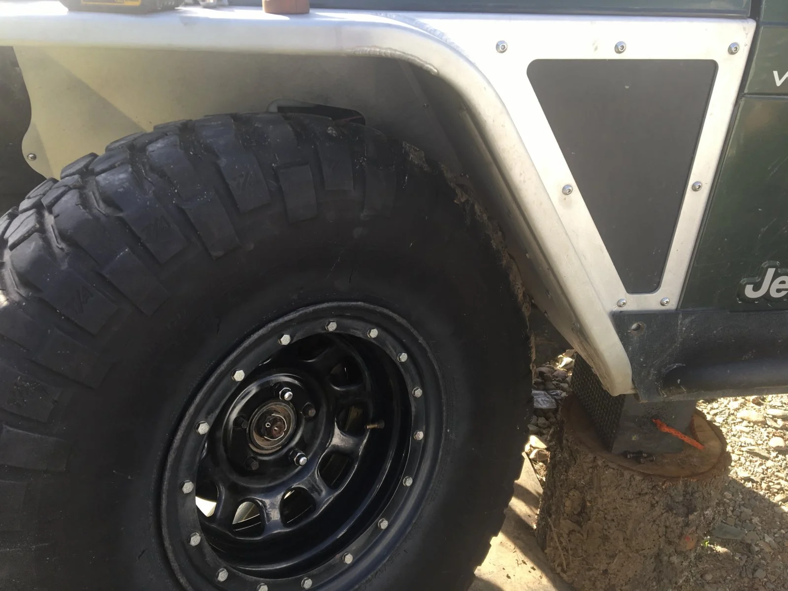

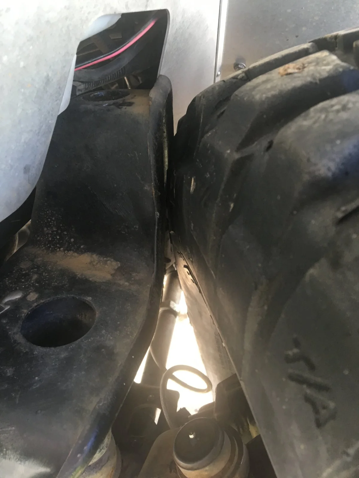

View attachment 82306Mr Blaine right now it is my track bar needs 3-1/4” of bs.
(Just checking to see if I can move my axle back)
When flexed with 2” BS I have 1/2” between my tire and rear fender when turned. Not much room to spare for a new tire and moving the axle back.
What do we do about tire rub on shock mount?
Yes this is with proper droop on opposite side. View attachment 82304View attachment 82305
Tire rub is controlled by effective backspacing. Or, just don't turn so far. ;)
3.75 back space wheels. It had 1-1/4” spacers too. That where I ran into tire clearance on fender before as well as very hard steering when front was locked. Those spacers have caused me a lot of trouble. Lol.

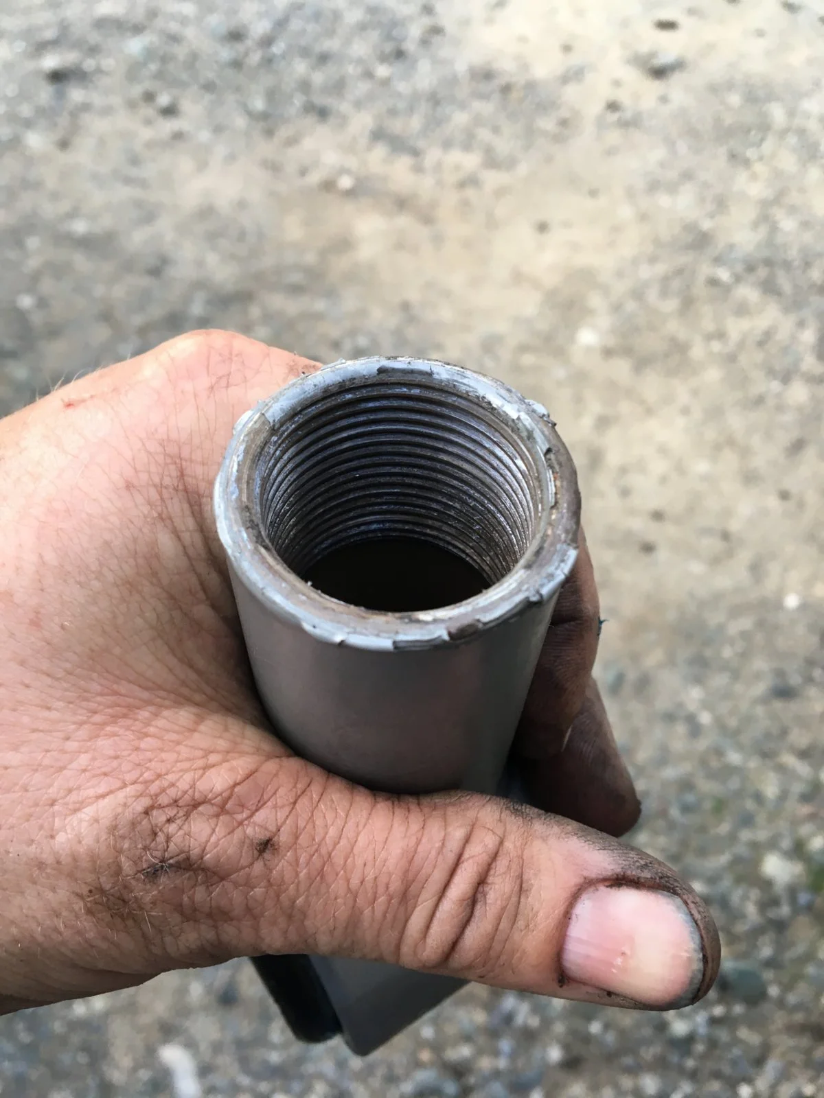

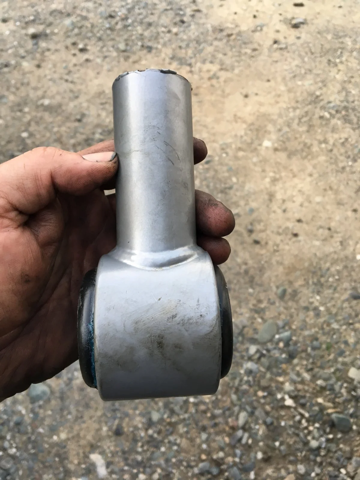

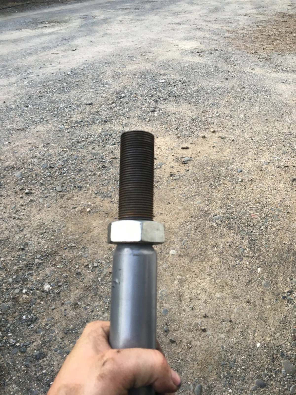

So I need one more turn on these crappy RE arms. Quality double adjustable arms are worth it. Just need to utilize what I have since these are less than a year old, ugh. 😪
So what are your thoughts on shortening these. Do you think I can just trim the threaded stud and female end? I know the stud will be fine to trim. But the female end is only threaded for the first 1-1/4”. Trimming an 1/8” to 3/16” be ok?
View attachment 82338View attachment 82339View attachment 82340
How many threads does the jam nut have?
