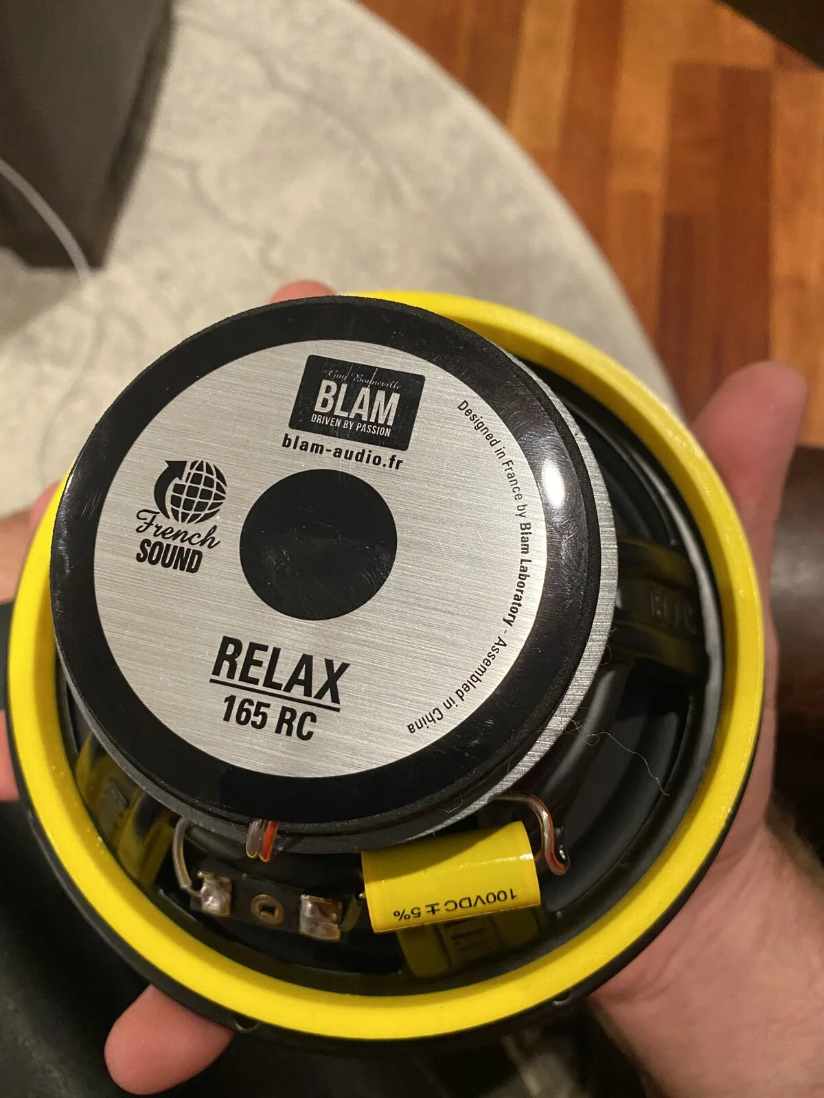

So i just full ordered a set of Blam speakers to replace my Polks. I spent some time talking to my local installer and they do a lot of Porsche convertibles for which they recommend upgrading the tweeters to the Signature series.
So coming next week:
Signature TS20 tweeters which should fit in my Valicar pods
Relax 130RS for front mids
Relax 165RC for the rears
Can't wait to get it installed and tuned.

The only AF dealer in town is a company I don't really want to deal with and the GB10 were going to be 4x the price of the Signature tweeters. Apparently the Blam's are brighter than the AF which makes it a better fit for convertibles.
Blam couldn't sell just the front woofers so I had to buy the entire 130RS - so i'll end up with spare Relax tweeters that I might do a sound comparison on.

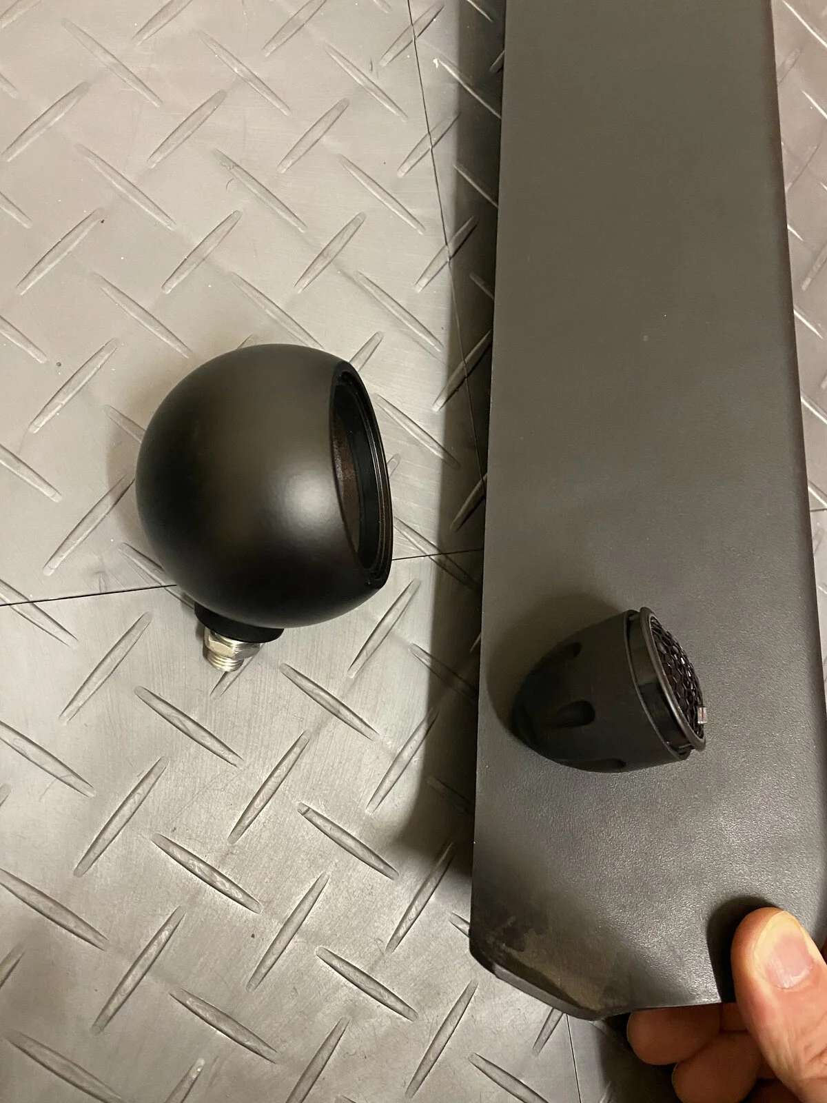

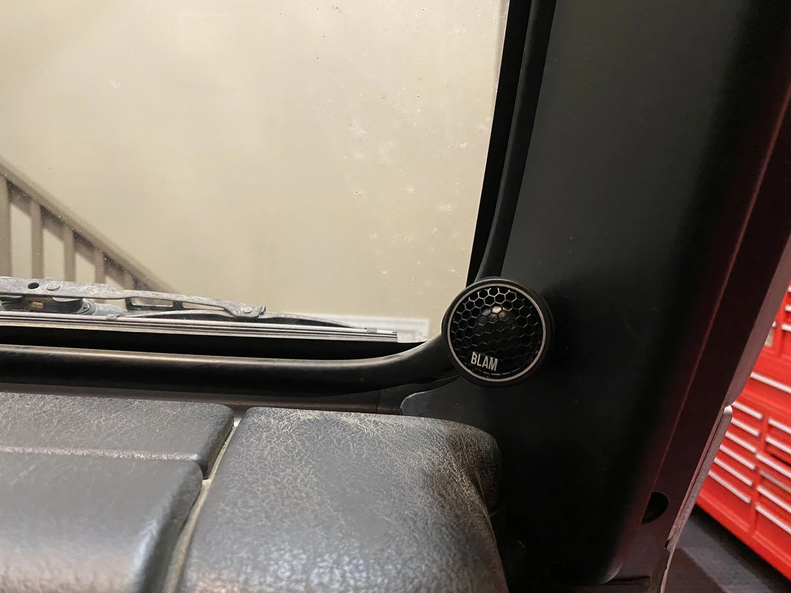

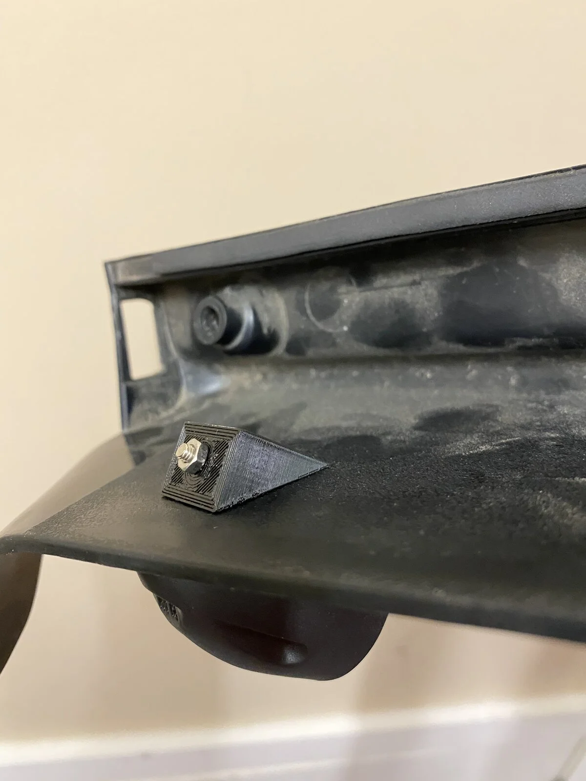

I love finding little uses for my 3d printer. My blam tweeters came with their own plastic enclosures that mount with a single screw. The screw comes out the back at a 33 degree angle so it wasn't really going to be secure just screwing it into the plastic trim.
So I used Blender to whip up a simple backing plates that matches the angle. I can now crank the screw down so the thing doesn't move.
Check out the size of the original valicar enslosure that had my Polk tweeter vs. the new Blam one. I'm much happier to have the smaller size and apparently these things are loud.

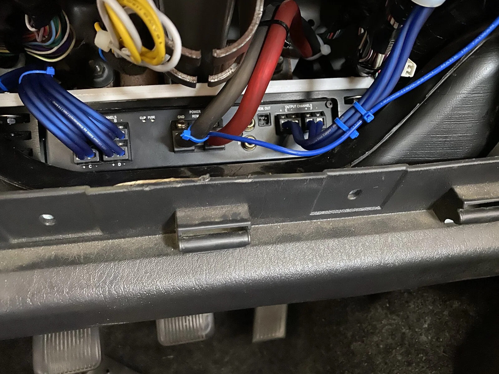

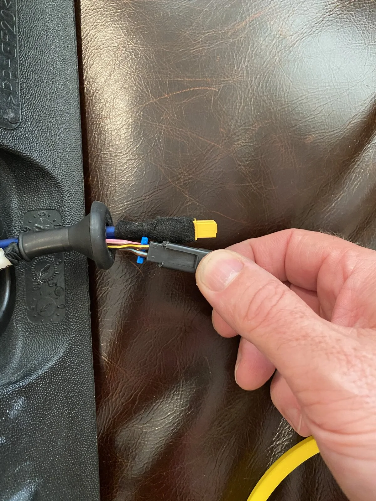

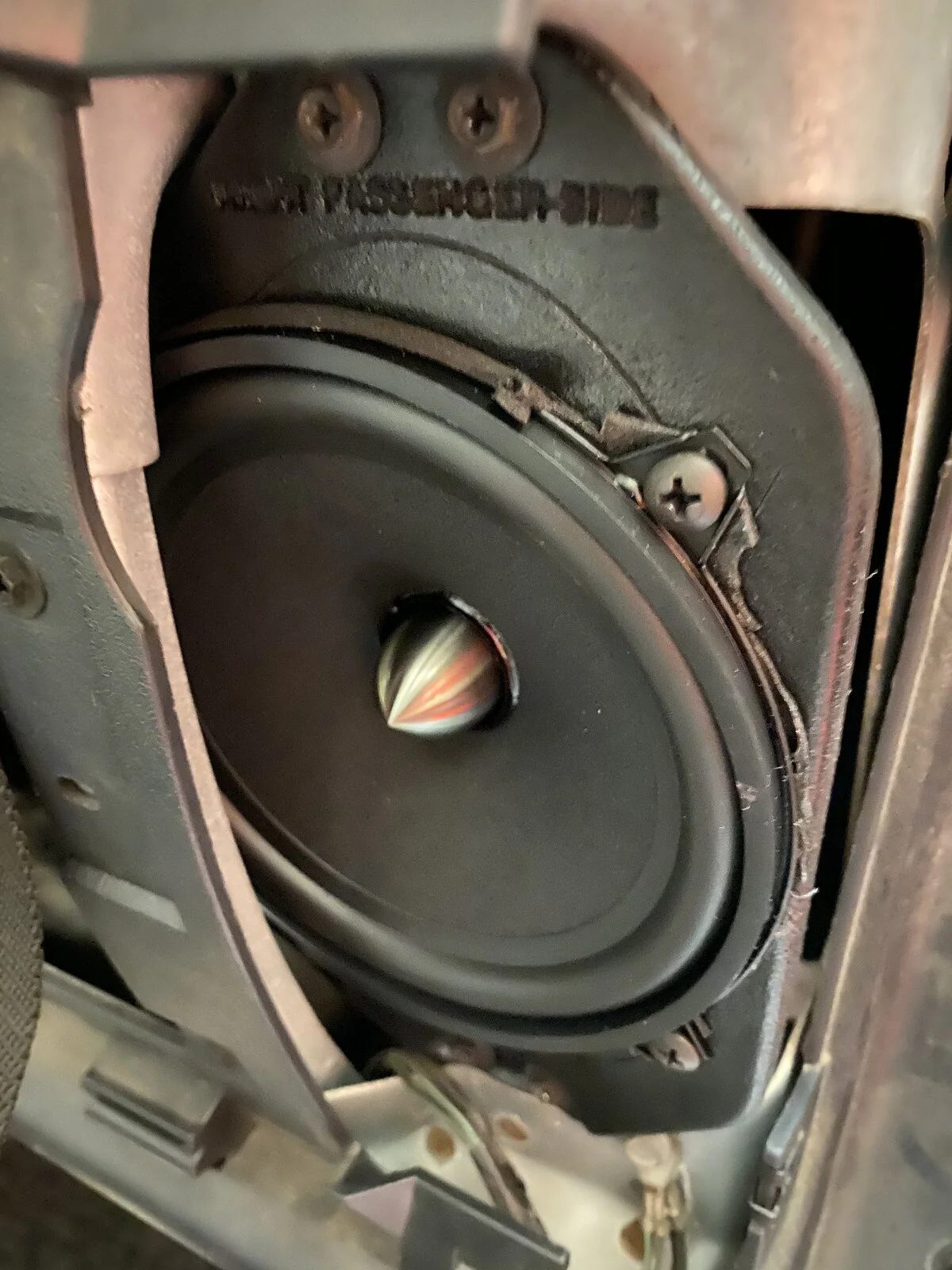

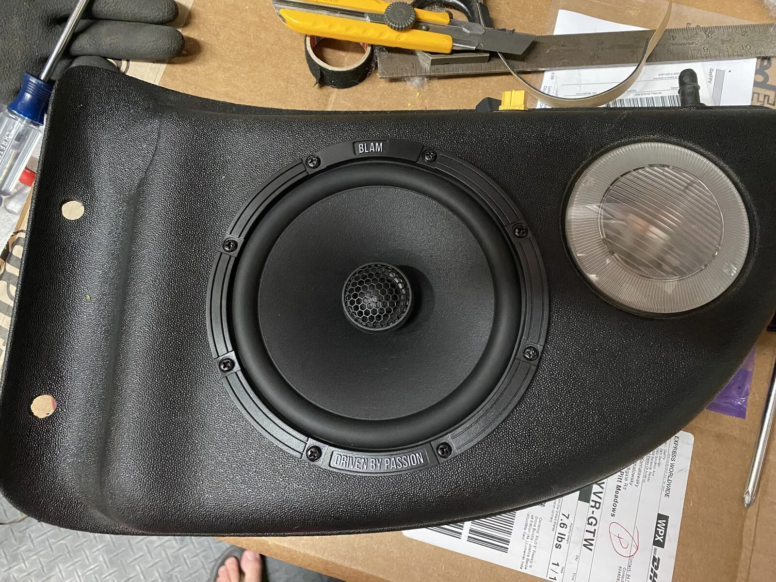

Some random pics from my install which I just finished up. The sound quality of this setup has no business being installed in a TJ :giggle:

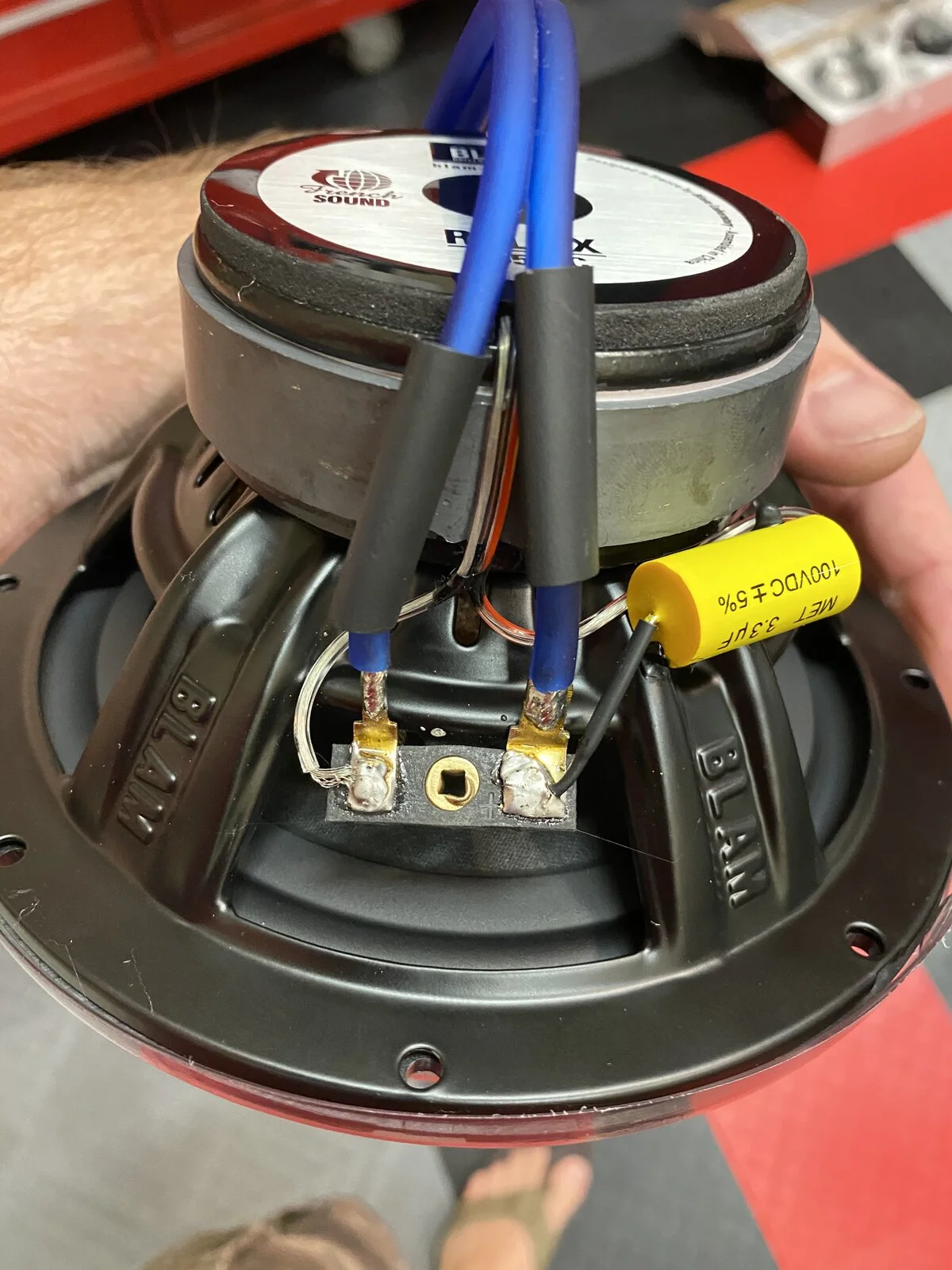

I ended up using 14 gauge knukoncepts speaker cable. Soldered and heat shrinked it to the speakers and then used XT60 connectors so i can disconnect as needed.
Reactions: Vasq

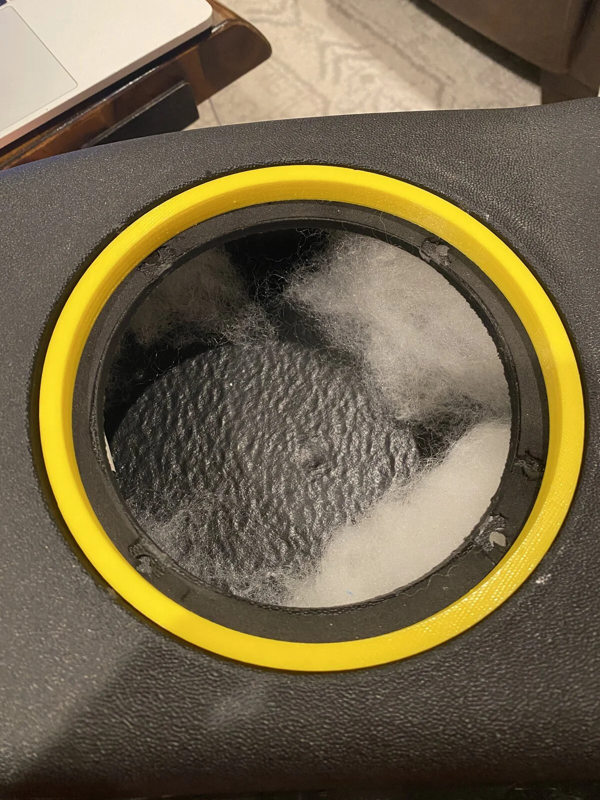

Here is the spacer ring. Make sure you expand by 1% if printing with PLA. It's not just a simple ring - the outer edge is angled to perfectly match the contour of the speaker pod.
https://www.thingiverse.com/thing:4617429
I didn't 3d print the speaker pod for the Signature TS20 - the pod was included with the tweeter. But the design is stupid - the screw leaves the pod at a 30 degree angle so when screwing it into the platic trim it isn't very secure. I created a backing plate to match the angle. Here it is:
https://www.thingiverse.com/thing:4617443
