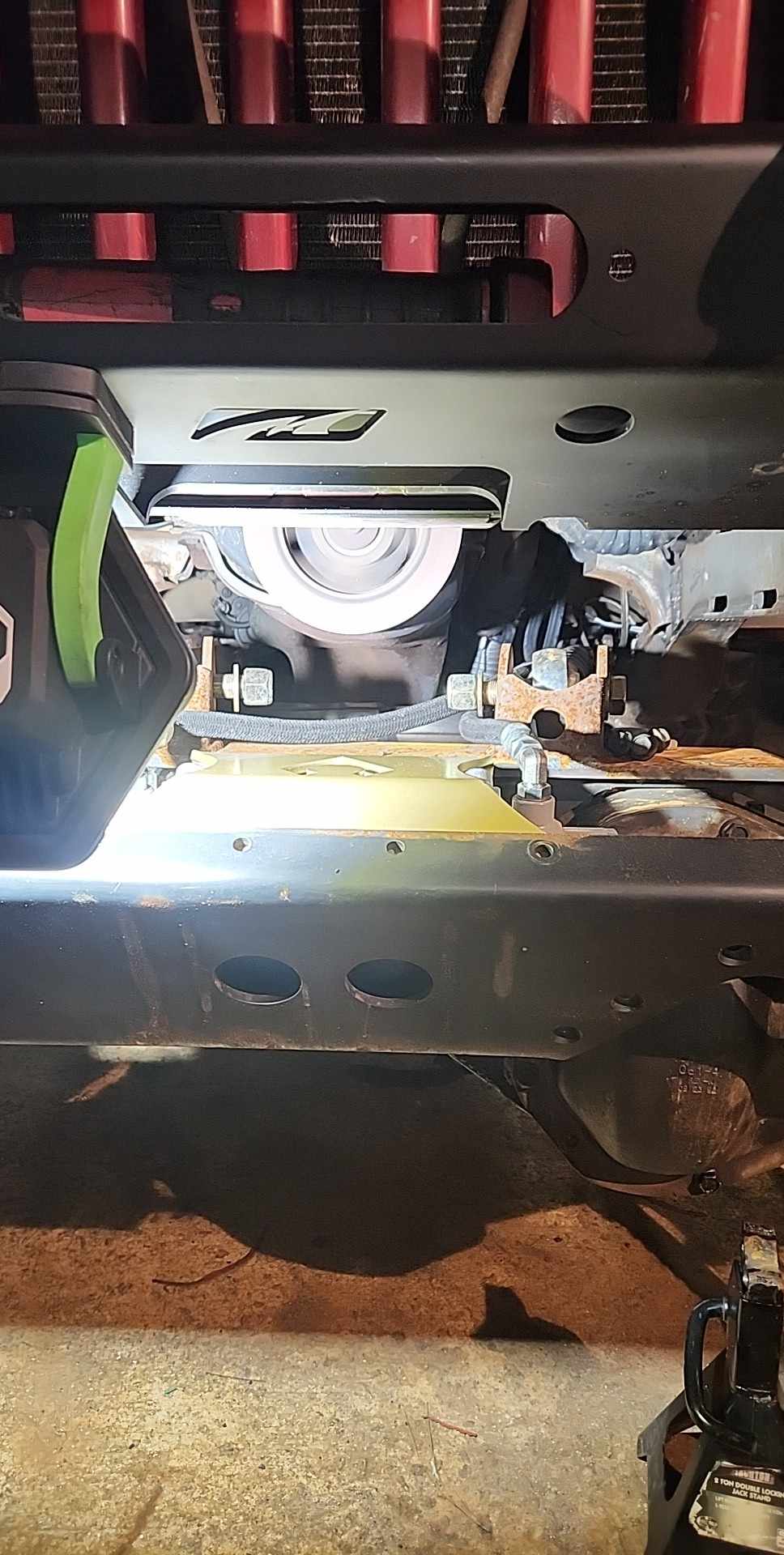

The information regarding the jtec pcms from the 97-04 jeeps is pretty sparse, so hopefully this helps some people who cant run a mechanical fan. Id run the stock fan on mine, but the front half doesnt work with the stock radiator, and it hung about 3 inches below the frame rails and the fan hit the upper link bars. A lot of the aftermarket fan controllers are notoriously failure prone, and since the programming/circuitry exists its a viable option.

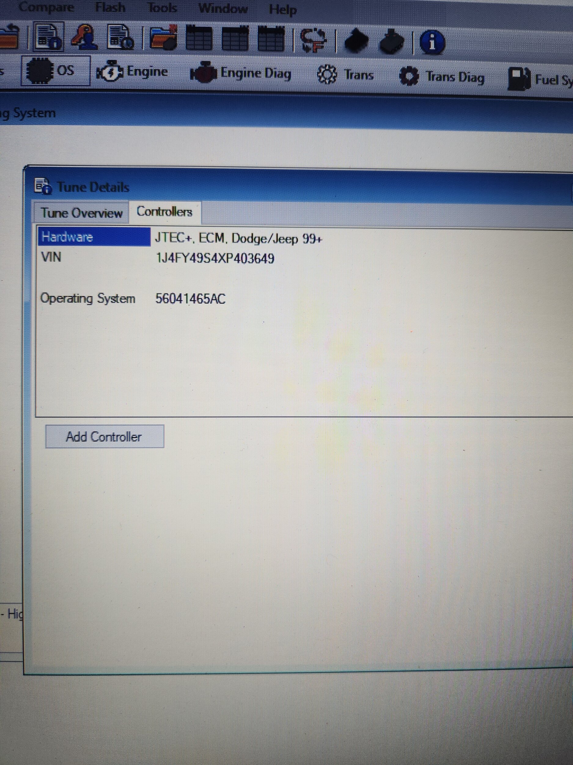

I found that tune file in the hptuners forum. Took a gamble and flashed it to my pcm. Spent a good part of the day playing with settings til i got it to work the way i wanted. I also added the terminals for the maxi fuses to the factory pdm, so the fan relays are fuse protected and i have 3 additional fused outputs. Just need to clean up the wiring and it'll be good to go
I did the same with the PDC. I love how clean and factory it makes everything look.
So you need to start with that OS on the time then, there's no changing it? Any chance I can get that file from you or a link to it? I don't know what the XJ PCM I have has on it and I'm at work so can't check until late tonight around the time Santa comes to town.
I dont know if thats the only OS that works, i just know that one does and the other one pulses on start/stop. If its a xj pcm, id imagine it will work since they used an aux fan. Just play with the temp settings and set dc fans to disable(should be set that way on the xj tune). I have a 2000 xj pcm i pulled the file from to look at settings, but its a coil rail OS. It'll cost 1 credit to flash that other file to the pcm, even if youve already licensed your current pcm. If you want, i can post both those files if you want to poke around in em.
I will take a look at when I got when I get home and get back to you. Thanks a ton man!
Oh and another thing ive noticed is since the native units are metric in the programming, sae doesnt always translate right in the editor. Set the units to native in tools/options and use the unit conversion tool to get the celcius numbers from your farenheit numbers. You usually have to close and reopen the file to get it to switch over.
