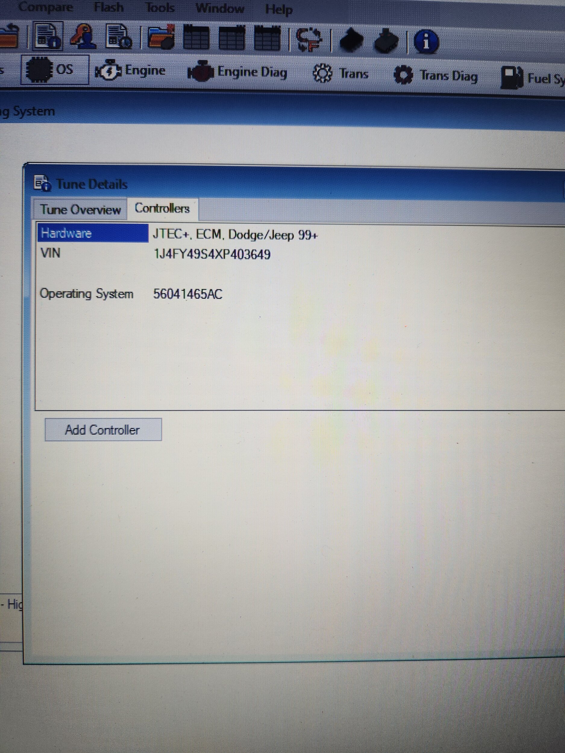

Well I had the chance to write some new tunes with various modes enabled, and to poke around the empty spots on connector C3.
I got a null result. I could not find any change in the pinout operations based on enabling each of the different fan modes.
So either the tuner isn't capable of enabling the PCM to do these tasks, or the PCM isn't capable of it.

So I hooked up a wire to C21 (gray connector) and played with the settings in HP tuners every which way I could think of. Nada. After looking at a bunch of PCM pinouts, it looks like C21 is used only for the high speed relay on Viper JTEC PCMs from what I can find. I do see several different XJ PCMs that use C2 for low speed relay. Might give this a shot soon.
Cool! Which pin is it? What's your setup?
Pin c2. Its a negative trigger. Set the high and low temp in hptuners to 199. Fan shuts off at 194. Changing dc fan to enable makes it not work. 2 speed fans doesnt seem to have any effect. One OS had the fan cycle on/off every second 6 or 7 times, then it would turn on. Repeated that when it shut off. Changed OS and the cycling went away. Runs as normal now. I set the ac temp to like 120, and the fan comes on when you switch the ac on.

Running vcm suite version 4.10.7 i think. The new version wont let you turn off dtcs. This jeep started off as a $1500 SE 4 cylinder with no axles and rotted arches at the rear axle, and i swapped in the 4.0 and ax15 from a 99, including the entire underhood harness.
