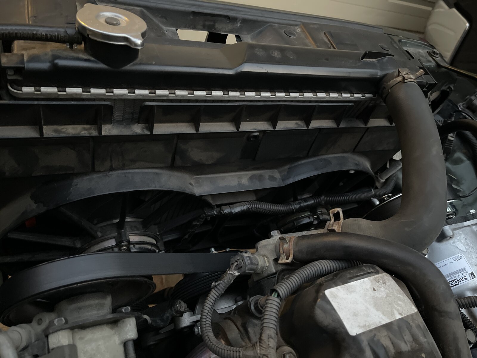

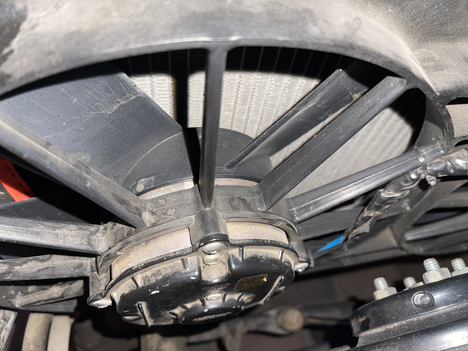

Interesting. I’ve been wanting to figure out a way to do this with an electric fan. The PO put dual electric fans on the tj controlled by a toggle switch on the dash that’s on or off. It would be nice to have a better way of controlling it.
There are aftermarket controllers. I use a Dakota digital, but there are many options. I would love to make it integral to the pcm though. The switch method is going to fail you at some point though. I'm sure that's why you are researching something better.
BTW--dual fans? I'm imagining some pretty small fans in my head.
