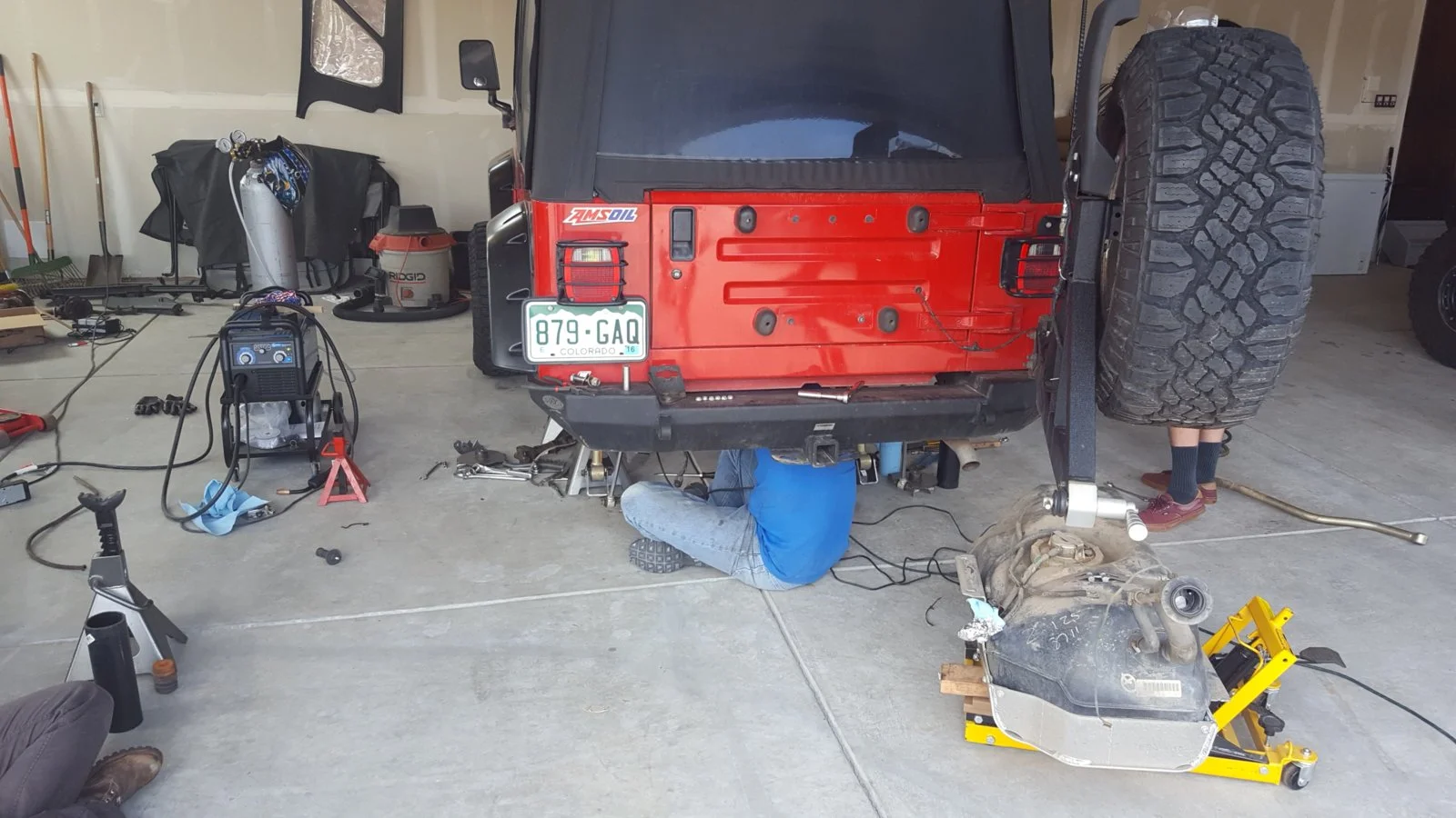

I have a hydraulic floor jack. This jeep is my daily and only car so i’ve been getting rides from friends back and forth. I’d leave it in my car but i’m out of space in there and I don’t want to leave anything valuable outside of it when i’m not there as it’s a sketchy place and someone has already stolen my license plate for some odd reason. It’s my fault tho as it was just zip tied on but still.

The difference is huge between a floor jack and motorcycle jack, the motorcycle jack will hold the entire tank as it has two support bars that are roughly 10-12" apart. No need for a second set of hands holding your tank, they motorcycle jack is perfect for it. When your done throw it in your living room, Ive done that for a bit when I didnt have a garage
that jack would be awesome for the skid plate too, next time I need to drop mine I'm heading to my buddies place to get his.

Yeah i know they’re different but with the hitch that is on there I definitely need another set of hands plus $100 is not something I have right now[emoji53] also i live on the third floor of an apartment with a randomly roommate so i’m not sure if she would like that. Lol. I hope I dont get any door knocks. Especially since it’s my mothers address connected to the plate.

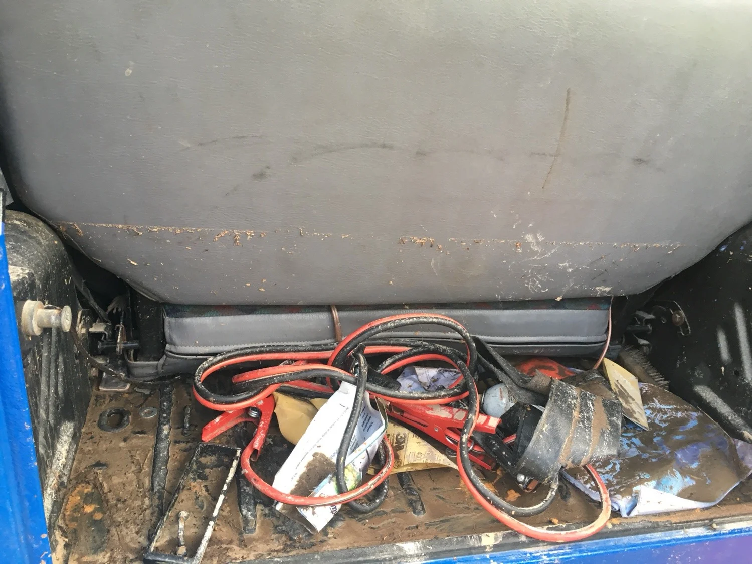

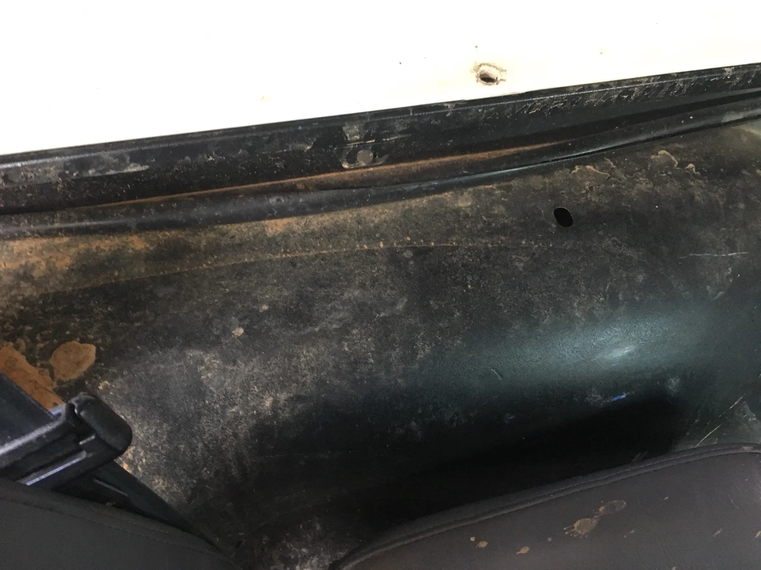

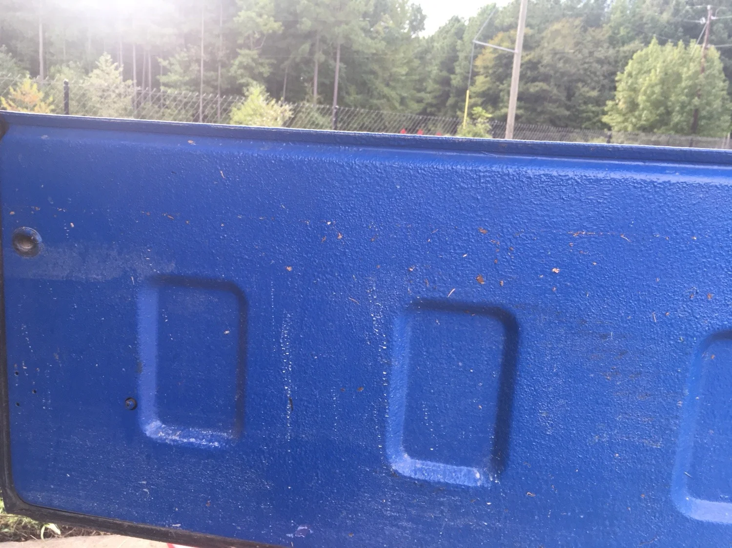

Well here are some pictures of the water line now that it’s day and I can see. I don’t see any line on the front seats.
Also

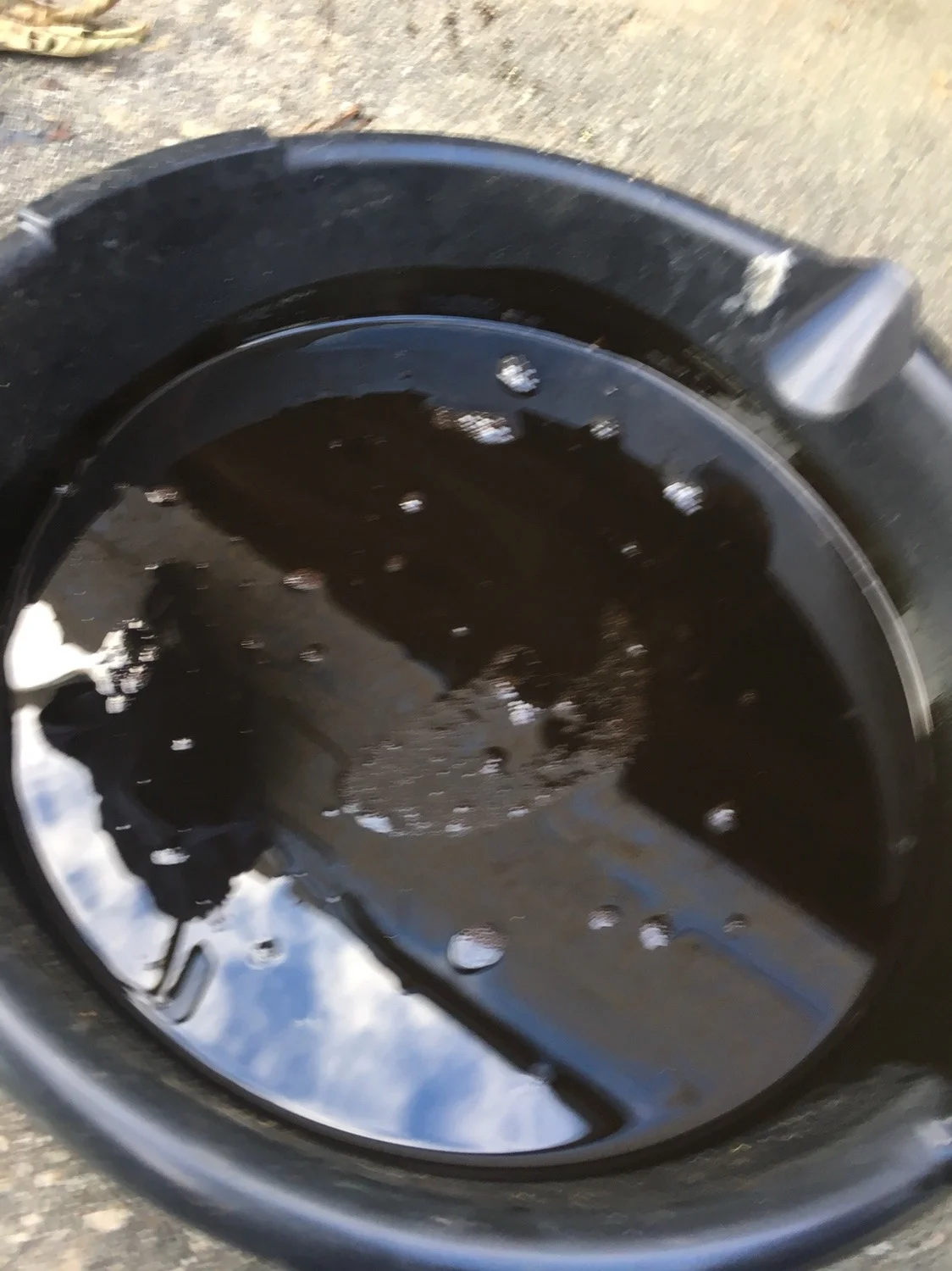

Oil looks fine despite being a bit dark. Any milkyness you see in the photo is from water that was already there as I just dumped out the rain water.
