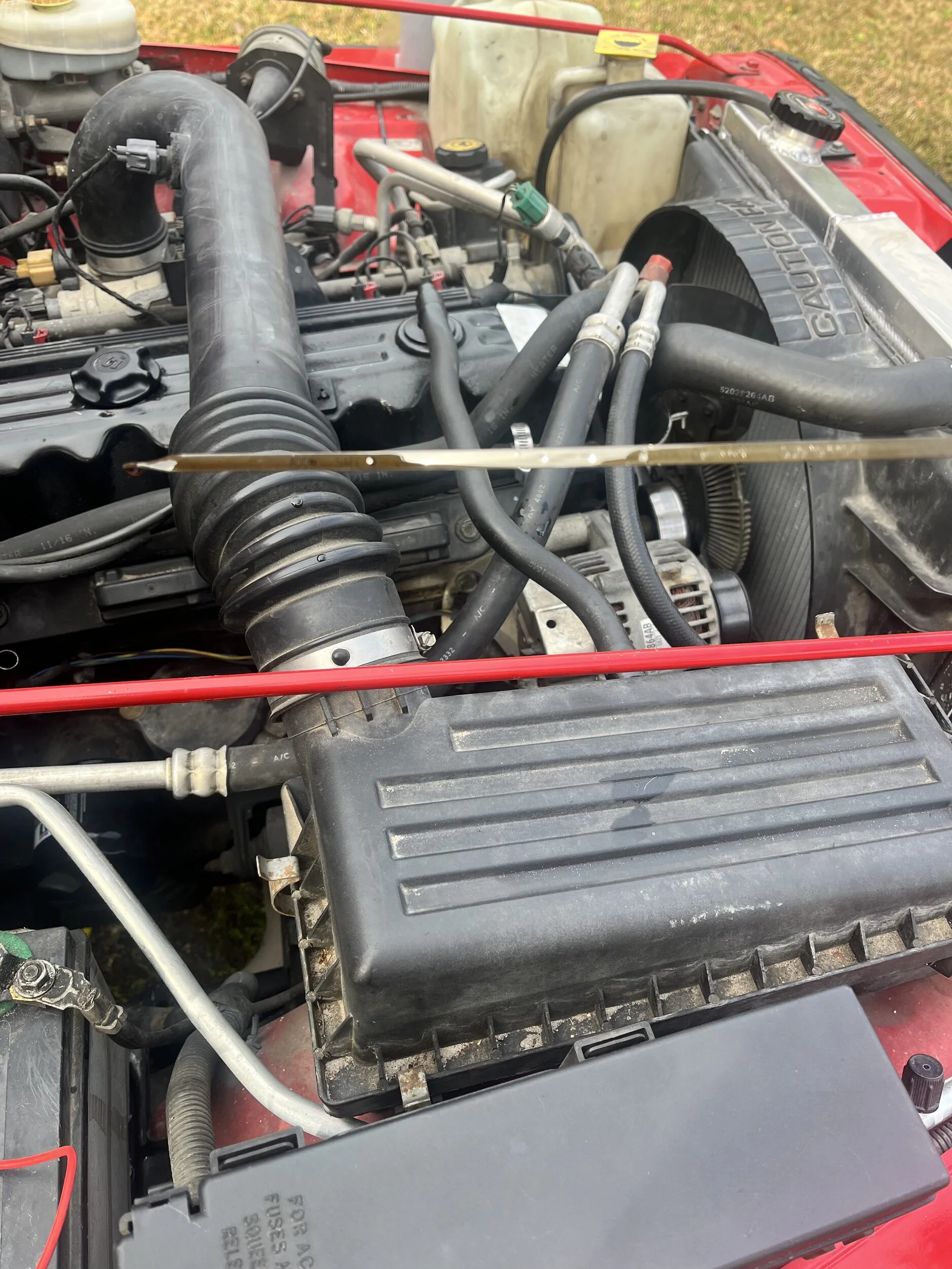

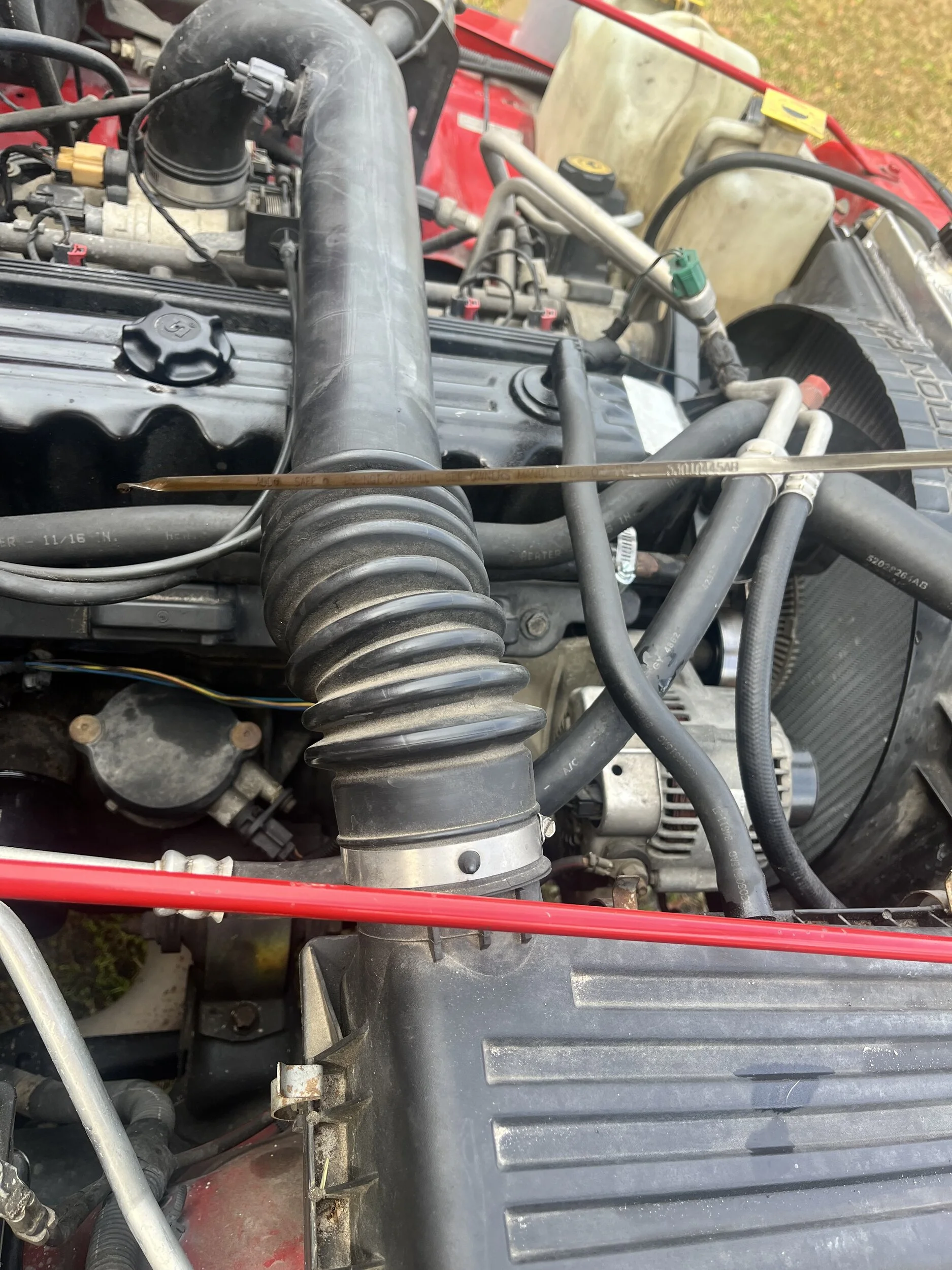

Oil and water on the dipstick.a separation between the oil and the water and also a puddle of water on top of the engine kinda just put two and two together, i know the smell of coolant and it doesn’t smell like it at all

I’m having trouble telling by your picture where the separation is from the water and oil. Is the water below or on top of the oil? Does it smell like fuel? I would drain into a clean pan, if it is water it should come out first from the drain plug. Fuel would be on top.
If it is fuel I would suspect an injector which would make sense with the flashing check engine light.
