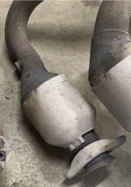

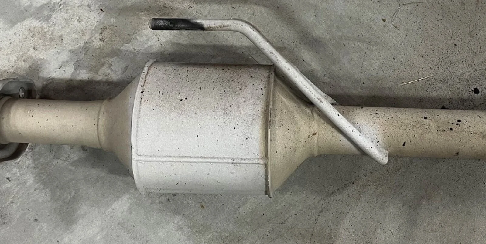

The turbo kit I received has the exhaust ceramic coated, but it's faded and chalky in some spots. Not sure if it's still working well or not doing much at all.
The PO said that he went to a famous company back east and it was super expensive, but he wasn't impressed. From what I read, Swaine has really good reviews, and I don't know of anyone with a better reputation for ceramic coating.
These are the best photos I could find of the ceramic-coated exhaust in the kit I purchased.
Third Cat
Headers welded to the turbo up-pipe

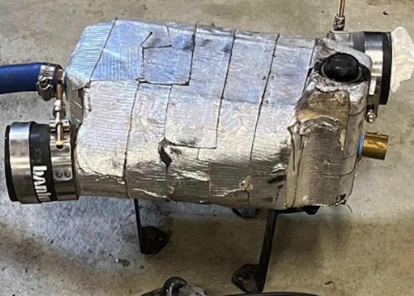

I saw that when looking for a heat wrap to protect my shock/res hose that's near the turbo. It didn't even cross my mind to run that under the intake manifold. Awesome thanks for sharing man!
I have a feeling the PO used something like this when he wrapped the Banks intercooler.

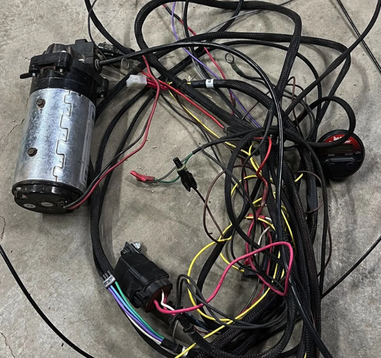

Here's some of the water/meth injection kit
I couldn't school ya. Hopefully the smart guys can help though.
