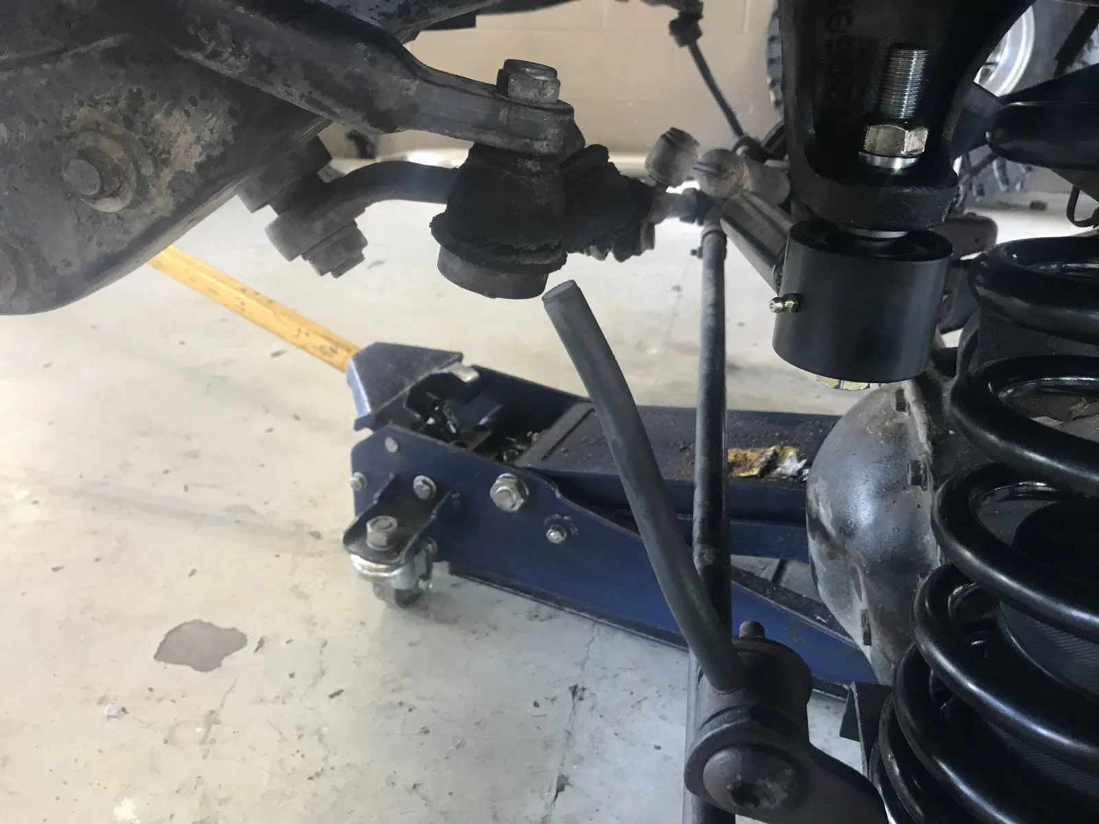

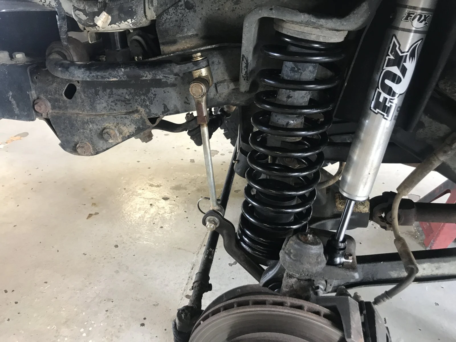

Do they rattle or make any noises at all?
No noise at all, great set of quick disconnects. Although to make it easy to install I carry a mini malet to set the pin by in. Way better than my last set of sway links!! ;)

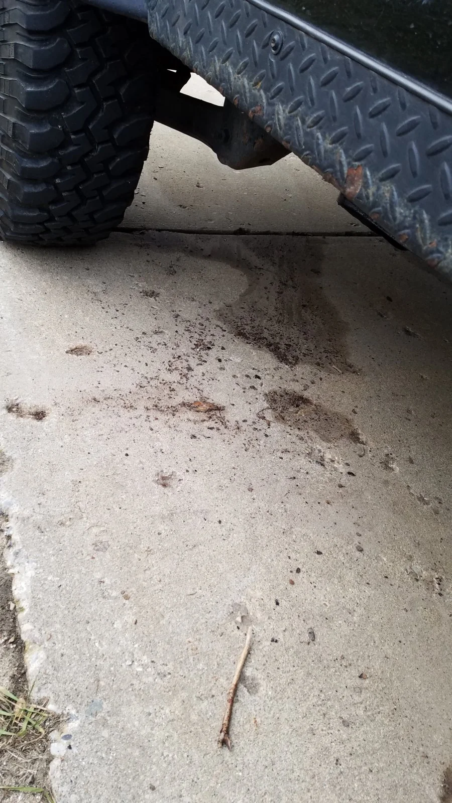

Drilled a couple 3/8" holes in my frame, right ahead of the rear LCA mounts...then powerwashed the inside of the frame...crazy how much crap came out of those holes. Thankfully, not too much by way of rusty metal flakes.
Passenger side was worse...this is what was left in my driveway.

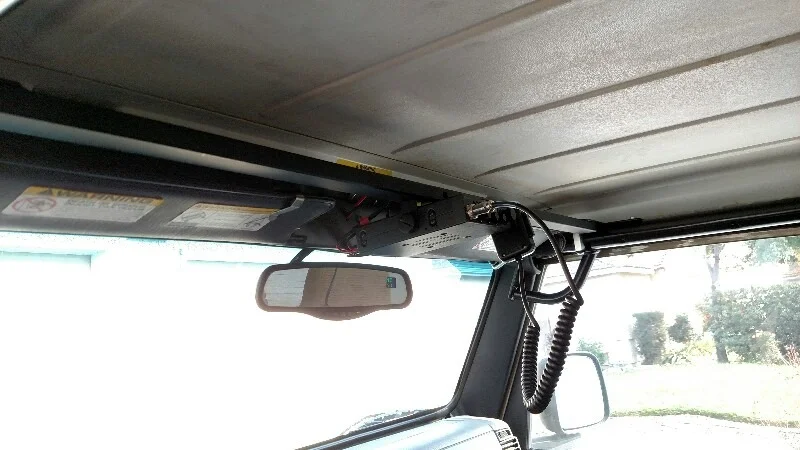

Installed my ARR Radio mount. I had to modify the mounting due to the Synergy grab handles but all went well. Also created quick power disconnects to make removal quick and easy ... For me and a thief, but oh well.
I used allen heads for mine, figured harder than just unscrewing the knobs. I am going to try and find the tamper proof allens that have the little pin in the center. Those require a special tool to remove. Of course, if some tweeker wants to steal my 36 dollar cb, not much I can do about it.

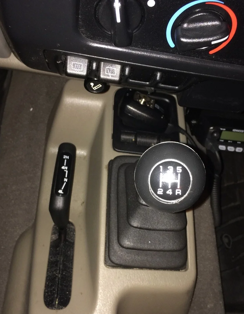

Okay, this is lame compared to you folks with your springs and rear end swaps, but the danged gear shift knob shift pattern was skewed about 20 degrees to clockwise (sorry, no before pic) and it just finally got my OCD fired up. Marked where pattern should be, unscrewed knob, pried out pattern from knob, reinstalled pattern aligning to mark, and replaced in TJ.
No, not a great pic but I know I would be (rightfully so, "no pic, didn't happen") chastised if I didn't have a pic so had to include it.
Just one of those stupid little things ya just gotta do.

I'm the same way. I would bet most of us are.

My OCD would have made me fix mine too, so you're good :)

That was the first thing I fixed when I bought mine!
