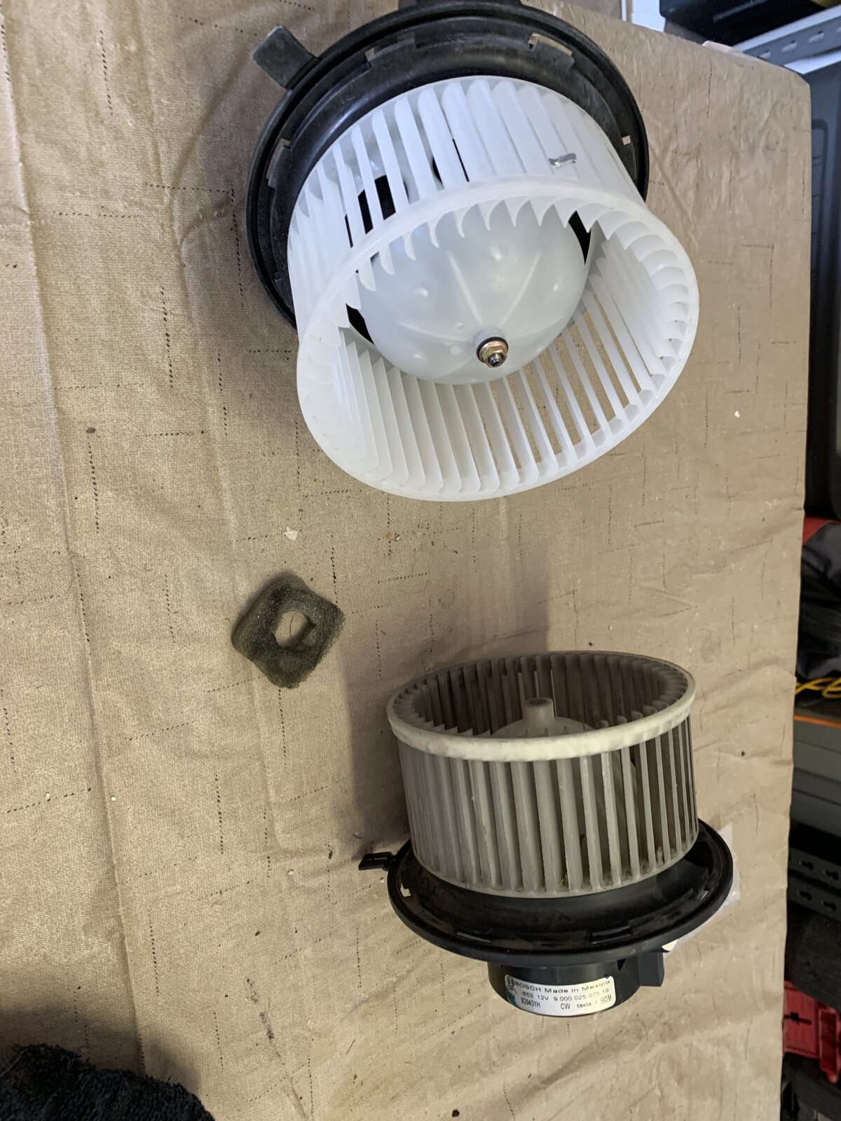

These are from a few weeks ago when I replaced a bad fan motor assembly and my windshield washer nozzle. I just now downloaded the photos.

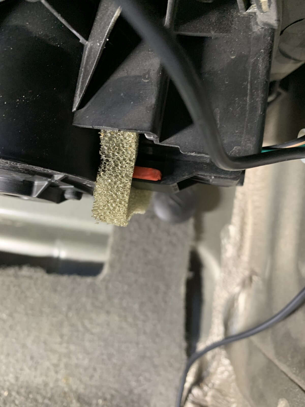

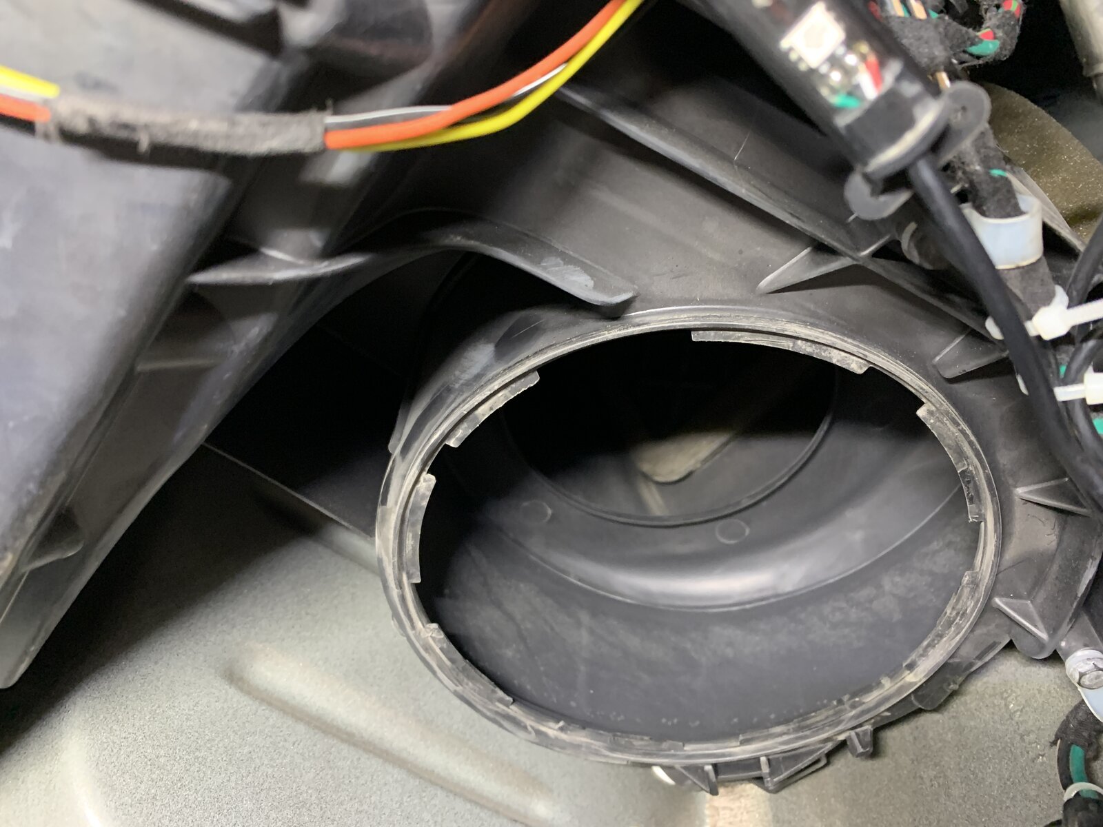

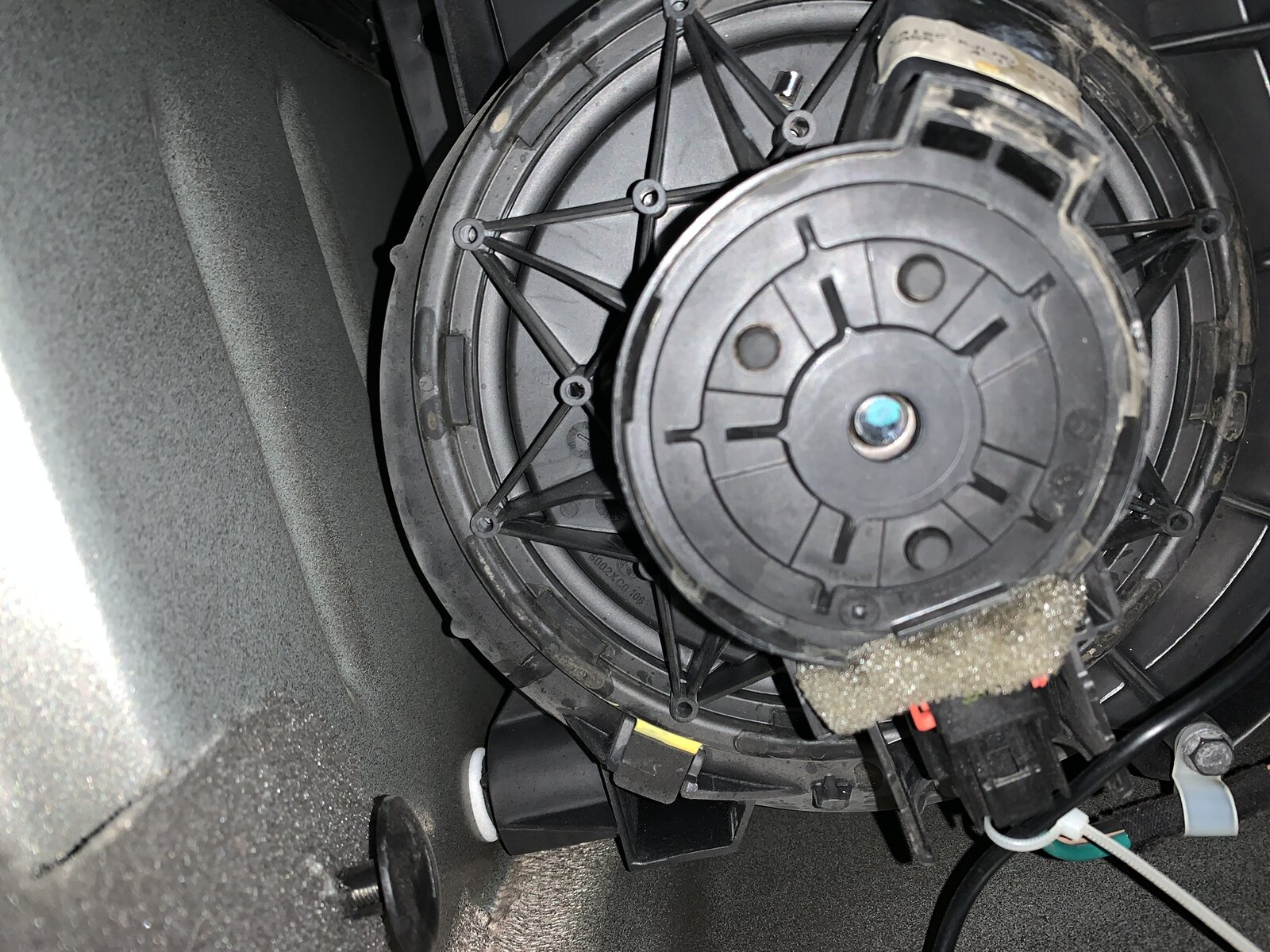

The fan motor replacement is a tool less endeavor on this model (2005). It sits behind the glove box on the 2004 and on models( I believe thats the right years). Earlier models it's more effort as there is a hatch you have to get to that sits behind the battery.
This was a A little tricky to get both hands on it (one to press the tab and one to twist it clockwise). A simple connector later and it's swapped out.

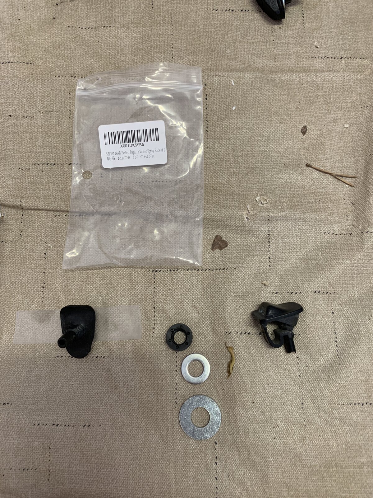

The windshield washer nozzle was a little more difficult just because of access. The replacement I bought needed a larger washer to attach as it doesn't have the same "clip" or base as the original. A little clear silicone under it to seat it and it was a perfect replacement.
I had to tape the new one in place to be able to thread the nut on. Once on I tightened it up a little put the hood down and got it straight, then cranked it down.
The recess under the hood to access the back of the nozzle has razor sharp edges. I was able to stay away from the BanAids this time but just barely.
A few tries to aim the nozzle later it was much better than stock. A strong spray all the way to both edges of the windshield.
Both combined were a half hour.
