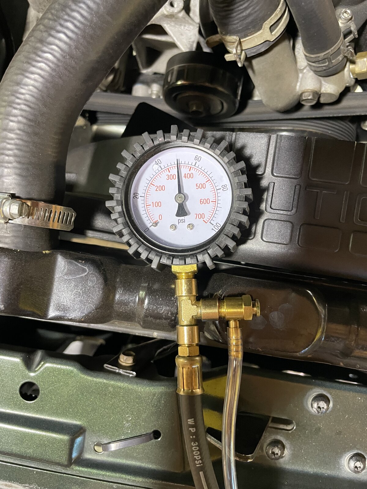

I just did a complete assembly on my ‘97. I was starting to get long starts after it sat. After some reading, I surmised that it was the pressure regulator (which sits on top of the fuel pump assembly and is what holds pressure in the line after shut down). So I borrowed a fuel pressure gauge and found that my pressure when running was within spec at 51 PSI, but rapidly (in a minute) went down under 20 after it was turned off. That indicated, I think, the pump was good but the regulator was bad. Also my long start issue wasn’t present if I cycled the key 2-3x before starting (the 1.5 second or so pump activity after turning the ignition to ON pressurized the line again). You can buy a pressure regulator and replace it separately but all the ones I found were 1/2 the price of a whole assembly. I had the good fortune of finding a new complete Bosch unit, so I jumped on it. The old one wasn’t OEM at 160K. Now pressure stays at 50 after 20 minutes and no long starts in am.
