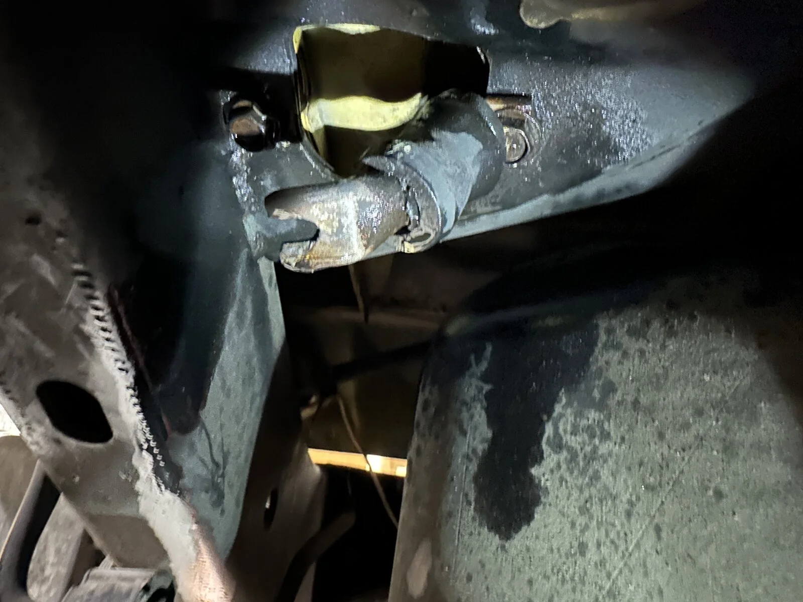

I guess today I am trying to figure out why the rear passenger shock is hanging down.
I felt up in there. There is that cross piece that the two upper bolts go into. That piece is bent. The thing is I have no idea how long it has been this way. Since I have the wheel off, I'll probably take this time to also redo the drum brakes which I needed to do anyways.

The bracket that holds the 2 bolts at the top is bent. I may have to try to see if I can buy just those at my local auto parts store. Worst case, I just buy another set of shocks.

From what I can tell, the shock is still fine. It is just that little bracket that holds the 2 bolts in the top.

That pic looks like the shaft of the shock is bent. Unless the boot has come detached up top and just happens to be laying in that position.
Figured out the issue with the shock. The shock is bad. I can compress it, but I absolutely cannot pull it out of the body of the shock. What happened is that it compressed into he body a bit, and absolutely would not pull back out. Physics happened and the piece at the top of the shock that attaches to the 2 bolts eventually bent. Here's the best pic that I could get.

Is that oil from the shock or penetrating oil or something else?

That is penetrating oil. I watched a few videos that the nuts are welded to the frame and these bolts are prone to rust. So, I'm trying to soak them in penetrating oil for a couple of days to help loosen them up.

So I think the piece you are seeing that is bent is from the shock. The shock I believe looks similar to the below. So I think that piece broke off from the shock.
