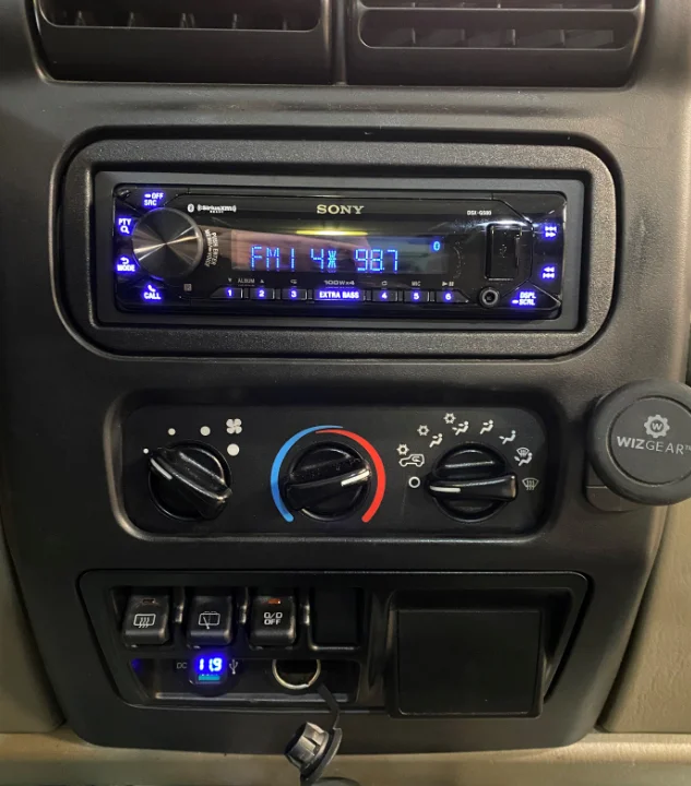

I upgraded my stereo and speakers this weekend. After a lot of reading and researching I gave it a go!
For the stereo or as some call it, the head unit I opted for is the Sony DSX-GS80 - https://www.crutchfield.com/p_158DSXGS80/Sony-DSX-GS80.html . It a little on the pricier side but I'll explain my reasoning in a minute. The unit does not have a CD player but I can't remember the last time I used a CD anyway. I typically stream from my phone library of music or just listen terrestrial radio anyway.
I chose this received because it has a high power built in amp. Most receivers come with a small built in amplifier with something like 15-22 watts RMS which my previous one had. I was at 18 watts RMS but this new unit is 45 watts RMS and 100 watts peak which is more than double what I had. I really didn't want an external amp. I didn't want to have to find a place to mount it and run all the wires for it and so on. I wanted a simple solution and this stereo solved that problem. I have the OEM subwoofer and amp in the center counsel and with this upgraded stereo and the speakers (which I'll get to next) I installed, there really isn't a huge need for anything more....for me anyway! I figured a different receiver would cost roughly $100 and an amp would be minimum $150 plus all the wiring that's necessary for the amp, this was a more economical choice and easier by far!

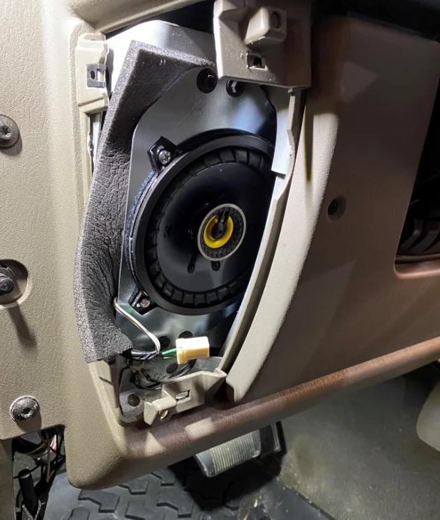

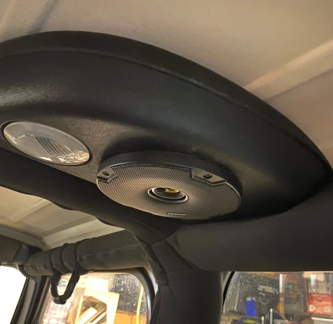

As for the speakers, I went with the Kicker CSC5 (5.25") in the dash and Kicker CSC65 (6.5") in the sound pods.
5.25" speakers - https://www.crutchfield.com/p_20646CC54/Kicker-46CSC54.html
6.5 " speakers - https://www.crutchfield.com/p_20646CC654/Kicker-46CSC654.html
I had to get the brackets to mount the 5.25" in the dash corners. I didn't have to cut anything to make them fit. from everything I've read, in the 2003-06 you don't have to remove a metal bracket in order for these to fit.

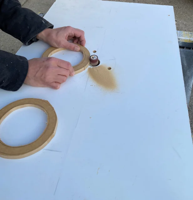

As for the rears, it wasn't difficult, but without the right tools, it could be a little more difficult for someone. The sound pods in our later model TJ's as opposed to the earlier model sound bars are not capable of accepting the 6.5" speakers...without modification that is.
I had to cut out wood circles and then I used a router to sand them to size so they could fit in the recessed part of the sound pod where the OEM speakers mount. I had to build that recessed area up to make it level with the rest of the pod to mount the speakers how I wanted them to fit. After the ring was installed into the factory mounting holes for the OEM speakers, I then mounted the new speakers to the wood ring and then the grills are mounted, which do require a new set of holes in the sound pods.
*NOTE* unfortunately I didn't get a picture of the rings I made after I had them mounted in place but below there is a link to something very similar, someone 3D printed theirs. If I ever have to remove my speakers for any reason, I can get a picture then and edit this post.
However, the wood rings are not necessary, I do recommend them. It makes it much easier mounting the speakers where you want them otherwise, you run the risk of them being mounted off center which will be noticeable. They don't sit in the speaker holes well so these wood rings help big time to make sure you mount them centered.

Now that it's all done, I can say that I am happy with everything. It sounds so much better than what was in there. As a side note, the speaker pods do have poly fil in them to help with the sound quality. I put that in over a year ago and it helps! I am very much into good quality sound and I do like loud music and I also like to "feel the bass" but this set up doesn't allow you "feel" the music like a much more expensive and elaborate system would cost but I am very pleased with it.

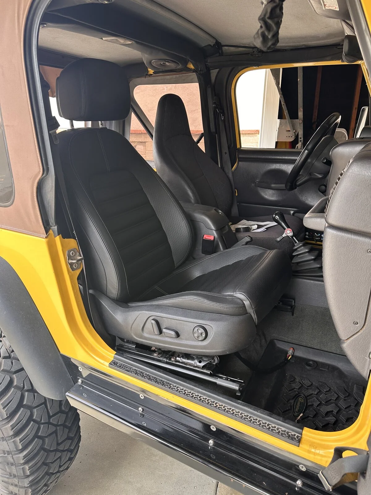

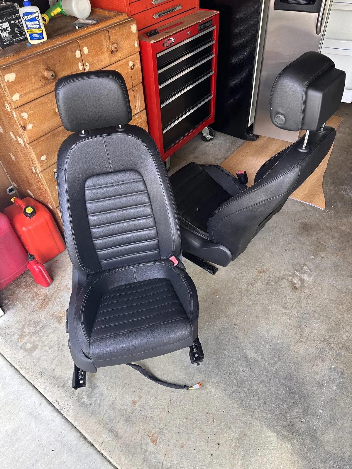

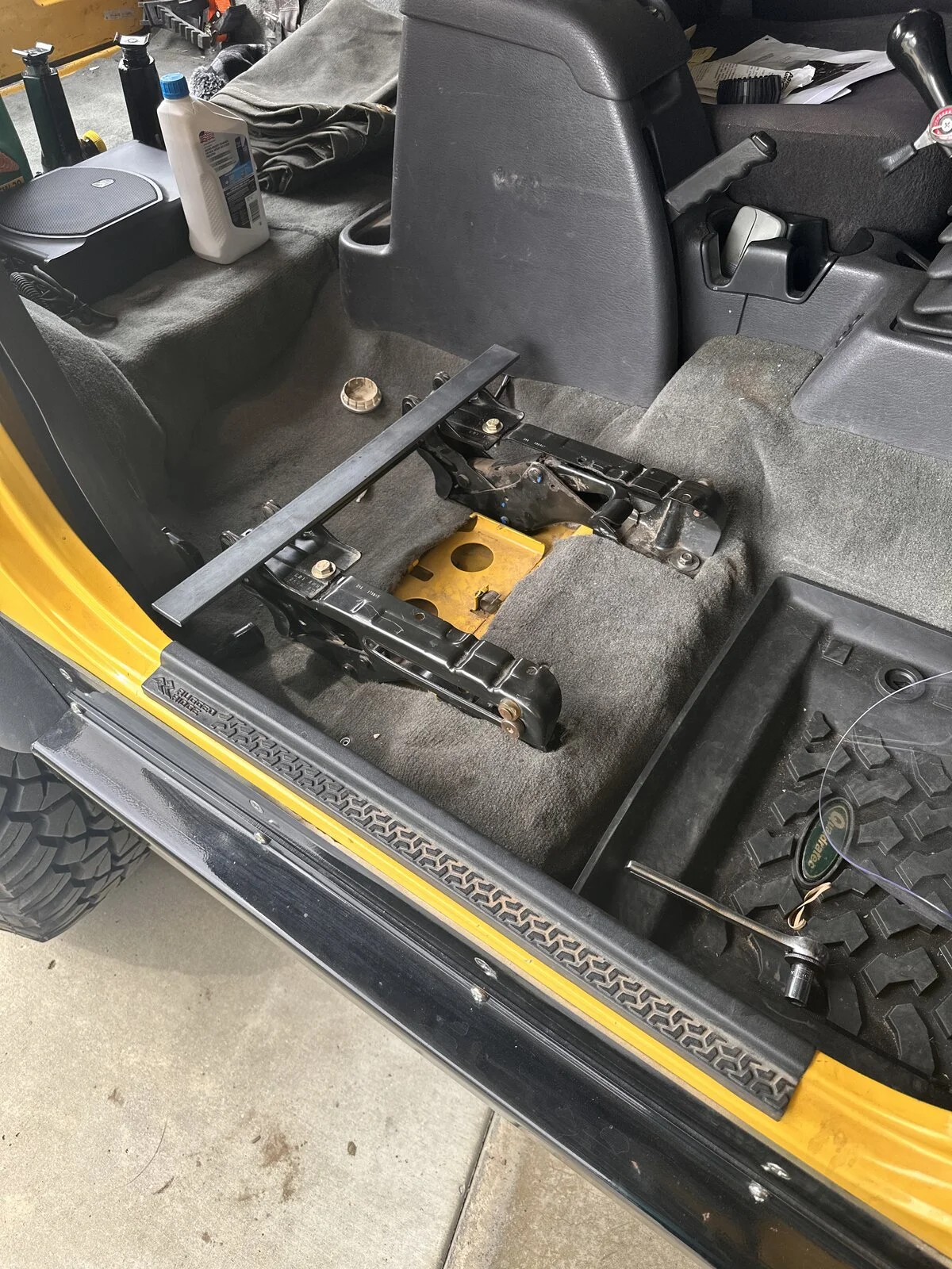

Nice seats!, need a few more details, like brand, where you bought them and exactly what you had to do to make them work :cool:
2014 VW passat CC Lux.
Junkyard for 280$
Brown wires on german cars = Ground
Red Thick wire 10gauge = Heated Seat
Yellow 10 gauge = Power and controls.
You will need to disconnect other wires and cap them off and insulate them for the airbag. Those are usually the yellow plastic harness.
Everything else is 1.5" wide by 1/4" thick steel flat bar for mounting. This mod isnt for the faint of heart ill admit. But damn is it nice. Looking to get the driver in this weekend. Im betting i'll need to cut my center console where the cup holder is to fit it.
