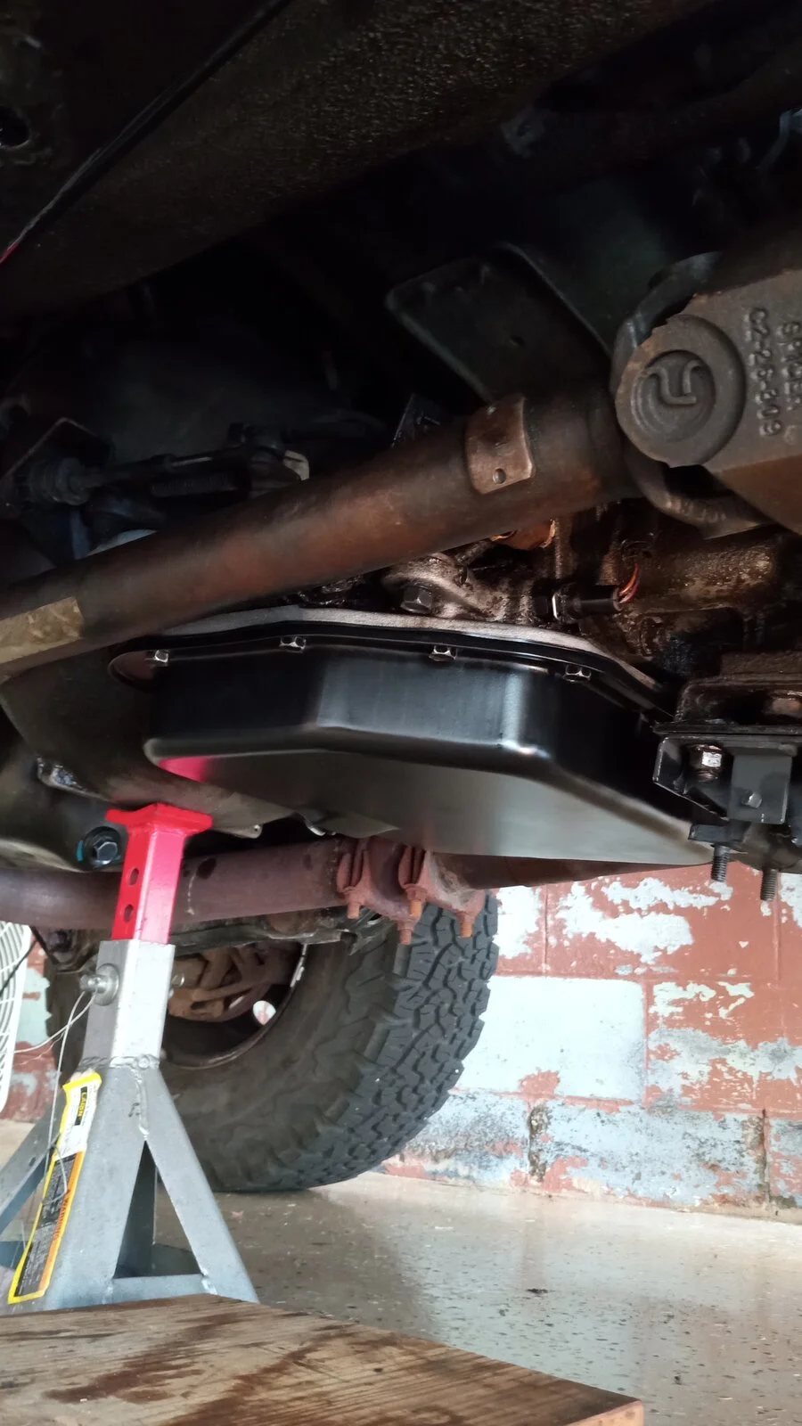

Seriously, any other ideas for how to fix this trans oil pan leak or track down where the leak is coming from? The first thing that I thought of is to get a Lube Locker gasket, drain the trans oil pan, put the LL gasket on, and then put the oil back in. It is all brand new trans oil.
I just checked. Based upon a strategically placed paper towel, it looks like that the trans oil pan gasket is NOT leaking. The leak is coming from somewhere else in the transmission.
Any suggestions on how to track down this new leak?

Check first to see if you didn't simply spill some ATF when filling it...

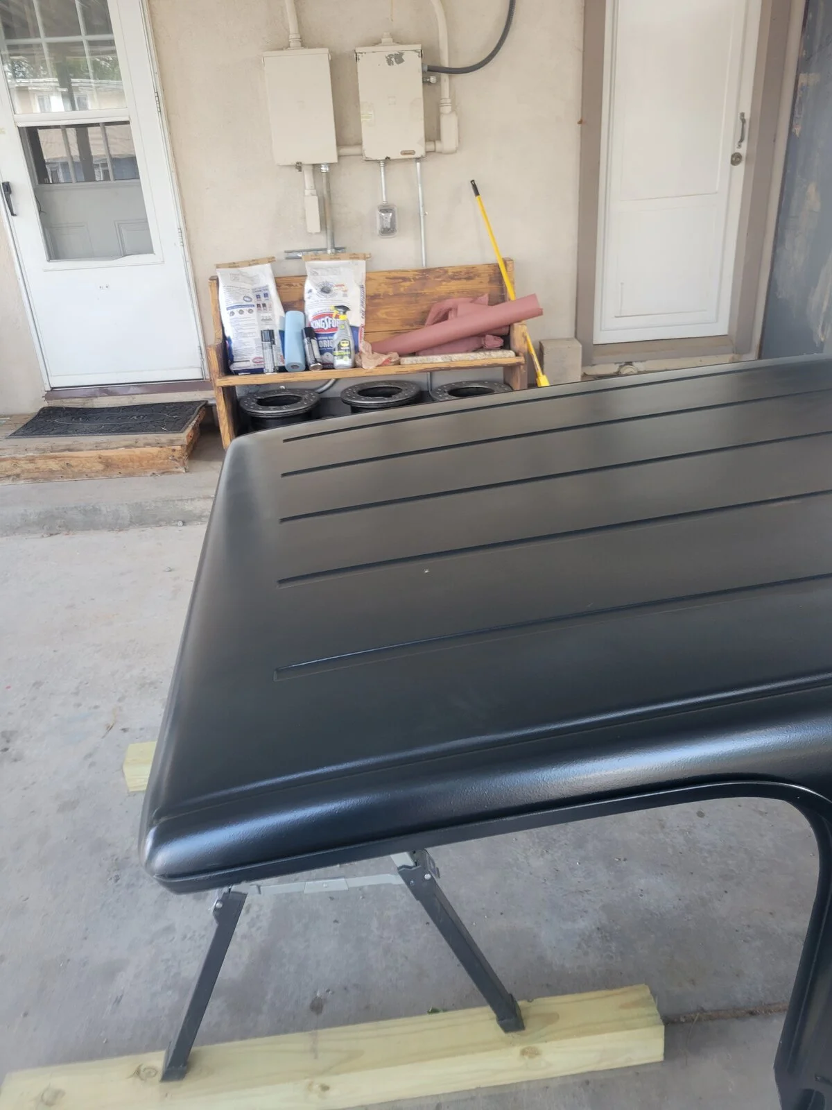

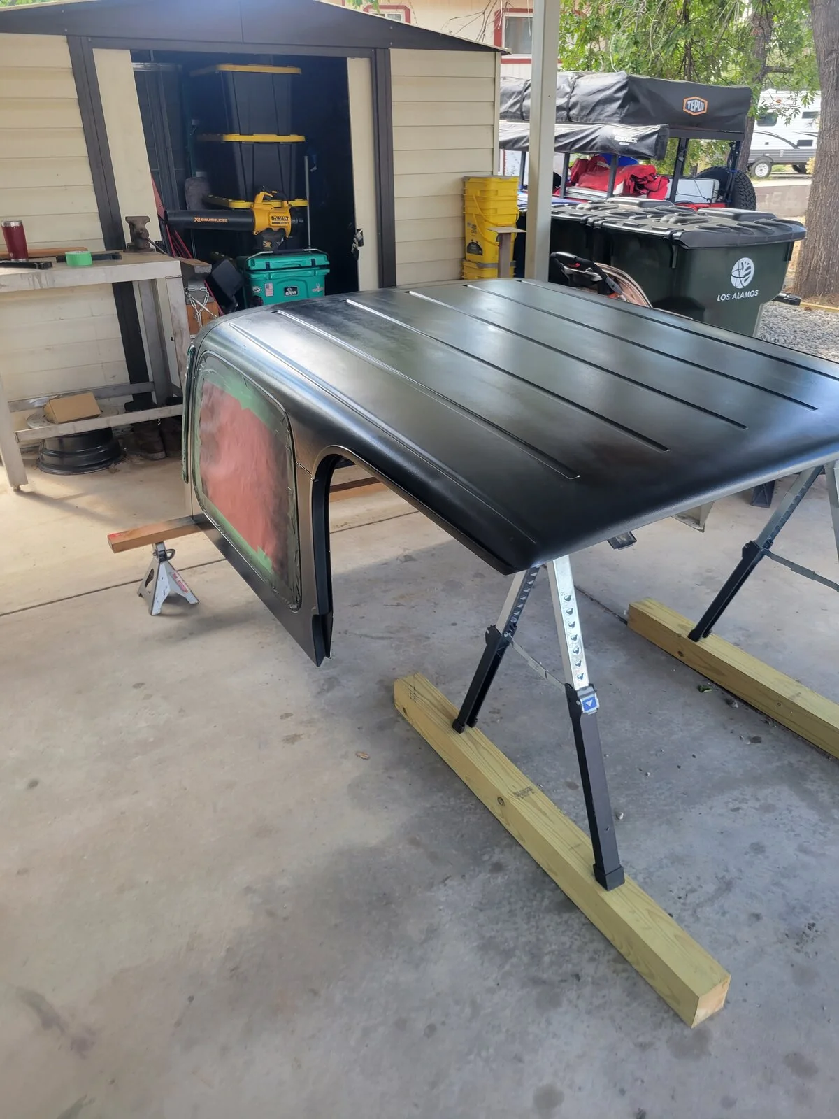

Rattle-canned my top. First I washed it, then scotch-brited it, then degreased and final rinsed it. Then I shot it with some Duplicolor for wheels that I had 4 cans of on fhe shelf. It's not perfect, but the previous owner painted it with a brush, and stopped painting where he couldn't see it. And he didn't cut in around the windows. It's a huge improvement over what it looked like yesterday. In fact, it went so well, I may just do my flares too!
Before
After

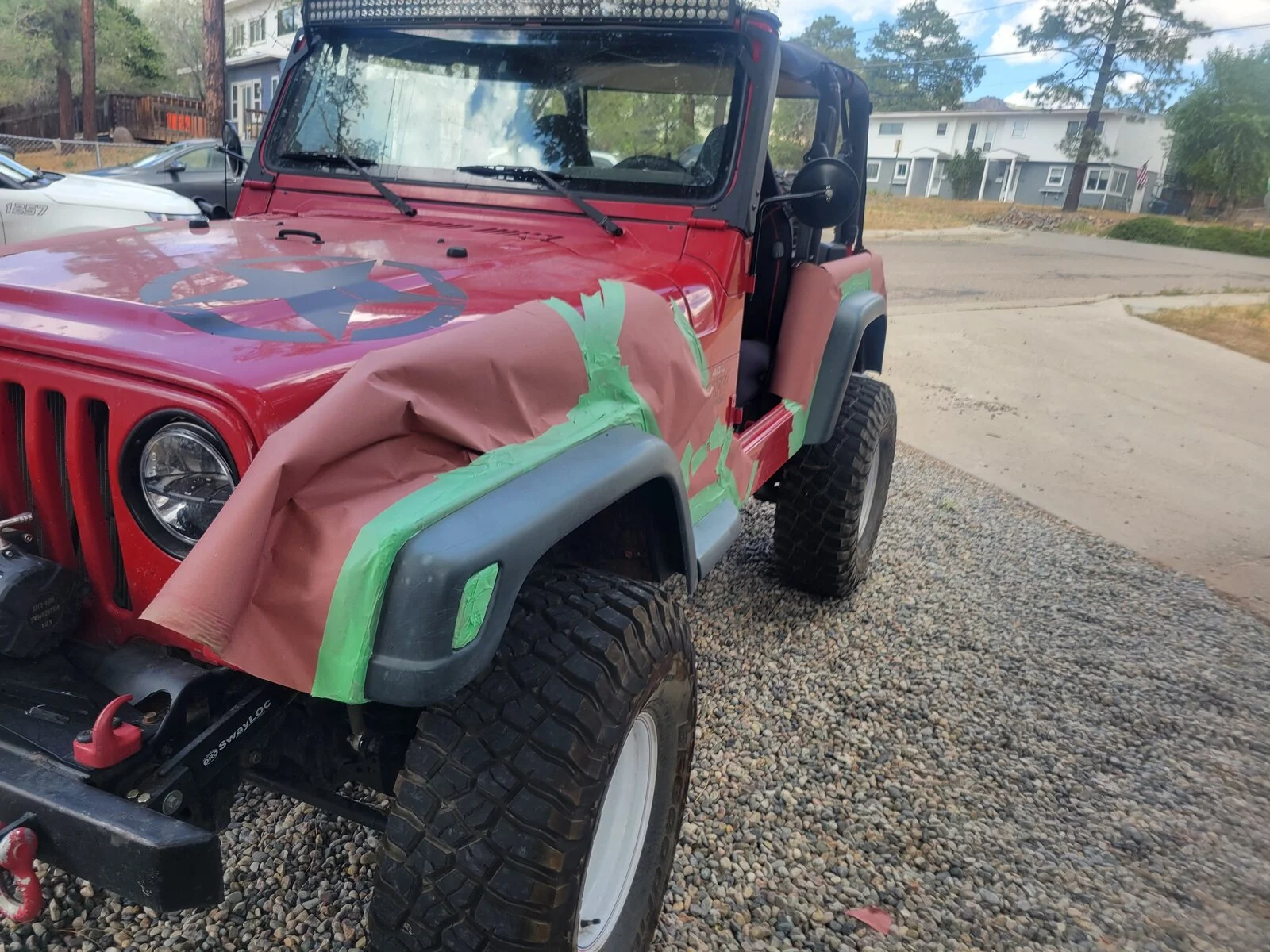

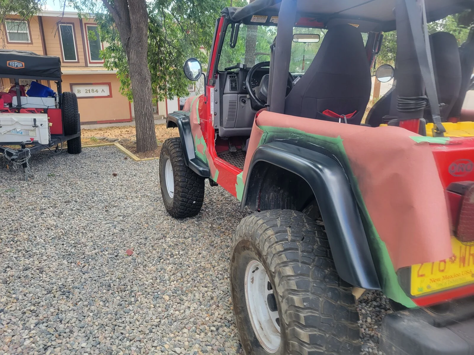

Alright, I already had everything out, and the top went so easily that I figured I HAD to do the fender flares. Of course, there is the right way (remove the flares) and the redneck way. Obviously I chose the redneck way. Tape that shit off and get to spraying!🤣
I'm really digging the way they turned out. Really injects some life into the ol' Jeep.
